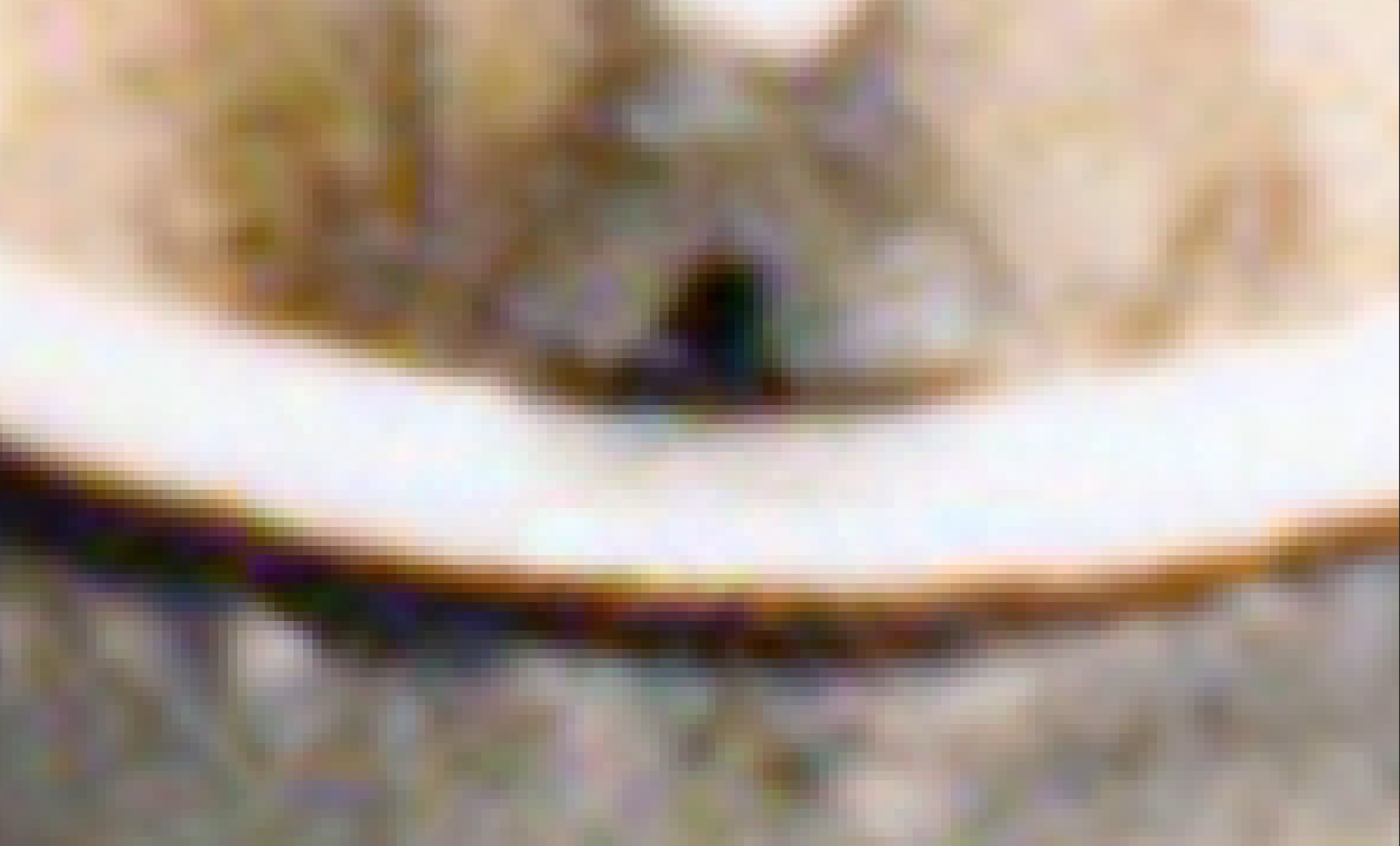

I hear ya, and I see what you're talking about in your photo, but the one I posted is much higher resolution in that area and a better angle. In my opinion, it's not a dot of shmutz, and to me the overall shape is very telling. You don't have to agree, I'm just saying I'm satisfied that it's a split strip. If that's the case, it would probably be 5000-series aluminum, since that's the best type to bend like that. 6000 series would definitely break.
You misunderstood me. And I posted a close up of the same photo you did, plus my first photo is much higher res. That dark black dot is definitely there and most likely a hole or divot of some kind, bit the wedge is much lighter in color and looks like a stain of some kind. And if you zoom in close on the left hand magazine photo you can see that the wedge ends before the edge of the outer ring.
I had this exact theory many years ago based on the same old photo, and posted about it. The consensus then was that it was not a split piece and I don't believe it is. I'm not trying to shoot you down buddy, but I just don't see it anymore.
I strongly disagree with that consensus. Your photo may have more overall pixels, but the detail in that spot is very fuzzy. The Bill George photo is far clearer in that detail area, because it's a much closer shot of the phaser to begin with.
Look, believe what you want. I'm not really invested in convincing anyone of anything. Just calling it as I see it, and that's how I'm going to make mine. We'll see what kind of results I get. :)

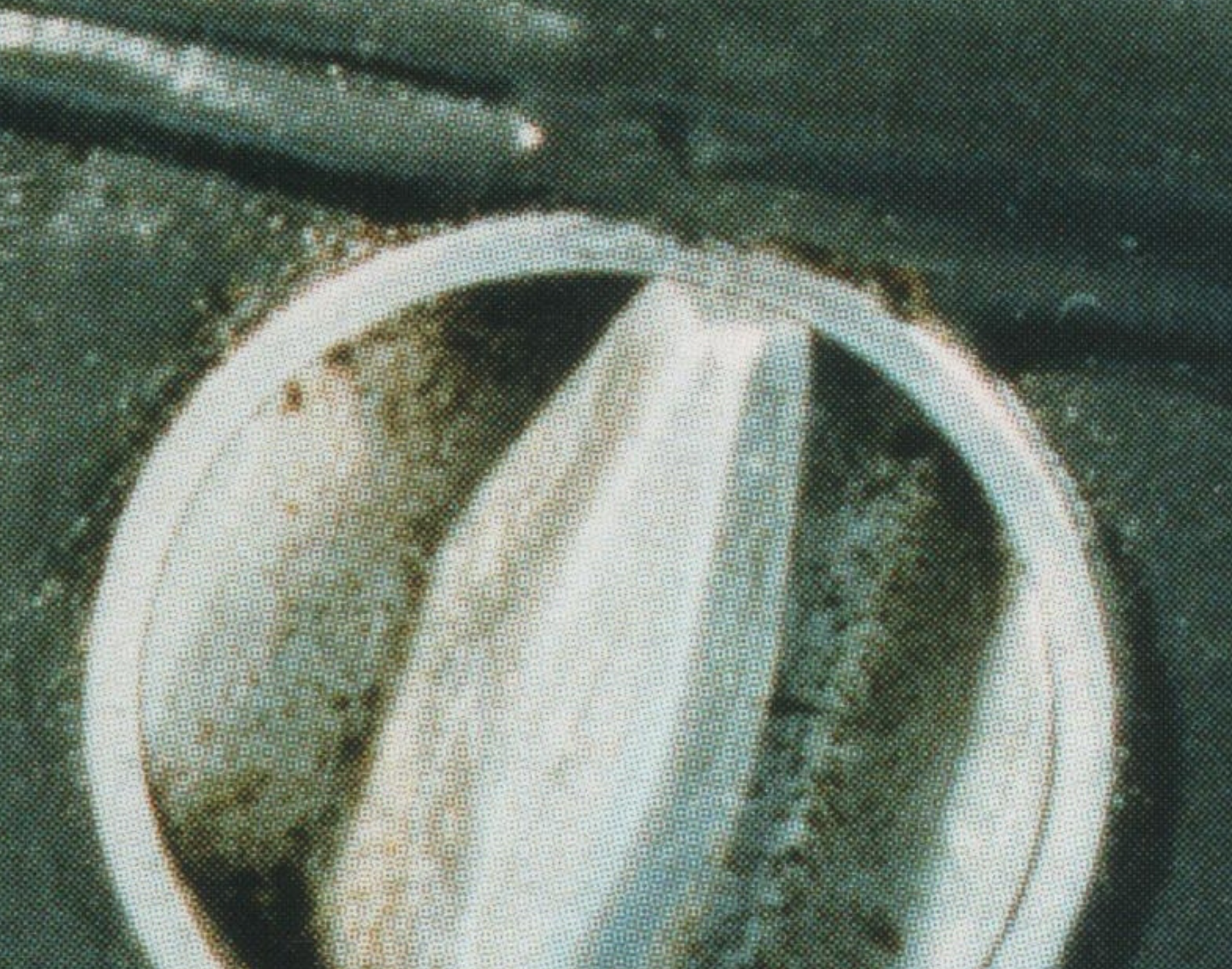

One thing I hadn't thought to do is compare it to the midgrade photos which have made the rounds, to see if there's any indication at all either way. Another thing that's occurred to me is to look for tool marks, which might help decide either way. The nozzles have tool marks, and that's consistent with not expecting such things to read on film, so they're left as-is. Tool marks might show milling, depending on what they look like.
My skepticism about milling a solid piece also comes from the profile of the channels on either side of the tab. They're not round, the way they would be if a ball-nose end mill had dug those out or if they'd been drilled from the side. They're more consistent with being bent twice to get that shape. You can see it both in the photos above and on the Wand phaser.

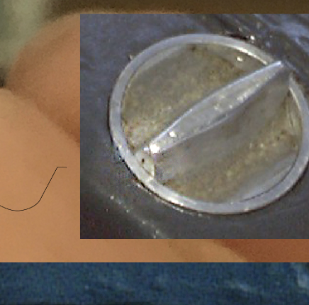

I’m with Robn1 on this one. And I happen to be an expert in imagery. If you expand the image you posted asalaw, you can see there are anomalies within the ‘black triangle’ (cue x files theme) that support the black spot theory. Not to mention if you look at the photo Robn1 posted, the opposite side of the side turn is solid aluminum right up to the outer ring. See my enhanced copies:

View attachment 721328View attachment 721329
I appreciate your input, and any such constructive input is very welcome, but I believe your conclusions don't necessarily follow from the facts in your analysis. There is still the profile to be accounted for (which your analysis doesn't), and even if you're correct about the feature being a hole, your conclusion isn't the only possible one. In short, we still haven't eliminated all the alternative interpretations. To wit:

The picture below shows the profile of the knob, which is wholly inconsistent with either milling vertically with a ball nose endmill or drilling transversely with a drill bit. The profile is consistent, though, with a strip of aluminum being bent into shape. Particularly since each groove is asymmetrical. This profile is the same on both the original and the Wand replica, which is the one I have in my fingers. I suspected for years that the profile wasn't perfectly round, and the Wand replica would seem to back that up. It would be a very odd change for them to make. And IIRC, it's the same way on the JL/Masterpiece Models resin version.
2. The other side of the tab. While the other side, as you point out, shows no such feature, this could be accounted for by an uneven slice -- a very, very simple explanation that's possible whether the slice was done by hand with a small hobby saw, or by running the strip into a bandsaw blade. Either way, there's no guarantee that you will get a perfectly even cut on both sides. So one side could be above the ring, the other just below it.
3. Hole vs. triangular opening. This might simply be a fracture going from the top of the split, where the metal failed while it was being pried open after cutting. So that would mean while it's not a triangular opening, the piece may still be a split strip. So the actual split would be below the outer ring. This would also account for issue no. 2.​
Overall, I think the biggest stumbling block to the milled rod theory is the profile. There's no good way to square it with being machined or drilled. And whether the original was machined or split, I'm still going to have a crack at splitting it. I still think it could be a faster and easier method than milling it, which would be another point in its favor (though certainly less probative than the profile).
Here's a quick breakdown of the profile issue:
I don't think it's a hole. I think it's a spec of dirt. And while my analysis doesn't account for the lack of milling or tooling evidence that would support the theory it was created from solid stock instead of a sheet, I don't think there's enough evidence to say it wasn't. Perhaps this was cast pot metal?
In fact, the triangle area from the photos in your last post would seem to confirm the spec of dirt theory from an image science perspective. Milled, filed, cast, bent etc remains to be determined.
