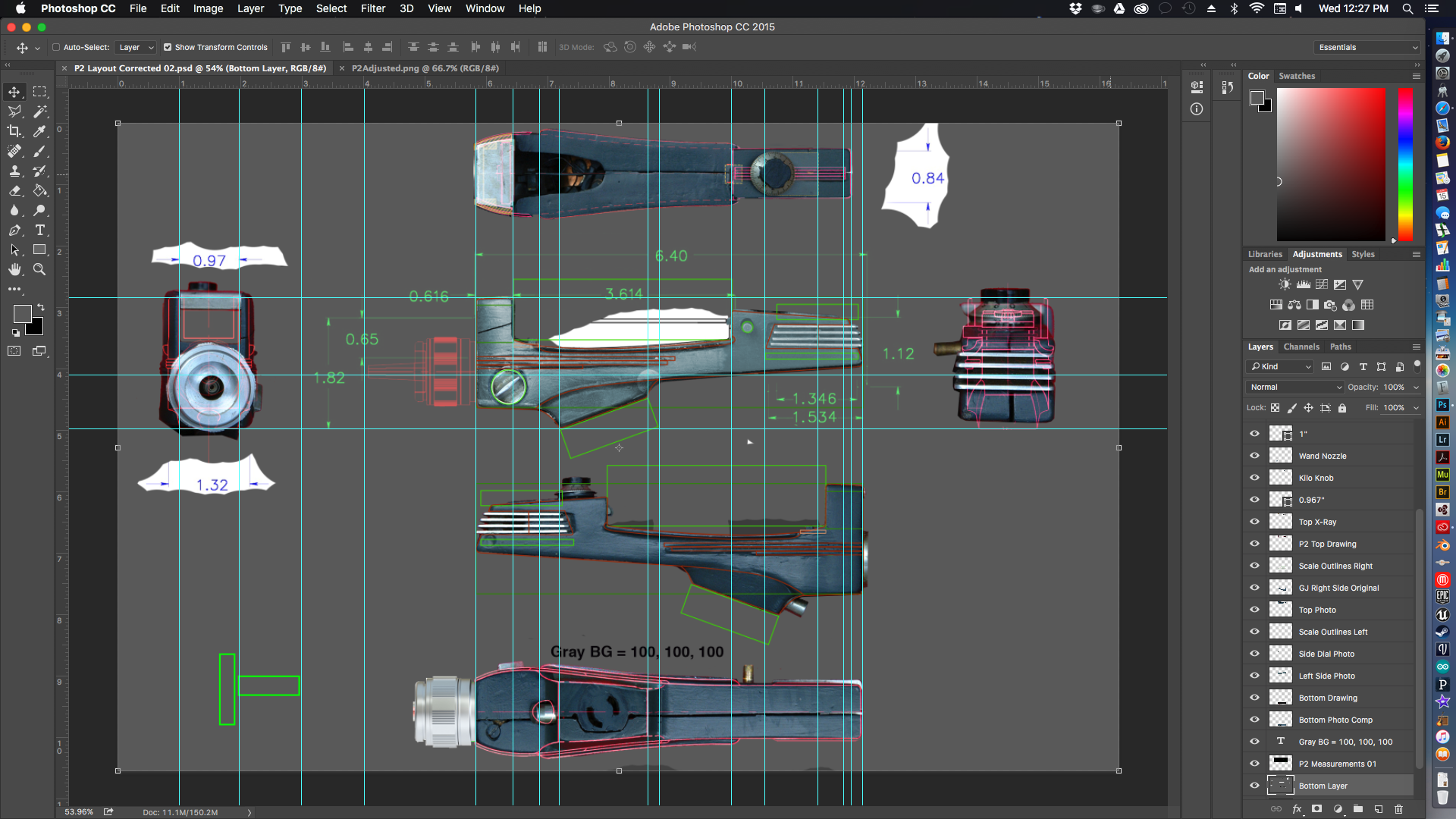

Been taking measurements and thinking over how to approach parting the model, and I've just had an epiphany. Time to put my head down and bust my ass for the next three days, 'cause I got a 6-month gig starting Friday. But as I've so often said, every time I model something, I get better and faster. I truly think I've sussed it now, and when I can get a weekend free, I'll pop for a month at Techshop and git 'er done. :)

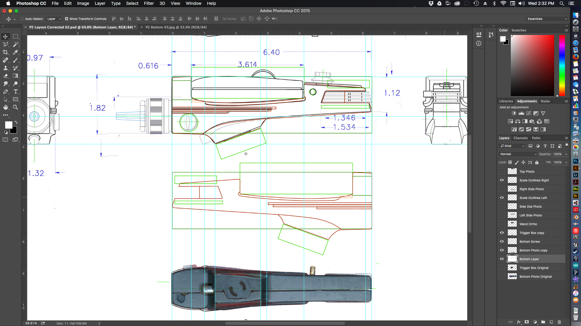

Today's blueprint revisions went really well. I'll finish tomorrow, only the front and back views to go. Then I dive right back into the model to do the retopo against these new drawings.

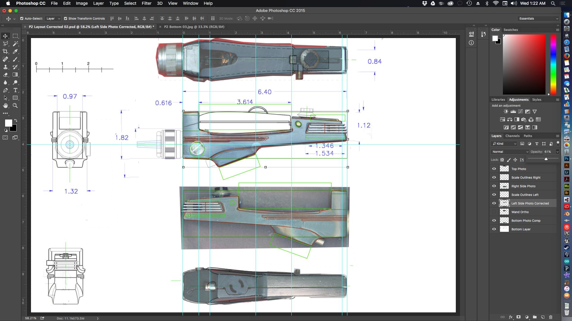

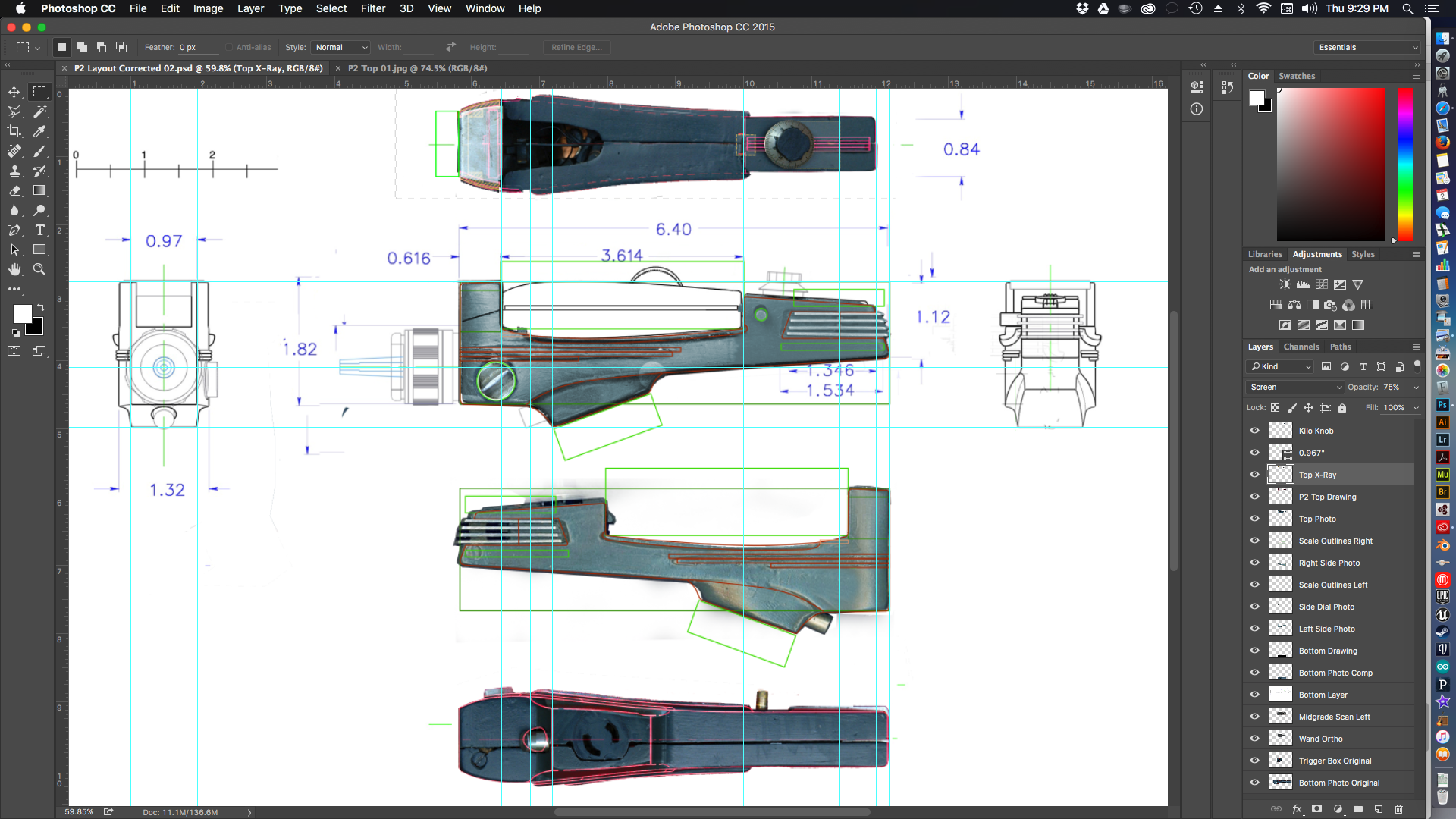

The green boxes represent actual measurements from the GJ hero. The tiny little orange box at the front of the cradle in the side views is the single measurement I took from the JL. Once I had these measurements in place in Illustrator, I discovered the Wand phaser has a couple of distortions.
The red outlines are my actual corrections to the blueprints by Sunking. They're very close, I'm very impressed. I derived the red outlines by comparing the Wand to the actual measurements from the GJ, then by using those measurements to correct the distortions in the photos of the GJ. My red countours are necessarily idealized a tiny bit, since the GJ isn't symmetrical and there's necessarily still some error in my corrections of the photos. Also, in one or two places I did a bit of fudging to my own taste, again to clean up inconsistencies in the GJ.
That said, I think I'm as close as I need to get, and once the 3D files are out in the wild, maybe others can redefine rivet counting.
I'll post comparisons of Sunking's blueprints and the Wand orthographic side view to my outlines tomorrow, but meanwhile, here's a taste:

Zeroing in on the bottom view. Gotta get these things done and out in the wild by EOD tomorrow, so I can start using my weekend time for modeling. Off to forage for food and diapers, back to the mines later today. :)

Quick update -- still getting in work on the drawing, but if I posted a screenshot it wouldn't look like I'd done anything. The changes are very subtle. The contour errors I got the first time around trace back to errors in the first drawings, so I only want to do this twice once. :p
Really closing in now. The front and back photos need scaling and comping, then some cleanup of the measurements and rulers, and some final dibbing and dabbing... and man, am I ever late for work. Gonna be a late one. :)
I might do a version with a straight-up black background and no photos, since in Blender I can put the drawing in front of the model with partial transparency and that would give me nice bright lines on top of the model for comparison.
Also, at the end I have to put Sunking's credit box back in and some other info.

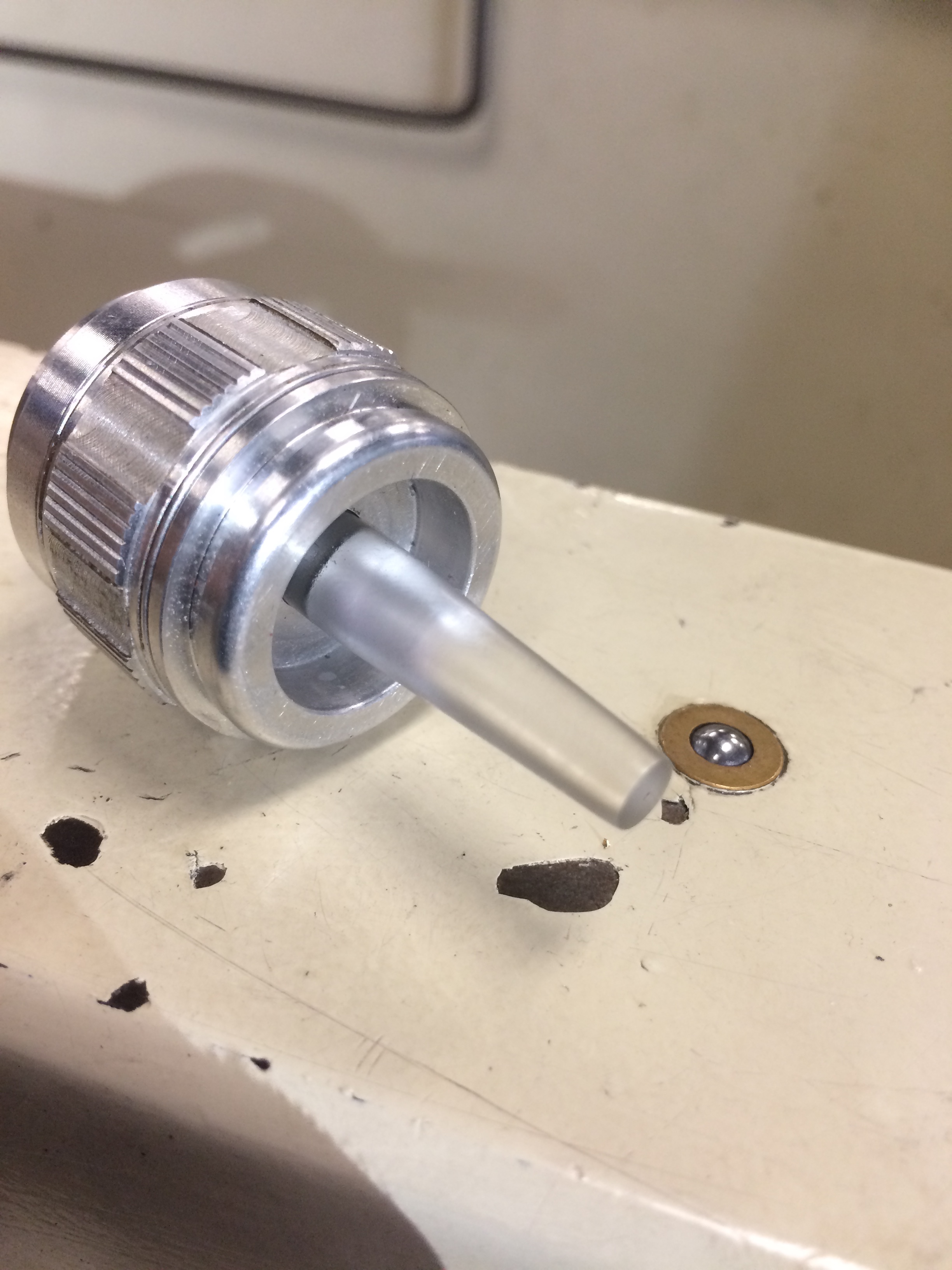

  • Last but not least (and actually, first), I turned a beautiful fake Kilo knob for my midgrade project.
I also got back into turning P2 emitters, but since Techshop cut their hours back to 9am - 12am, I had to bail before I could finish dialing in the exact angle for the taper. One minute you're turning acrylic like a madman, the next minute someone on the PA says "RELEASE THE HOUNDS!" and you're backed into a corner, holding off rabid Rottweilers with a dull parting tool. Ah, shop life...
So here are the knob pictures, such as they are, which are actually taken across two different pieces. Why?

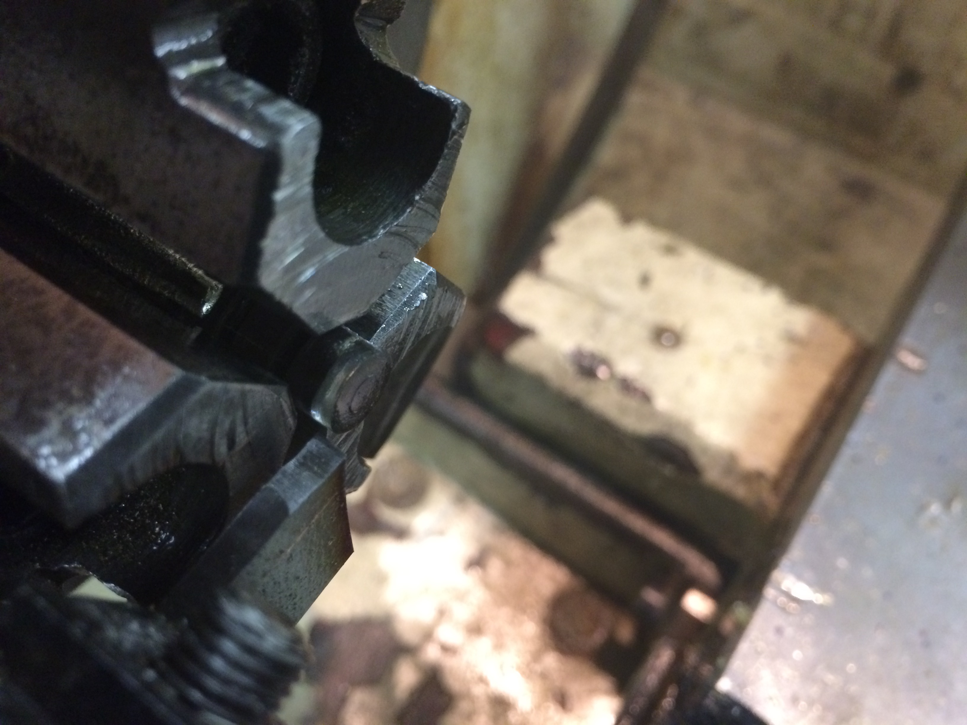

A word about auto-feed. It's a beautiful thing, unless you send the carriage the wrong way. If you pull the lever one way, the tool glides slowly and precisely across your work, leaving behind a gleaming, industrial-quality finish. If you pull the lever the other way, the tool glides slowly and precisely into your workpiece, leaving behind a mangled corpse.
And that's how I got hit by that car. :p

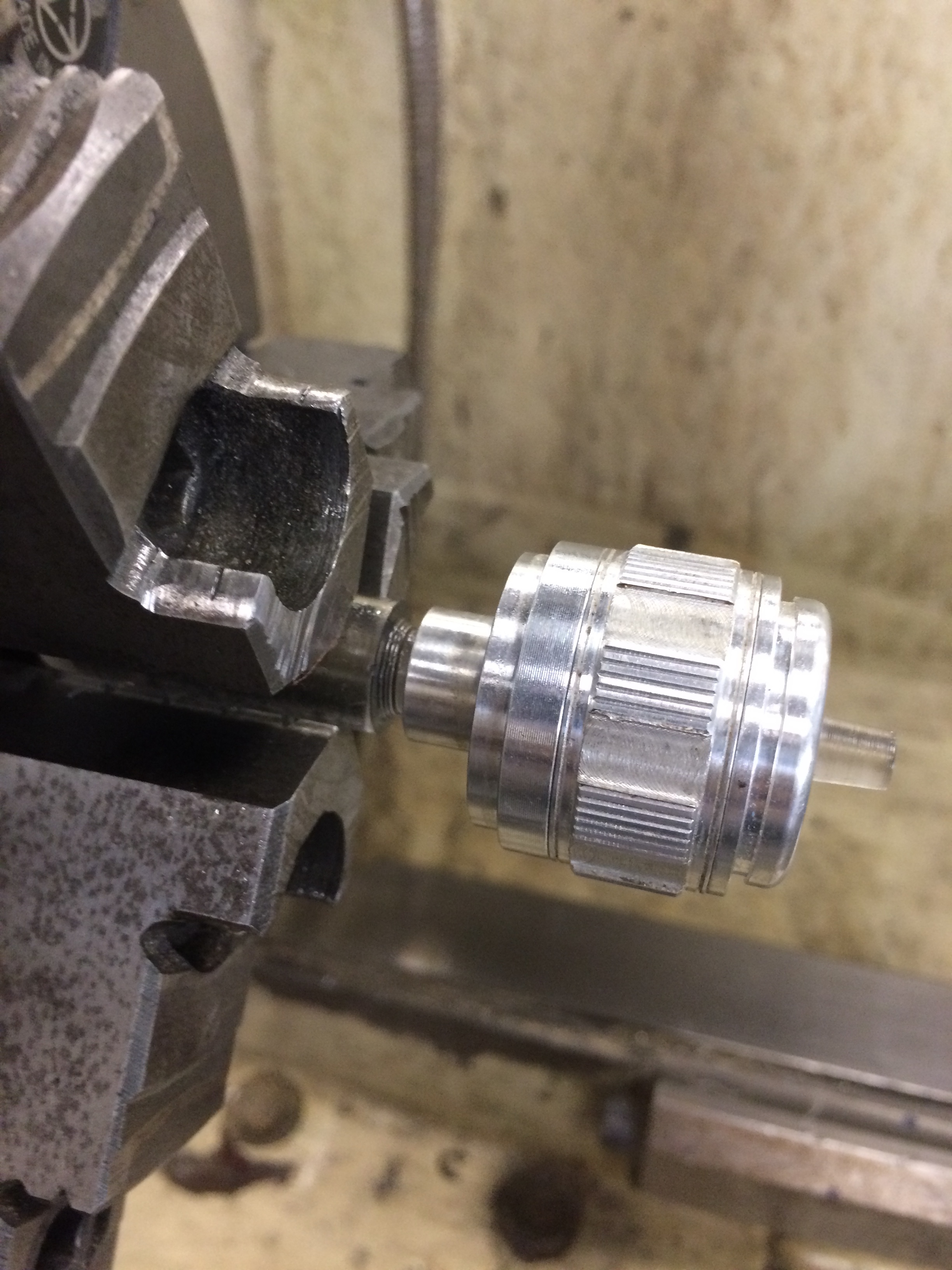

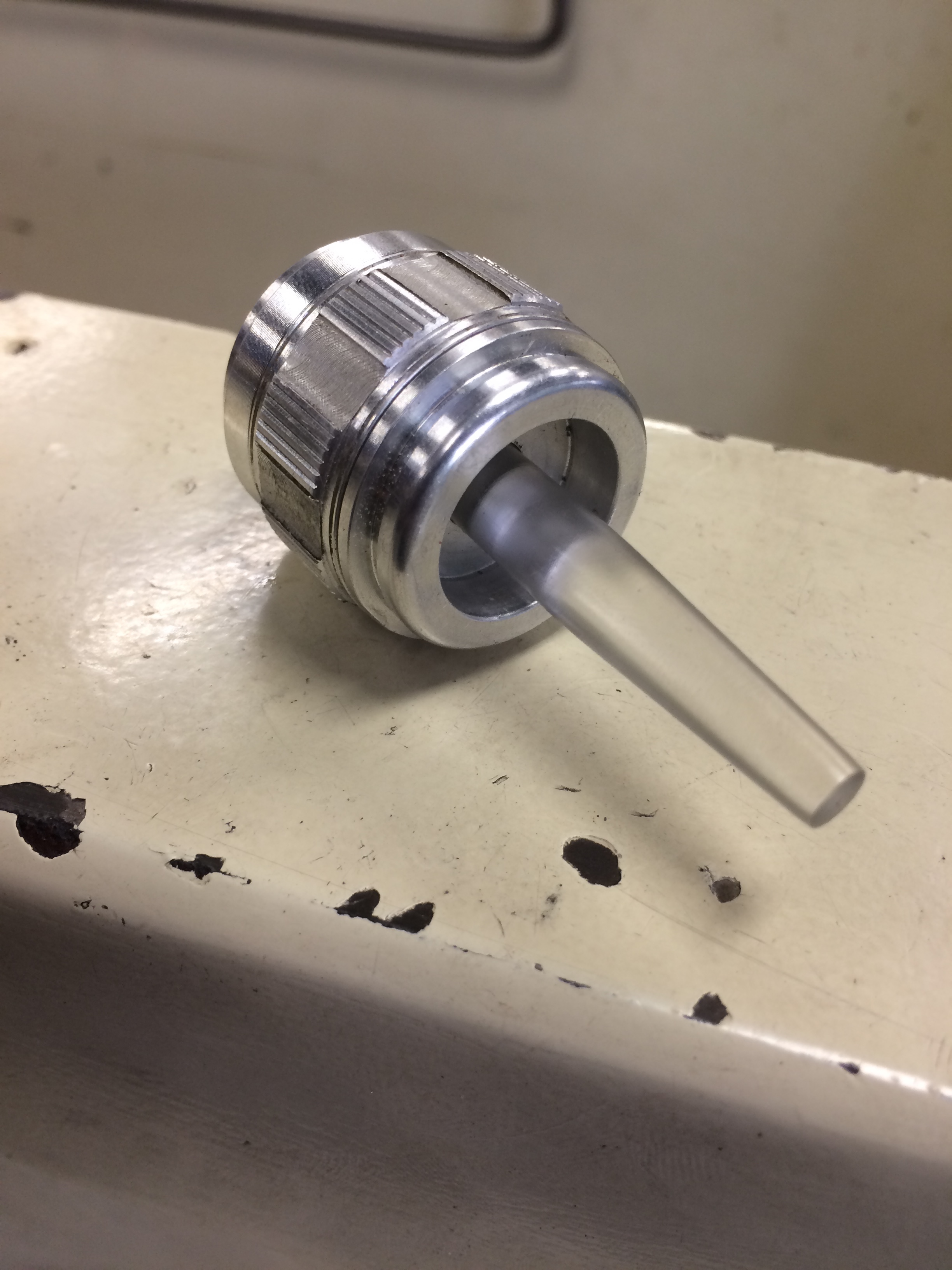

1. The faux Kilo knob:
I found the best order to turn it is as follows:
  1. Turn down the top stud, leaving yourself extra length to finish off at the end.
  2. Turn the taper. I moved the tool toward the stud to start with (away from the chuck), then switched direction for the last couple of fine passes (to avoid accidentally crashing the tool into the stud and ruining it).
    1. I did a 55º taper, which looked about right by eye and compared favorably to the Kilo knob. Not identical, since the faux knob looks flatter to me in photos. If I had to guess, I'd say the Kilo knob is more like 50º. Nobody's gonna walk up to me at a con and put calipers and an angle finder on it, so I'm not gonna sweat that.
  3. Turn down the diameter of the dial part, to around 5/8". This can be loosey-goosey on the midgrade, IMO, depending on the width of the back of the phaser.
  4. Finish the end of the stud down to a height of 3/32". The diameter is 7/32".
I'm going to paint the stud tonight if I remember.* I've decided to make this midgrade showroom-new, partly because everybody's doing the distressed look, and partly because the machined parts look so pretty, I just don't want to distress them. :)
*I did not. :p

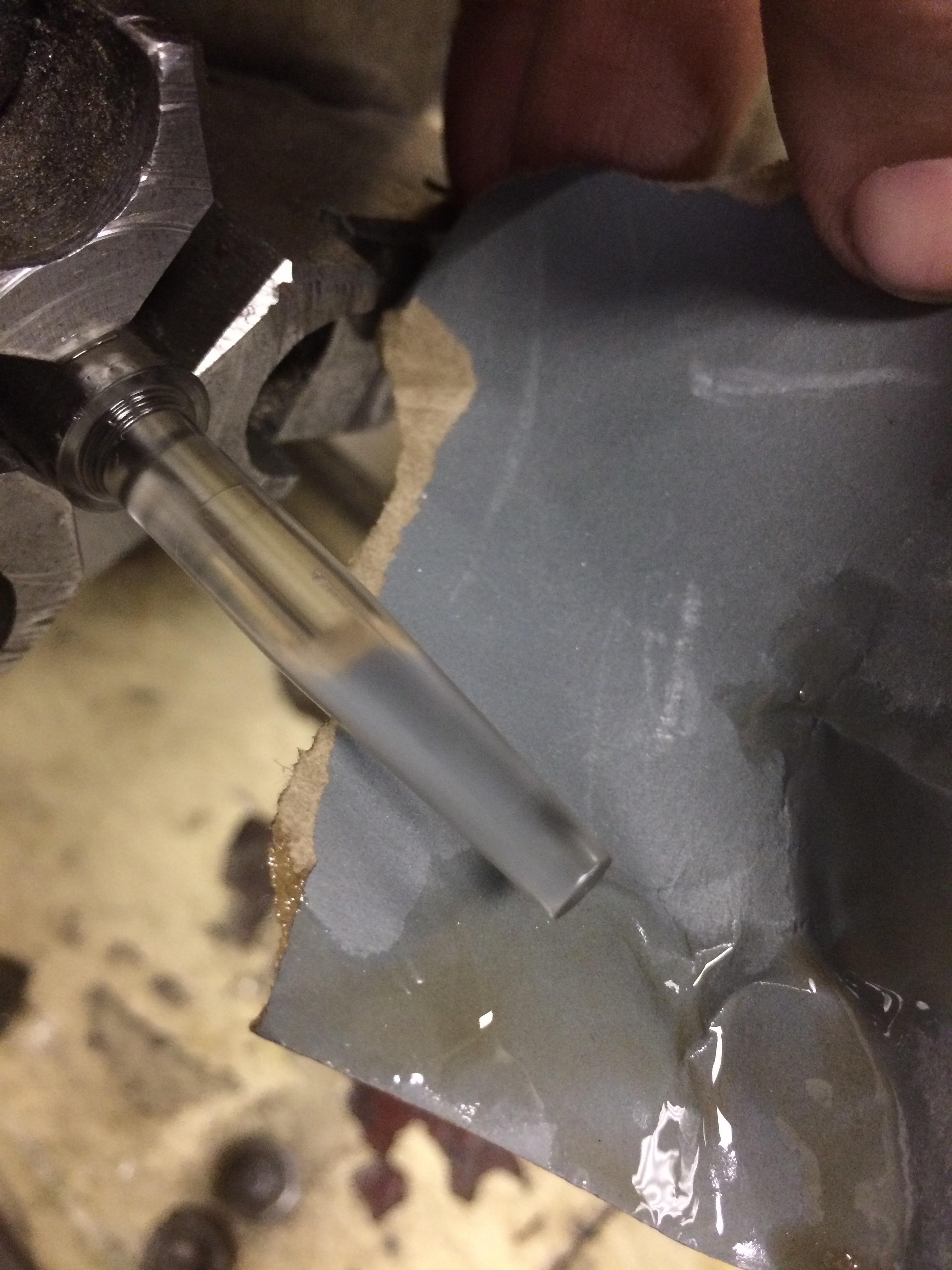

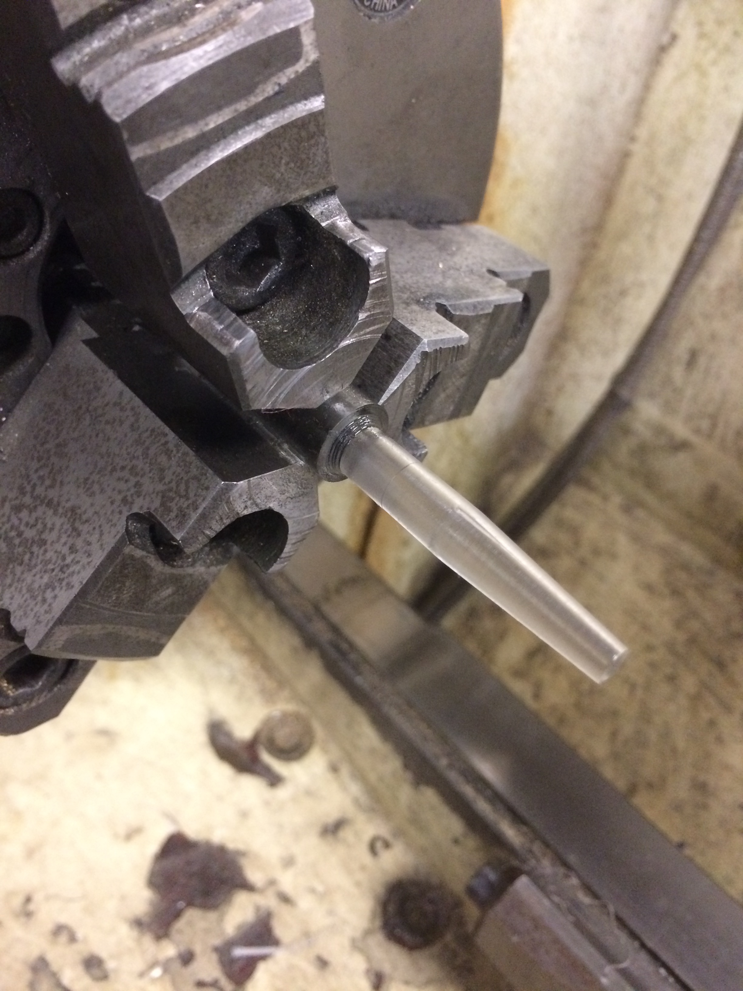

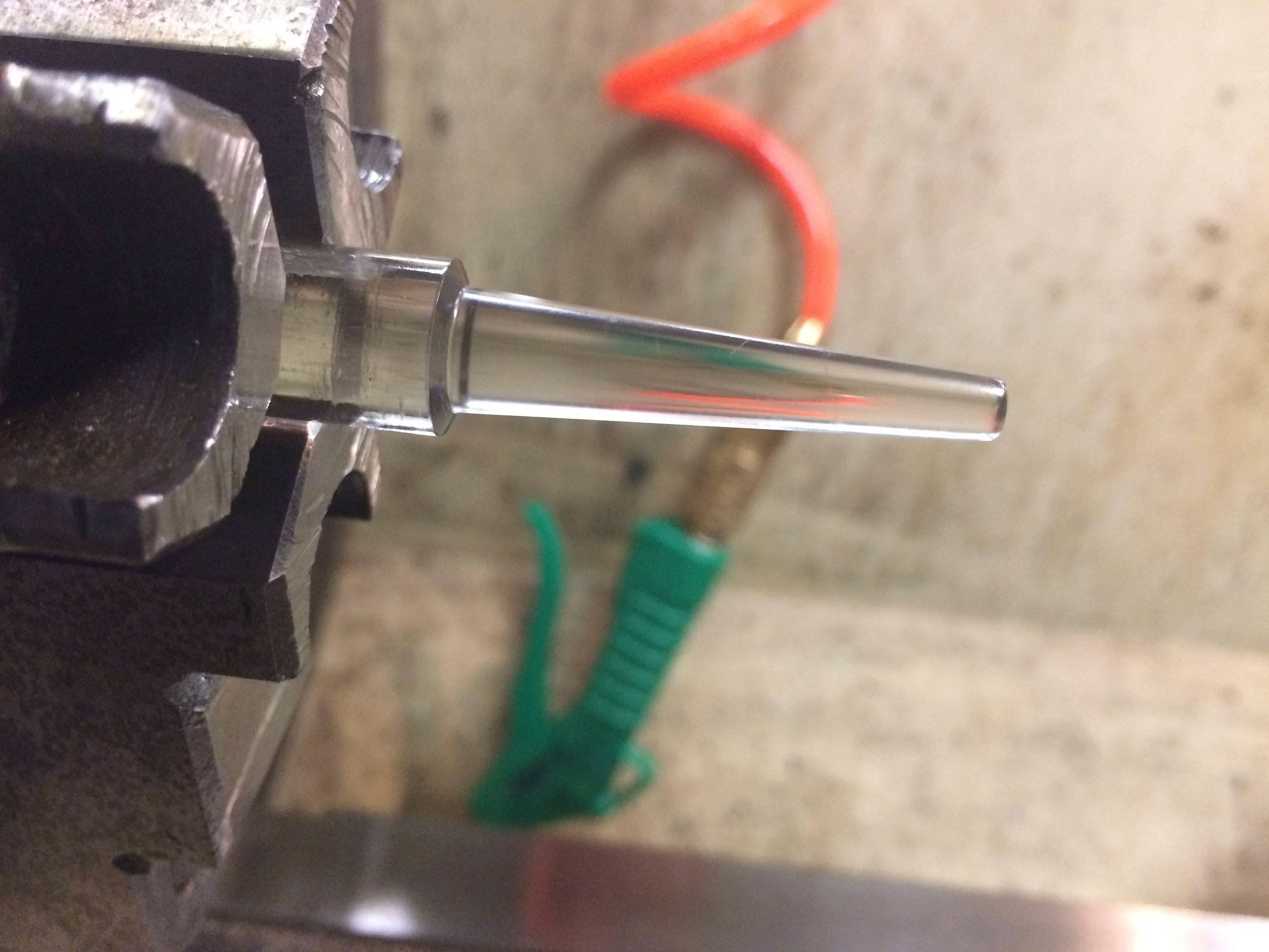

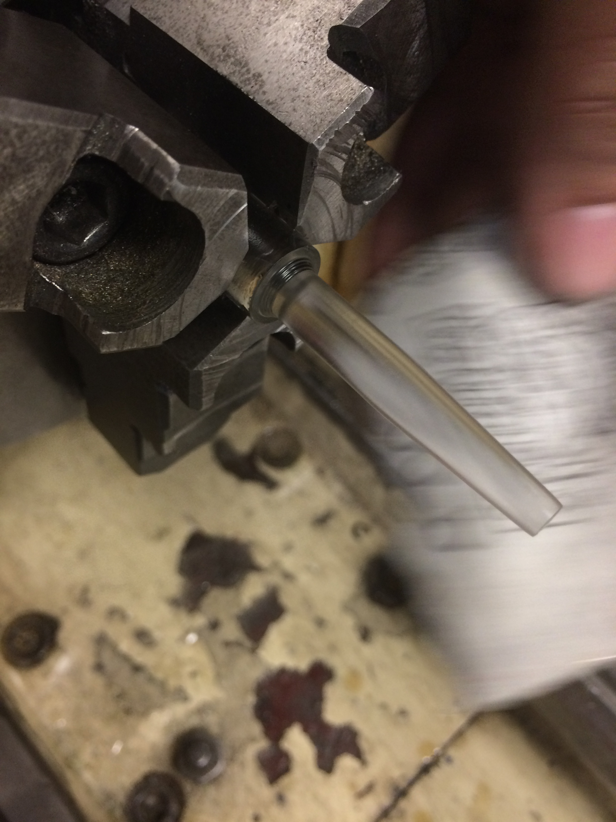

3. The midgrade acrylic emitter:

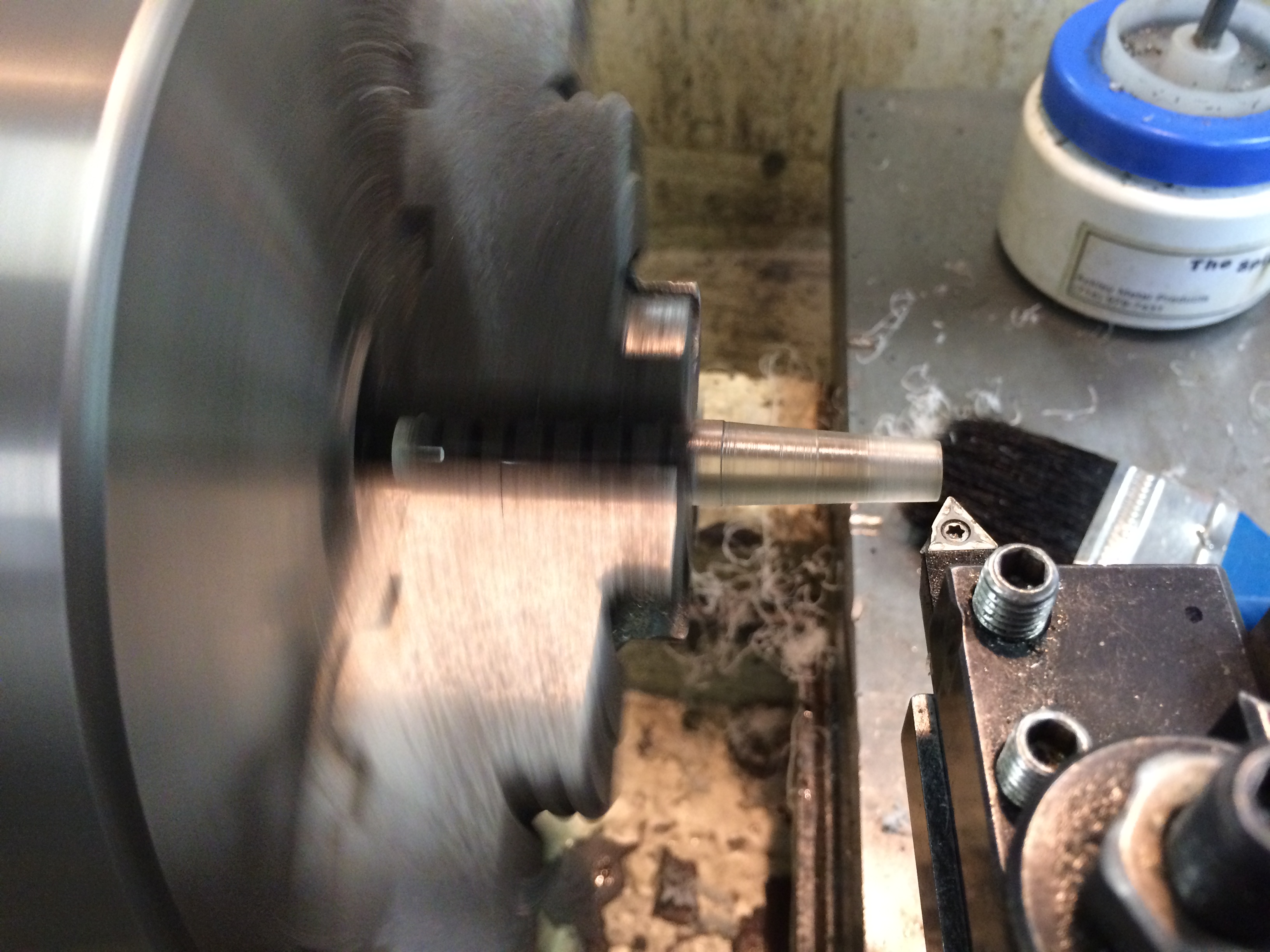

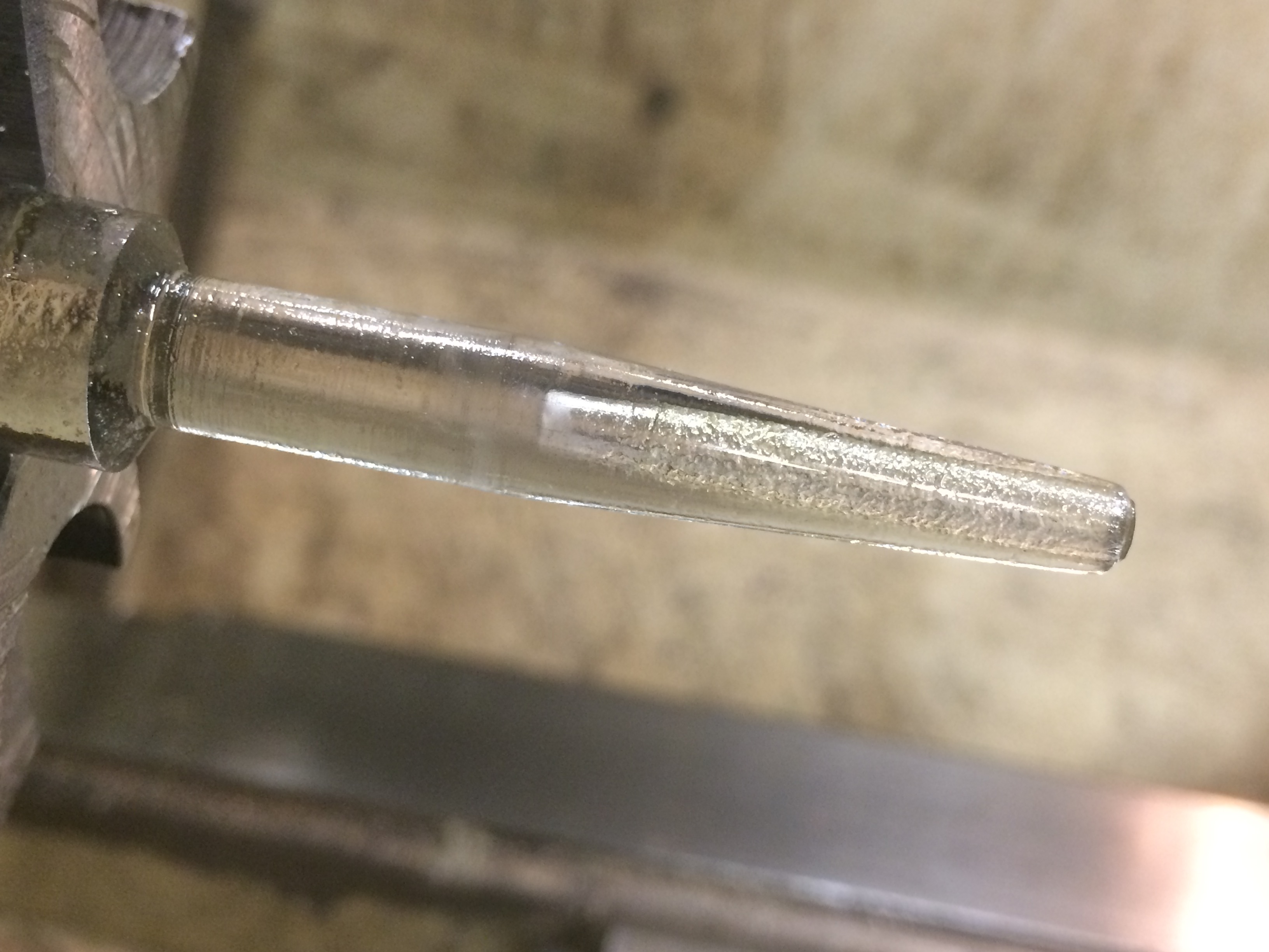

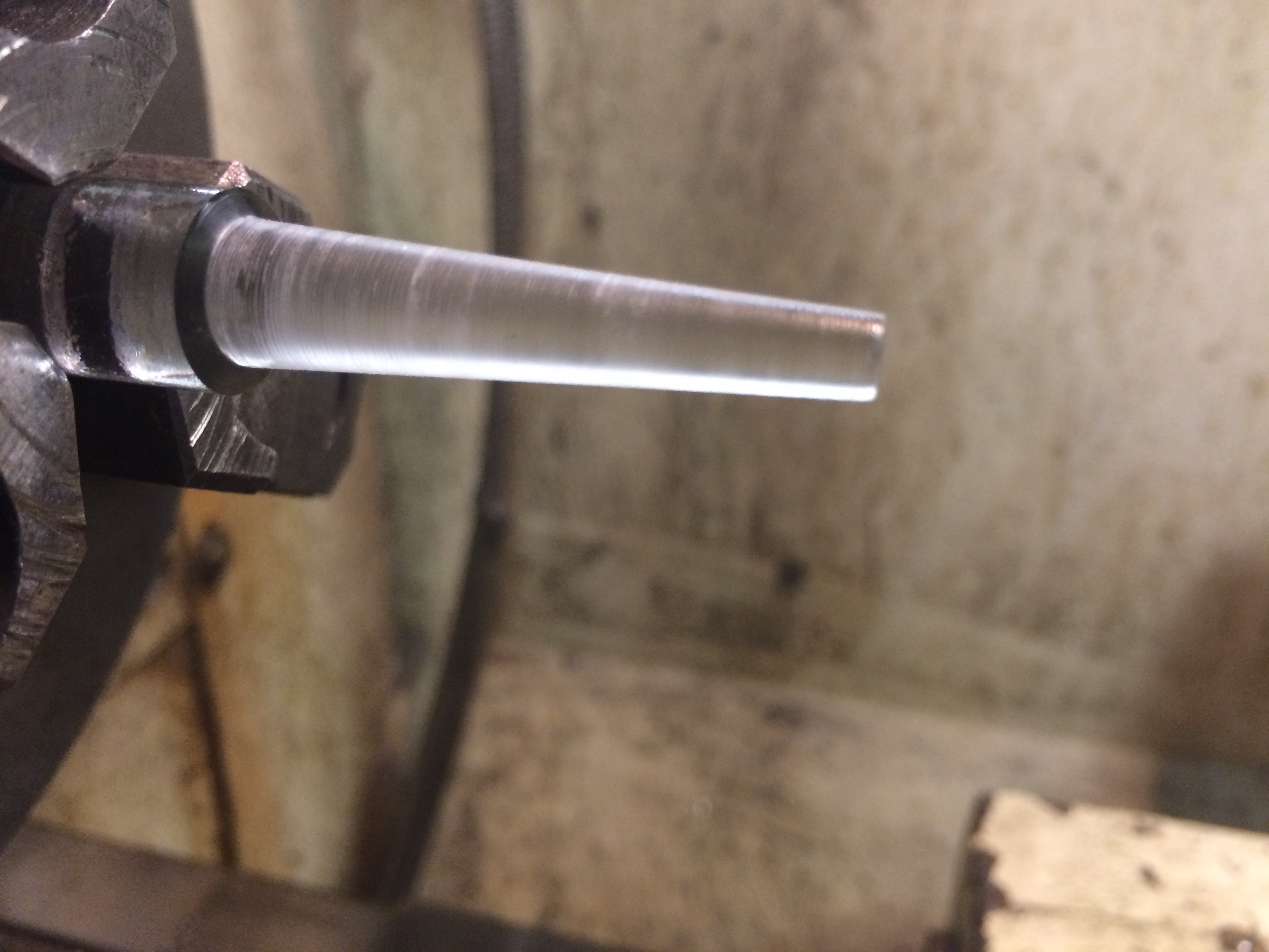

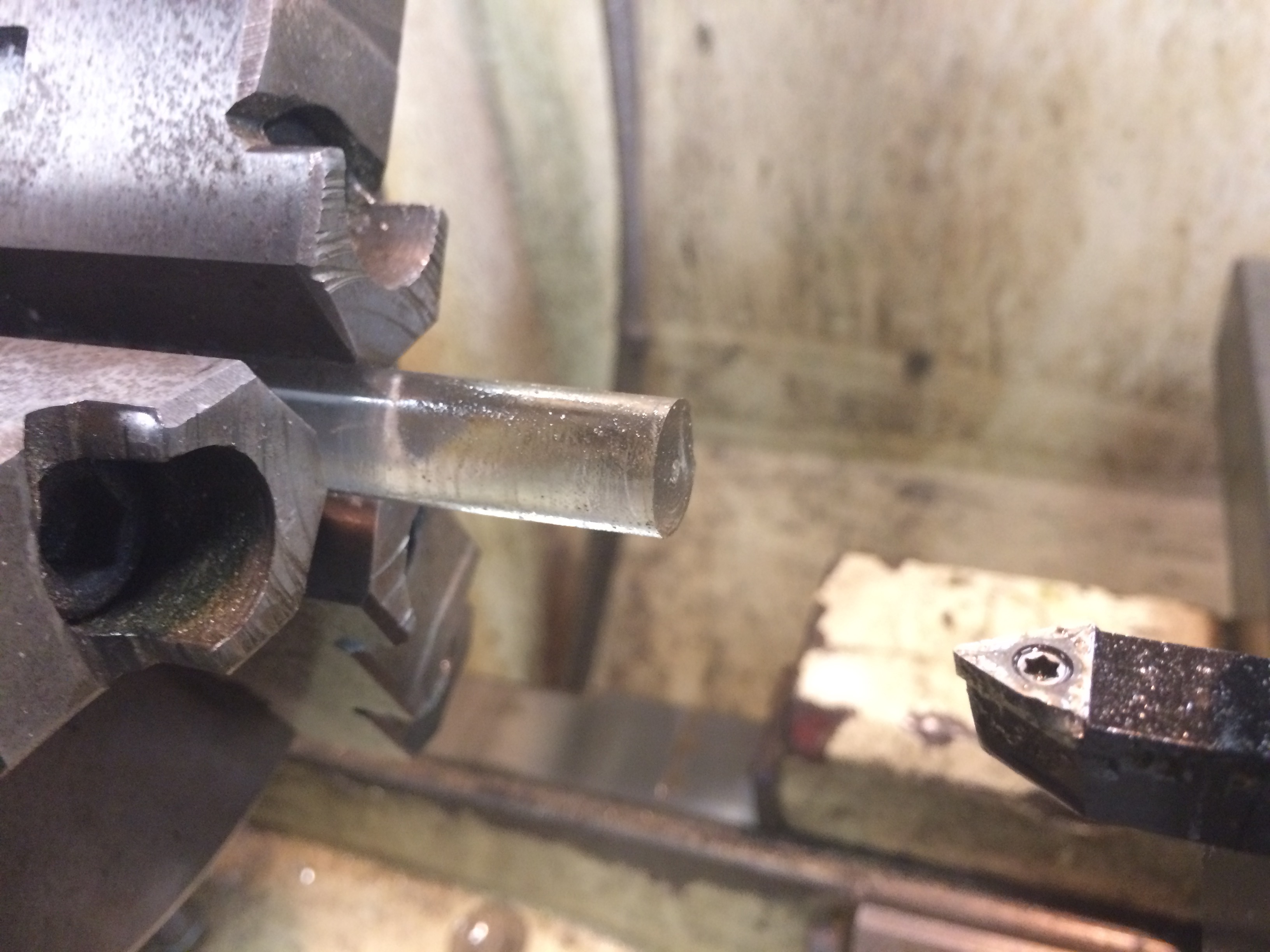

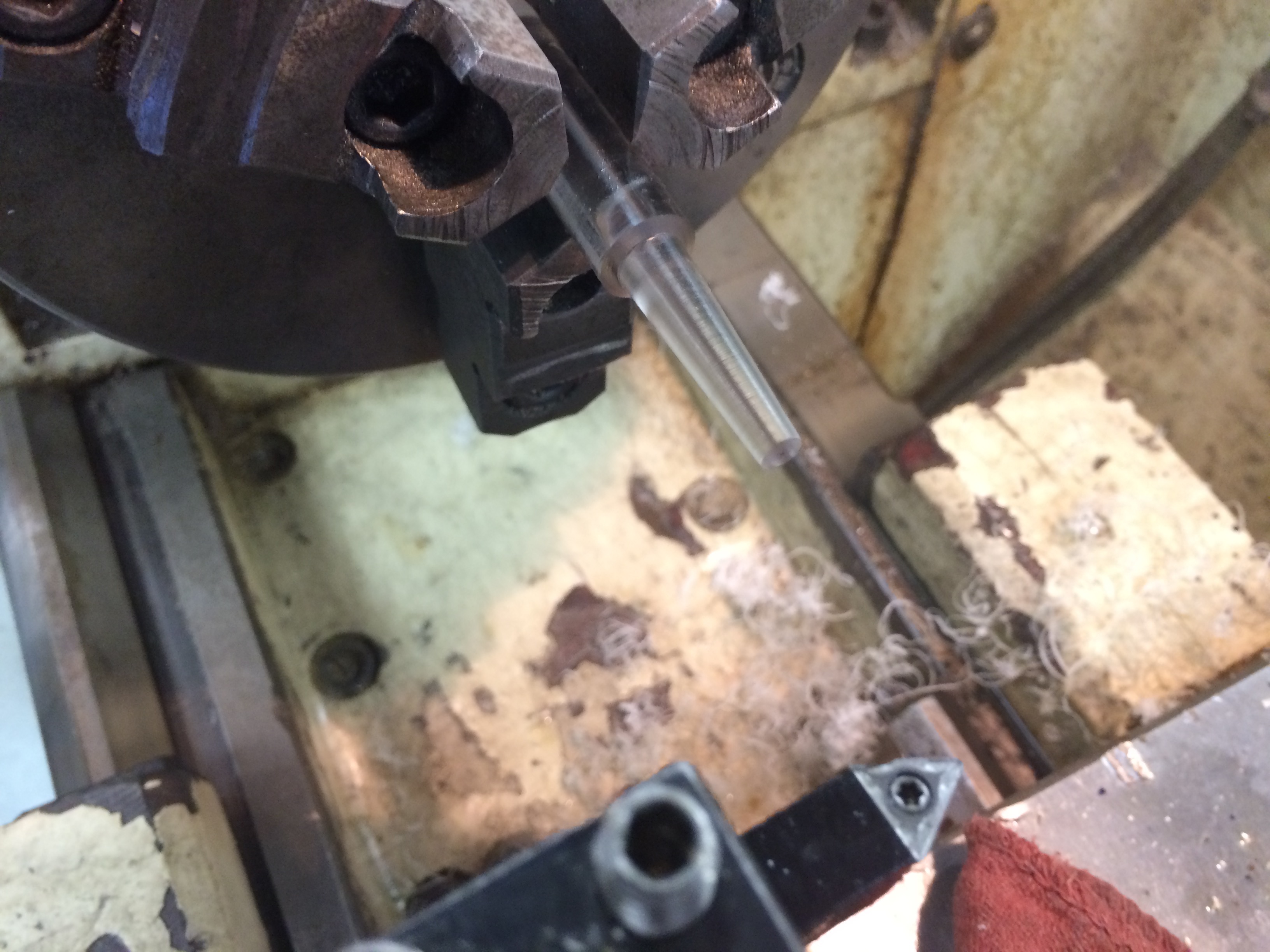

This is basically just a taper. I grabbed some of my 3/8" stock from last year and gave it a 4º taper, which seems to be just right. Basically, that gives me a 3/16" diameter at the tip, and 5/15" diameter at the back, across a taper length of just about an inch. Without taking calipers to the originals, I can say this looks best to my eye.

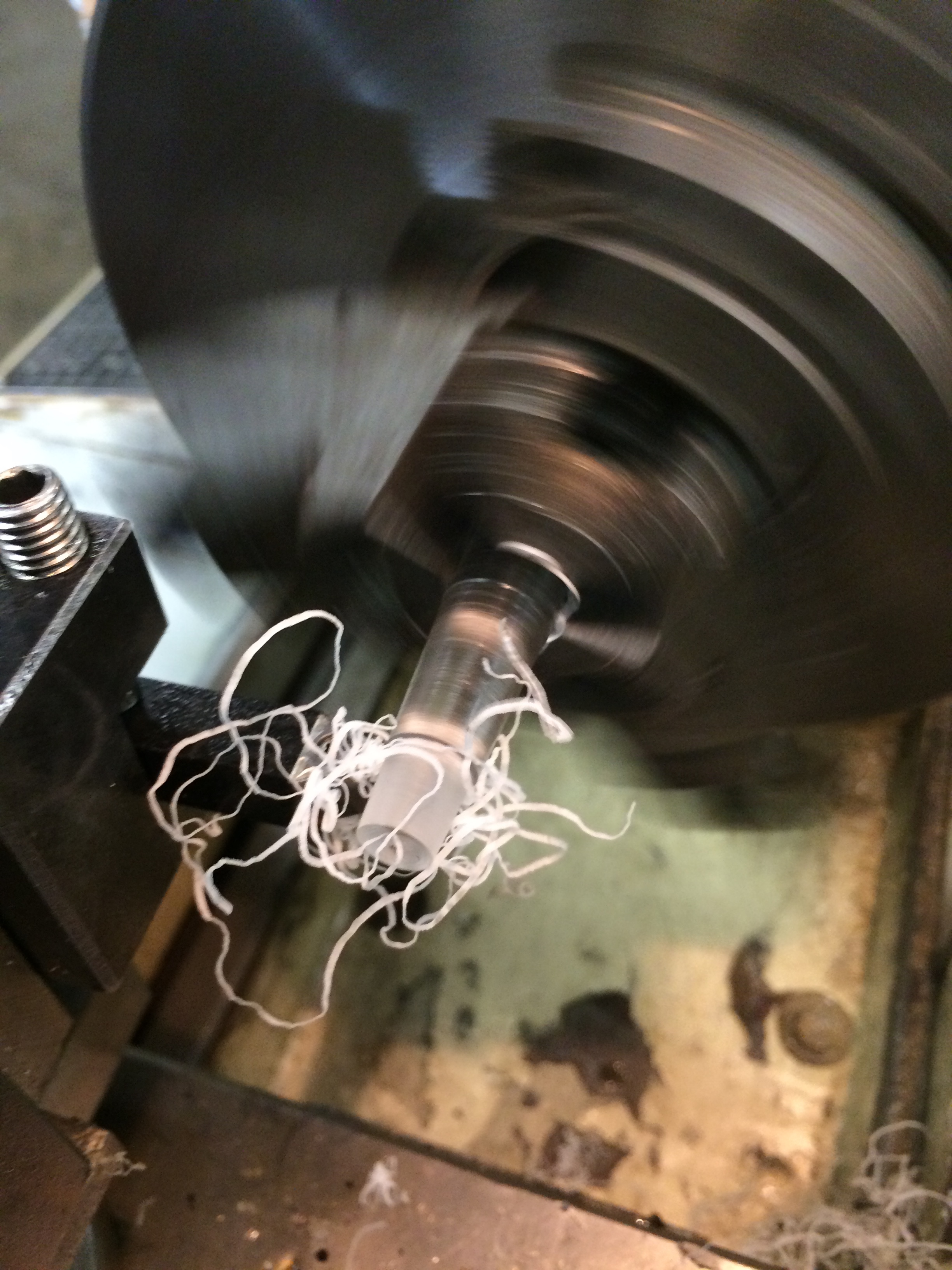

So to start, I take off material pretty aggressively, working the tool away from the chuck because I really hate it when the tool crashes into the chuck and gets destroyed. This is only around 80rpm, but at high speeds things can get kinda shrapnelly when that happens. As I've said previously about turning acrylic, use low speeds.
And here's the proofy pudding that this lathe is now wobble-free: looky them perfect chips!
Also, the taper comes out just gorgeous. No tool chatter, no cracking or shattering, just a nice, smooth, perfect taper. Note -- it looks very clear in these two pix because it's covered in cutting oil. It's actually very frosty, which gets taken care of later.

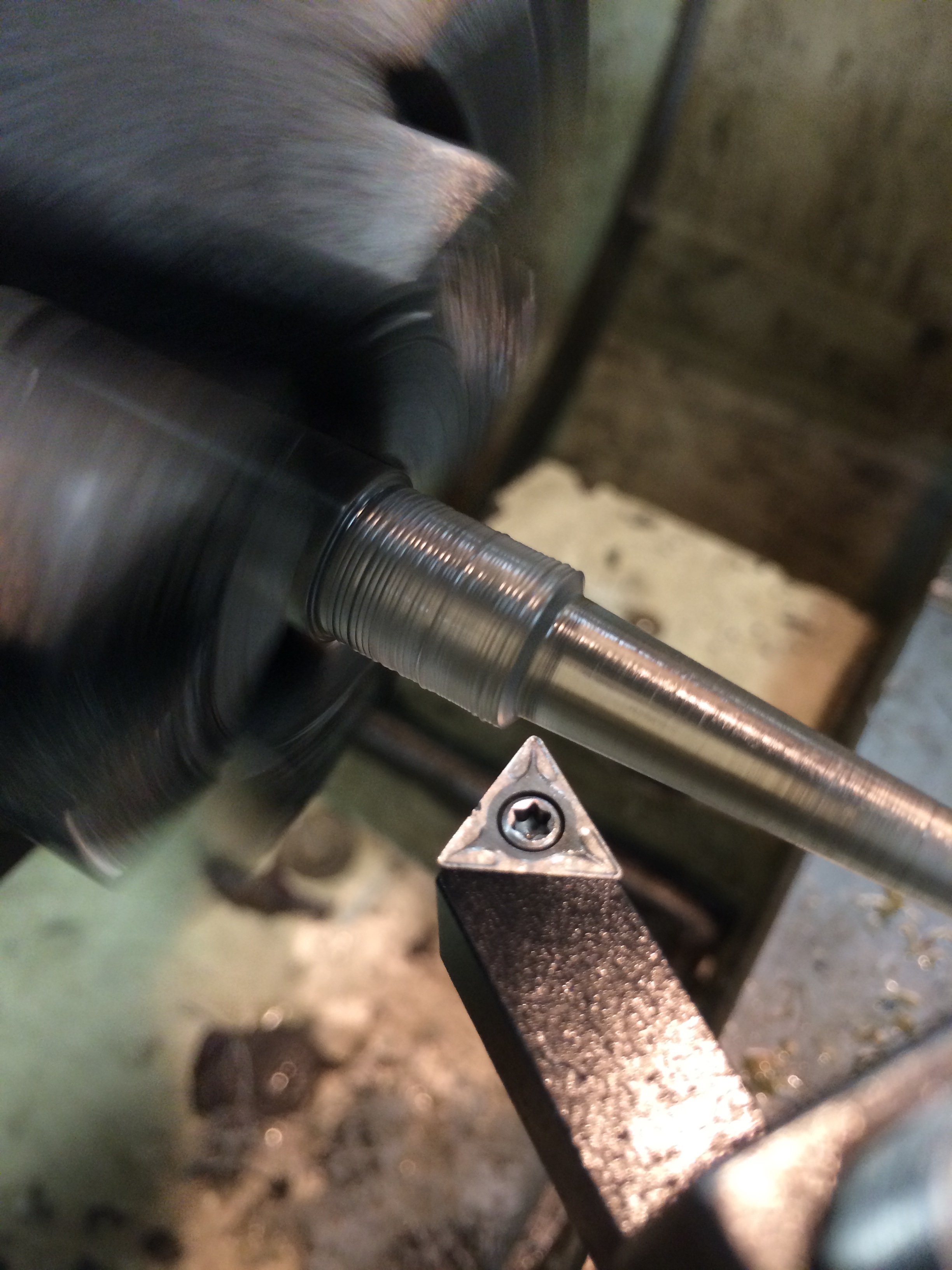

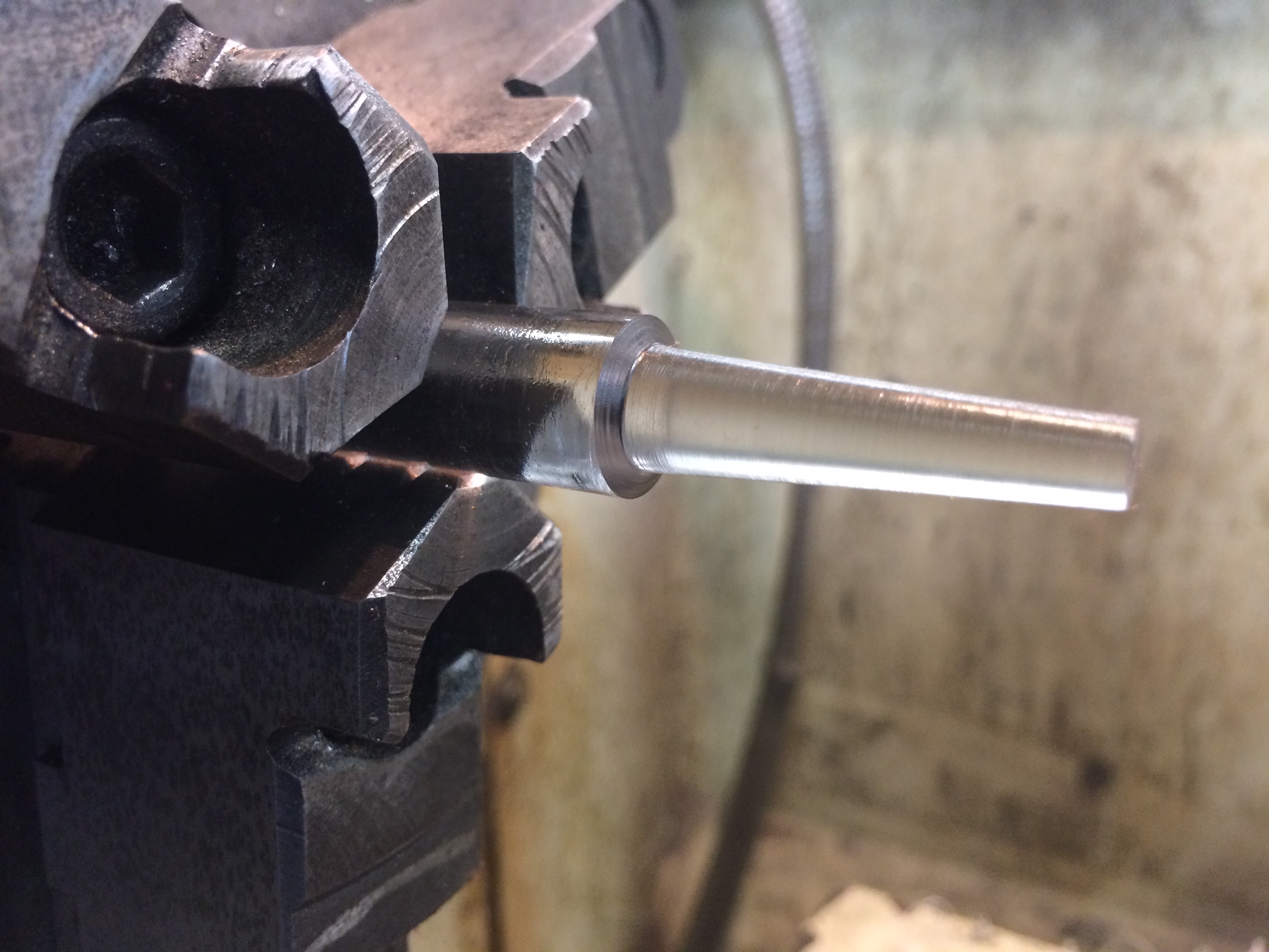

Now that I've got the taper, I turn down the back to 5/16".
Note in the first picture how rough the shaft part looks compared to the taper. That's because when you're just hogging off material, you want to move your tool faster to save time. It's only when you're doing a finish pass that you want to go really, really slow. For brass or aluminum finish passes, I'll go as slow as 0.02"/sec. Sometimes even slower -- I think the auto feed goes down to 0.0063"/sec.
(However, there's no auto feed when you're turning the taper with the compound slide, so you have to turn that gear wheel by hand. Getting that even and consistent takes practice, but you can get really sweet results that way. And it's much easier to set up -- the other two ways require very lengthy setup with additional gear and it's not worth doing unless you're turning a lot of high-quality parts.)
So I just keep turning it down till my nozzle fits nicely. That's really the easiest way to know when to stop.
And now,
LET THE SANDING BEGIN!!!!

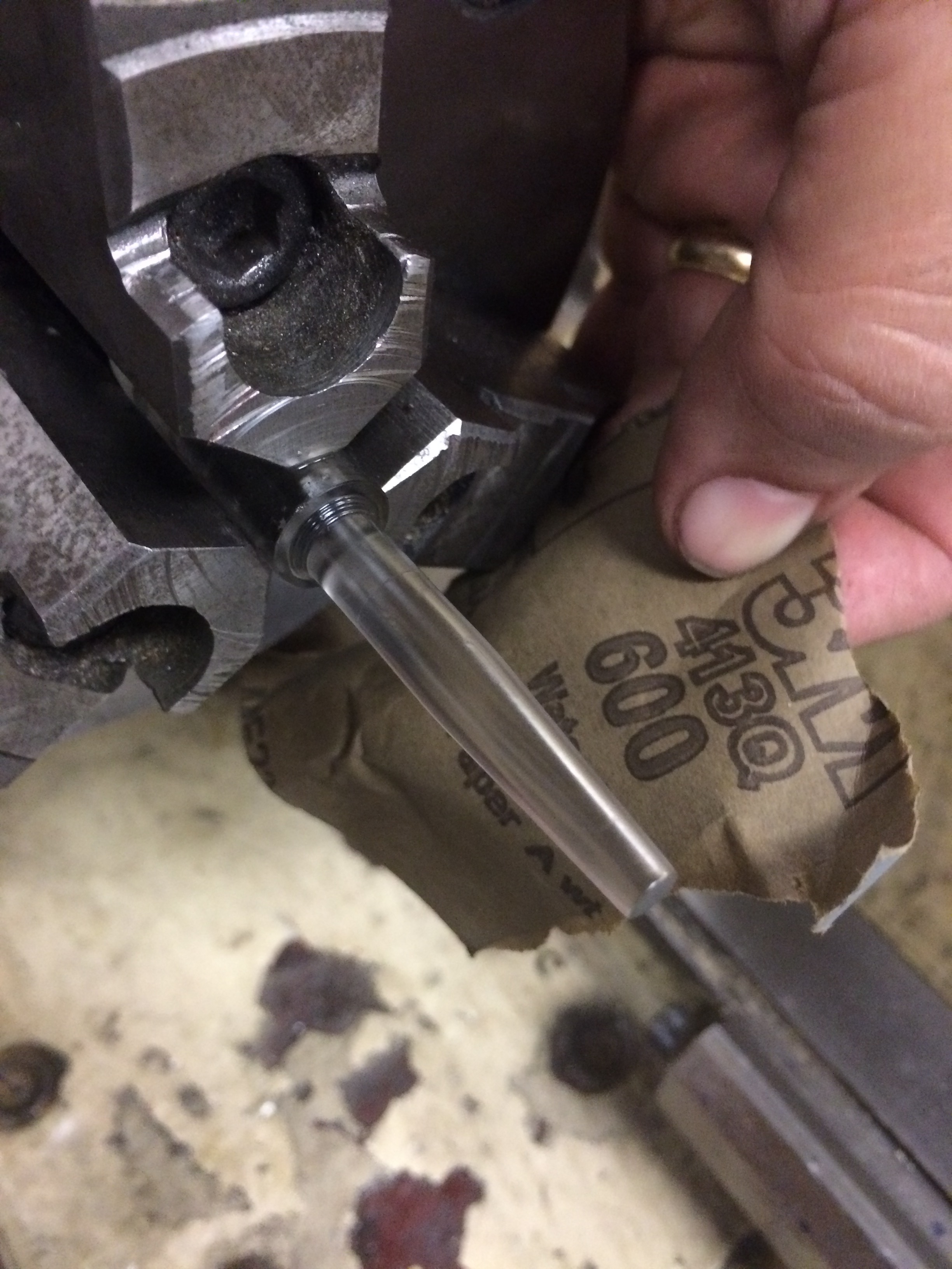

The last sheet there is 1500 grit. In the third photo, you can see I just used cutting oil for the wet sanding, and it worked very well. Also saved me walking over to the slop sink for water. :p
In retrospect, I shouldn't have started with 320. I wound up with an ever-so-slightly loose fit into the nozzle, meaning I took off too much material after I'd gotten my nice fit. Not a show-stopper by any means, but next time I'm starting with 400 wet. In this case, I think using epoxy to hold the emitter in the nozzle will more than compensate for any looseness.
In any case, I stopped sanding when I was just shy of perfectly clear. No 2000 grit, no polishing with jeweler's rouge. To my eye, that comes closest to matching the photos of the originals:

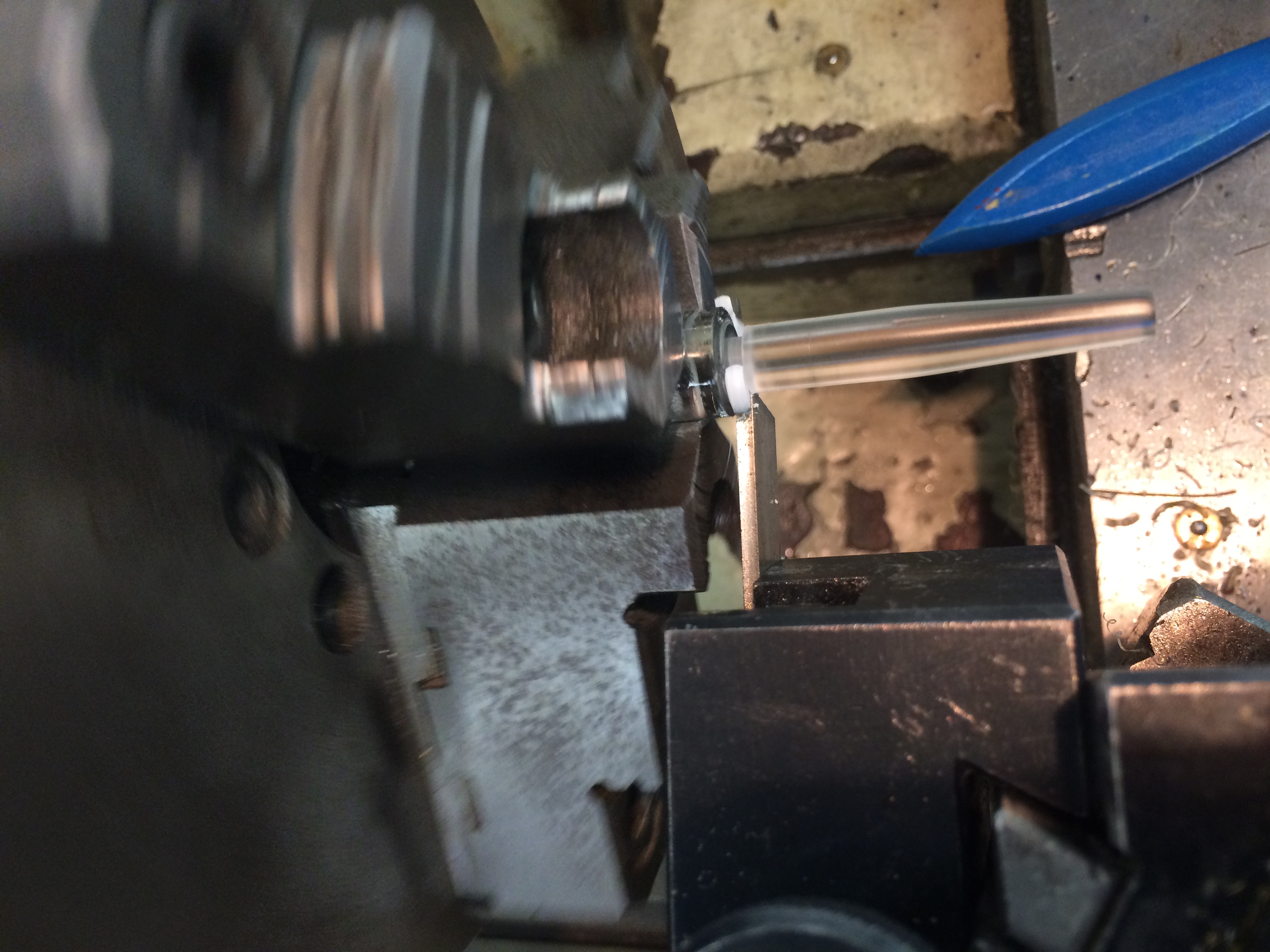

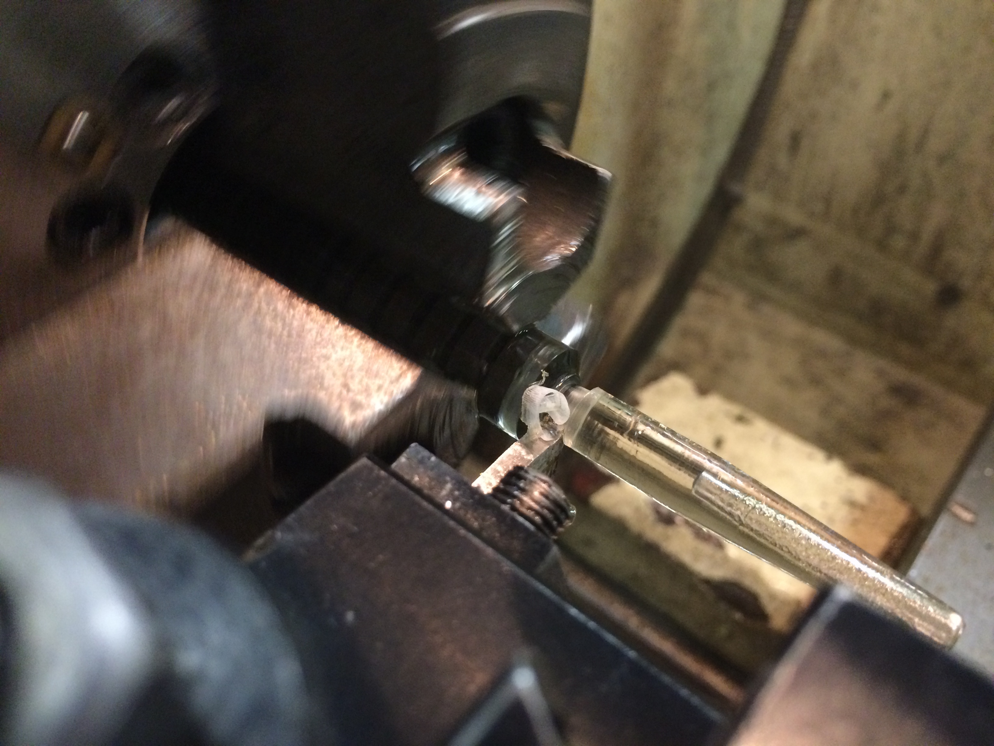

Finally, it's time for Romeo and Juliet -- parting is such sweet sorrow. Not really appropriate, but I get to show off my Shakespeare quotes. :p
Uh... anyway, here's me doing the cutty-offy thingy.

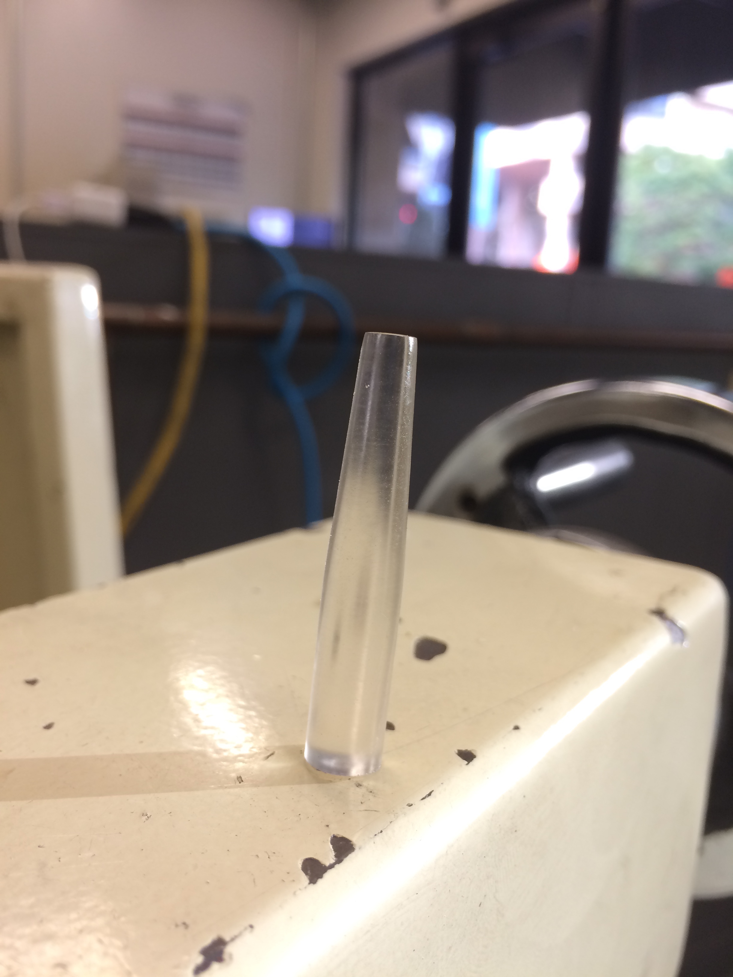

So there's one more item off the punch list! I cut it very long in the back to give myself a choice in how far out to let it protrude from the nozzle. I can go from just the tapered part (1") all the way out to ridiculous (a little over 1 1/2").
Yay!!

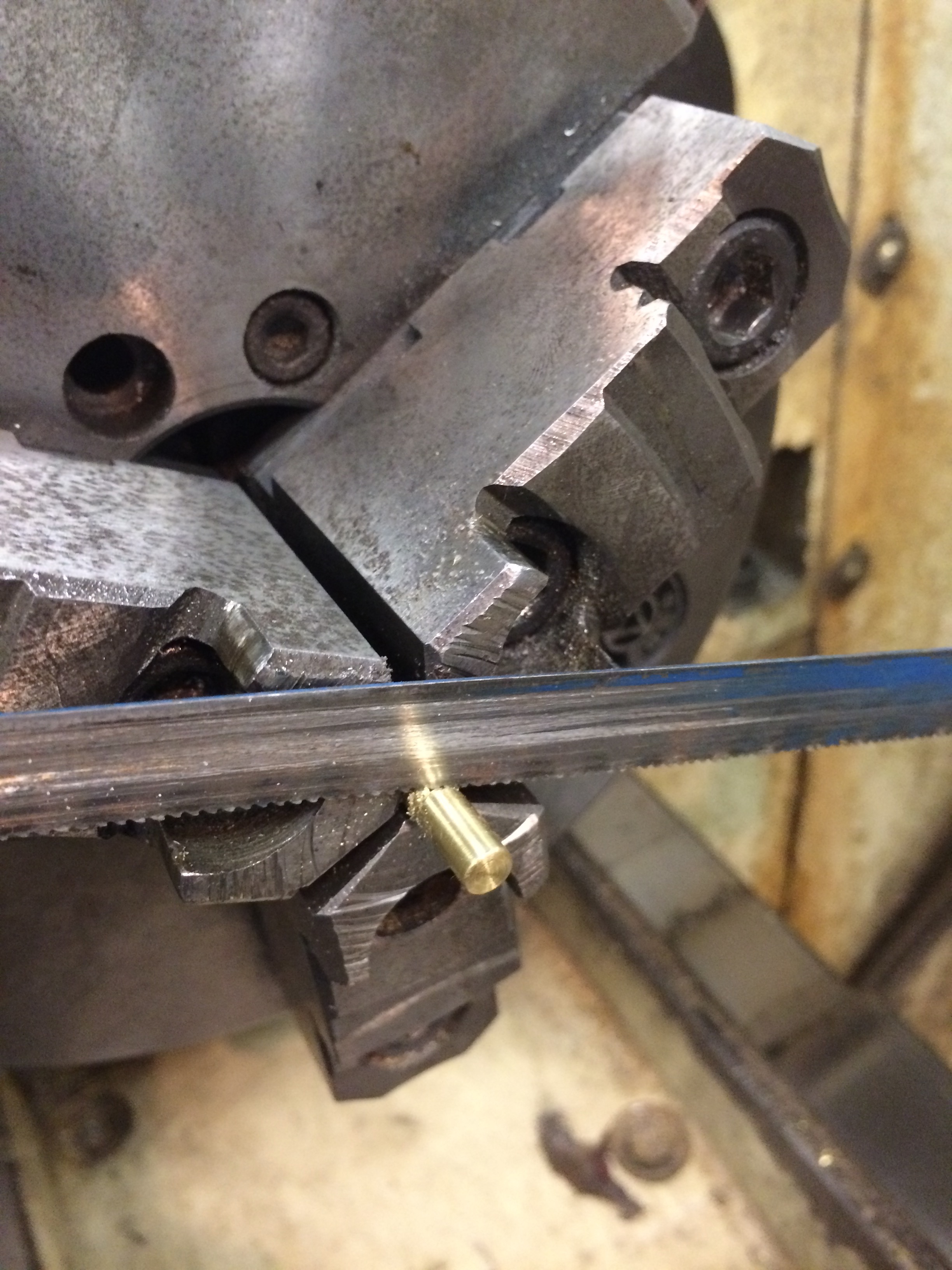

4. The midgrade brass release pin:
Not a big deal, but I'm not happy with my results here. I started with exactly 3/16" stock, because I was too tired to turn it down from anything bigger.
I've found that it's much easier to turn thin items down from fat stock, which seems counterintuitive -- after all, if your stock is already the right diameter, it's less work to finish, right? Nope. If it's a really narrow piece, say, less than 3/4", then you just can't stick it out very far from the end of the chuck, and that makes dancing your tool around it much harder.
Please, tell me more about this dancing tool of yours.
:p
The formula for allowable length from the end of the chuck gives you 4x the diameter of the stock piece without support on the other end, and sticking a live center on the end of such a tiny piece makes things more difficult. If you stick the workpiece out any farther without support, the high speed rotation starts to distort the shape of the stock, and you can end up with anything from garbage to serious injury.
For the emitter piece above, I could stick out much farther than 4x the diameter because (1) the taper removes material from the end, making it lighter than the rest of the stock and thus safer to turn farther out; and (2) I was going at relatively low speeds -- 80rpm or so for the taper, and 230rpm or so for the sanding.
So tonight, I'm going to turn it down from some 5/8" rod stock I have on hand, and I'm sure I'll have a much better time with it. As it is, the parting tool just kept ruining my piece, so I had to saw it off. It'll do just fine since only the last 3/16" or so sticks out from the pistol body, but I'm gonna turn a couple more in case I make other midgrades or for trades.

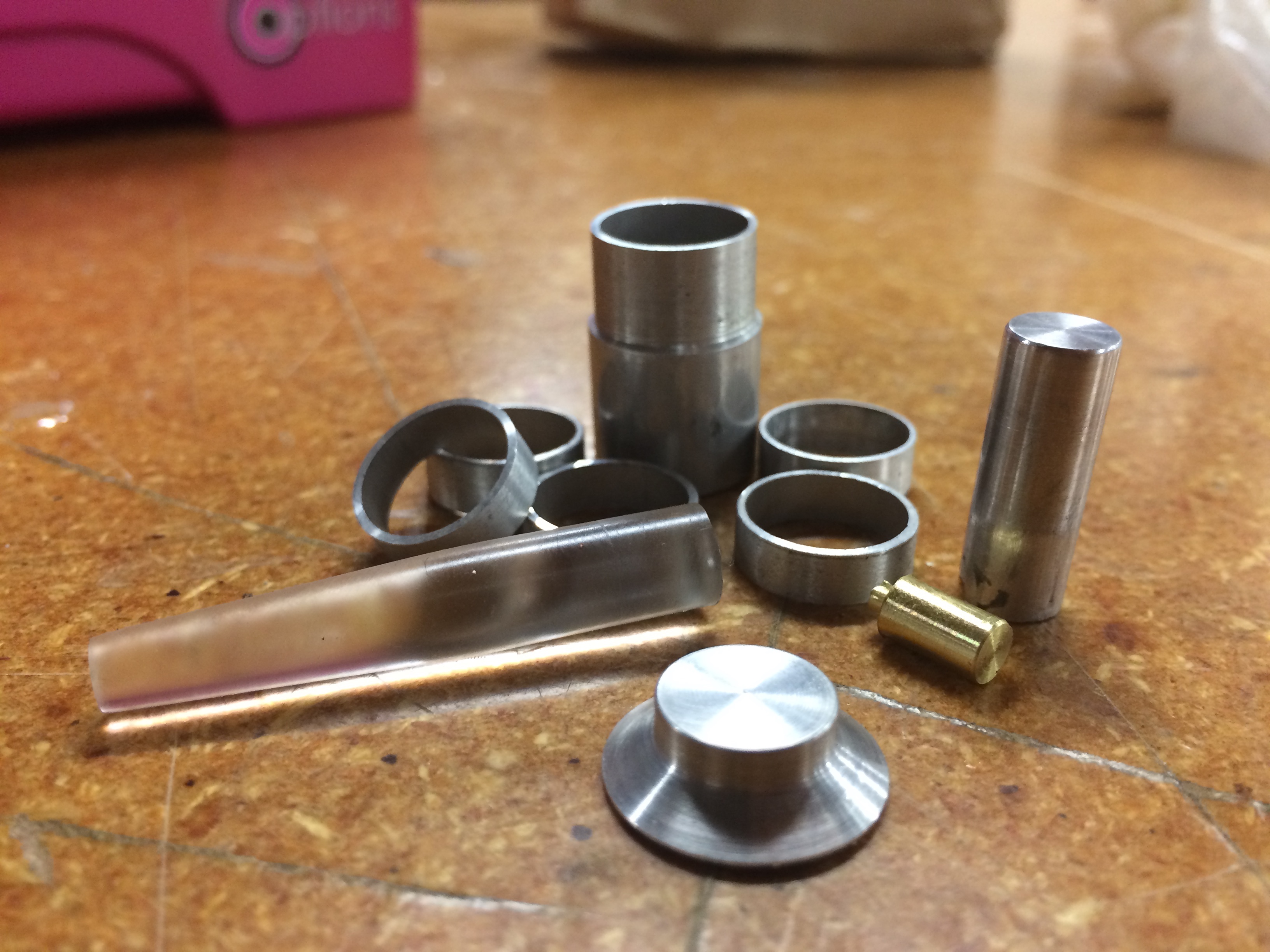

So that wraps up the wrapup! Here's the result of my last two days' labors:
Not bad if I do say so myself! And I do. Because massive ego. :p

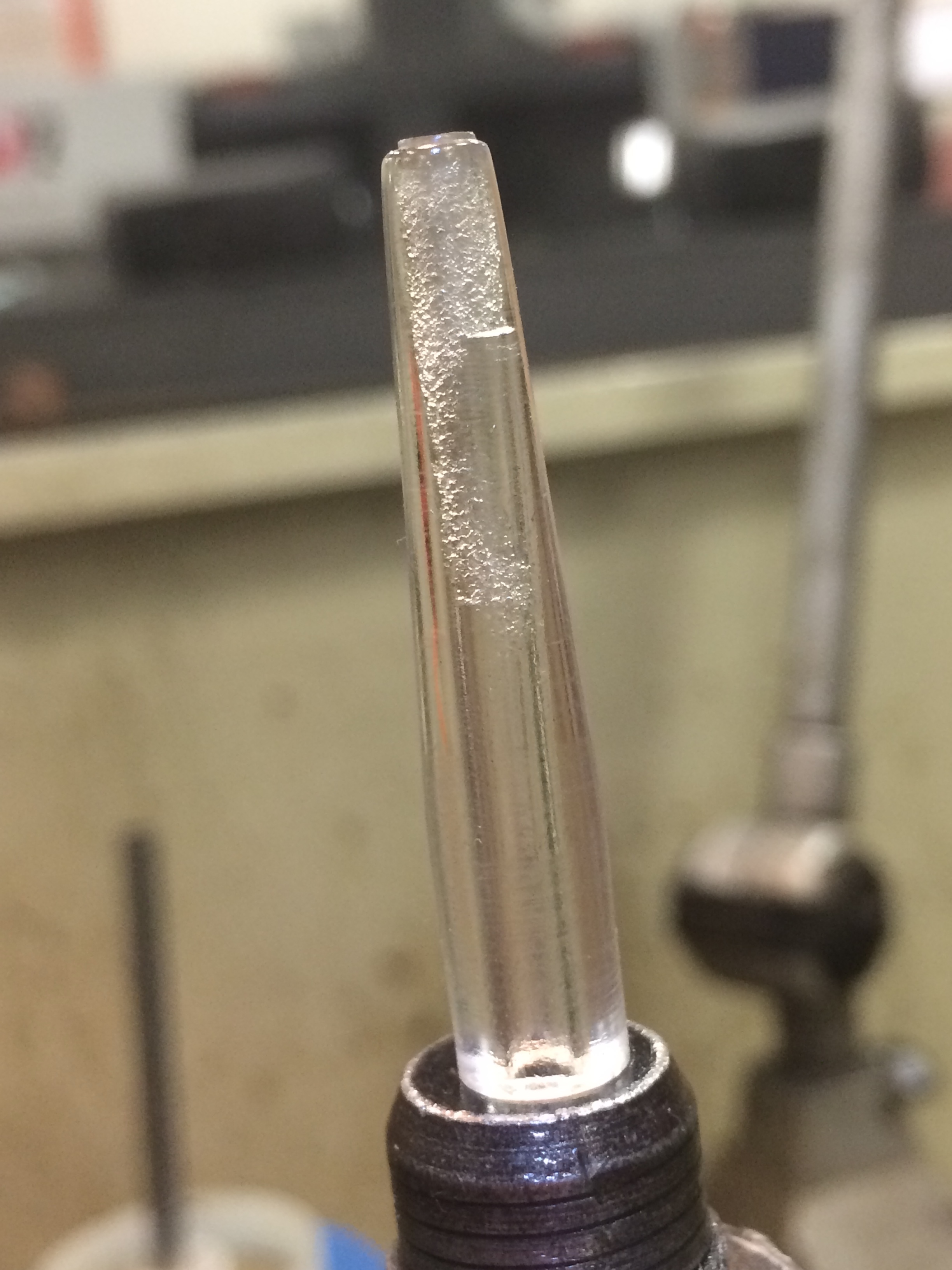

Turned out a decent hero emitter last night (Tuesday), but my drilling didn't center properly. I don't think the lathe still has any wobble, because the outside is turning so beautifully. I think I may have turned too fast at some point and slightly distorted the emitter. At any rate, rather than try to dial it in forever, I'm just going to turn the outside on the lathe, mark my centers for drilling, then make the actual holes on the mill. It's dead vertical, and goes all the way down to 60 rpm. The drill press only goes as slow as 150, and that's still fast enough to overheat the plastic. Pix & details later today if I get up in time, tomorrow if not (gotta be back on the lathe at 3:30pm). All in all, though, a great day. :)

And we'll take the tapering as read, since I didn't do anything different from the last post.

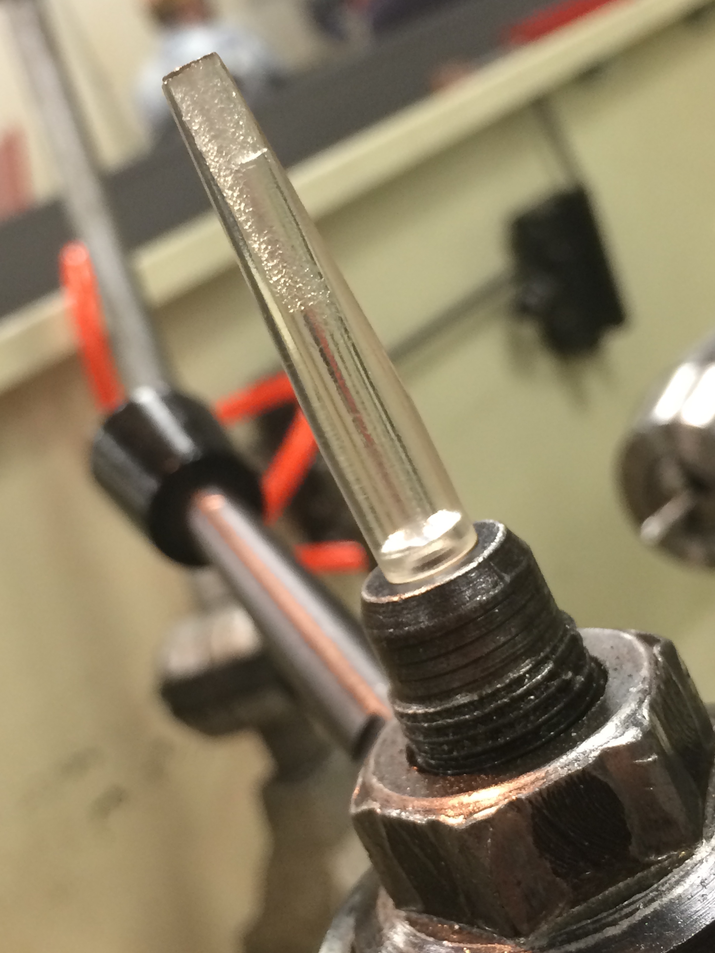

And then I did all the sanding up to 2000 grit wet (again just using the oil, which BTW is Tap Magic).

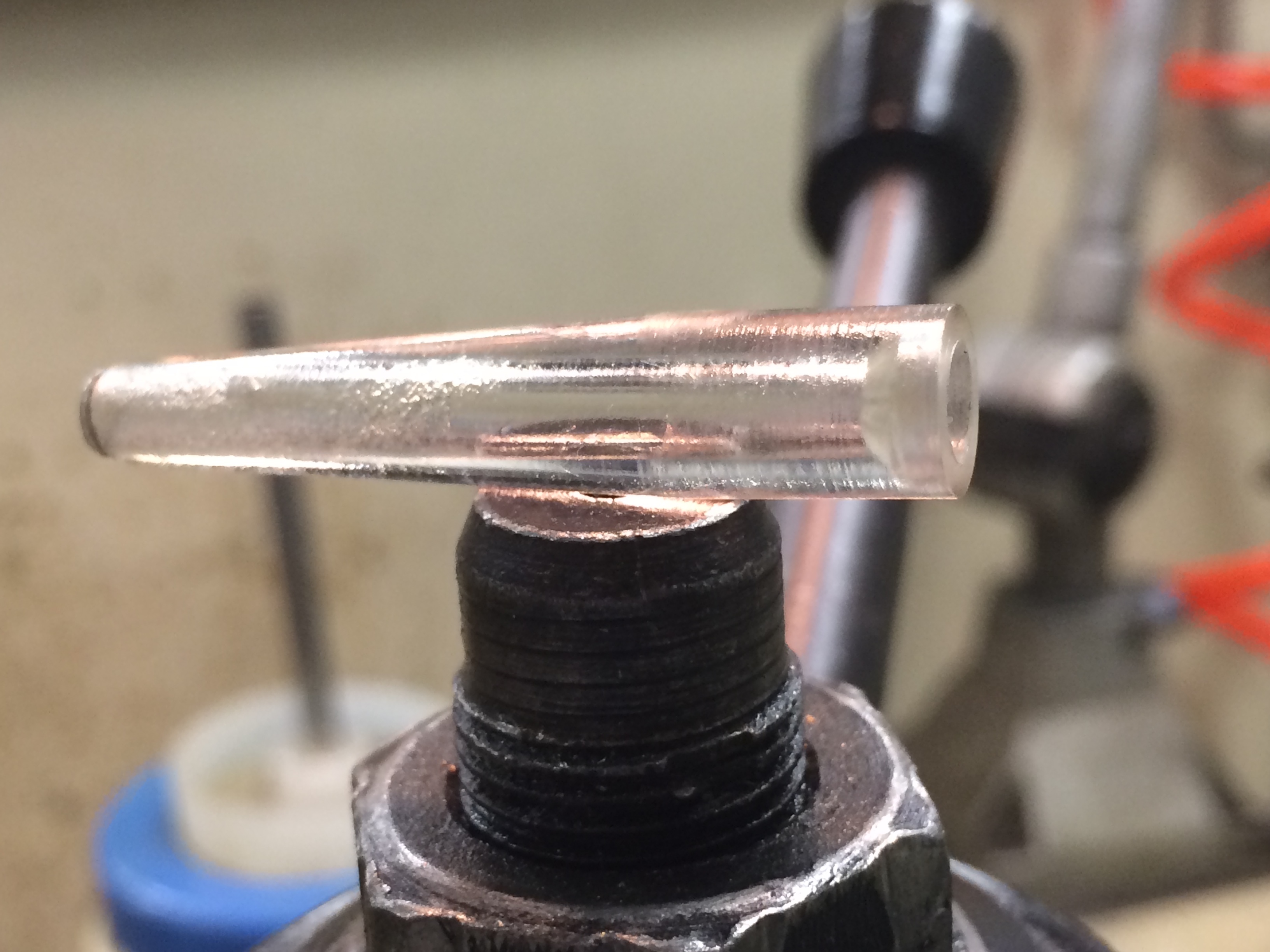

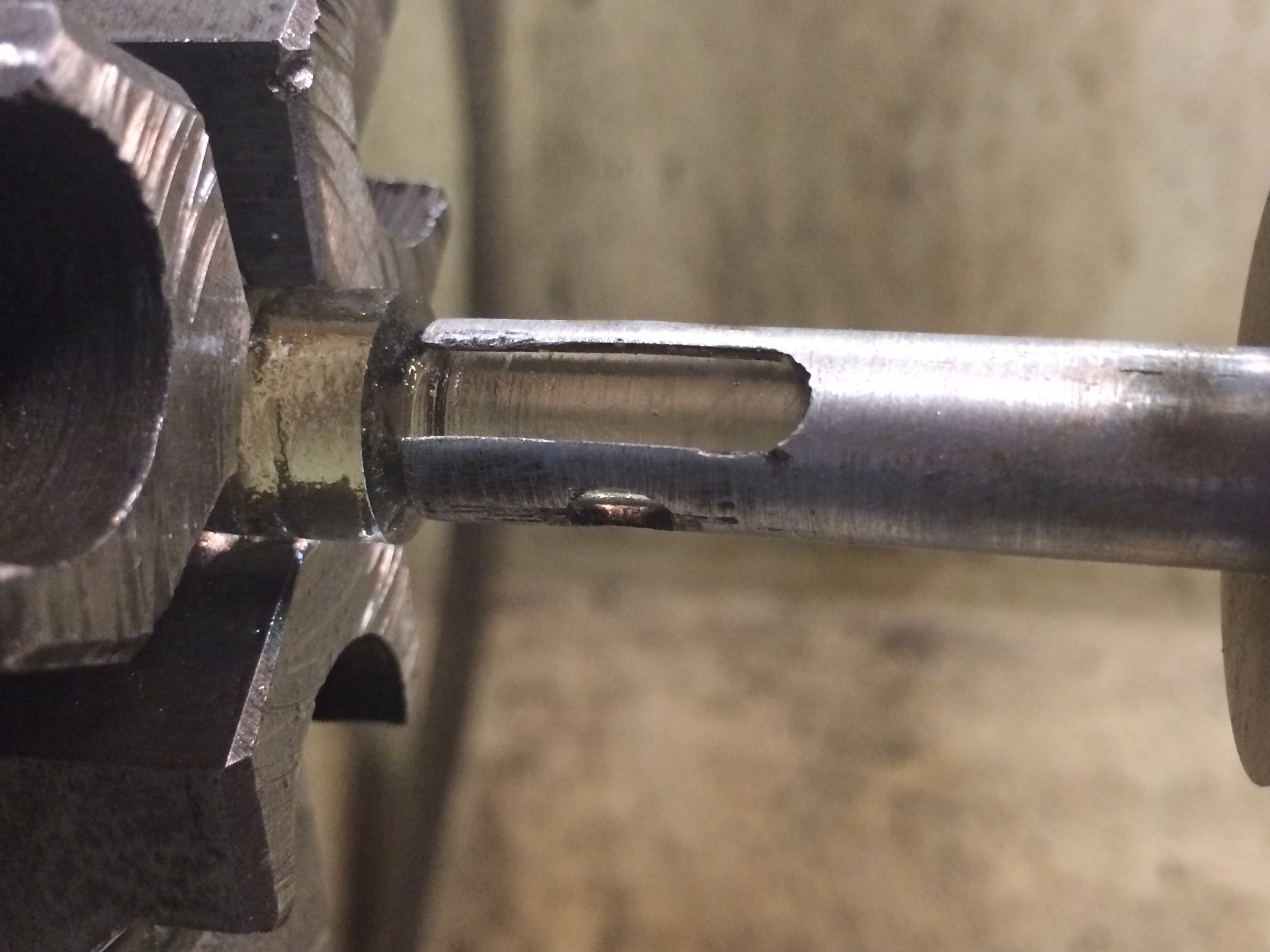

Then the drilling, which is where I went a little astray...
The sort of grainy appearance is caused by turning too fast during the drilling. The plastic overheats and actually melts, though at this point I hadn't realized it. All I could see was that the plastic around the drill point took on a white, foamy appearance, but I hadn't connected the dots yet. I finally figured it out when I pulled out from my last plunge, and instead of regular clear chips coming out, I got brittle, white sticks. The chips had fused together in the heat, and crapped up the inside wall.
But I'm not gonna learn enough if I just quit now, so I turned down the base till it properly fit my JL nozzle. Guess what -- his inside diameter is also 5/16". I'm sensing a pattern...
And at this point, I'm praying nothing breaks. Also saying several Hail Marys. For real.
Yay!

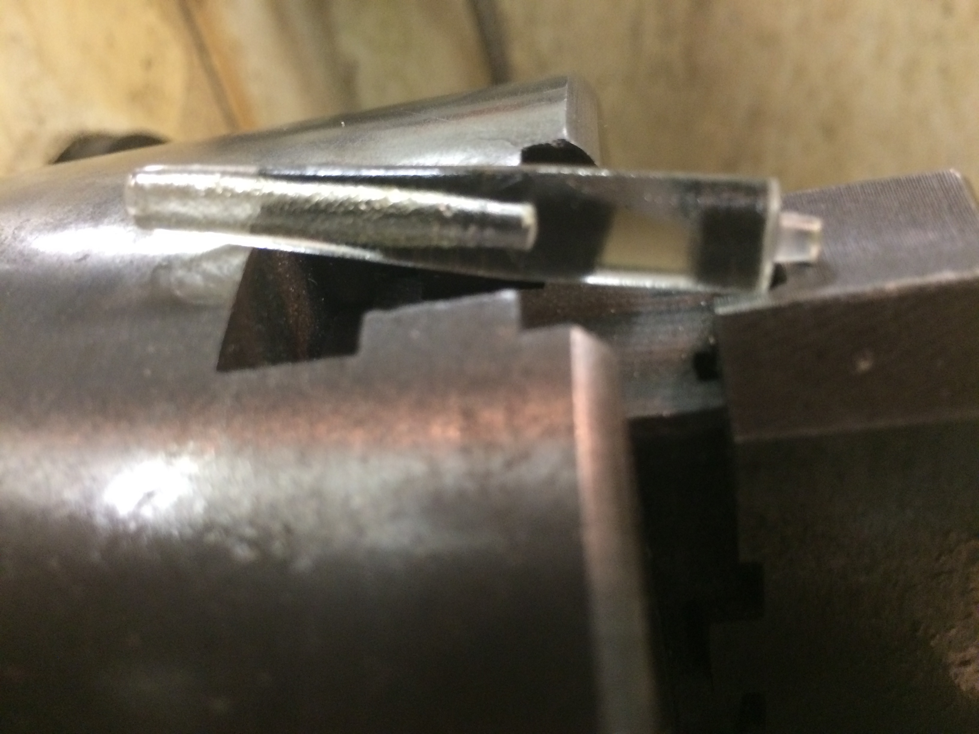

Now I chuck it in facing the other way, and part off that little nubbin on the end.
So now I decided two things: First, I was gonna slow my turns WAY down for drilling. Second, I decided to plunge my center drill farther in than necessary just to start my drill point, so that the little 3mm GOW bulb can slip in a little more easily.
At this point, the drilling went perfectly, except for the line-up issue due to whatever bending or wobbling happened during turning. Not exactly the Chunnel project, but it worked.
See the difference? Crappy at the front, where I turned too fast, crystal-clear in back, where I slowed way down. So I've definitely solved that problem, and my next attempt should come out great. As I said last post, I'll just turn and part on the lathe, and drill my holes on the mill, rather than try to figure out exactly where and how I'm getting a wobble or distortion. My best theory is that when I overheated the front end, I maybe bent the end of the emitter, and the straightness of the rear hole (till it meets the front one) seems to back that up.
