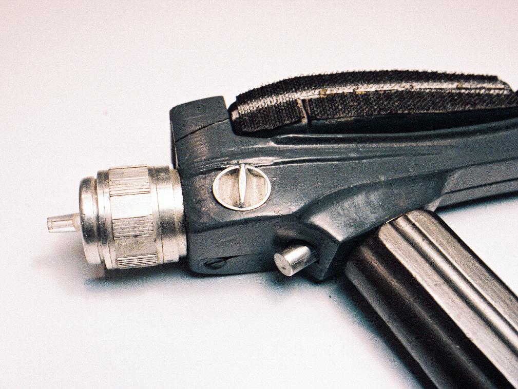

So, remember this series of photos from Gerald Gurian's Star Trek Prop Authority site? In particular, I saw this one some time back and thought it might show that the side dial was not a milled rod, but instead a butterfly-cut strip of aluminum:
I was focused on that little black dot on the bottom of the center tab, which I read as a triangular opening, meaning this was a strip of aluminum flayed in two. Most people disagreed, and there was further discussion about whether it was a piece of dirt or some other detritus. Since it was very hard to tell due to the low resolution of the photo, I dropped the whole idea pending further information and really forgot all about it.
Until last night!
A few months ago, I tripped over a thread on HobbyTalk about some of Bill George's Imgur links (yes, that Bill George). The main topic was his K'Tinga photos, but there was a list of other links, including what it turns out were his phaser photos in much higher resolution.
Not gonna belabor this except to say that as of last night (when I finally got around to looking at them closely), I am now absolutely satisfied that it is indeed a split strip of aluminum and not a milled rod. Ten minutes in Photoshop later:
Enjoy!!
(Oh, one thing -- please don't go around using words like "conclusive proof," "definitive," "forensic," or "toe jam." :p This is my interpretation of a photo, and I find it very convincing, but I'm not a photo analyst. Just an obsessive-compulsive prop nerd.)
The good news (and another check in the Pro column) is that this makes it massively simpler to produce this piece. Yay! :)

...I'm not a photo analyst...
Analyze this.
Click to make yuge.
It looks like a small dot or hole, perfectly round or nearly so. The "wedge" shape appears to be some schmutz right below the dot.
