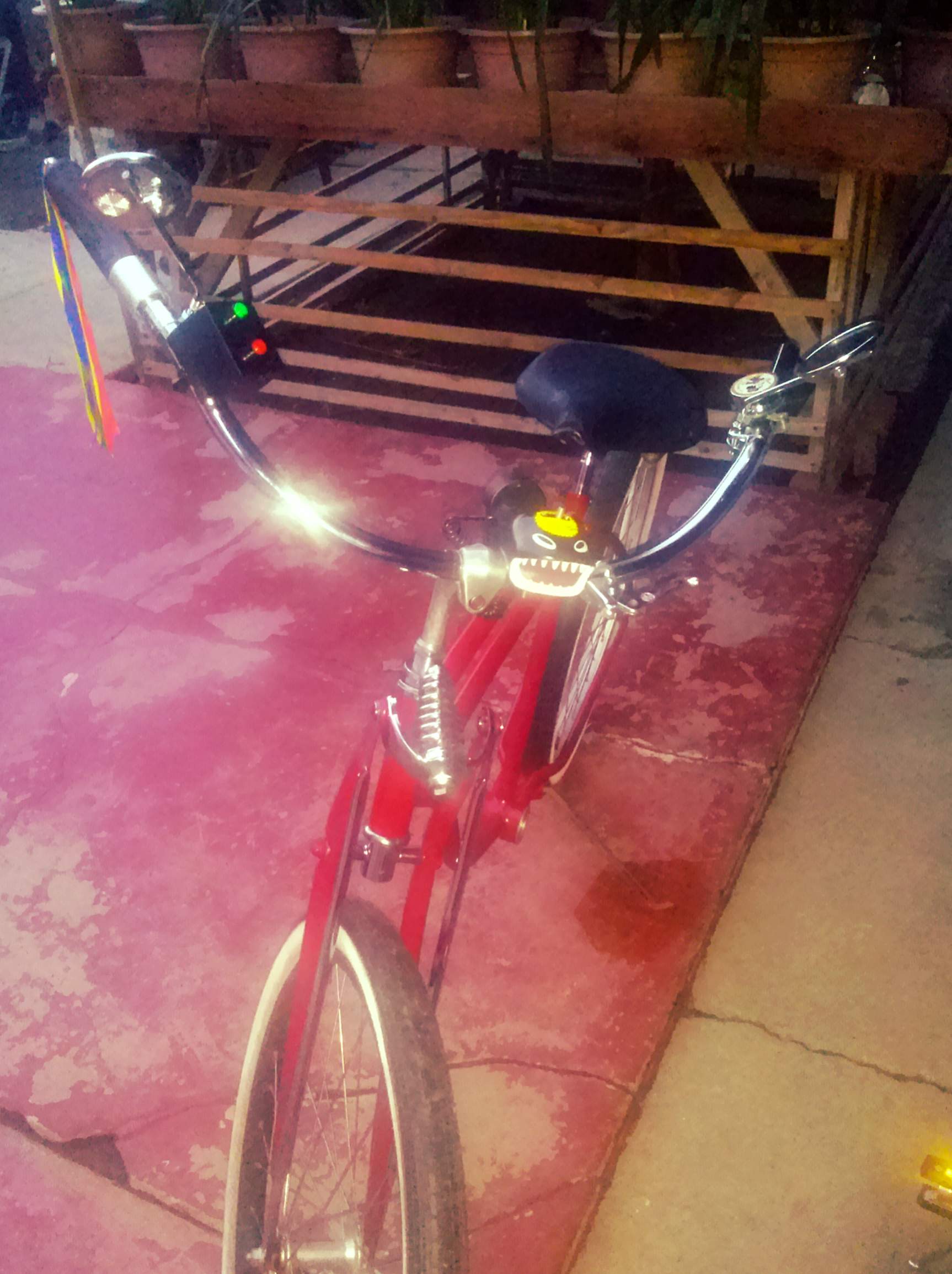

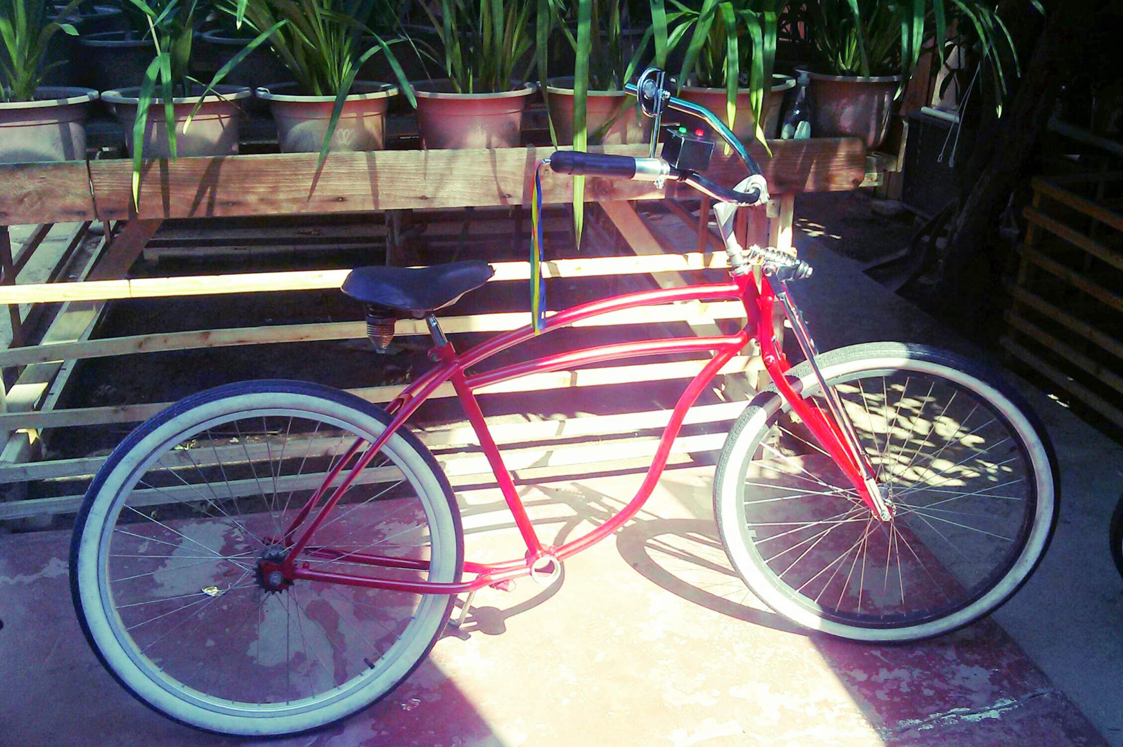

its officially been 1 month. Here is an update from the last two days. I was able to put my bike together. I'm rocking some typhoon tires for now. I still need to find a shimano shifter and some fenders.
Aviary Photo_130208402293611056.jpgAviary Photo_130208403822530264.jpgAviary Photo_130208405295587494.jpgAviary Photo_130208406240130651.jpg
