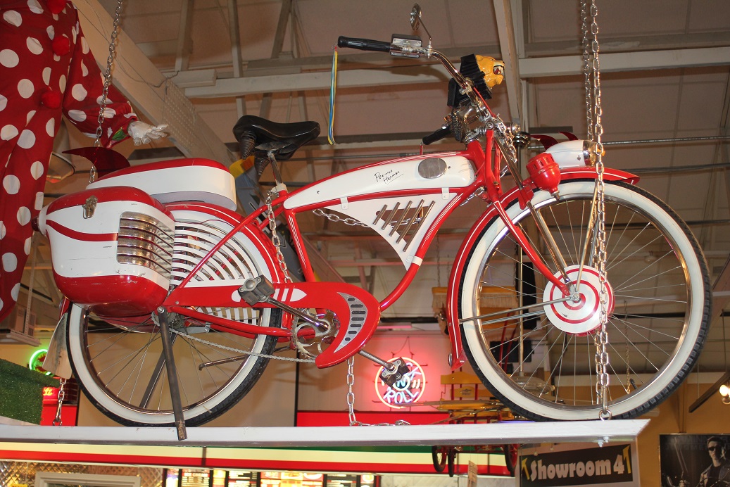

Hi guys, I'm not building a bike, but I saw this at a museum last month and thought it might be good for reference. :):cheers
attachment.php
What museum is that? Did you get any more photos?
Off-topic: I stumbled on that photo recently while looking for info on the animated clown. I've found a few owners online (incl. a store in Louisville that has one on display), but can't seem to find any info on who produced these. The stock outfit seems to be yellow/green/red, which you can see peeking out of his sleeve in your photo.

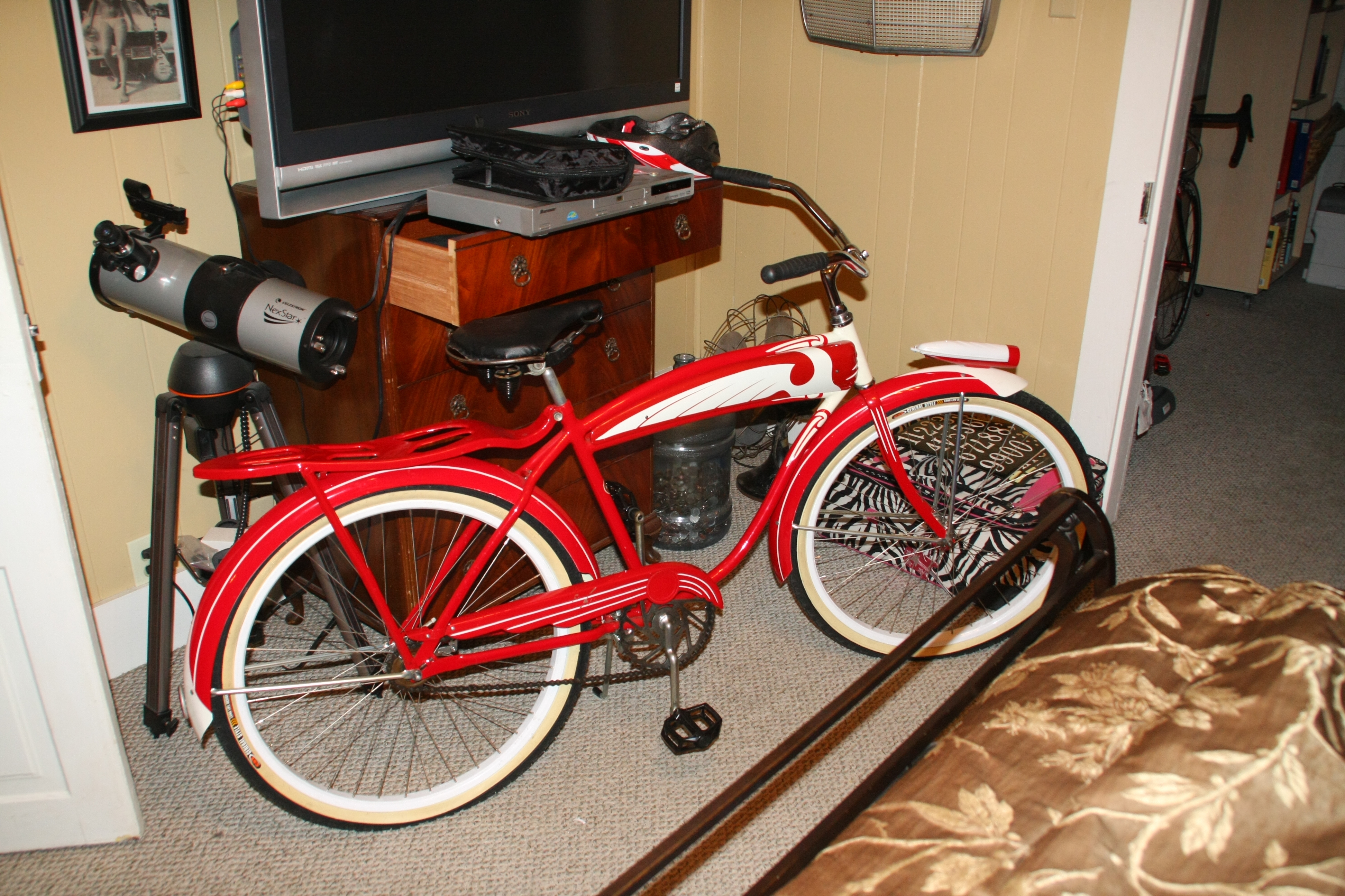

Here is my starter bike. It is a prewar bike. I will be pretty much needing everything. I have so far:
Compass
Donkey dicks
Messinger saddle
I am proficient at fab work and bike restoration. I have IM'd a couple of you nice folks out there to help me with chainguards, saddlebags and frame section cutouts. Seems like a wealth of info and nice people here. Look forward to talking to you all. Where do I get the elusive tiger siren?? Thanks
Great looking bike!
