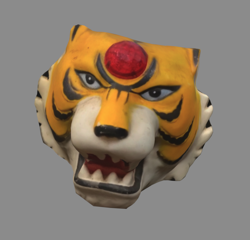

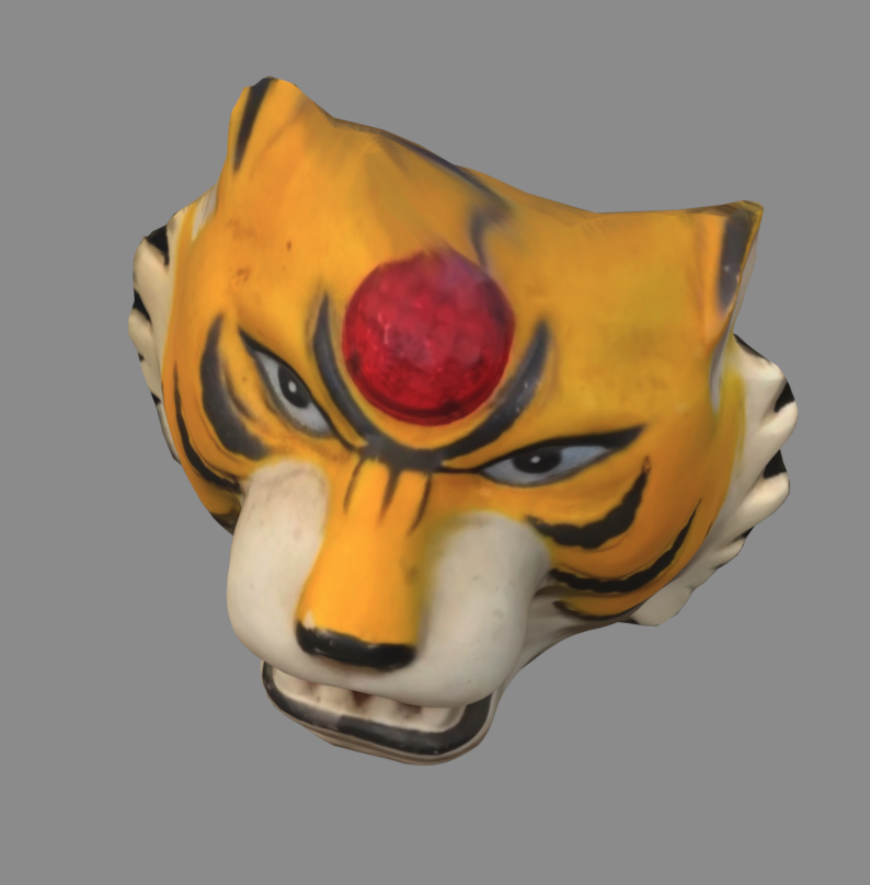

I've started a new method for creating the tiger head. I'm actually surprised it's working as well as it is so far, but basically, I download a video of someone with the tiger head, scrub through it taking multiple screenshots per angle, then matte out the background (mostly by hand) and run it through photogrammetry software. This was created using just 40 photos, I still have about 100 to go but I am making good progress. Much better and more precise than my attempts to model by hand or with clay. The next best thing (besides actually owning one..) would be taking a trip to one of the museums and using the TrueDepth camera on the iPhone to take some scans of the real deal.
