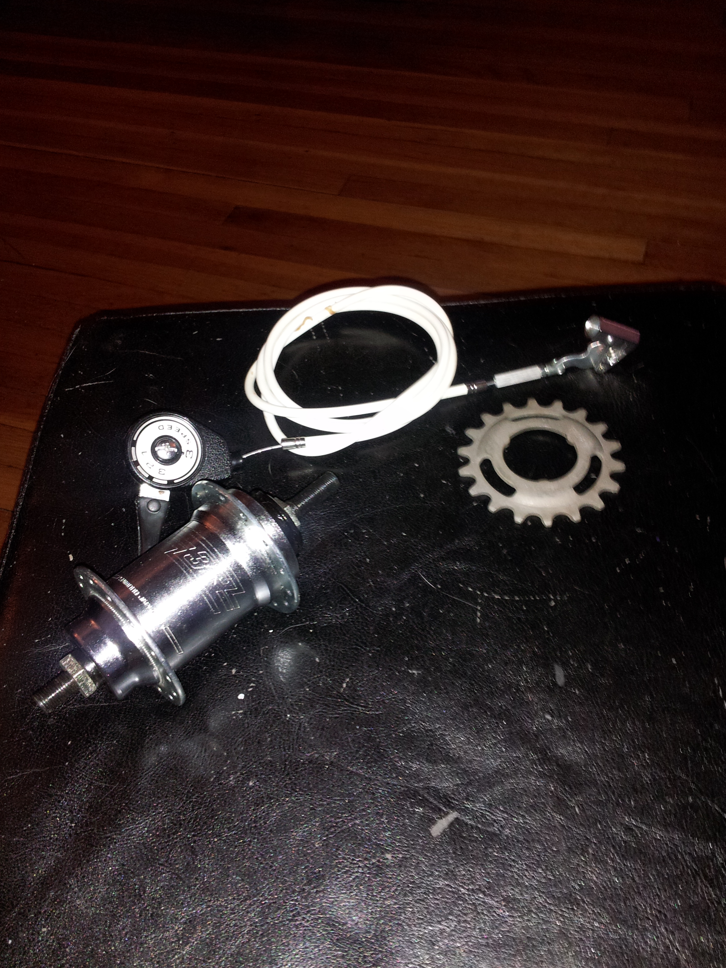

Well, now I have a 3 speed hub and a shifter. What I don't have is any idea nor instructions on assembly. I've seen diagrams, but they don't seem to show what to do with some parts in the box. Does anyone know how this is assembled? It says 3S on the housing.
if your gonna lace a wheel as well, you might want to have a bike shop do it.
basically you have a hub, sprocket and hardware and shifter.
if its a coaster brake, kind of see the arm. the small bolt and strap go on the arm. the sprocket goes on the other side, sometimes there is a ring, that is a dust cover then the sprocket, then a large c-clip gets snapped in.
Sometimes you need sprockets with more or less teeth to make the ratio of the gear work with the front sprocket correctly, otherwise your 3 speed is not working to help you.
If you have a rear wheel already you may be able to reuse the spokes, what wheel lacing videos on yooutube, get a spoke wrench, go to it.
I would take it to a bike shop, like Abe said. If you want to do it yourself, you can, but there are a few issues. The main issue is the spokes, your current spokes may not be the right length with the new hub. At the very least, bring in your rim and the hub, and tell them you need spokes made for a three cross lace pattern. Get stainless spokes. Then you can lace the wheel, you'll have to true it so it's straight and round, and then run the cabling for the shifter.
Lacing isn't that hard, I did it myself after reading up on it and watching some videos. Truing is a bit harder, and that back wheel needs to be really straight with the skirt guards back there.

I think I've got the basic assembly for the hardware on the hub, and later I'll go to pick up a spoke wrench.
But before that, I've still got some pieces I'm unclear about.

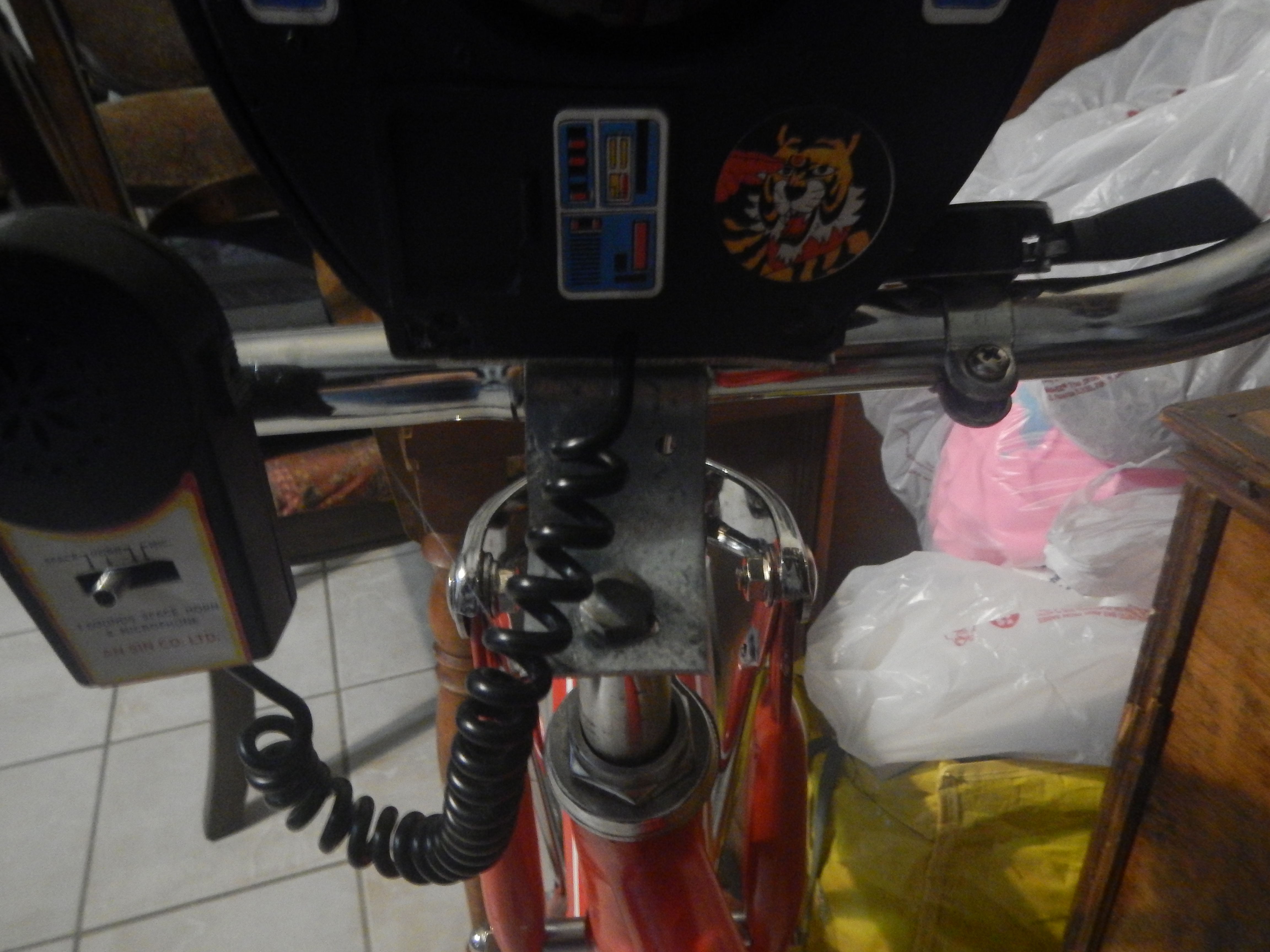

Anyways I finished my new tiger siren mount. Like Rudd I went looking for the fattest, mallable piece of metal I could find and used a vice and hammer to bend it to shape.
Next step is to paint the bracket black.
