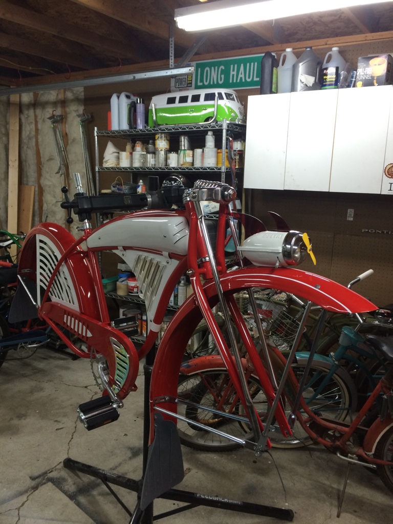

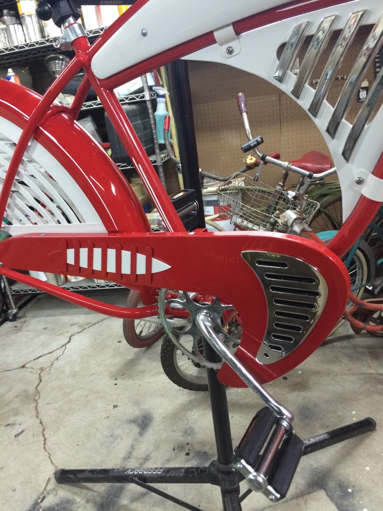

pee-wee.jpgHi guys- been a while since i posted. I had some house issues at the beginning of the year and didnt feel like posting for a bit. Lets just say i dont have an ipad anymore:(. As i work out these issues. Im just glad i still have my bike. Make sure guys to write down the serial numbers to your bikes and photo them. In fact i been looking for gps locators that work on bikes lately.
I think Ryan hit it on the head with this project. Just wait it out and get the correct parts from the get go. I have pm'd a few people about the correct springer. You can get the 1995 schwinn cruiser springer and be set. Those have closest look for the money.

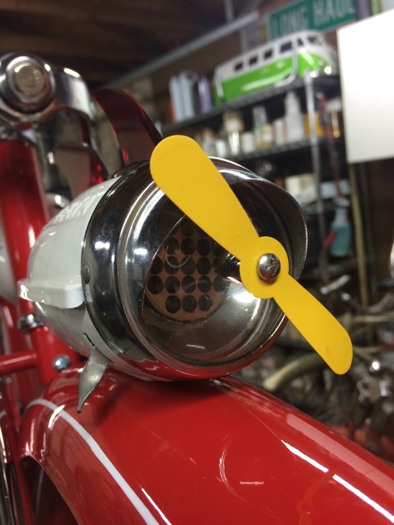

As far as that siren. I would just hold out for the correct persons siren. I have a few non working ones if anyone needs one.

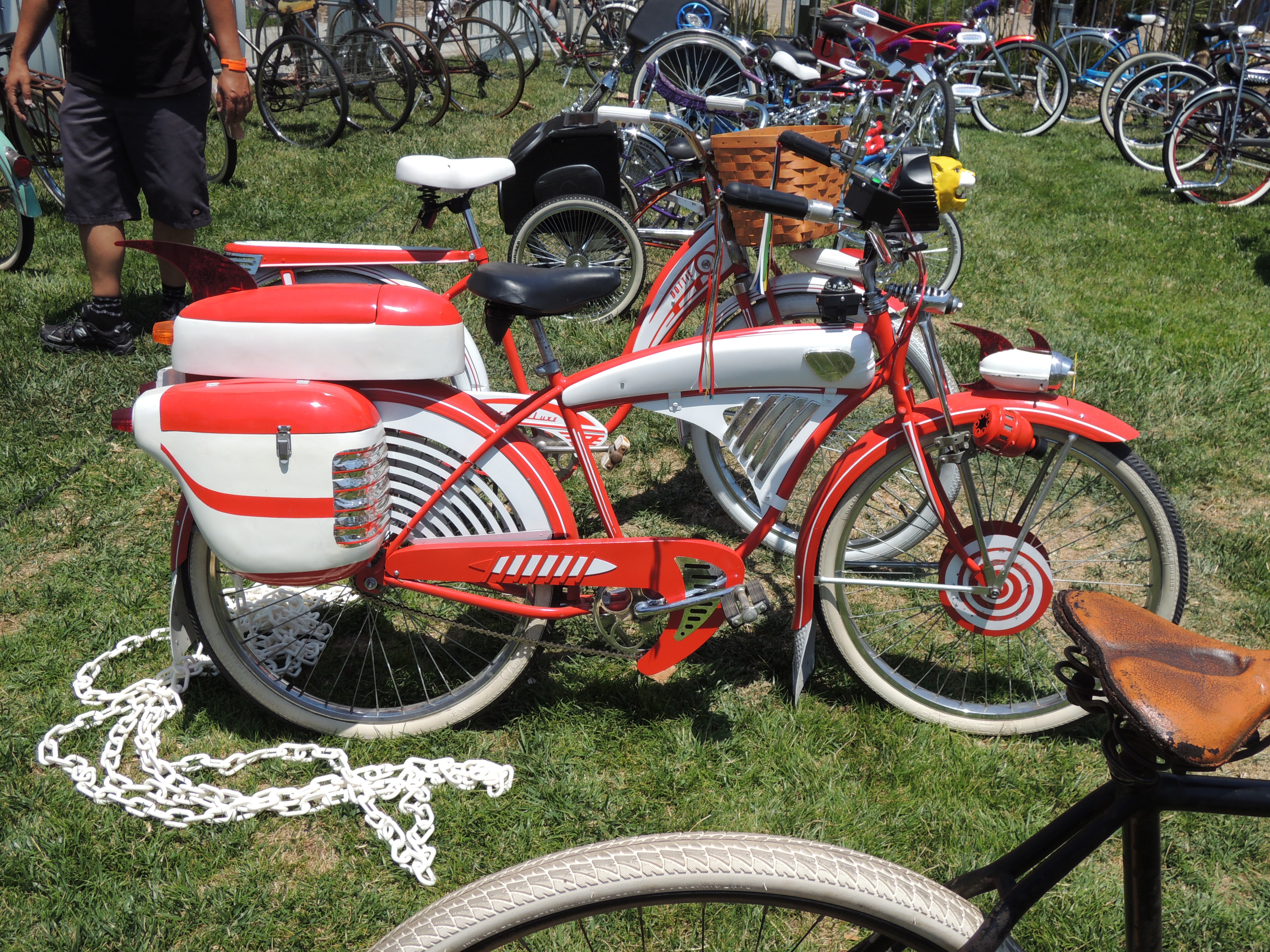

As far as the chain goes i ended finding a great deal on 100ft of mr chain white plastic chain. It seems about 50 ft is all you can really get into one bag. It weighs a lot. We discussed this and think the movie stuff was white chain painted silver. I only have it one bag as i like to carry tools to fix stuff or change a flat. I think there is a phot of my bike with the chain out on the met someplace.

Is there a good way of making the bags quickly removable? I think I remember someone a while back with three brackets on each bag that could be disconnected by taking out a screw and siding them off or something
I used key hole brackets on mine. When I transported my bike, I just removed the center console (held on with 2 bolts) and then the bags just lifted up and boom!
