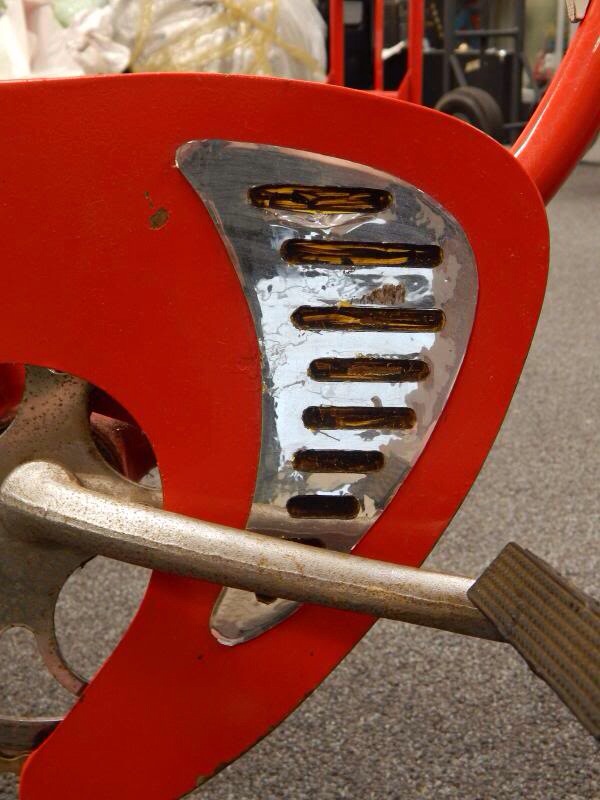

Quick question on the chain guard. Did you the hollywood bike actually have a chrome plated metal piece or use chrome tape on it?
All of them if I recall had chrome tape. I know for a fact the others I've documented have. I didn't look at that specifically on the Hollywood Museum bike.
Here ya go ;)
