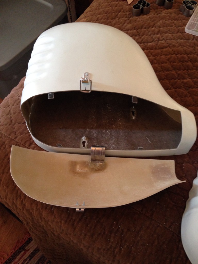

I cleaned up and did a quick and dirty paint job on an upper saddlebag. Still waiting on more red acrylic sheet for the fin, should be here today though. A couple things about this, this is actually a reject casting, but I cleaned it up with some bondo and it looks pretty good. The hinge is recessed, I don't like the sticking out of the top look, and it has magnets at the other end to hold it closed. The tail light is attached with a wood screw through the center and has a circle of chrome tape under it. I thought that might make it look a little better, not sure if it does though. The base is plywood and is attached with small wood screws at the front back and sides. It could be better, but I wanted to clean one up quick and see how it looked.
Here are the side bags I've done so far. The openings are cut out and the hinges are just like the movie chain scene, except that I used rivets instead of nuts/bolts.
And lastly, I decided the side bags weren't symmetrical enough in the rib section, so guess what, I'm redoing it and remolding it. It's more money, but I want it to look right.

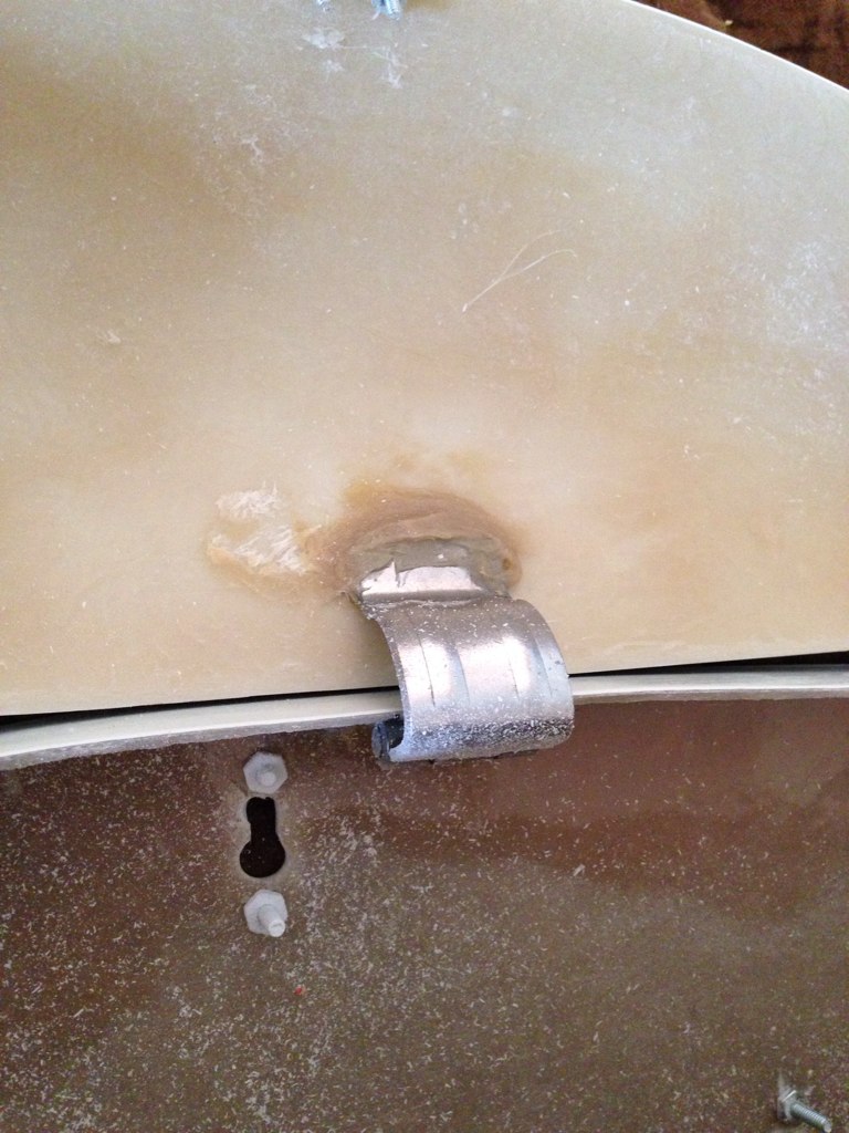

Can you take a pic of how you did the hinges? It's been kind of the bane of this whole project for me.
Gregg
It's really easy. First I marked where the hinges would go before I cut out the openings by making pencil marks through the bolt holes. Then I drilled out the holes. After I cut out the doors with a dremel and a cut off wheel I marked where the hinge part needed to be notched on both the door flap and the saddlebag. This way only the hinge portion shows from the top. I also chamfered the meeting edge of the flap and the bag so it could open easier without hitting itself. You'll have a small gap, not bad though. I plan to solve this by putting a small strip of something under it glued to the bag, and painted red.
One hinge seems like it would be a little wobbly. How is it for you? I wanted to use the same type of hinges as the movie bike, so that's why I did mine this way. What is the name of the type of hinge you used?
It's wobbly when it's open but when it's closed and latched it's fine. I honestly forget where I got it but it's a concealed hinge. I'll see if I can't dig up some info on it.
