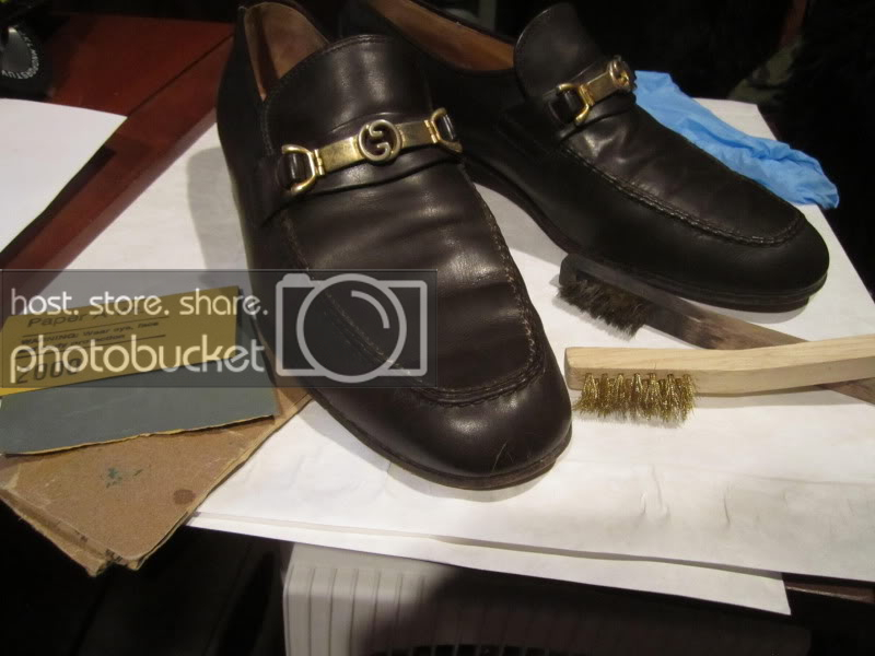

After stripping the wax and protective coating off I used a little fine grit sandpaper to give the paint better adhesion.

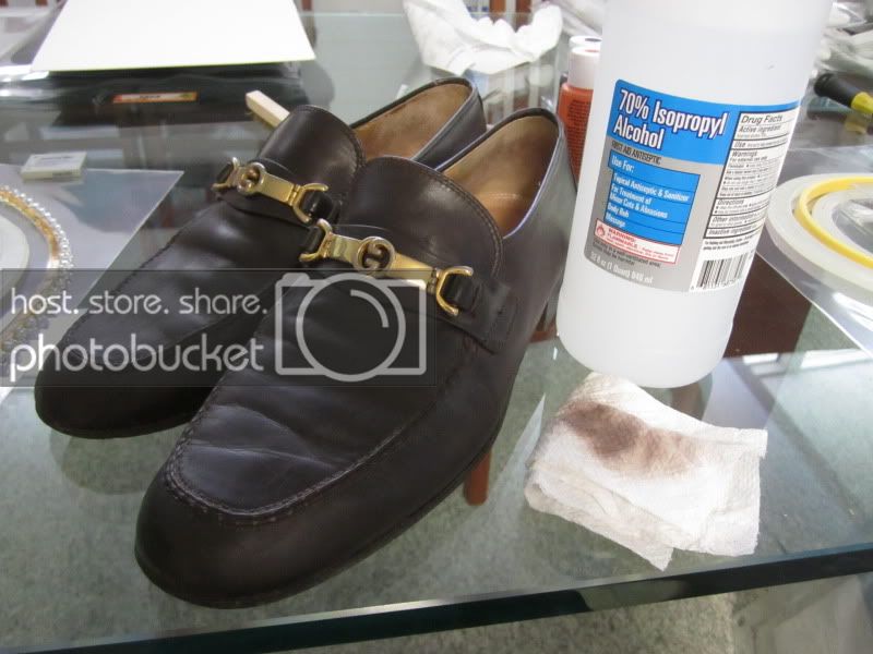

Then I cleaned with rubbing alcohol.

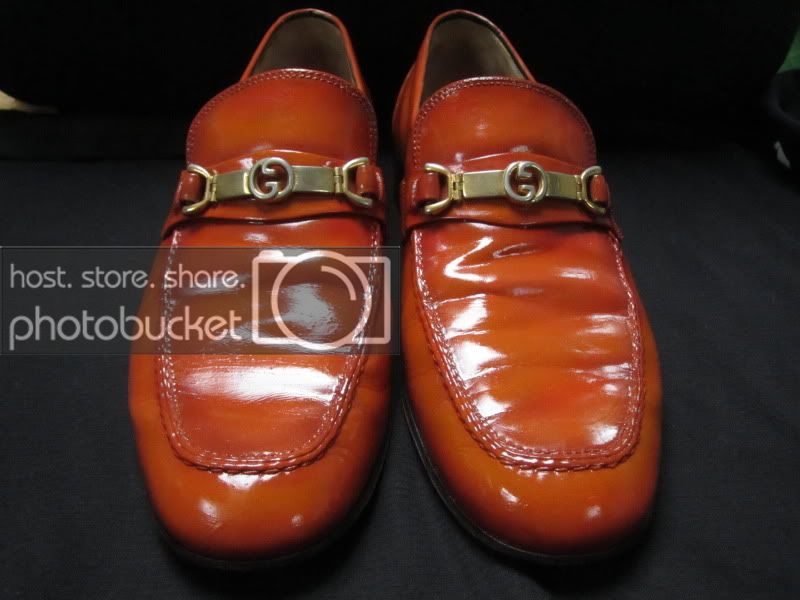

Now to protect the finish. I went with Liquitex High Gloss Varnish. (because, you guessed it . . . it's what I had on hand) :p
After the first coat.
And the final product after 2 coats of varnish. (I'm thinking I might add one more coat.)

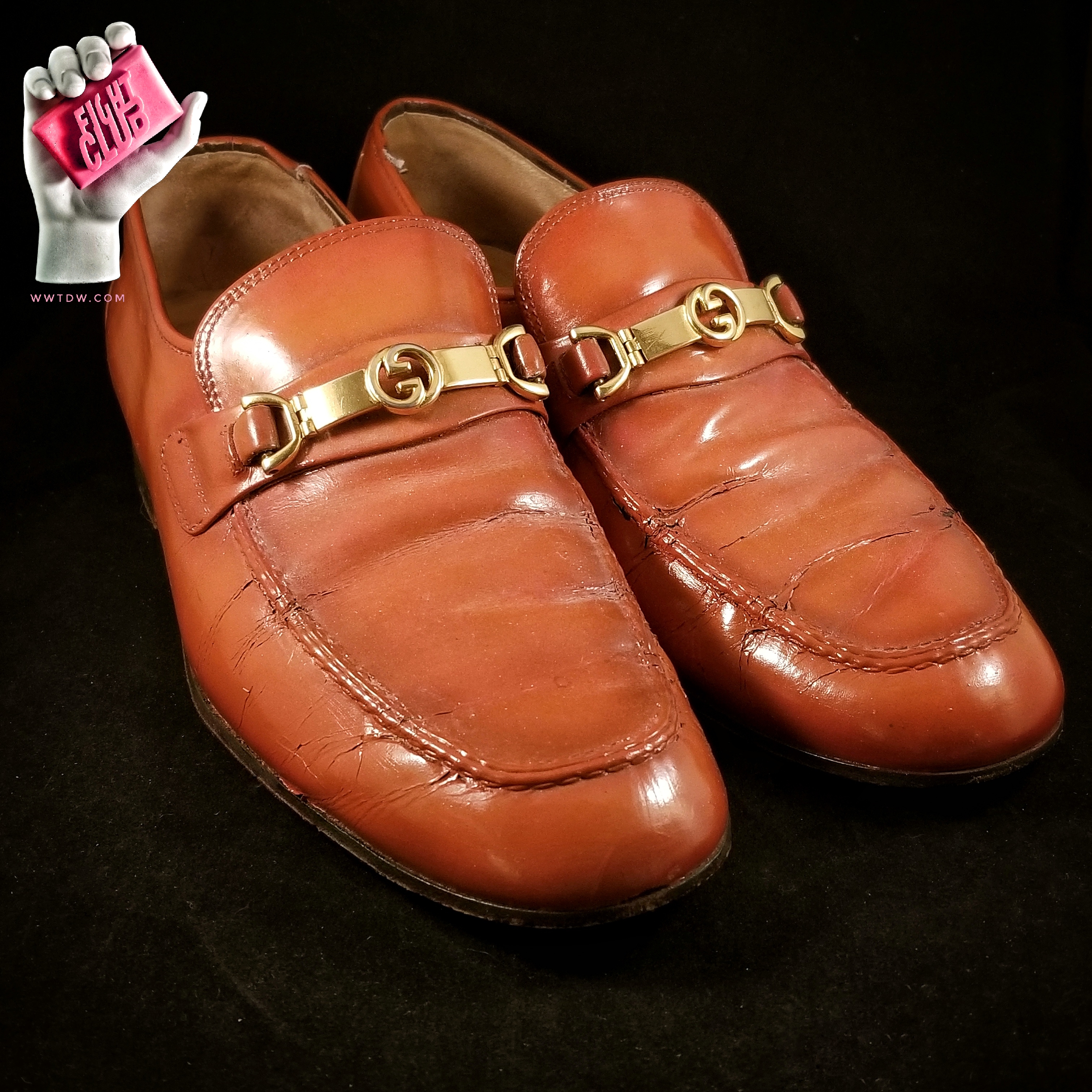

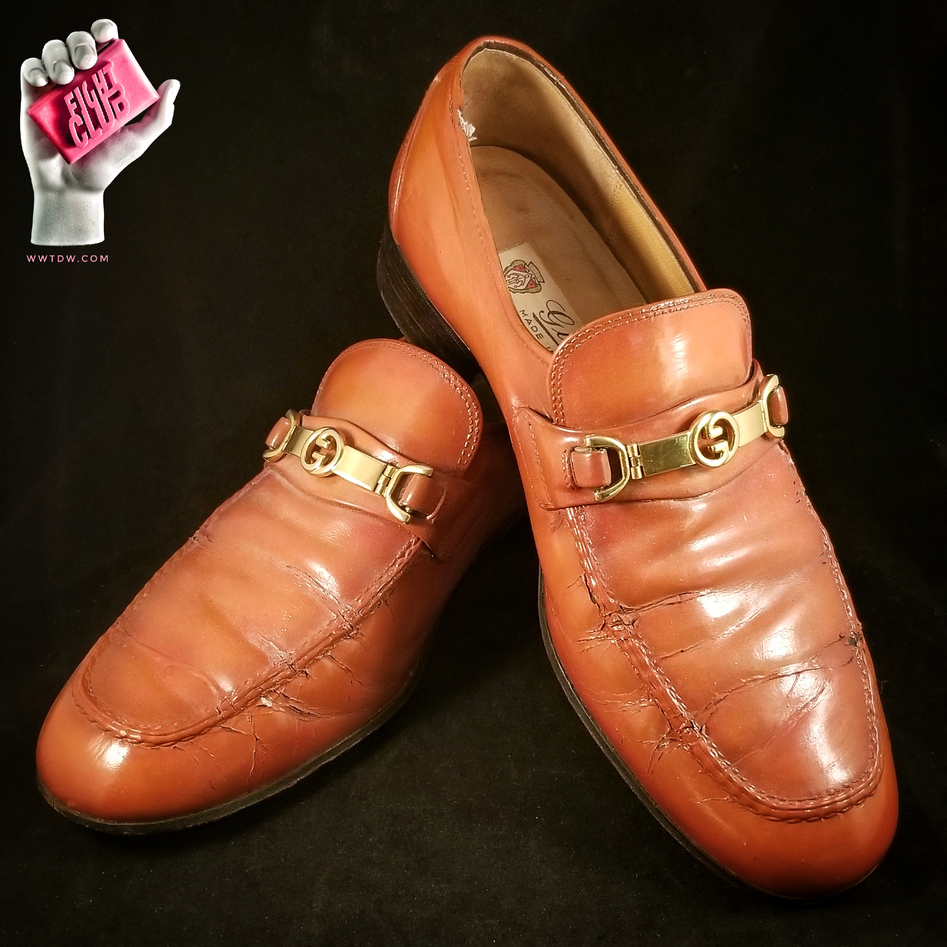

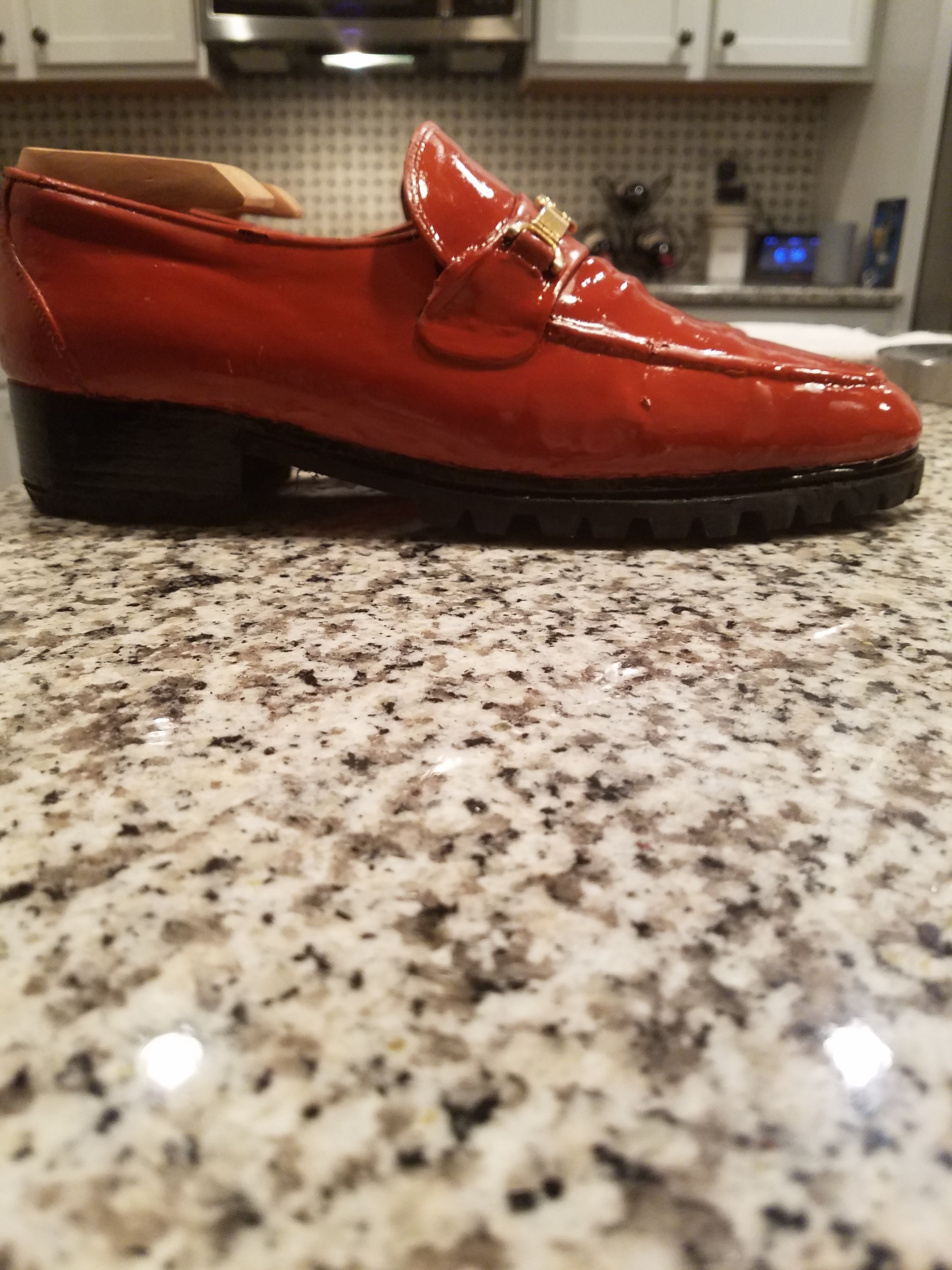

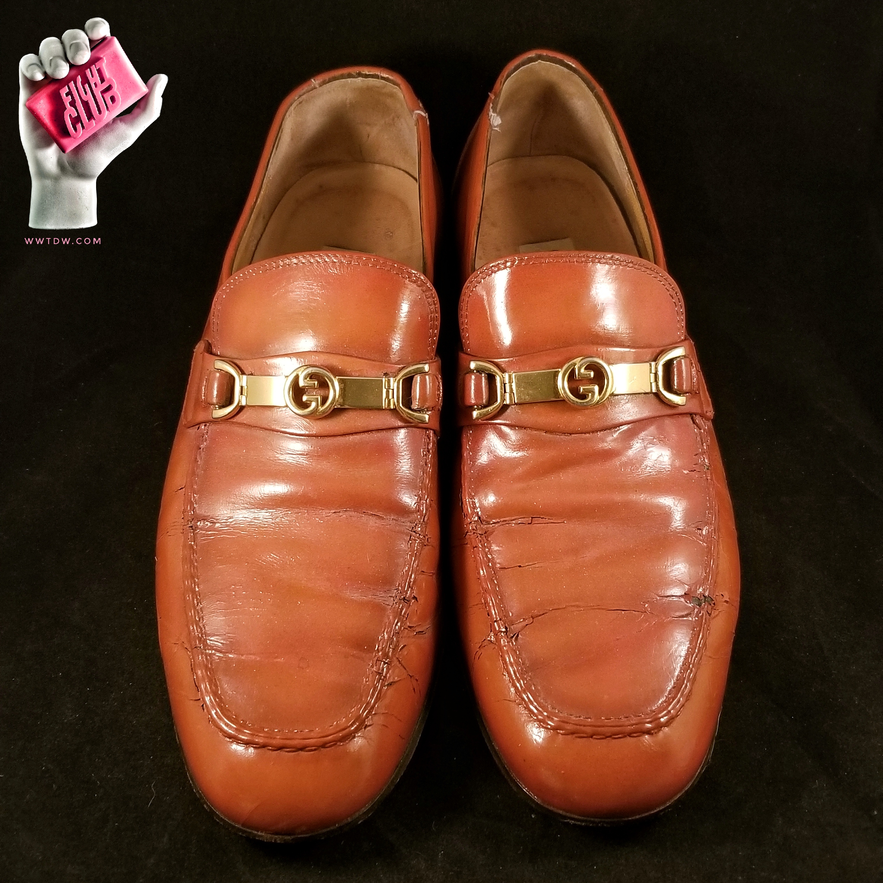

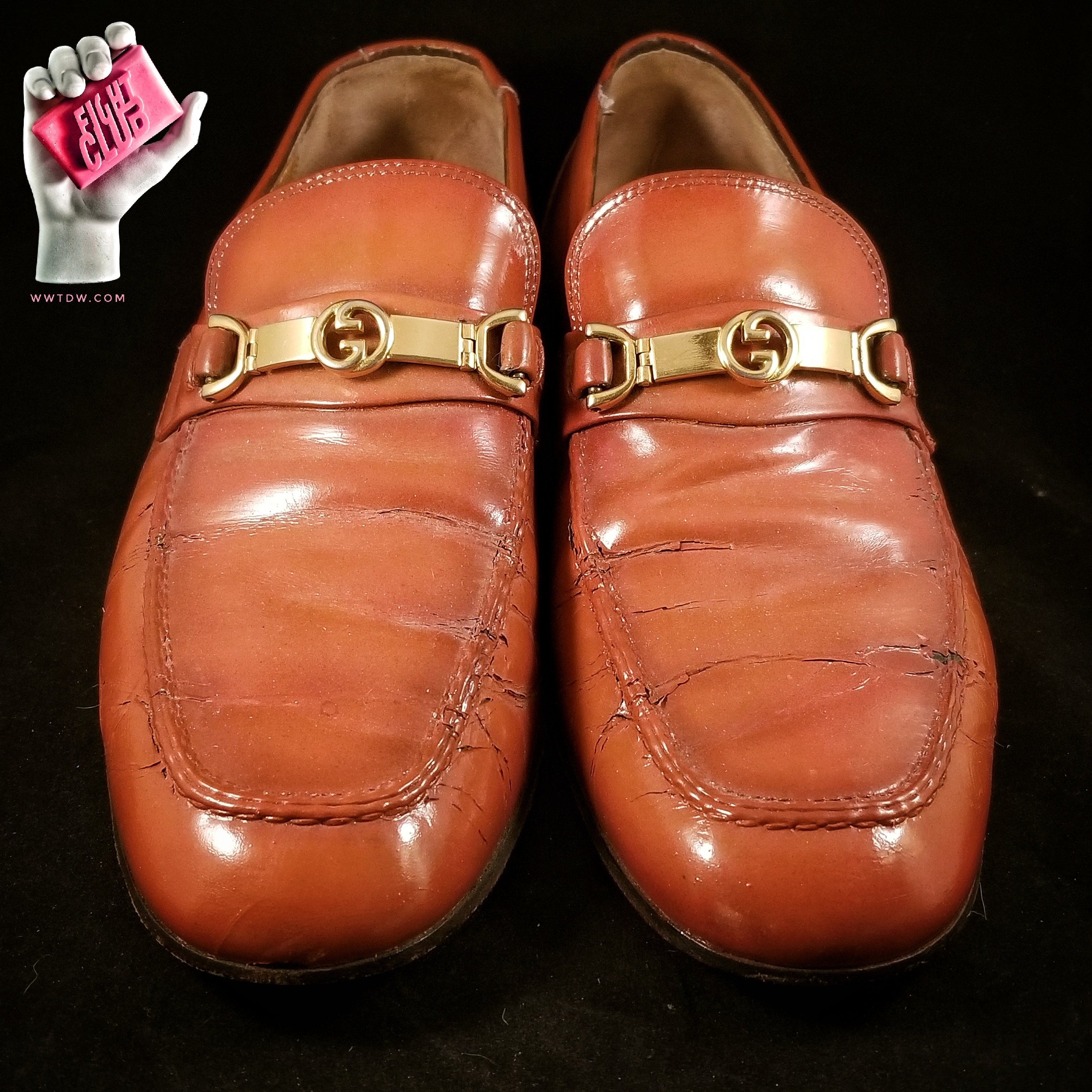

For reference, here is the color I was trying to match:
I think I pretty much got there. :thumbsup

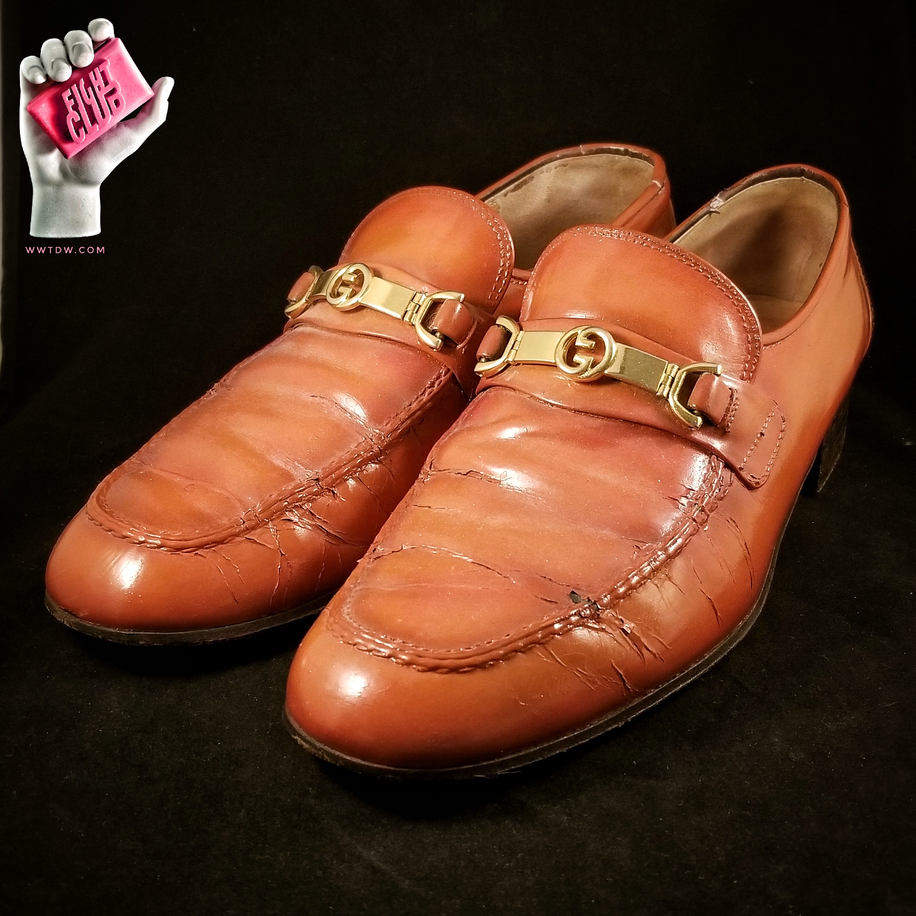

I mostly just keep these on display these days, but I've worn them out a handful of times. Here is how they are holding up after all these years:
