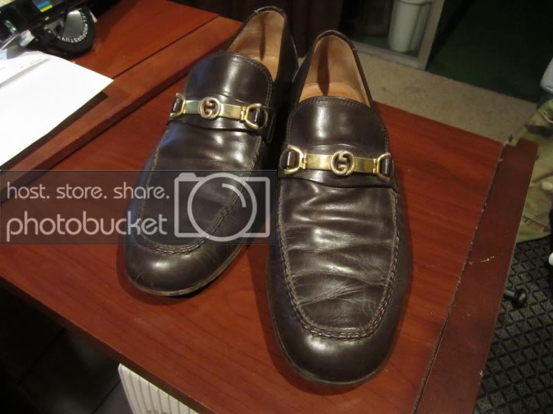

So I got these pair of vintage Italian made Gucci shoes on ebay last week.
They are the same exact pair Brad Pitt wears as Tyler Durden in Fight Club, but they were too dark! I got a helluva deal on them ($35) so I figured I'd just buy em even though they were too dark and try to lighten them up somehow.
After purchasing I started researching how to lighten leather only to discover that lightening leather is pretty much impossible. :facepalm Sure, you can go darker, but once the dye impregnates the leather there really is no going back. So I started researching some alternative ideas. I found a couple youtube videos of people customizing their old nikes with acrylic paint. So I figured I'd try an experiment of my own.

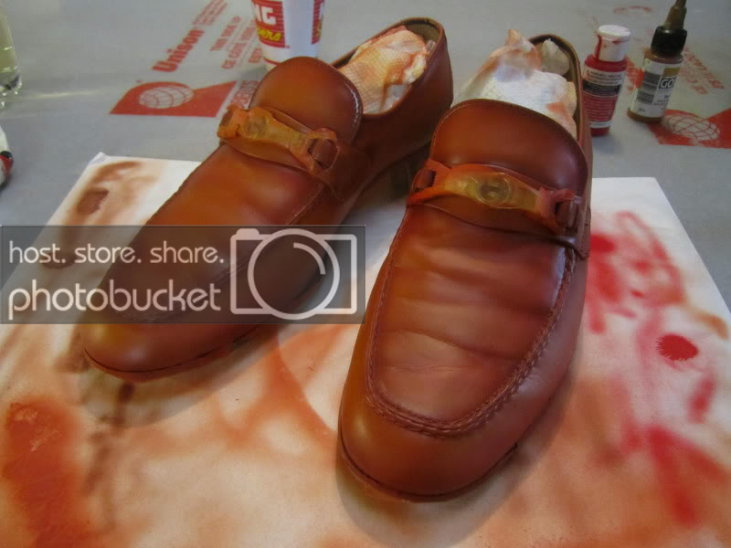

I mixed up a batch of light color for a quick primer coat.
After first application. Woah thems some fugly loafers! :confused
Then I sanded them down again.
Detail shot.

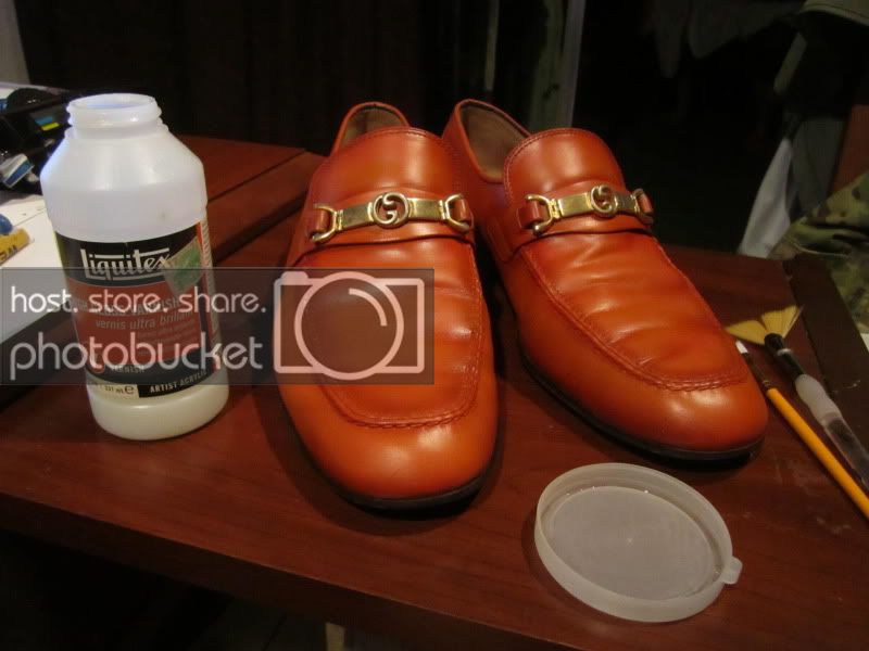

Now to protect the finish. I went with Liquitex High Gloss Varnish. (because, you guessed it . . . it's what I had on hand) :p
After the first coat.

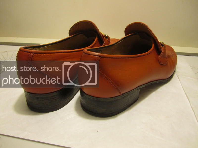

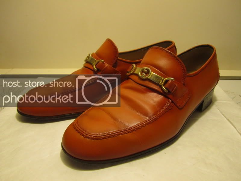

And the final product after 2 coats of varnish. (I'm thinking I might add one more coat.)
Couple detail shots.

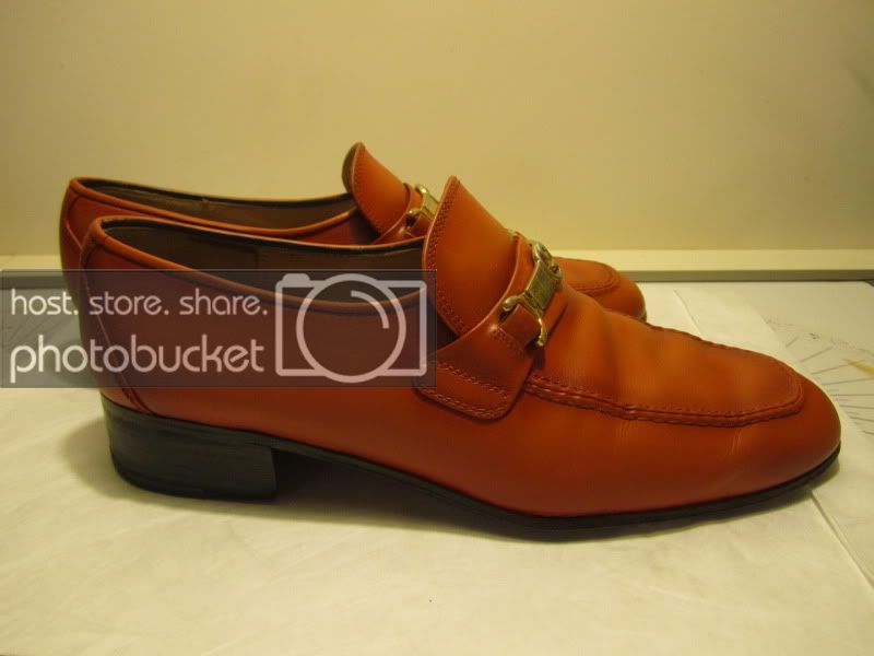

For reference, here is the color I was trying to match:
I think I pretty much got there. :thumbsup
