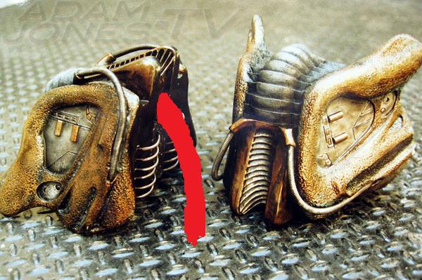

Question ;)
Apart from the hot toys thing, i cannot clearly see via screen shot or Mr Jones pictures, WHERE the supply hose will/would attatch. I know its not really important.
BUT
does anyone have any other pictures that show this? id like to have it in roughly the right place. :p
Please excuse the crude mspaint once-over but here is where I think that supply tube goes. If you look on the original reference pic there is a small hollow on the bottom there.

Rechecked P2 and after adusting slightly in photoshop im nothappy that the supply tube does NOT attatch under the chin section of the rebreather.
it appears to attatch to the left had cheak section.
