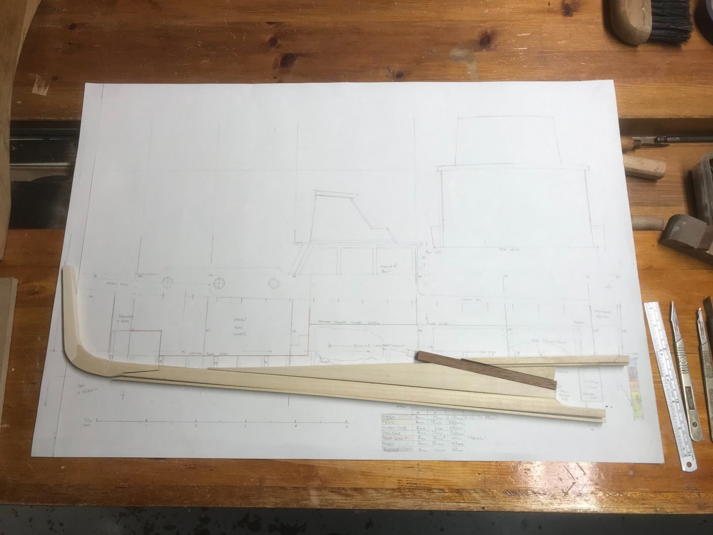

Micheal these are the keel and bulkhead patterns I used for my build. The PDF IS scaled up to 1/9th scale or a 56" long 18" wide boat. You have my permission (if you want) to use them. The PDF I had printed out, I traced the form to wood with graphite copy paper. I did the same with the keel. (forgive me, but I don't remember the enlargement percentage use for the keel) The keel should be 56" from bow to stern.
Hope this helps start your build. As Filmzy said to me when I started,
Welcome to the Rabbit Hole" LOL.

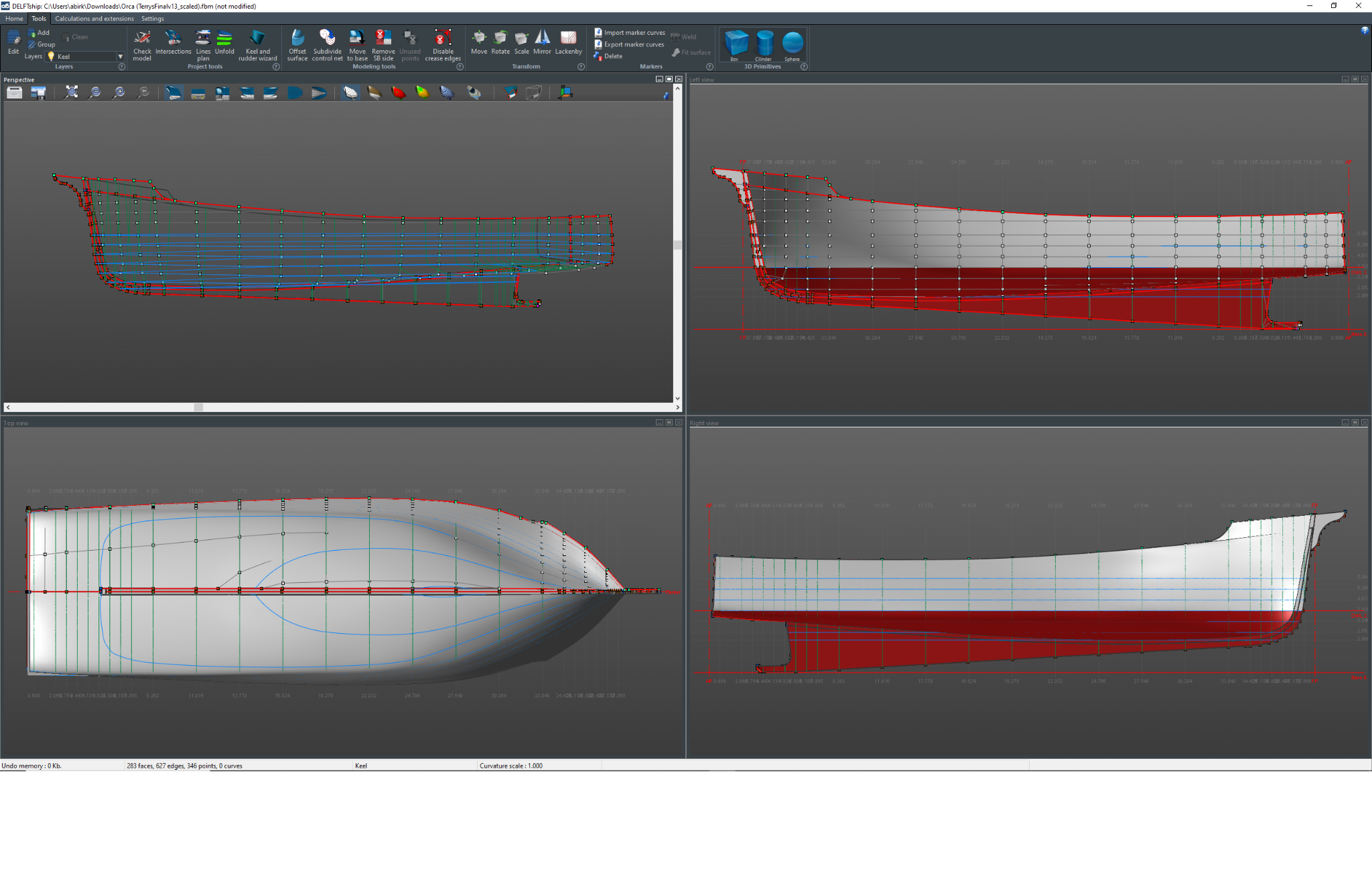

Hi just seen this , I didn’t go with ether scale. I draw the hole thing full scale so I could use real world object in an assembly, I the used Quints ( Roberts) IMDB hight. To come up with a factor to reduce the model in solidworks. As all productions are now on hold including mine I will be at home, so can work on my own jobs for a wile and will tell you what that number was. But as you say it isn’t 1:8 or 1:9.
I’ve thought of trying to do that same thing actually, using Shaws height of 5’10” to try to scale things out. My problem is I have the desire but lack the skills to use programs like blender or cad or DELFTship…they just totally confuse me. I have the skills to build, but when it comes to computer stuff I may as well be trying to decipher alien technology. I will get to my goal somehow eventually…
It is an odd scale as I've based it on Quint being 8" from 5'10" so I've reduced my full-size models by 0.114
that gave me a Bruce of 34.2" if it was 25ft.
I have worked in Imperial only because any hardware would have been in feet and inch's.

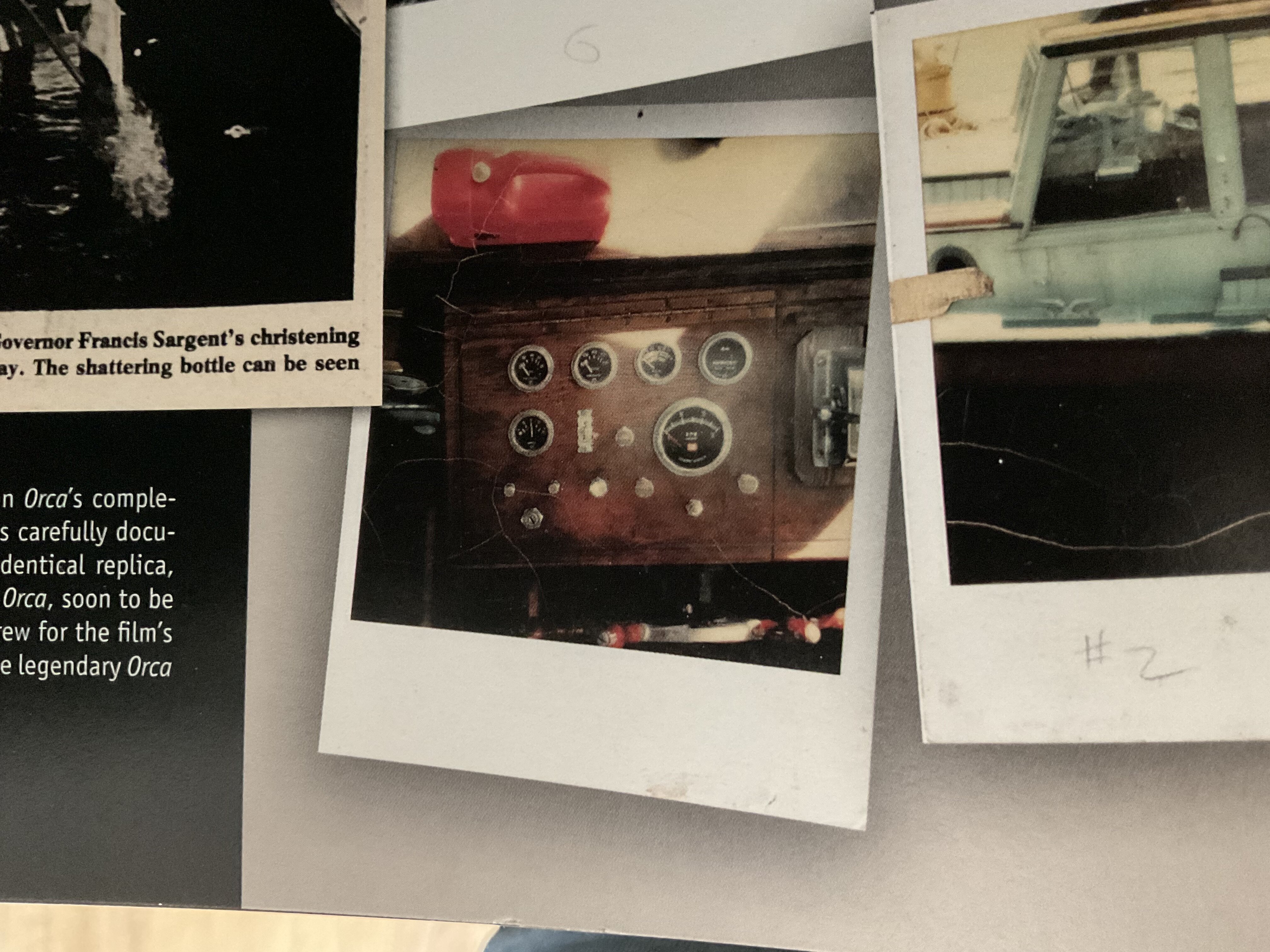

Good God!!! The amount of information you have on those files is staggering! Now I see why you said you needed stronger glasses. This boat is going to be SOoooooooo good! And BIG! I did catch something. The main control panel......it's in 2 pieces. The gauge side and the throttle side, both hinged at the top. The video was so fast (for good reason) I wasn't sure if you had figured that in. Christmas is in 5 months, might as well use the time. Sniff, Sniff.......I can smell the laser cutter and 3D printer now! LoL

Based on the dimension of my real Morse throttle against this photo. this time I'm starting with all the props and working backward
that way I know things will fit in the right place with the right spacing. Yes, I got the hinge.
