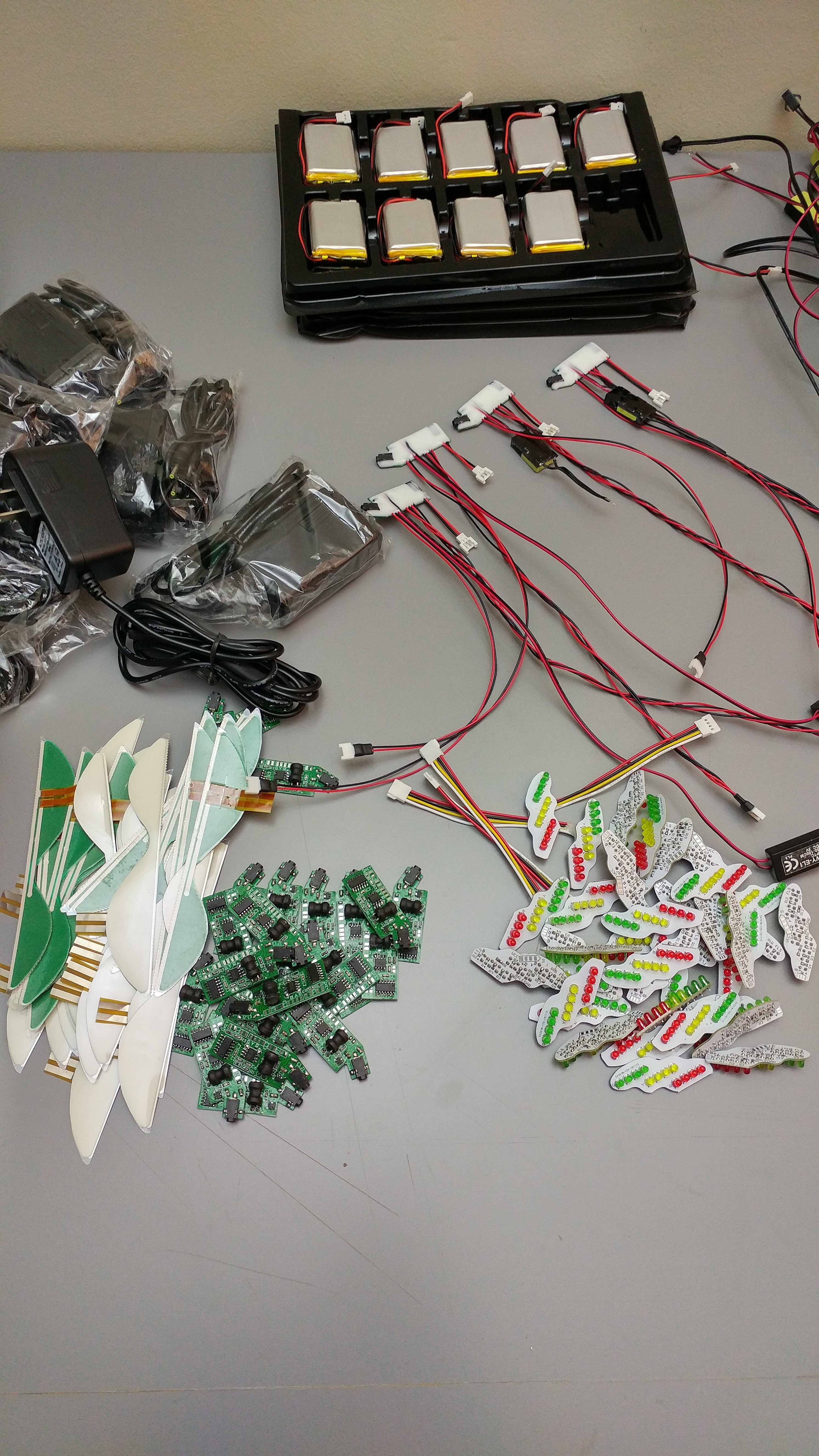

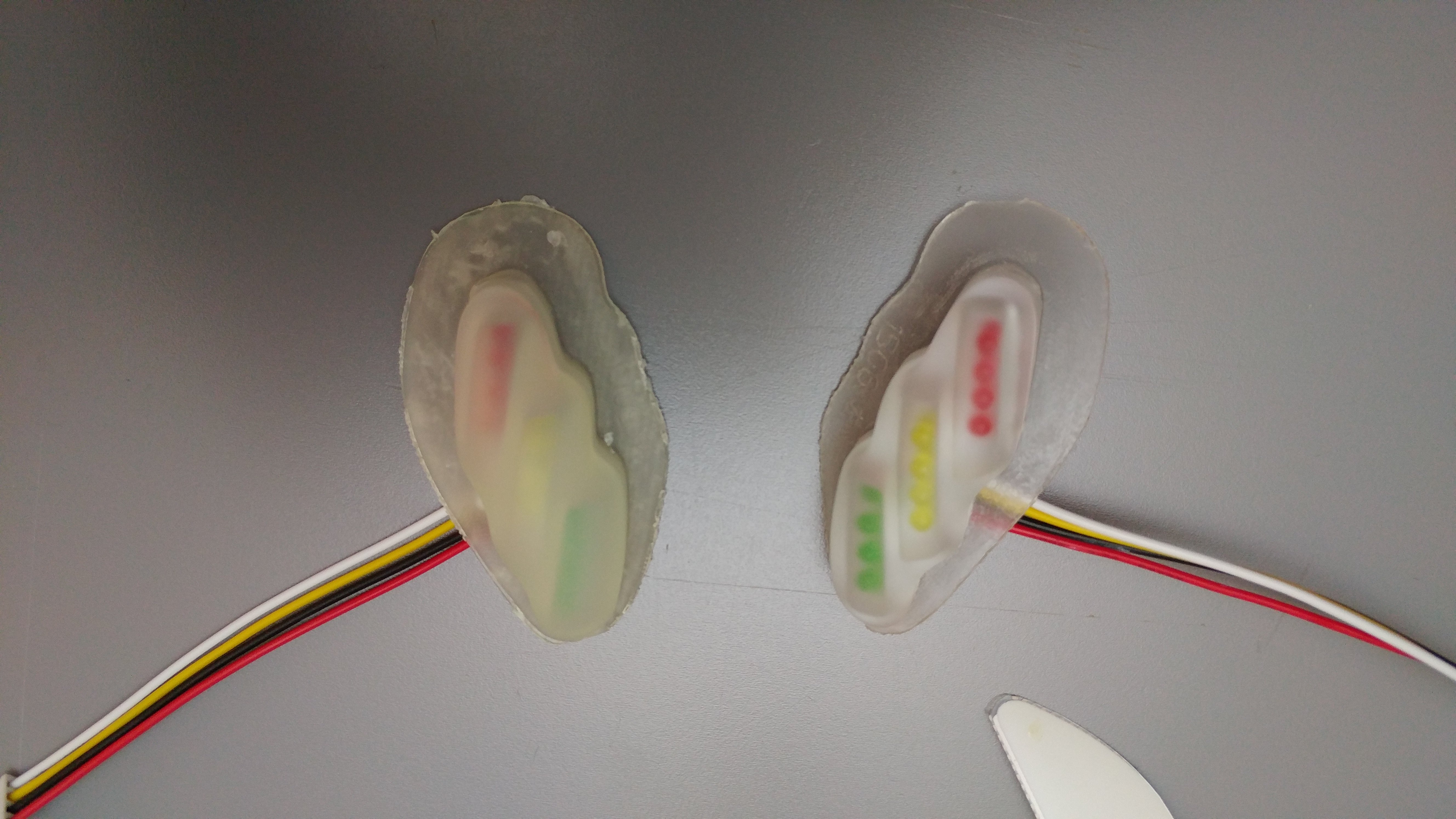

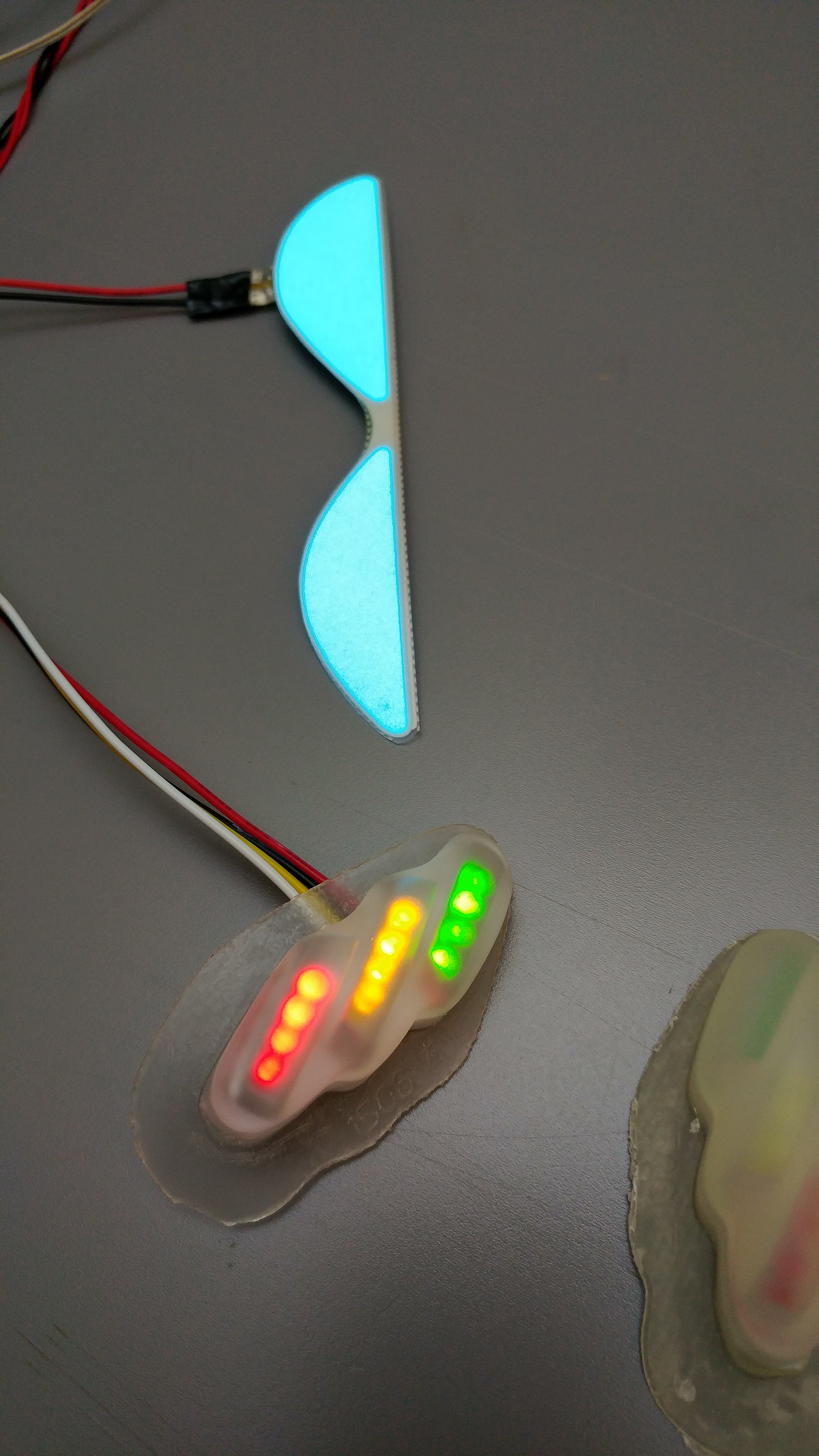

I have some that work with V3 if anyone needs some too. I recently got a new batch of goodies in. Few updates in these electronics...
Led boards now have 4 wires an individual channel for each color. This is required for red blinking when charging and solid green when fully charged. (my main boards and LED boards have to be used together for this to work)
LED brightness has been addressed again. I can also move the LEDS forward on the board to give it the look of the 2011 Mags where you can see the individual LEDS better (this comes with LED bubbles I make which are slightly more transparent as well)
Added a brightness option. The standard 3volt WY-ELI (little black box inverter) is the best stock inverter I've found for these mags and I've tested a bunch. It does add a bit more blue to it but it increases the brightness a decent amount. It ties into the main board and uses the stock V3 switch to turn it on and off. I also have standard V3 brightness/color option.
Posted some videos to my instagram trying to show off some brightness comparisons and charging.

do the leds blink like the original 2011s?
is that possible?
i mean its still good progress but just curious
is that possible?
As far as I know its pretty close to the 2011. It blinks red when charging and goes solid green when fully charged. I posted video on my insta.
