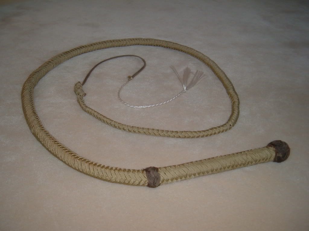

I finished plaiting my 6-footer yesterday, with the exception of the turk's head knots that is, and have a couple of questions.
First, where would I find a lacing needle like is shown in the tutorial?
Second, could you throw in a little detail about making the cracker? I picked up a spool of mason's line, but haven't figured out how to attach it yet. The picture shows a small loop at the end that is attached to the fall, but doesn't show how that loop gets there.
Lastly, when you begin the 12-plait, how do you keep the lines of cording from slipping out of place and bunching up? It's not a problem once you get a few plaits in, but I had a hell of a time getting them to hold still and had to resort to a few drops of super glue to get them to stay in place. It'll be hidden by the leather wrap and turk's head know, so I'm not worried about it showing, but it's not the ideal solution.

1. Tandy Leather Factory. Get the Jumbo size.
2. http://www.youtube.com/watch?v=rrvJ54ZvzM0
3. Go ahead and let them be loose untill one complete set. Then go back and straighten/tighten them from top to bottom.

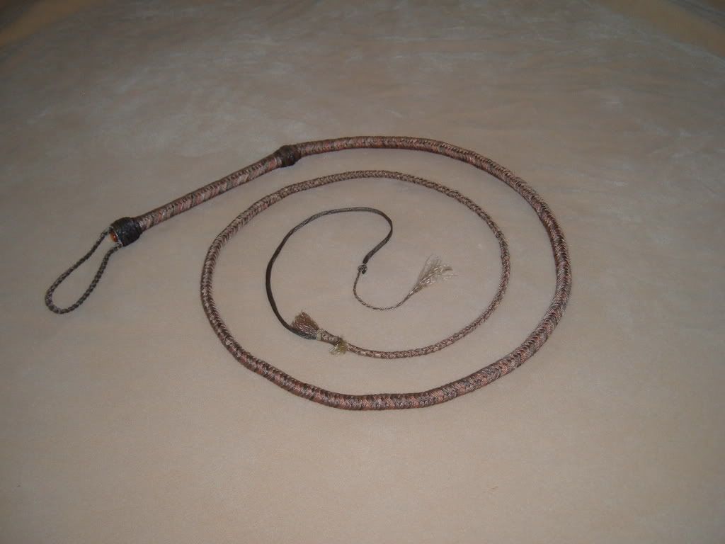

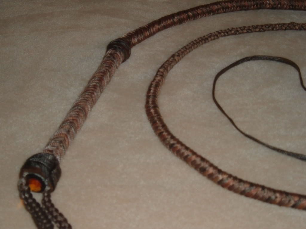

Here are a couple of shots of my latest whip...my wife calls it my "Calico Whip". I made it with white paracord from Wal-mart...and used three different shades of brown shoe polish, as well as a bit of black shoe polish, on the strands before plaiting.
And here's another shot of my first whip...much higher quality cord, and quite a bit shorter...but, man can it ever crack!
