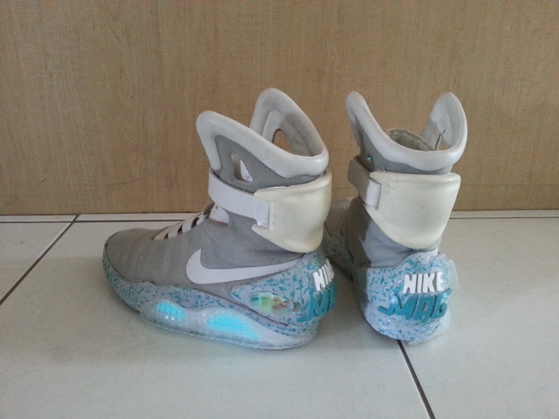

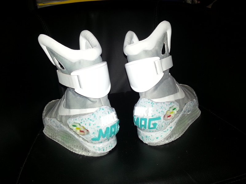

The very first pair I fitted were cutout and glued letter for letter. These shoes belong to member BTTFSpencer and are US11.
attachment.php

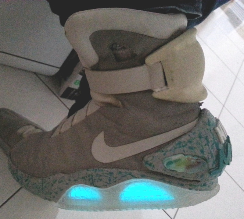

My own pair. I went back over the back of the decals with light grey to bond them to a single sheet. Much easier to fit, but I then changed the grey to clear to make it easier to match to the darker grey of the V2s.
attachment.php
attachment.php
You can see the layer of grey. What I do now is to not back fill the parts with the colour rubber, rather just use clear. It make the letters lower profile.
You can also see prototype bubbles in the two pair of shoes and of course, the new super bright Glow In The Dark (50% per volume) mix. It looks like EL here.

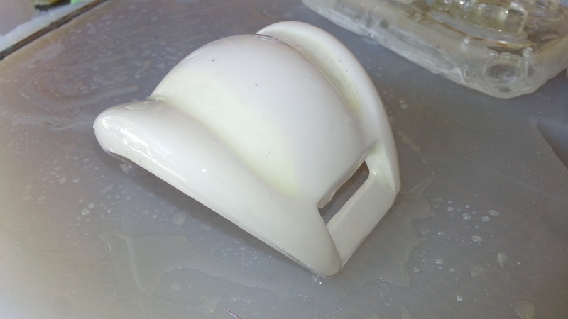

That buckle on my shoes is the cloneprops buckle, not the new sculpt I have done.

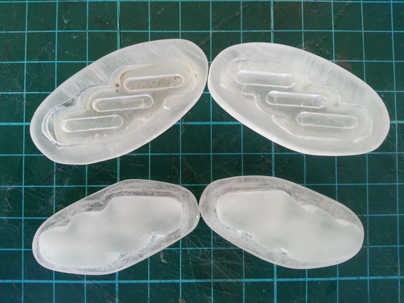

Here is my new part
attachment.php

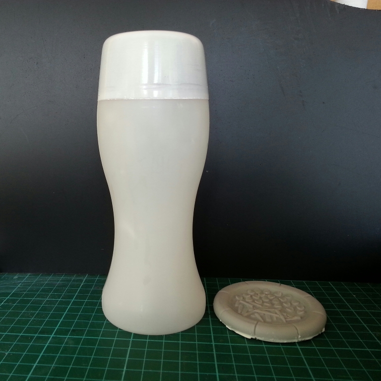

And the new bubbles
attachment.php
And something I have been working on to go with the mini Pizzas
attachment.php
Hopefully I can pick up some silicone today and mold and cast the buckle and the new bubbles this weekend.

will you make a pre-order list and give a price depending on the quantity I guess ?
The parts will be identical to the master. The silicone I use will pick every detail including my finger prints. The rubber that I will be using is the same as I use for the Clear Soles, just tinted solid white. It will be degassed to be bubble free.

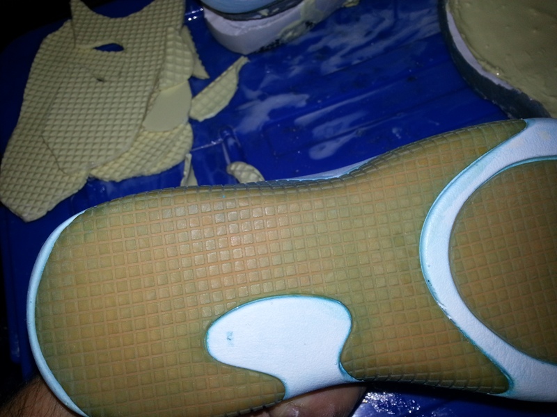

I am going to suggest the same (A60~A65) based in the way they mid-soles are core hollowed and how the rubber grinds compared to how the stuff I use grinds. It is not soft like the V1 soles which were under A40.
I also learned that I can get a product that is A15. That would make an awesome gel pad for inside the heel and under the ball of the foot. Maybe even arch supports. Because it is a polyurethane, it will bond to the other flexible clear I have. Even the pink silicon I am using as a soft cusion under my own heels is A25, but that will never bond to the rubber.

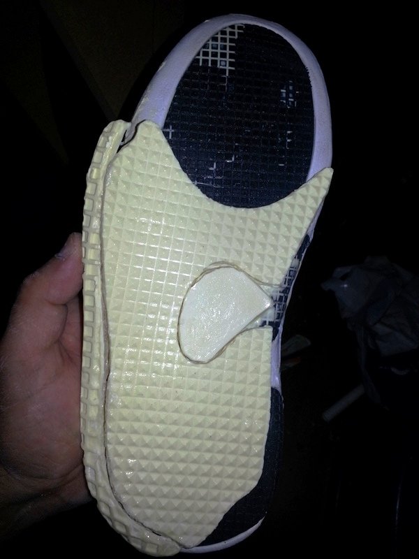

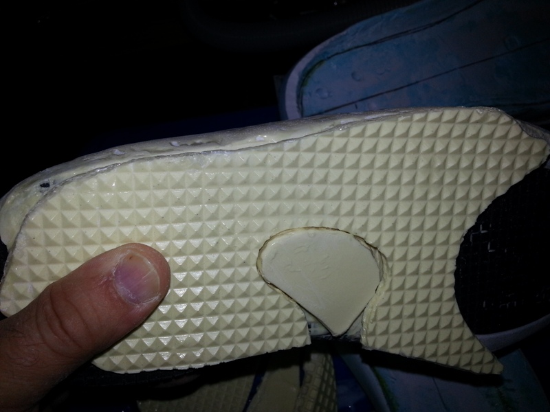

Last night I was looking at the V1 soles again because they just have a better overall shape to them. I now have US8, US10 and US11 in these. I will have to fill the concave outer edges of those to make them work with my outriggers and rather than build them up, will build them down to cover the thickness of the soles and to increase the thickness of the toe. I have to cut away the back part where the heel cup attaches.

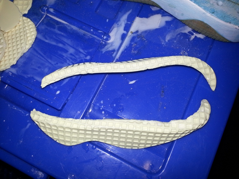

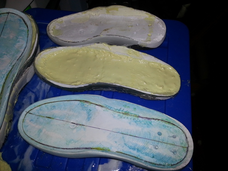

Tonight I had a bit of play with the V1 soles. So an mentioned, I have 3 different sizes and the plan is to make masters from these.
At the top is US8 (EU41), middle is US10 (EU44) and US11 (EU45).
attachment.php
There are a few things that are actually better about the V1 sole over the V2 sole. But this giant recess is not one of them and must go.
attachment.php
So I used a two part, quick set resin to do that.
attachment.php
And made a cast of the sole bits so I could shape these to fit.
attachment.php
Based on how the side wings turned out, it might be possible to make new (better) masters and molds them in this shape.
attachment.php
