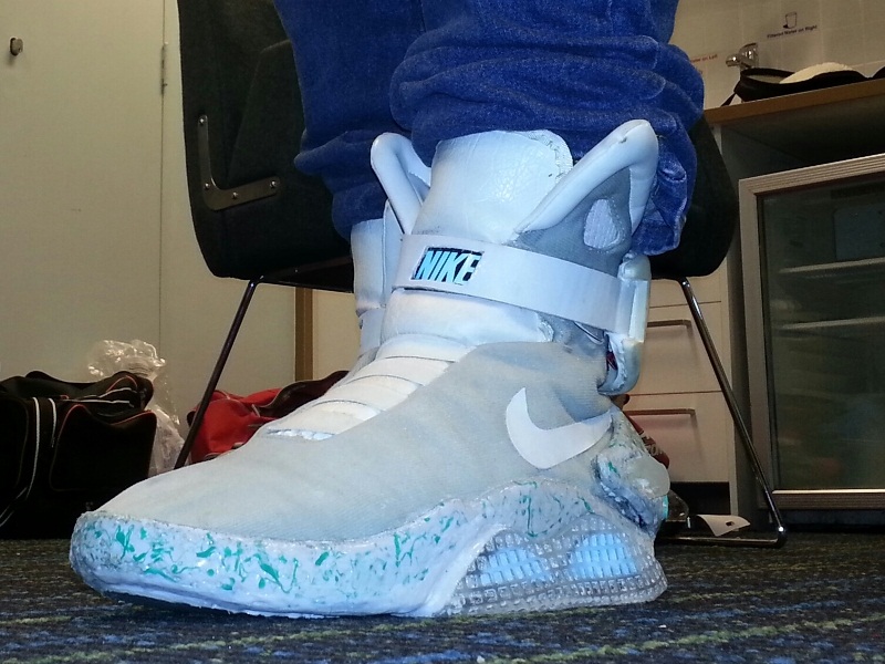

Ok, I'll try this spot if the wrikles don't want to go away.
Trust me, you want to get the toe box out of your shoes. They become SOOOO much more comfortable without that hard thing pressing against your toes after the slim.
I agree. The HC's feels way better too, so I guess the V2 will. But I might have find a method to have a semi socktoe style without having to open the shoe (and I like the idea of not getting in there). I'll tell you about it later ;)
And by removing the thick in sole, I've made more room inside (maybe half a size) so it is still confortable even with the toe box in place. But I have to wear them more than an hour to be sure...
Tongues on, wrinkles almost gone...

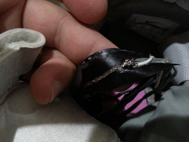

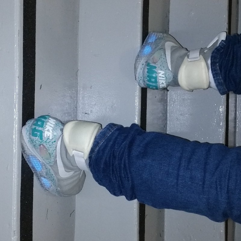

Another broken wire.
Took these for another spin today.
attachment.php
All was good until some noticed that one side of the left EL was not on and flickered if I twisted my foot.
attachment.php
When I got home, I pulled up the sock liner and found this.
attachment.php
Lucky, easy to repair this time.
attachment.php
This is the 2nd time solder joints have broke on my shoes and why I went to GIDT last year. What has happened here is that the flex in the sole has just strained the solder joint until it broke. I honestly think the only solution here is eliminate the joins in the sole.
If you look at images of the screen used shoe, you sometimes see what looks like a phone or data line cable attached. And I think that might be the answer here. Phone or data line is flat with up to 4 pair of wires. So this means that a single cable can be run up the back of the shoe that allows eight connections at each end. I will need to play with some, but I do think it is possible to carefully divide these wires into pairs to be run off to the different points so that all joins are only at the very ends - ie the EL panel or the connector at the top of the collar.
This data cable would work for both all EL systems as well as EL/LED systems and even when the battery is stored in the heel.
EDIT: Looking back, I did walk these stairs about 30 times today, so maybe this didn't help.

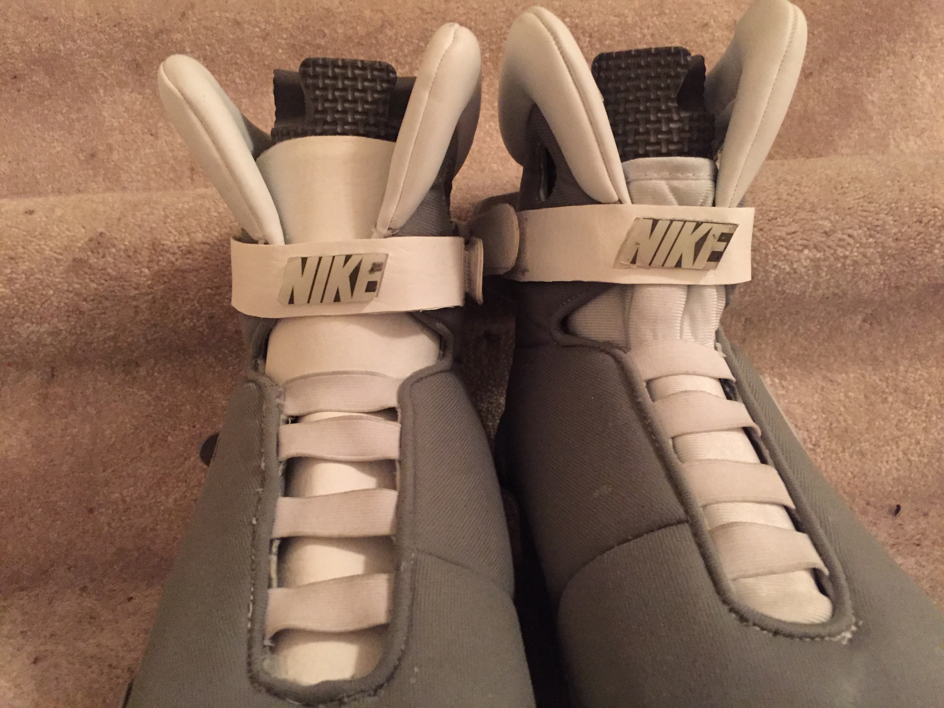

cavx sewing didn't work so I straight up glued it in the shoe on the left is the modded tongue using the strap from my first pair as a test.

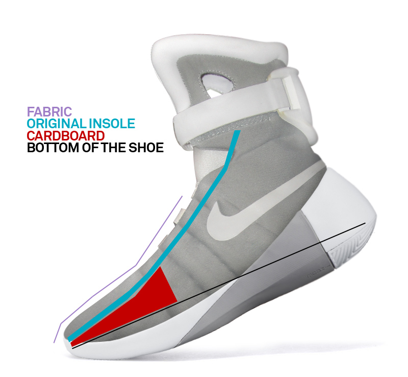

It is Ironin, but I've not used the conventionnal method (like on my HCs)
And it is a result I had in about 10 minutes.
Basically, you put a old shirt or some fabric on the toe box as usual.
Inside the shoe, I made a "shoe last" shape out of some card board. The key is to make a flat shape on the bottom that goes with a light angle.
Strating flat from the tip of the toe and goes up to the laces with an angle of aproximately 20°.
Then, you put the insole on this shape (the shape should be the same than the insole).
Next : You iron from side to side as usual for 1/2 minute (depending of the steam).
After, your shoe should be a bit wet due to the steaming.
You have to shape the toebox with your figners and carrefully put the insole of the other shoe on the fabric.
AND FINALLY : You place a BIG OLD BOOK on this and wait ! (and some other weights if you like)
I waited for four hours but I guess it doesn't have to be so long.
Here is a picture of the "sandwich" method (as I like to call this :D )
And VOILA ! :)

@cavx sewing didn't work so I straight up glued it in the shoe on the left is the modded tongue using the strap from my first pair as a test.
Can you post some close ups picture of the area where you did glue / sew ?
I will, I may attempt it tonight (my time) on my left shoe I'll take pics as I creating my tongue.
Loctite (did I spell that right) the liquid kinda but I when a little easy with it.

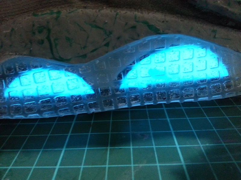

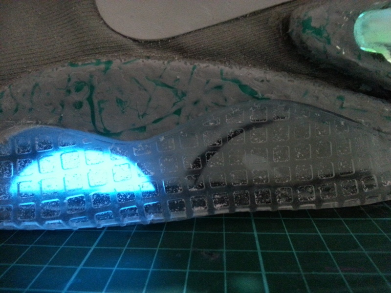

How do you make the led bubble like this ? I mean how to ungloss it ? (I don't find the word in english, as it is not my language so I say "un - gloss" ^_^)
that is basically roughing the ankle bubble with sandpaper and spraying it with a matte spray.
Ok, and you need to open the heel cup to get to the sides and sand the whole bubble ? Or is it ok without opening anything ?
I opened mine one my display pair I'm working on bc I'm adding new lights so I figured if I'm gonna open up the heel cup for lights go a head and take it out and worry about it later. Btw do you now where I can buy styrene sheets ?
