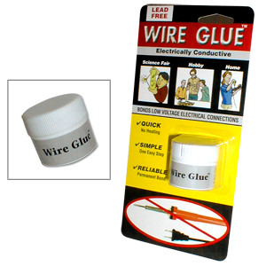

My latest sheets have that too. You need the wire tape, but not sure exactly if you solder that first.
Guess I got lucky, my el had some nice heavy terminals and I was able to solder the El to the tape.
I had no luck with wire glue. It wasn't nearly as strong as solder, and after it dried I could pull the joint apart with my hands. I didn't want to bury that in the sole of the shoe and have it come apart later after it's all sealed in.
I was able to get solder to work, but it is risky. Using flux paste *really* helps.
