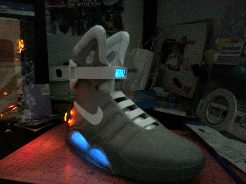

I have to take the other shoe to this level and then I can glue down the Heep Cup.
