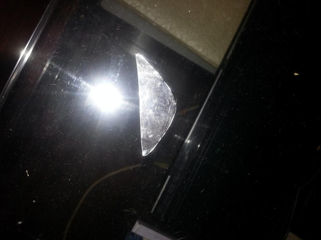

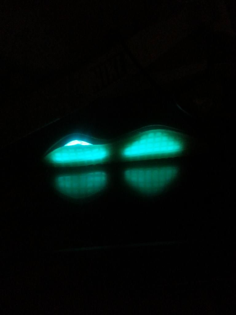

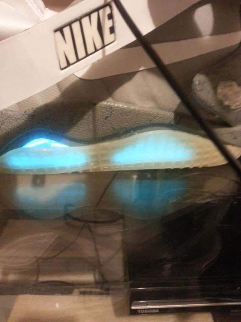

After getting the elwire in the sole I got it to project by using some mirror chrome vinyl, looks pretty good but I wanted it brighter so I used leds because I ran out of el sheet.as soon as I figure out how to post pics on here I will.i moved on to the ankle bubble but the green wire elwirepros sent appears more blue than green so ill probably use leds in the ankle bubble too.
So you say that the EL wire is not bright enough? I am hoping this not the case as a bag turned up today with EL wire and inverters. Hope they are bright enough for my project.

The leds are alot brighter if u ask me.im going to try to post pics to compare later today when I get off.dont get me wrong the elwire looks really good in the dark and the blue-green color seems spot on, I just wanted something brighter during the day.its just all a matter of personal preference. The el wire is a bit to deal with with the tiny angel hairs and I didnt think I would hold up well in the sole as these are going to be my wear pair.i really dig the gray on your midsoles, looks awesome.also can you let me know when you start selling the clear soles, I definitely need a set of those!

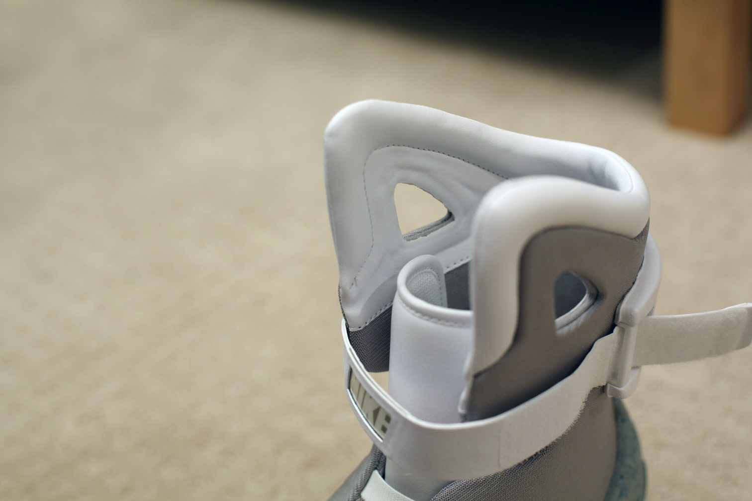

The problem they are having is that because I've asked them to make the top half of the upper the proper thickness, they are trying to work out a way to do the triangular hole cutout without any stitching. So i've sent them pictures of my own build to see if they can work out a solution.
The lace rib thickness is easy and they have sorted that out. If you open a pair of the V2 or halloween costumes shoes, you will feel a very stiff piece of cardboardy type or some type of material, and onto this is glued a very stiff eva foam sponge piece which simulates each of the 4 lace ribs. This is too thick (around 2mm) and stiff, and when they put over the next layer of thin spongy foam, and then the scrim fabric, then the grey fabric over, the lace ribs stick out ridiculously.
The white puffy collars will go on as a seperate piece which is glued to the grey upper half rather than stitched into it like the V2 and HC versions.
It seems to be the triangular cutout which they are having issues with.
If they're already going to be gluing the white portion on, there is no problem. Just tell them that the grey fabric UNDER the white doesn't have to be complete. You have a piece with a triangle cut out of it that is JUST bigger than the triangle itself. Sew the triangles together with right-sides-together then invert the seam, gluing the wrong side of the grey fabric to the shoe structure. The edge of that will be covered by the white cuff glued over top of it.
Do the same thing to enclose the seam along the top edge, below the cuff and you're in business.
I'm almost certain that's how the RDs were constructed, just with a line of stitches inside the shoe along the bottom of the white piece. Check out this picture and you can make out outlines of what appear to be these "incompletely" internal pieces under the white piece.

And that is passing through the yellowing soles as well, so pretty decent. I like it. So what is that tape you have used?
No tape was used just el wire, a small piece of styrene and mirror chrome sign vinyl.the vinyl is the same stuff people wrap their vehicles with or would be used when making banners and signs.i have a vinyl plotter so I used black vinyl for my nike logo also.
