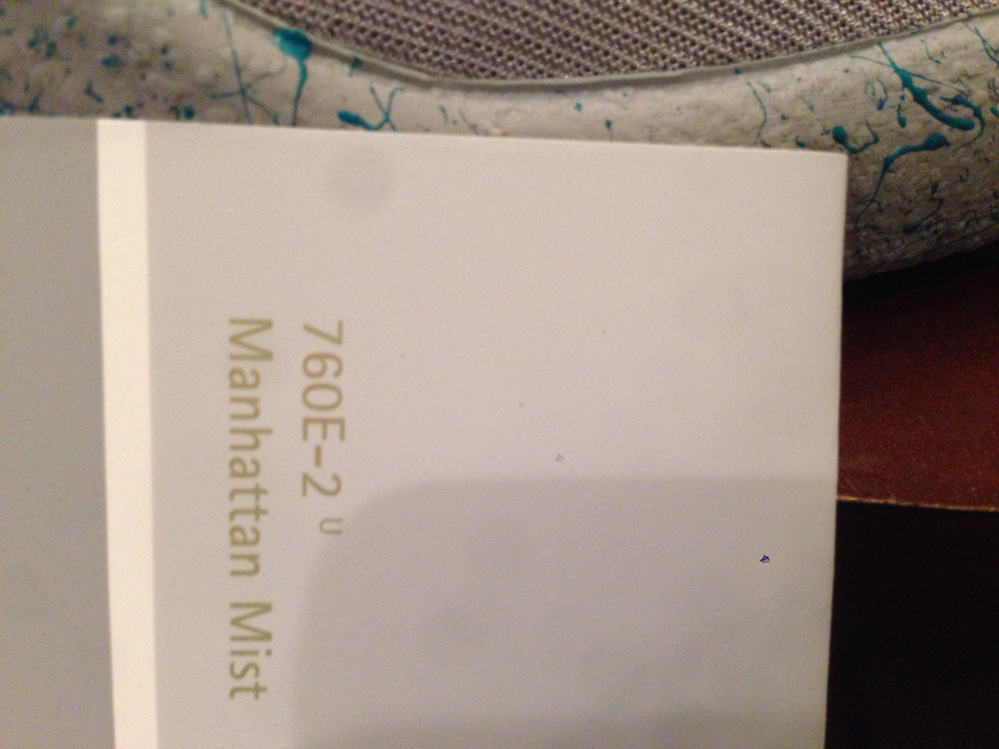

Could we create a grey scale in paint to work out a close colour match? I would suggest simply posting a photo except everyone's monitors are not calibrated to the same level (colour temperature), so will look different. If we work in RGB levels in paint, at least we have a level playing field. Even though the image may look different on a computer monitor, when taken to professional print place, should be able to get close reference colour card.
I'm cool with that.
Notice the 2nd column has RGB values where for this "silver grey" (RAL 7001) RGB is 138-149-151.
And further down the chart I found "Agate Grey" (RAL 7038) with RGB levels of 195-195-195.
^^ Could be what we want ^^
It helps, thanks!I took this photo tonight. I grabbed some paint swatch sample cards from Home Depot. This way most people should be able to figure out the shade of grey.
