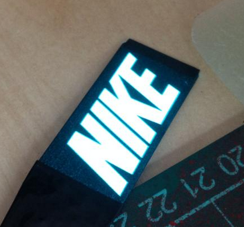

please i want to know where can i buy le nike Logo for my Air Mag .
Can someone tell me or give me a link ??
Thanks for all.
Thanks for all Capture d’écran 2014-06-01 à 22.04.57.pngCapture d’écran 2014-06-01 à 22.05.10.png
You have to make them , or get someone to make them for you , but remember you can't just connect them up to the shocking china electrics thou ,
thank you winchy, but i live in paris it's little bit hard for me to undesrstand everything in the discussion and specialy to try to make this nike strap!
For the rest i think i can make it, with link posted buy people for buying electric EL panel and the electric thing for the strap .
sorry for my english ! :)
No worries , your English is better than my French :0) , bonjour ... That's it lol , the strap is the same el sheet as in the soles if you modified them , all I done was print the nike logo on A4 transparent sticker paper and then stick it over the el sheet .
Lol for the bonjour!:lol thank you very much bro for helping me !! it's cool !
