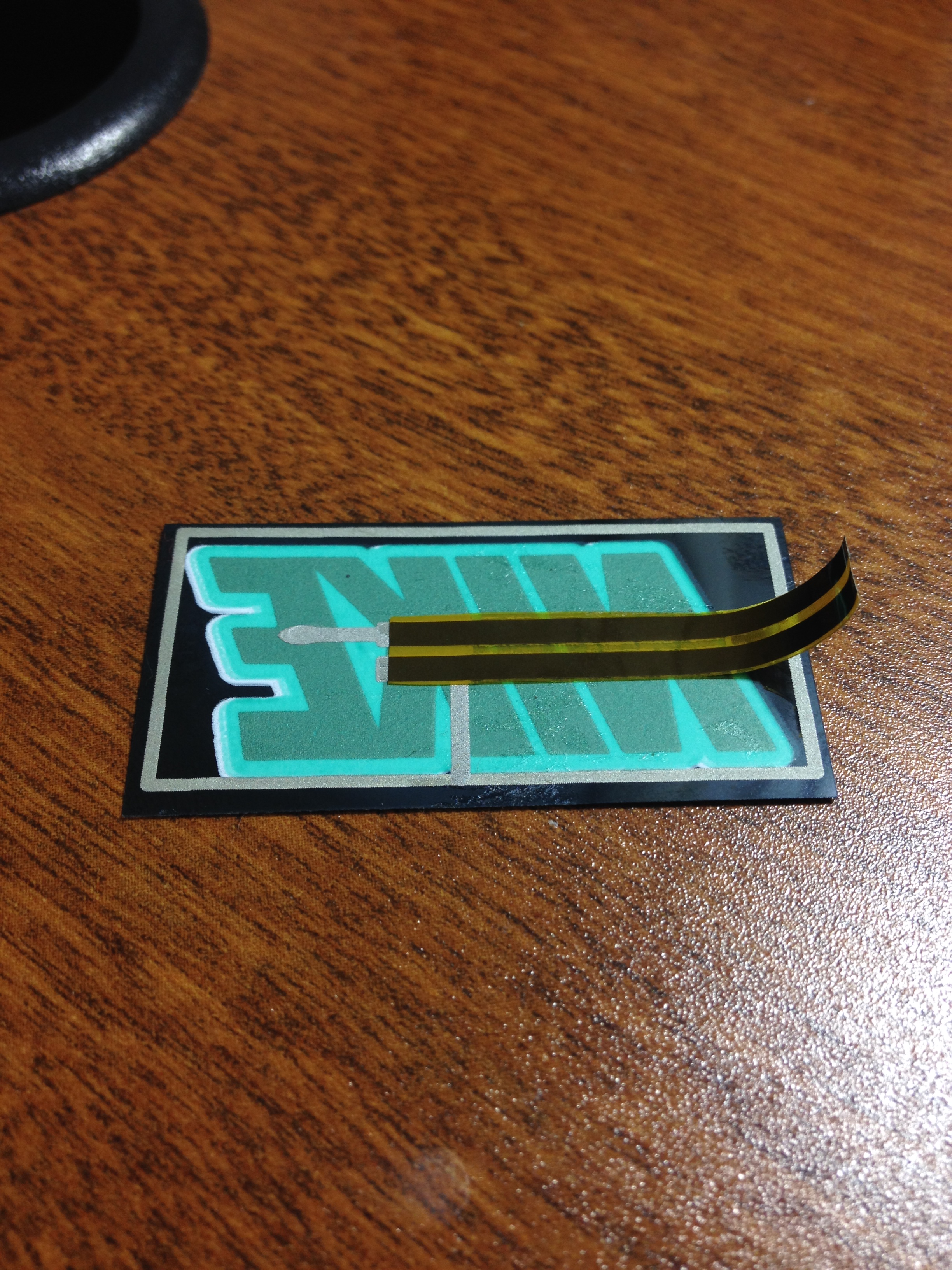

Hey jhk1976You can heat the back up with a blow dryer and peel the wire tape (two copper lengths) and then reapply them the opposite way or you solder the wires like the other strap and just place them behind the logoI personally used new wire tape because I had some

Just acouple seconds under the dryer too warmthe glue... Just be patient and takeout time with it so you don't ruin anything

Welp, I managed to get the copper pieces flipped, but wound up mutilating the clear tape that was holding it on in the first place. :facepalm
Suggestions for replacing it?

Jhk1976 show some photos.... From what you say all I can think is small piece of electrical tape as long as the contact points still engage it will work

The contact piece is intact, I just need a way to adhere it back down.
