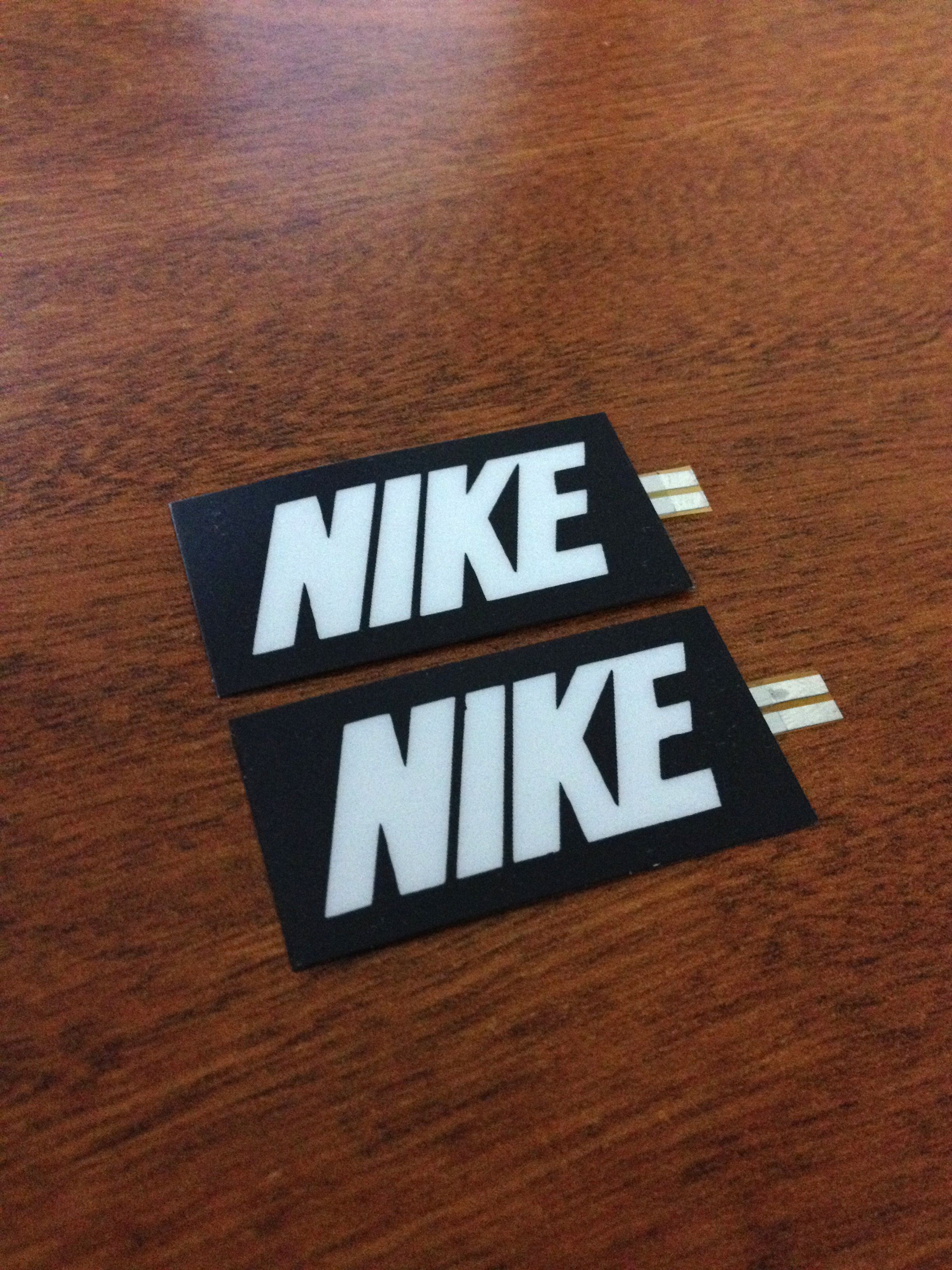

Also, something just occurred to me. My lights both have the contact on the right side. If one of these is for the left shoe, and one is for the right, shouldn't they be on opposite sides? Is everyone's kit this way?

hi jhk1976,
everyone's EL contact is on the right side ;)

hi jhk1976,

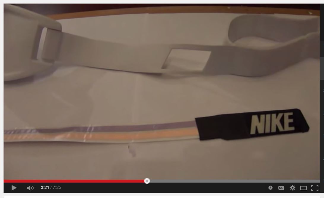

Hmm. I was planning on using the Jedifyfe video tutorial on how to take apart the strap for this. In his video, he takes it apart starting at the cuff end, moving towards the existing Nike logo that comes on the V2 strap. If both contacts are on the right, wouldn't this only work for one of the two shoes? Wouldn't the contact need to be reversed for the other shoe since the strap is reversed? The mod he shows in the video has the wiring running to the left of the face of the Nike EL.
You are right.
the nike logo has been stuck down incorrectly on one of them.
Have a look if you can peel off the decal, turn the el cutout 360 degrees and just put it the correct way round
I really don't see what is the point of putting on the decal the wrong way to begin with? Its creating a problem which shouldn't be there.
Its fairly straight forward, peel off the decal and stick it back down correctly.

Can we just take apart the stock strap on the V2's and put your EL panel in there? Or will we need to make our own strap
Use a hair dryer and peel off the original V2 or Halloween costume strap.
On the V2, since there is a nike logo embedded in, you can simply cut that shape out.
For HC shoe, you need to measure and cut out your own shape.
Follow Jedifyfe's tutorial, really explains in more detail than you could ever want.

Thanks airair I watched his video the other night and its very helpful. I hope we can change the decal. Im waiting for mine to arrive

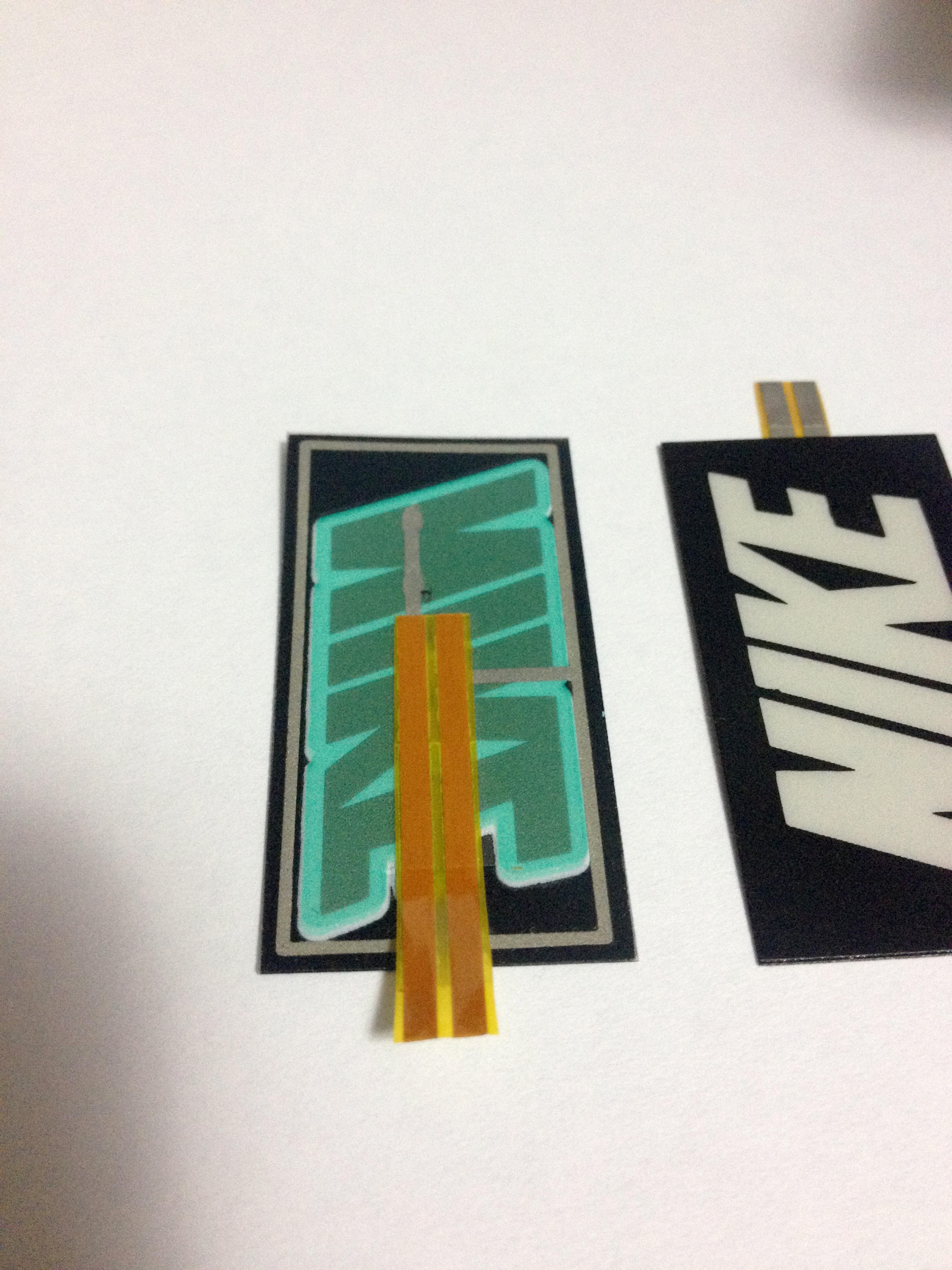

Here's the back of it if that helps. The front seems to be one solid piece. I'm not sure there's a decal to speak of.

Hey jhk1976You can heat the back up with a blow dryer and peel the wire tape (two copper lengths) and then reapply them the opposite way or you solder the wires like the other strap and just place them behind the logoI personally used new wire tape because I had some

Good to know. Thanks!

great idea :thumbsup problem solved :D
