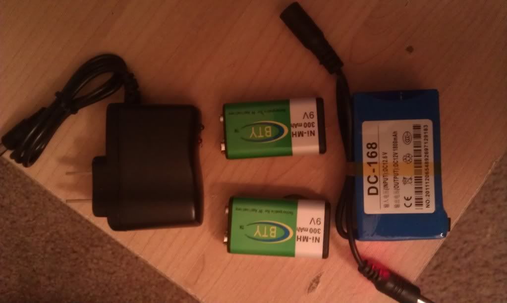

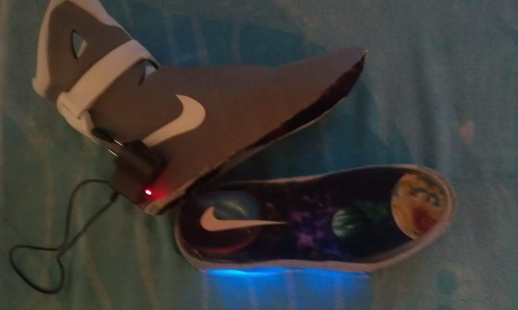

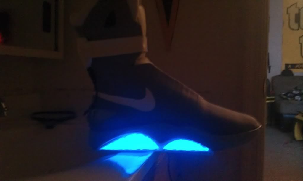

http://i1165.photobucket.com/albums/q586/FirstLabel/IMAG0176.jpg http://i1165.photobucket.com/albums/q586/FirstLabel/IMAG0181.jpg This set up[ gives me 18 hrs of no stop el brightness /9volt set up for led heel lights fall s short by only 13 hrs of life this set up is a win win .. mini 12volt comes with charger kit must install as desired. Thanks for all the positive comments.(B4TF) up coming project blk and red nike mags in honor of biff aka Mc Flys arch Nemesis this will be a must have add to all the relic collectors cabinets every hero needs a villain right ..Finished results will consist of Blk and Red Mags pit bull hover board display along side the Og grey Mags on Og hover board floating over water ..In the making as we speak will post threads an pics of progress i need a RpF thread trust me i know .
thanks, it looks awesome. Why pay $1000+ for a clonemag replica which may not even fit when you get a kmag and make your own like Caloss!

so how much of the foam did you have to cut out to fit the inverter?
and did you use 2 layers of foam sheets glued together, so 4mm total to give it strength?
do you have any close up pics of the joins?

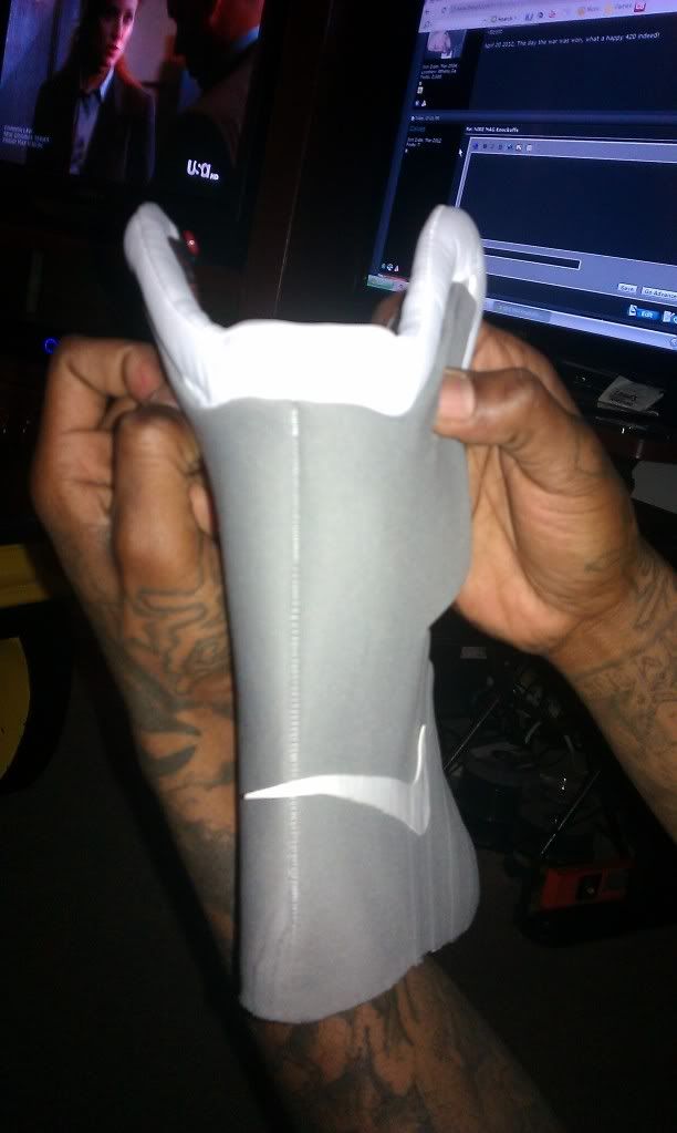

hot glue each peace carefully on each sides then plate a fabric stitch over each glued seem .http://i1165.photobucket.com/albums/q586/FirstLabel/IMAG0110.jpg outside flush look /inside view of fabric stitch before minded together . http://i1165.photobucket.com/albums/q586/FirstLabel/IMAG0159.jpg
For example, say i split the shape of the shoe to 3 pieces of foam sheets. 2 pieces for the back, and 1 for the front toe bit. Its just a matter of glueing these together? and which glue is best for eva foam.
I think you will find you should be able to heat form the toe box. To glue it, you can used hot glue or super glue.
thanks,
how many foam pieces did you split your uppers into?
two for back and one for toe area?

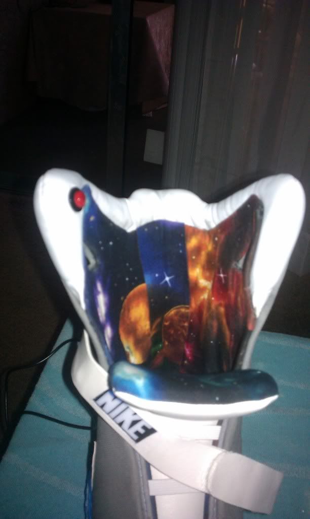

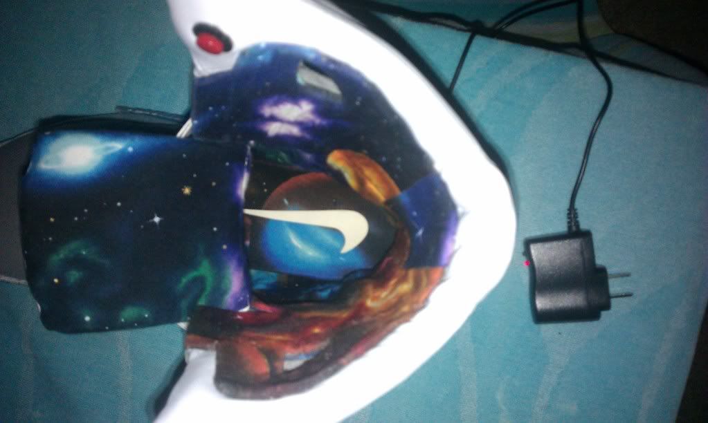

its 3 peaces all together /im about to put together another shoe in a day or two so i will put a step by step of how to make custom factory looking Nike Mags from start to finish/ from price of materials/best batteries to use for extra long life/best paints to mix for outer Mag sole along with stores an listings. ex sample inner liner peace- http://i1165.photobucket.com/albums/q586/FirstLabel/IMAG0159.jpg /Put together with inner liner to make flush/http://i1165.photobucket.com/albums/q586/FirstLabel/IMAG0114.jpg just hope this helps..If any questions feel free to ask.
fantastic job, without doubt the best replica out there. I think its incredible Caloss.
yeah i can see from the older pics you have an outer shell made from the 3 foam pieces
for the inner liner, did you add any foam behind that? or was just that thin fabric?
how have you stitched the main upper white puffed leather piece to the grey outer bit?
this is the bit i have no clue on. i think my mind is melting!
is it just stiched from behind the white piece?
The lights in the soles are too big? Are you going to fix that so that less light shows through?
i really don't want to make them smaller . in person they look real good /maybe its the brightness of the light that is throwing you off or maybe not, ill change it a little to give it that accredit Mag shape Remember this right shoe is only 75% done need to mold back led heel any suggestions guys..Or else it will just be sitting around collecting dust this is my plead for help .. http://i1165.photobucket.com/albums/q586/FirstLabel/IMAG0227.jpg http://i1165.photobucket.com/albums/q586/FirstLabel/IMAG0230.jpg http://i1165.photobucket.com/albums/q586/FirstLabel/IMAG0228.jpg http://i1165.photobucket.com/albums/q586/FirstLabel/IMAG0212.jpg http://i1165.photobucket.com/albums/q586/FirstLabel/IMAG0211.jpg

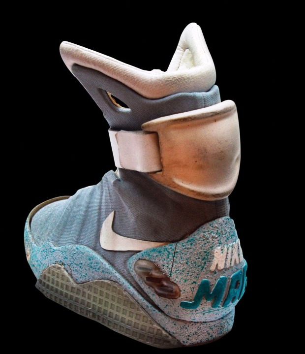

I forgot I even had this shot of the real shoe
attachment.php
Before I added the parts in this morning [waiting the for the glue to set before I sand], I was wondering if I even should because it seems in this image that part does not have a raise end to the slot pin thing, though now I have fitted it, I think it looks better. The dome part also seems to meet the ridges with a bit more of a smoother curve where mine is still quite angular, so I guess I will be sanding mine back more yet.
The original idea of having a larger cavity inside to hold a power supply is still valid I think.
