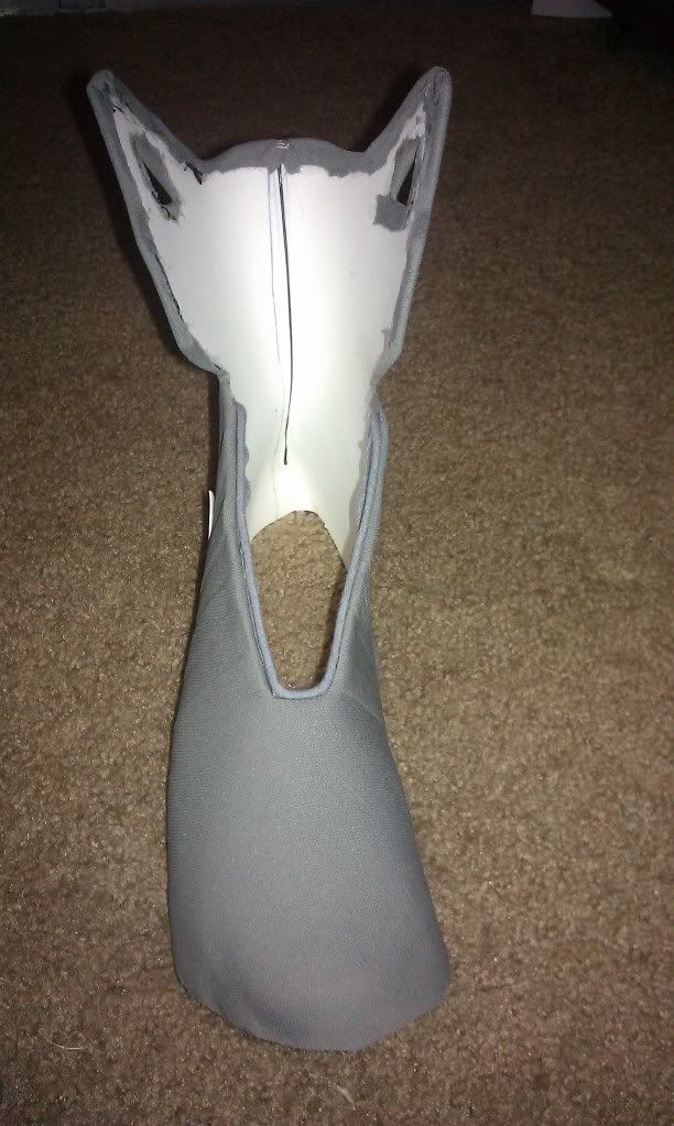

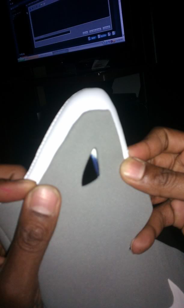

i'm referring to this post. With markpoons mags the hole is cut and the material is sewn through at the end, whereas in the picture of the nike 2011 mags its folded in on itself and either sewn internally or glued
when you glue your fabric to the shell pull the fabric into the hole an it will make a deep imprint so when you cut a slit into the fabric you can pull the extra fabric around the outside walls covering it with the fabric look at the real nike mag and picture it in two parts one inner liner one outer liner inside is gutted an prep i hope you get this ...if not i will send your pics of how i did mine its dead on to the real mag pm me with you e mail or contact info my pics or on photo bucket ...http://i1165.photobucket.com/albums/q586/FirstLabel/IMAG0111.jpg http://i1165.photobucket.com/albums/q586/FirstLabel/IMAG0103.jpg

stretch the fabric through the hole but make sure you have slack were the holes are so when you pull the fabric over the side walls to cover the foam shell make sure its done right you only have one shoot at it . when the tacky stick spray drys thats it no refunds get it ... easy way *****is to spay outer shell with super 77 tack spray then lay fabric over shell to bond [when you get to the ear part slowly manipulate the fabric through the ear whole enough to grab on other side and lay through ear hole to make look flush when finish it well look like a rip out on inner sheet but the outer shell will be flawless and flush just hide inner with 2nd inner sheet the out come looks as if you got it shipped from the nike warehouse

Funny that you asked ) i took the template of the real mag its on the net plain an simple ..i took the side image blow it up to the size of my shoe and began to make a 3d paper template of the nike mag kind of like( nick fox the build up) PHOTO of the all black foam shell... the rest is up to you ;

Funny that you asked ) i took the template of the real mag its on the net plain an simple ..i took the side image blow it up to the size of my shoe and began to make a 3d paper template of the nike mag kind of like( nick fox the build up) PHOTO of the all black foam shell... http://img.photobucket.com/albums/v419/FoxyMcFox/photo-23.jpg
I was referring to the finger pulls and the white back which turned out to be card and why the hole didn't go right through.
Actually what you're looking at isn't cardboard, it's the leather on the inside of the ankle on the other side of the shoe.
