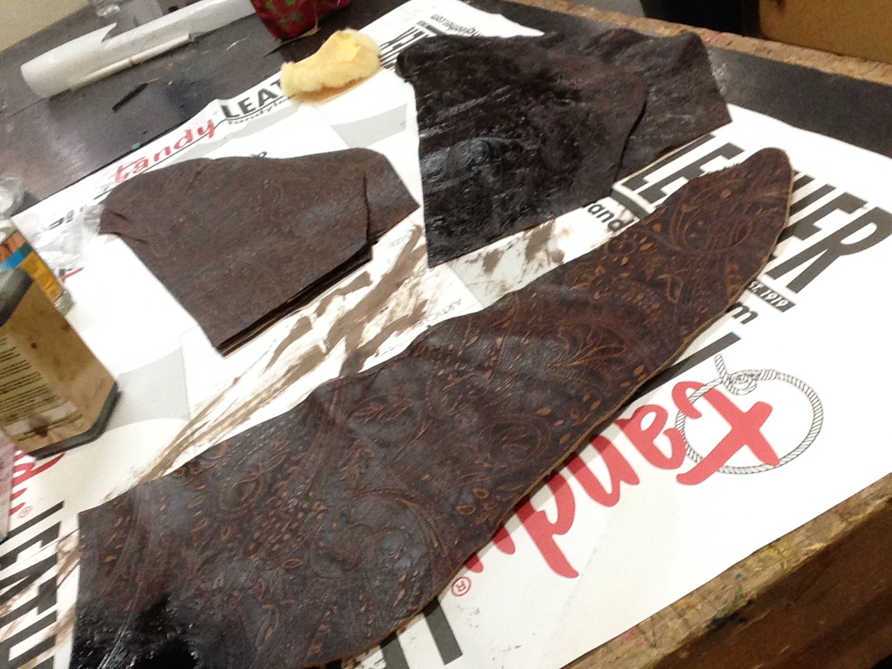

Cue Eco-Flo Waterstains from Tandy Leather. If ANYONE is at their last resort to re-dye leather, I would wholeheartedly recommend Waterstains (and I'll prove that in later project threads). Wide range of colors for mixing, no need for sealing or finishing, and they don't leave a high gloss (vinyl-esque) appearance.
One quick scrub with acetone to take off the original seal, followed by two coats of Dark Brown Waterstain, and the rapidly growing stack of leather was a lovely, weathered brown. For the edging/piping, I bought a few maple chrome-free pigskins (also from Tandy), cut them into 2" strips that were Barged into a 70' long piece (yup, 70 feet) and gave that two coats of Waterstain, no acetone required.
