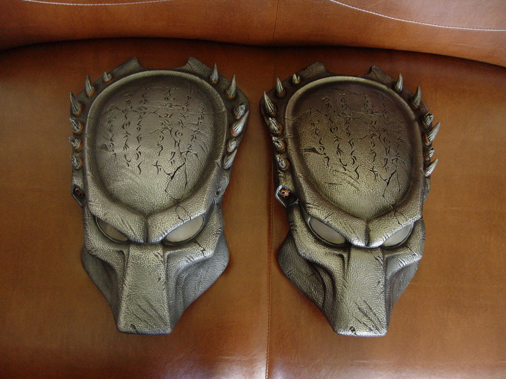

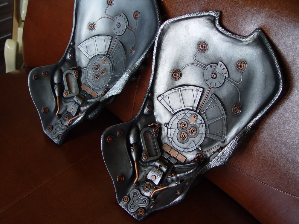

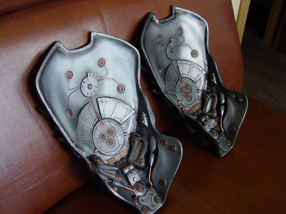

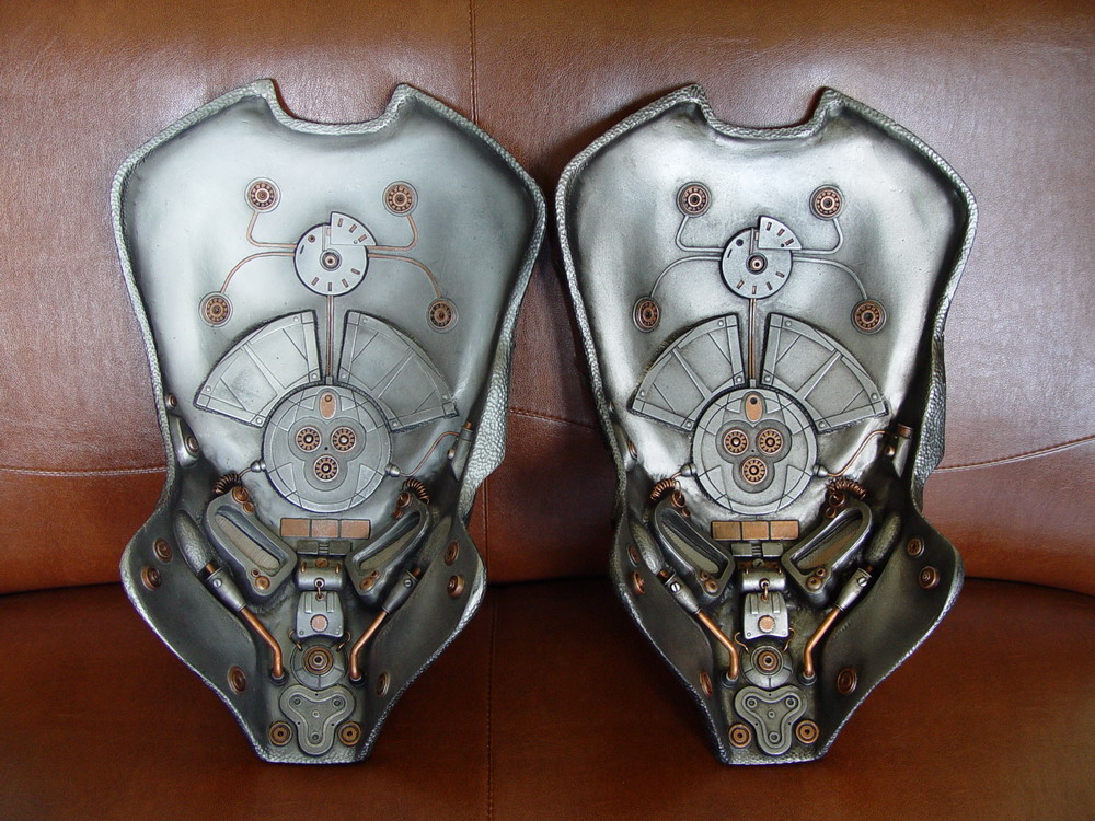

Two copies with different paint methods — old (left) and new (right).
It's for second mask:
1. black primer (acrylic, spray);
2. basic layer (alkyd metallic, spray);
3. copper elements (acrylic copper metallic, brush);
4. 1-2 layers of shade/wash (black oil paint with solvent) and drying/cleaning with toilet paper;
5. highlighting (chrome silver, dry brush);
5. 1-2 layers of matte varnish.
