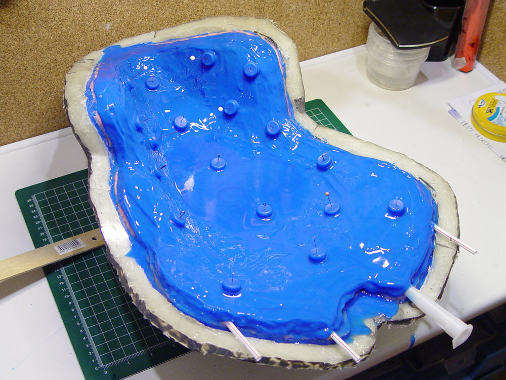

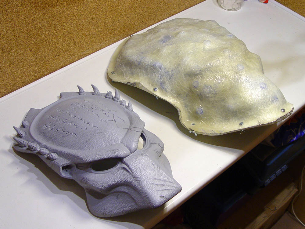

Thick layer of MoldSatr 30 + ThiVex.
Last layer of clear MS30 + locks
This keeps getting better and better all the time.  I'm dying to see the end result.  Keep going man!

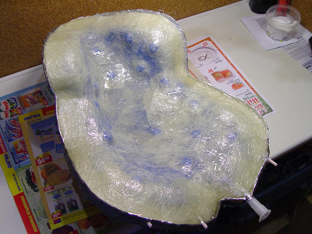

Last 2 layers of fiberglass on epoxy resin (wide borders made for M5 bolts with butterfly-screws)
Wonko, thank you! A few days wait for the first cast I think.

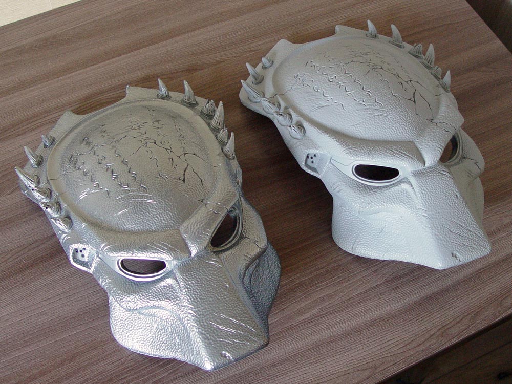

KmikzeKen said:
Congratulations on your first pull, it looks fantastic!
Thank you! A bit bubbles inside of the mask surface and 1,2l of ONYX (too much). Microsphere need to be added to plastic.

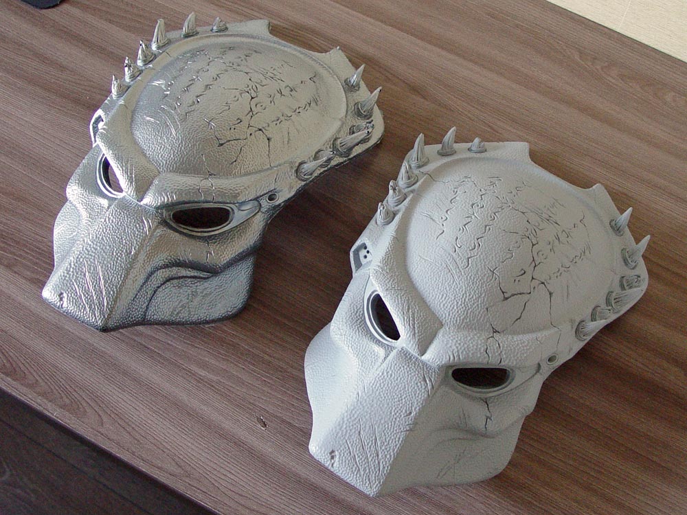

[SIZE=small]Can I buy one of your cast masks? What would be the price? It is an amazing work.[/SIZE]
incredible work!!!! the mold looks pretty, i tried to make a rubber mold brushing layers but really didn't work, i think the rubber quality is not fine
