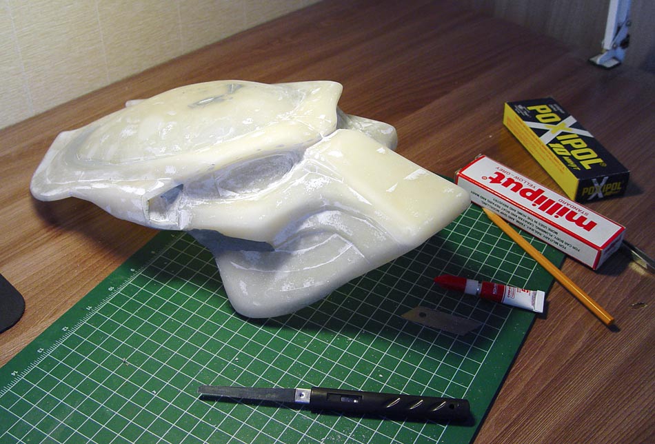

Now it's time to sculpt details and fix some errors. Poxipol, Milliput and some other epoxy stuff (Smooh-On FreeForm AIR for sculpting on inner side).

I prefer do not work with paper layers when sanding and priming. Paper is not a best surface for putty and primer even impregnated with epoxy resin. Epoxy resin (so as liquid compounds like SmoothCast) cannot impregnate microporosity of cellulose in whole paper thickness, especially with inclusions (like chalk and others) in paper types for aquarelle and graphics (over 200 g/m2). Liquid primer and paint on surface with paper parts gives spotty and uneven surface.
Now I prefer to cover model only from the inside. Paper from the outside surface can be easily erase with wet sandpaper or hard brush.

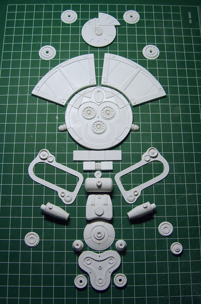

In fact that's interior of the Elder mask, but we cannot see Wolf's original. Some of details in original mask made of Panzer Tiger WWII plastic scale model (wheels, tracks, shafts, hatches) and the hand bomb from AvP movie.

That's almost whole set of interior elements of the mask. But still need sculpt some elements for eyes (borders) and seats for other plastic details. I used apoxy plasticine (two-omponent like Milliput or GS).
