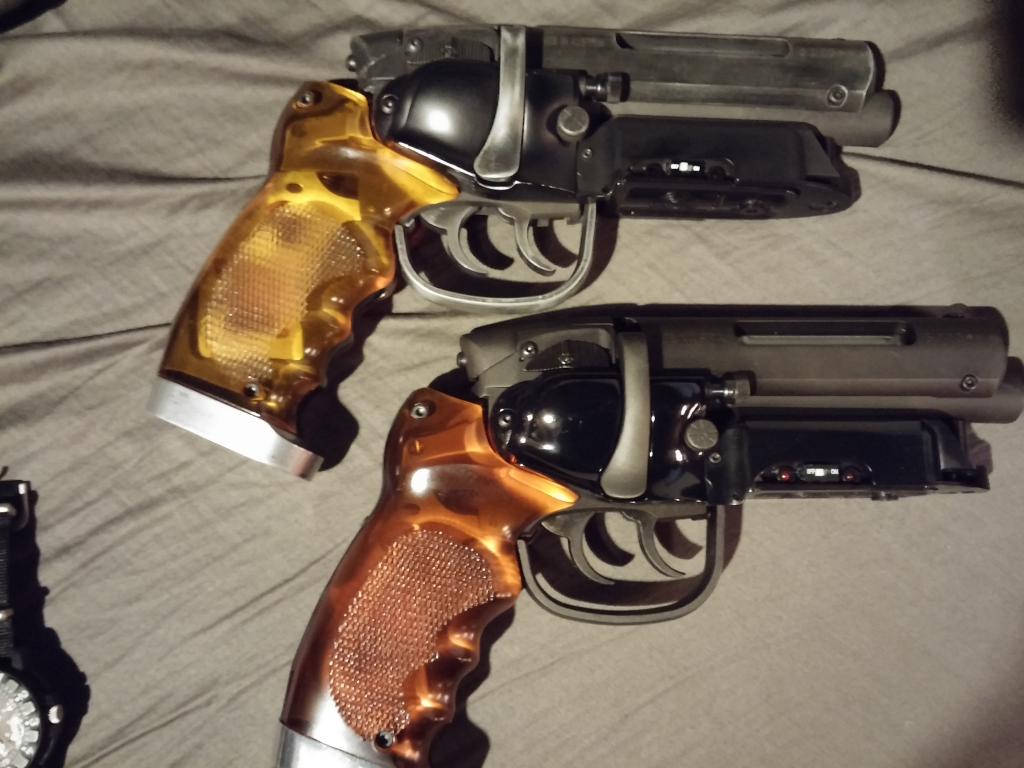

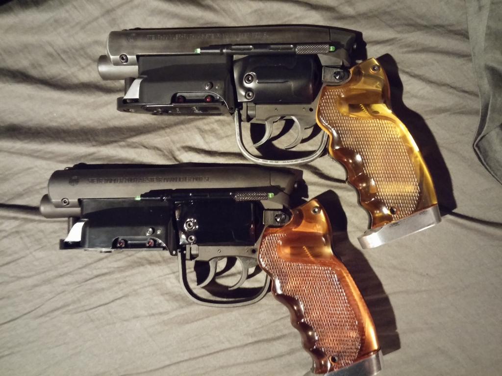

You need to polish the grips to get them translucent, a polish called Mothers Mag & Aluminum Polish was recommended to me and it brings them up great.
Took your advice and ordered the stuff right away. Here is the end result. The Kit on top (original super translucent grips) and the previously cloudy grips on my new assembled model.
Got my box from Japan!
Those grips look very nice, cld213.

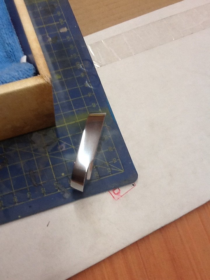

Hi clutch I sanded the butt plate and polished it up looks more accurate now :)
I would post a picture of the sanded butt plate not sure how to :( ??
...I tried using a scour pad just to knock down the shine.
Haven't looked close enough yet to see if it is plated. If only polished, no prob weathering. If plated, you don't want to break thru the plate on the edges ( the thinnest part of plating) or you will end up with some spliain to do. ( and crying)
I gave mine a rub with 1500grit wet and dry just to take the slight texture off then finished in 2000 and polished it up with G3 compound it came up great , I was worried about rubbing the edges thru I took it easy on those but the end result looks much more accurate hoping to get a steel barrel next

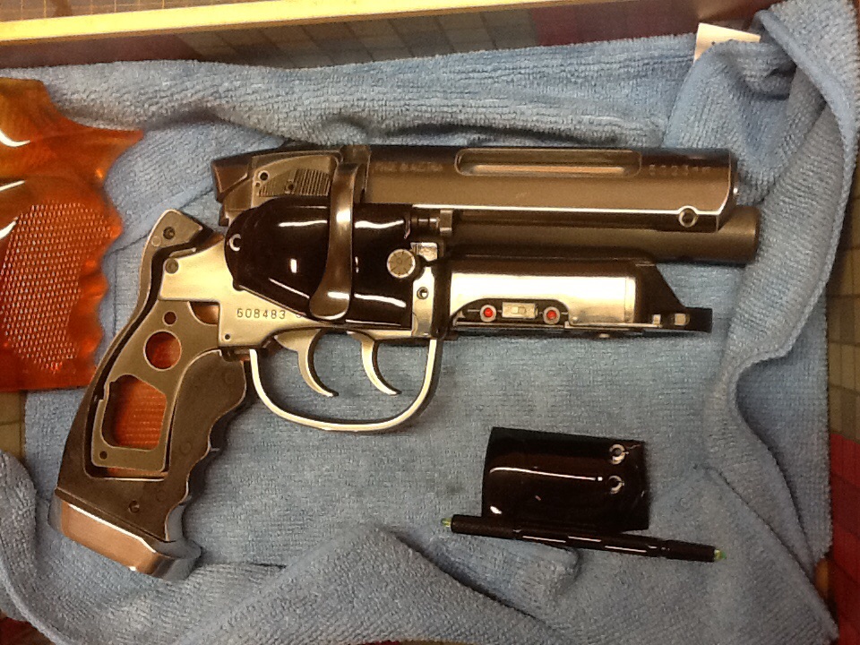

i bought the assembled kit and stripped the black finish I've been bluing it this week it's coming along ok so far :)
i will try and post some pictures
I'm hoping this works :) pictures to follow
picture of the scuffed and polished butt plate
i recieved my assembled blaster and stripped it down , I removed the black finish with perma blue remover and a grey scotchbrite
it fizzed up a little but removed the black fine , I then sanded the parts with 800 wet and dry and going up the grades ending
with a 2000
then I carried out the bluing process that vfx freak posted in a earlier thread about the kit thanks for sharing vfx freak
it worked great for my first attempt I was pleased with the results it worked much slower doing the 6% dilute perma blue mix
then working a bit of a stronger mix until the desired effect is achieved :)
Here are some pictures of my blaster as far as I've got I haven't touched the barrel as i want to replace with a steel one :)image.jpgimage.jpg

^ That's looking great! Very nicely done, Mr. mfletch80. I'd say that's a huge improvement over the matte black finish. You'll discover that the steel, (once you get a steel barrel from whichever Dave ends up making a run), blues much more easily than the zinc. You don't have to start with such a radical dilution.
Very nice Fletch! If I can get the finished one looking that good, I might end up selling my kit.
