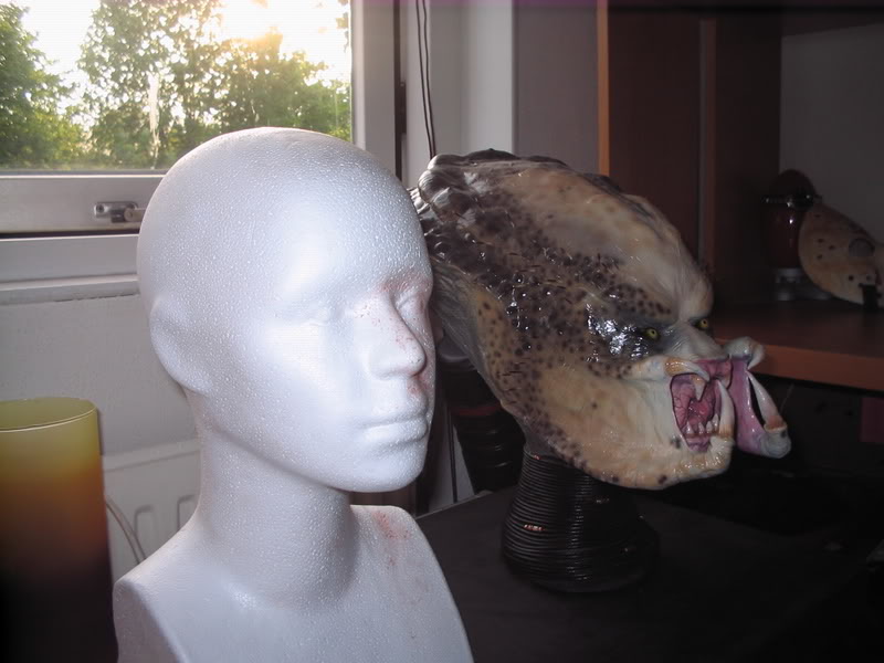

Btw thats the 1st pred on the photo (just for size but thats it for the people who havent seen it)

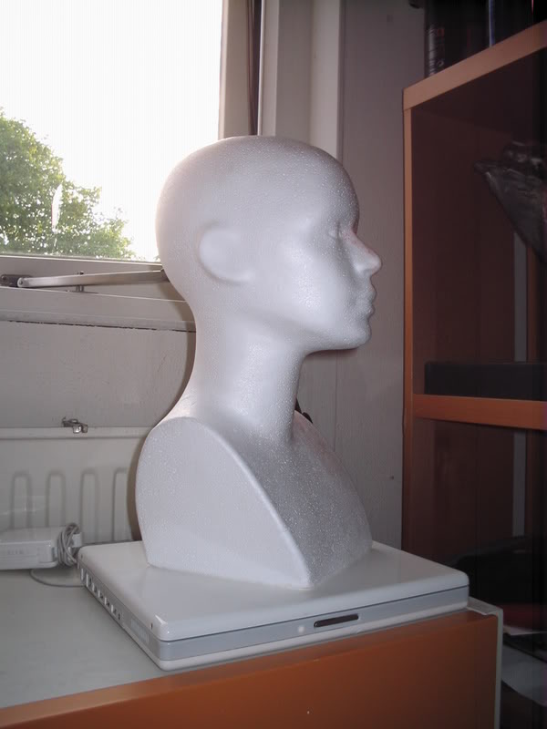

As u can see i bought a foam head...
Im afraid that if i buy clay that needs to be baken the whole thing wil melt and collapse..
Damnit!!!
Should i use this or do you think i should use something else? (if yes, what?)

You don't want to cook the thing to harden the clay anyway. You'll want your clay "somewhat" soft... Most people here use medium firm oil based clay of some sort. If you're fast enough and skilled enough to keep the sculpt cool and damp for the enitre time you're sculpting, you can use water-based clay as well, but if you have no experience with it (water-based), it's going to crack on the armiture long before you ever get to the molding process (I've seen 2 or 3 threads regarding "why did my sculpt crack?" just in the past week or so). The reason you don't want the clay to bake to harden is that if you have even the slightest of undercuts, when you try to crack the mold halves open, you'll either have mold-lock or the hardened clay will damage the mold if you can open it. You're probably best going with a medium firmness oil-based clay such as Chavant. I use Kleen Klay medium for everything, but it's expensive and not easy to find. Once your sculpt is done, coat it with some Crystal Clear spray (at least a couple coats). This will help keep your sculpt somewhat safe during the molding process.
Also note that the head armiture you have is much smaller than your head... You'll need to build it out (you can use clay to do this) to match the proportions of your head first. Then you can start adding your clay for the actual sculpt. Also bear in mind that latex will shrink once cast in the mold, so you'll need to make your sculpt big enough to accommodate for any shrinkage... say, maybe an inch circumference over the enitre sculpt. Hope that helps... good luck and keep us posted.

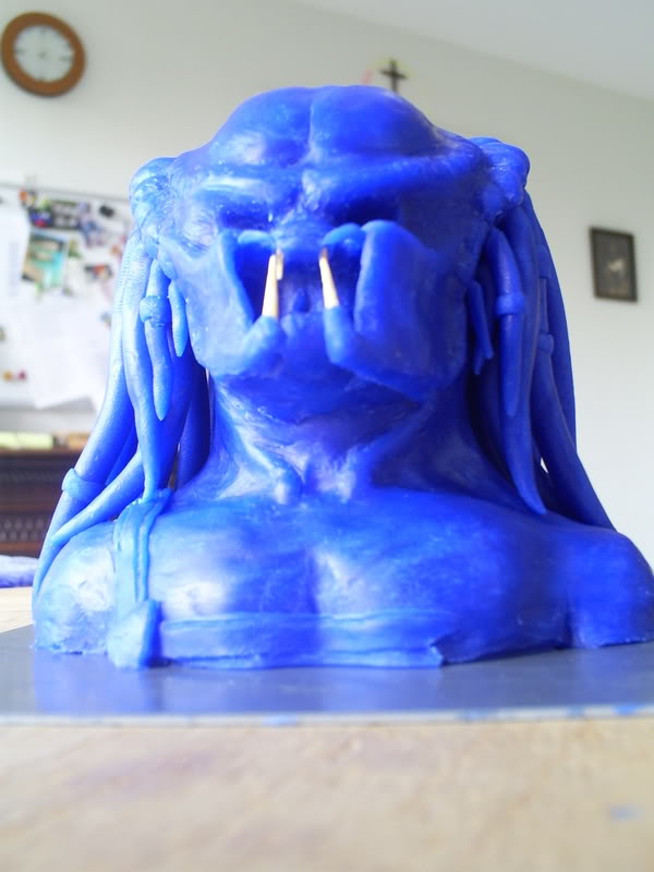

Im just searching for the right clay.. bought myself a bit of bee wax like clay. just to try it out.. seen the fact that i didnt have enough for the full head i made this fella.. Did this in a couple of hours.. (2-3) Of course this is just a rough sculpt just to learn a bit how to work with the clay..
Im not shure about the clay.. What do you think?
Its about 12 centimeters big
