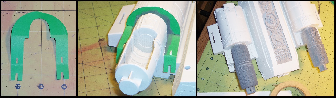

I was working on the engines today and came up with this nice little stencil for helping to paint the engines. I really didn't want to try to tape off all those curves so I cut out this stencil out of some card stock. Fits in there pretty good. Of course, then you have to tape off all the rest, but it helped immensely. This is just a first base coat to get some gray on the engines. I will go back with some dry brushing later to lighten them up and weather them.

I like your cardstock mask. That's a good idea I'll have to file away to my brain.
