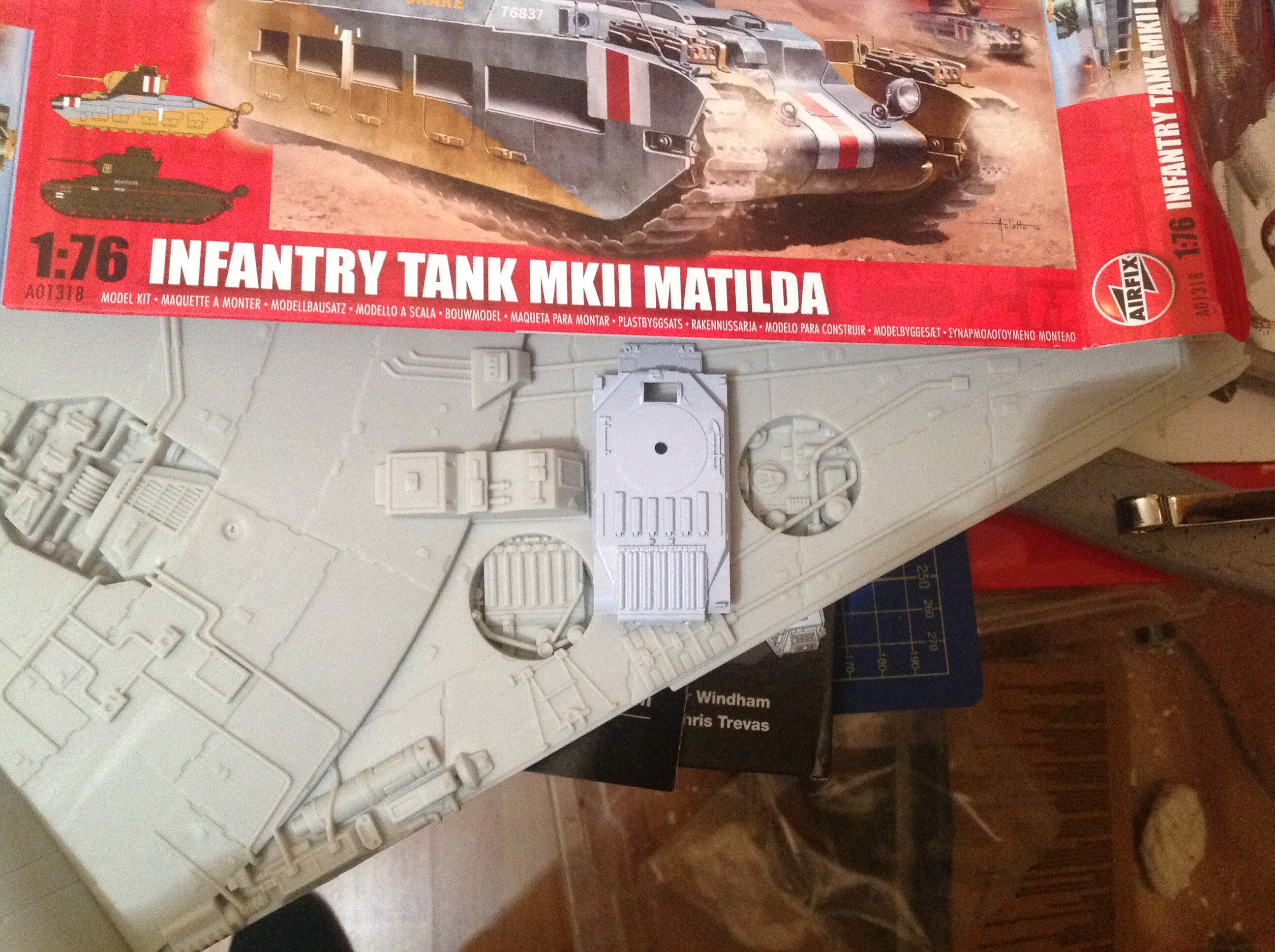

, I meant to reply sooner to this question with a photo of the 1/76 scale models with the hasbro , see below . Matilda 1/76 looks correct , I am not sure if the panther is correct detail wise , I may need a different variant .

A question for everyone , are you happy with the height of the side walls in proportion to the hasbro model , is it accurately scaled ?

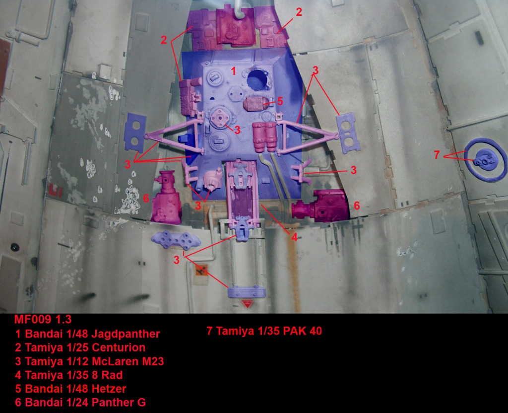

The original Falcon built for Star Wars used some 1/35 tank parts,.....when a smaller, easier to film Falcon was required for the Asteroid scenes in next film, The Empire Strikes Back,....they down-scaled the ship so that they could use as many of the same models in a different scale.....1/72, 1/72 for this 32" model....
...so this Hasbro is a bit smaller than the 32"......some of the 1/72 &76 parts although a little larger for this toy, you might be able to get away with....the back end of the Panther looks ways too large for the engine deck.....(but theres no need to replace the panther part anyway),.....but I've used some for some of the inserts,.....I don't think they are too noticeably large there

Vacformedhero its one thing that hasn't been checked in any depth, but I think the sidewall heights are good :)

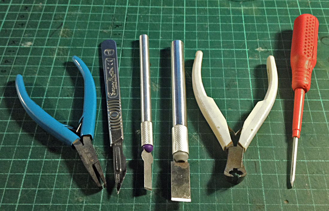

also these are the tools I'm using most for getting rid of bad stuffs.
The snips for chomping the best of it away and then the scalpels and such. The screwdriver has been sharpened into a chisel as nightrider has explained about 2.5mm wide.
I could do with another about 1.5mm wide too.

Thanks , the panther does too large all right, I agree the hasbro detail isn't bad

Thanks , I thought you had a secret weapon, I picked up some cheap micro chisels but they are not quite sharp enough , I have been using the scalpel horizontally but it need further cleaning. I'll try sanding it with very fine board.
