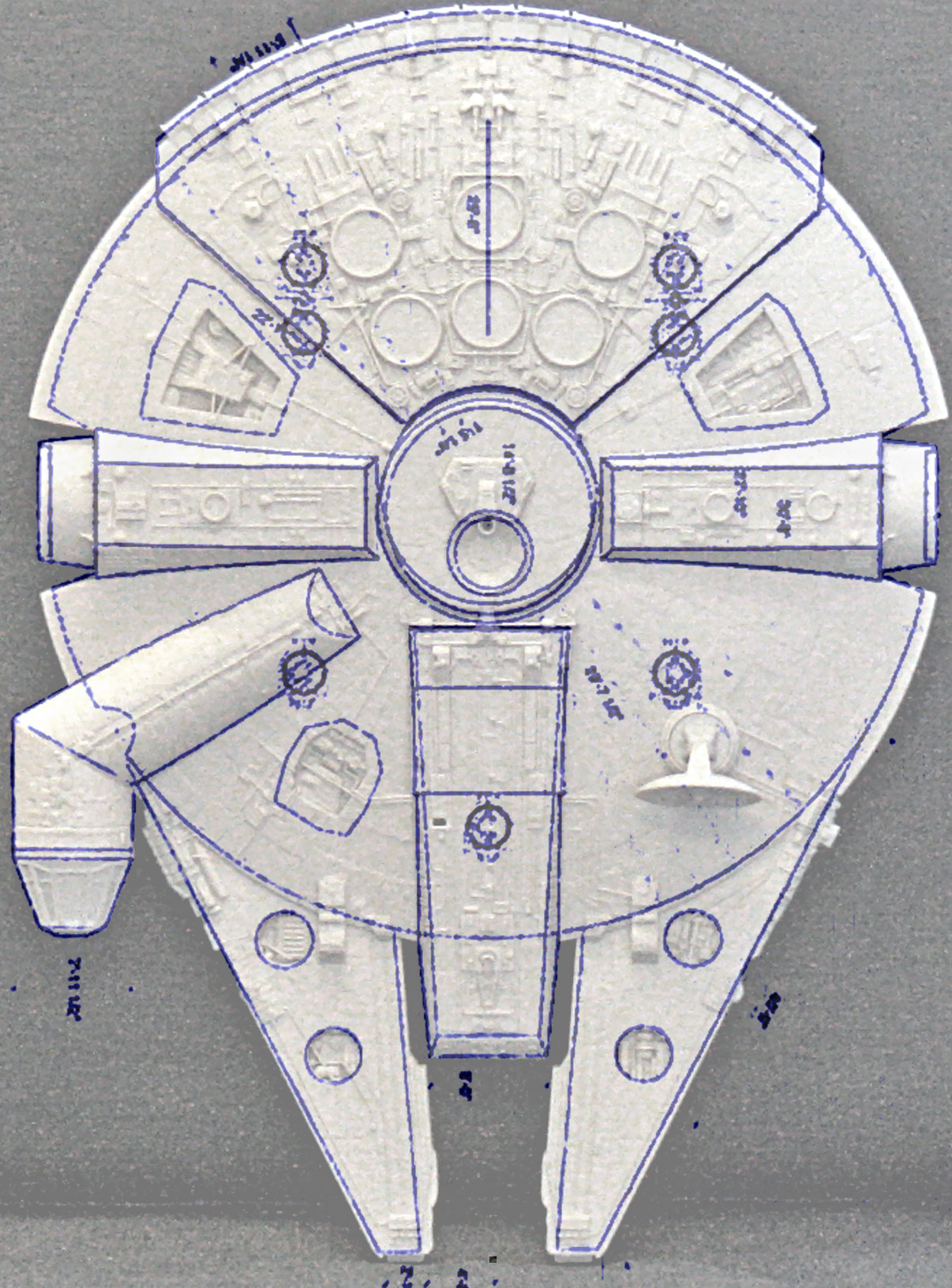

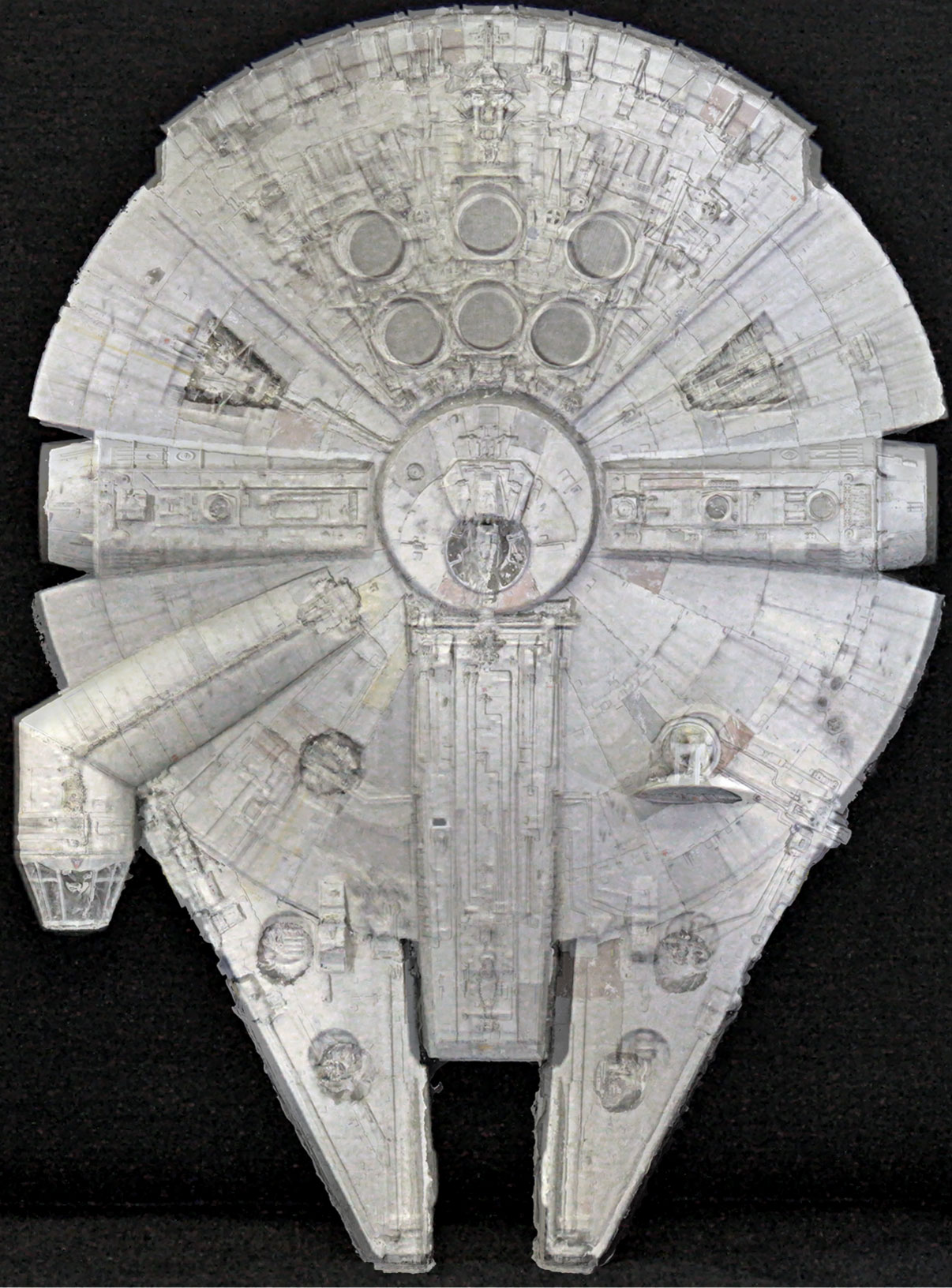

Ok, I took more comp shots with a much better camera..... with an optical zoom..... from 22 feet away..... as opposed to the first pics that I think were 9 feet away.
And there is a difference. I'm much happier and now I think I have solid answers to the panels out/ walls in decision that has held me up all week :)
VfxsupHsmfV2Web_.jpg Vfxsup Photogram five footer and the Hsmf.
MaruskaHsmfV2Web_.jpg Maruskas 32" plans and the Hsmf,
HsmfEpVIIV2Web_.jpg And because it was easy to do one more pic, here is the EpVII plan and the Hsmf
In conclusion panels stay (yay) and walls go in (boo) with the exception of the front panels if you are pushing towards the five footer.
I really didn't want to cut the walls out but hey, I'm only doing this once so whatever.
Best news is I no longer "have a bad feeling" about the mandibles.
I will update previous comp posts to reflect.

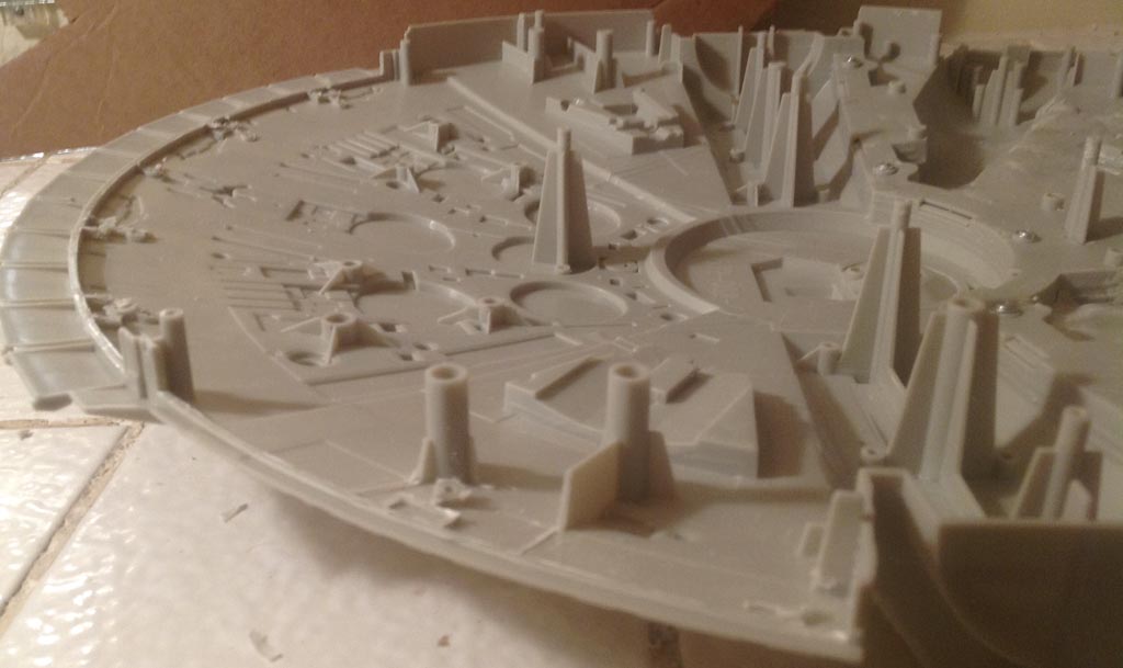

TronGod could you post some pics of the cuts you made to the walls and engine area please.
I have to do this next and it would be helpful to get some idea of how hard its going to be :)
@TronGod could you post some pics of the cuts you made to the walls and engine area please.
I would not say that it's hard to do, but more that it's a pain in the ass :)

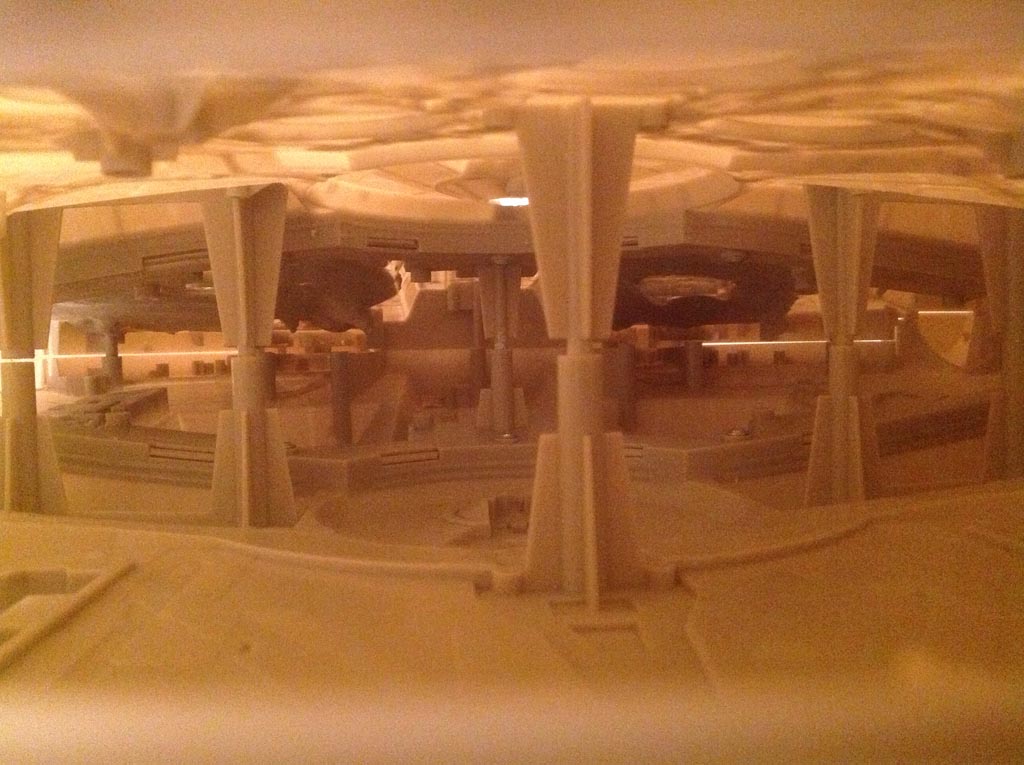

Neat shot thru the engine panel(now that it's gone)

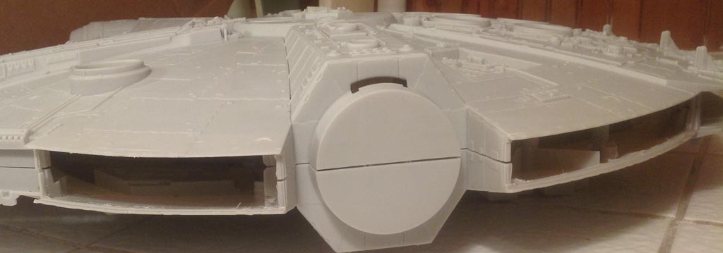

Like I said the other day, i've only done 1 side, and 1 rear and the engine panels...Still have to do the other side. Also note on the engines I'm trying to leave the edge support wall intact.

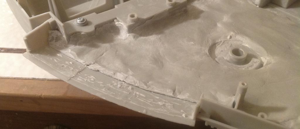

In one shot you can see the RESIN I've used to keep the hull strong. However, I would recommend cutting everything out 1st before doing that - as I have cracked my resin a tiny bit by all the rough housing going on when cutting the side walls out.
Keep in mind also...that removing the engine panel..makes the top half start to cave in a tiny bit..the bottom still has bits on it thats keeping it straight..I may or may not leave the bottom alone.

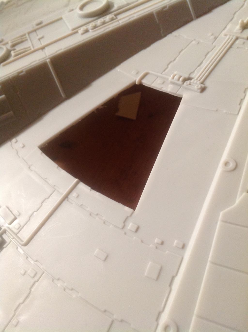

No turning back now! :) This part wasn't that hard to cut out cleanly.. Anyhow..plan to push the walls out on the part I cut out and re-attach.
