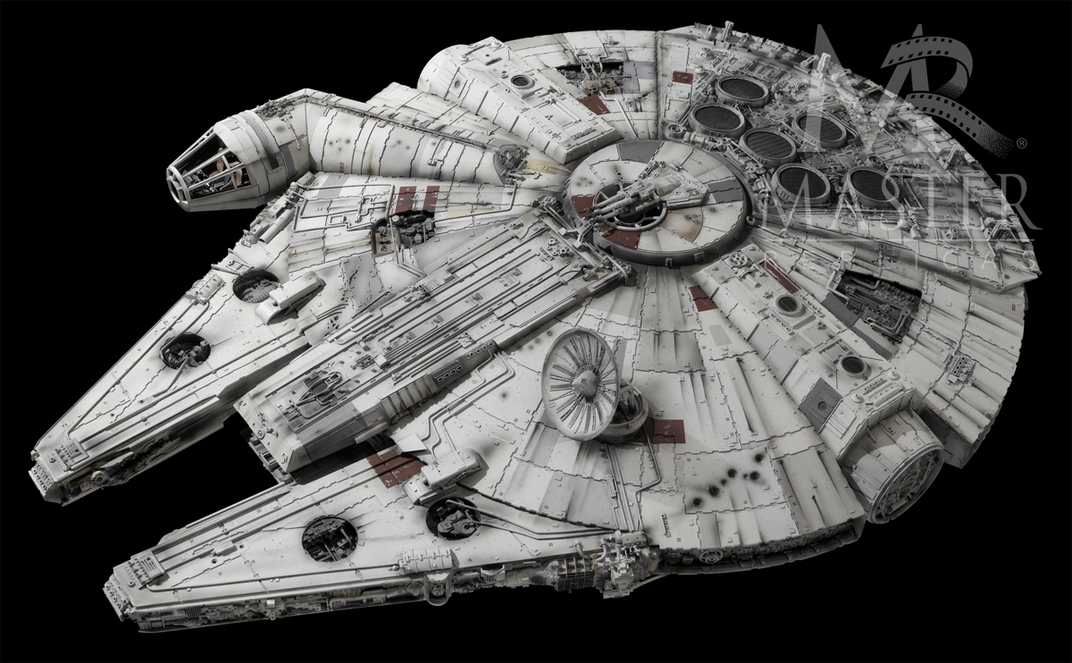

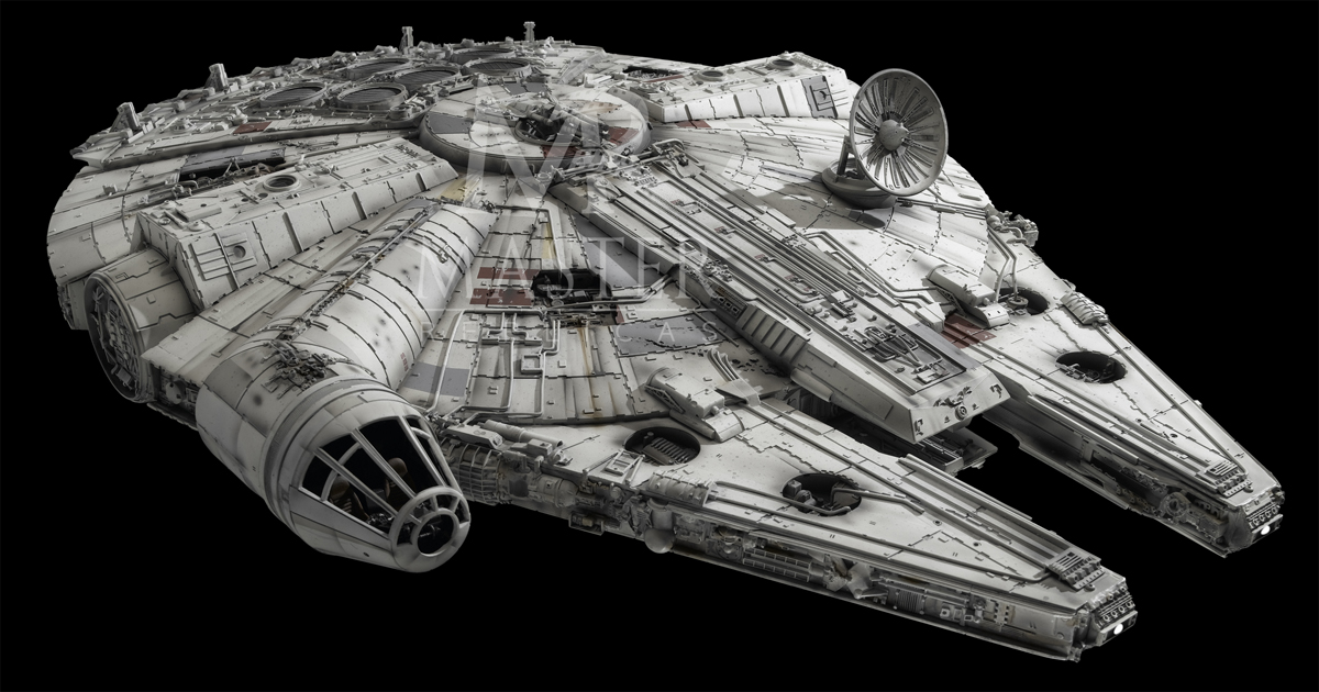

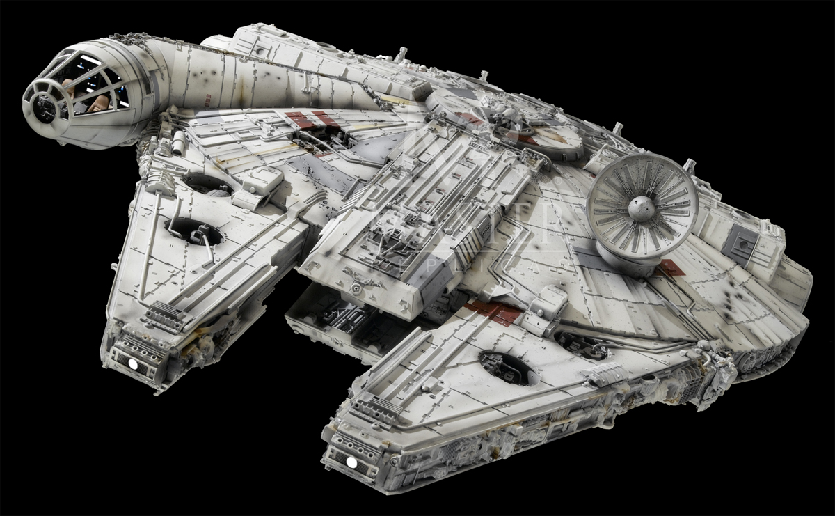

Also, MR published some very nice promo shots where the model looks particularly white under all the weathering, and personaly I think it looks great.
Great pics. That color is so elusive, I like to call it "Edge of white gray", or the cooler term "Starship gray".
