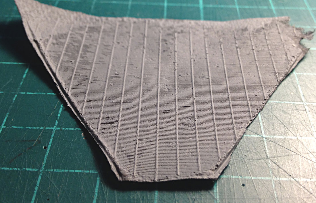

Oh yes :) success, It needs a bit of refining but it works.

Now this is a piece of kitchen towel painted with pva and pressed into the tie wing after my release agent was dabbed onto it, the release agent isn't working too well and it pulled some of the original paint on the wing away with the paper but it looks ok and it gives me 8 vertical lines across the diameter of the circle area which is perfect for the 32".
Gave it a quick coat of primer and that's a bingo.
It's paper thin and now I don't have to cut the vents out which looked like a pain in the .....

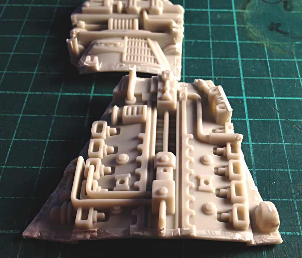

Also here is the triangle bit cut out with the walls cut down to the details so all i need to do is make new walls outside the old ones.
Thanks J, the other good thing is I can paint it separately and stick it on when I get to the weathering stage, which is nice.
View attachment 413380 click to love the pic.

Okay this part some of you are doing has been confusing me. If this part is accurate why are you cutting it out and adding new walls???

Because the parts walls are flush with the armor plating, you need to cut it out and make new walls outside of the parts base to have the armor overhang.
It should look like its glued from behind not added through the top.
I hope that makes sense.

You can see it in this picture..See how the details continue underneath the hull panels. Looks MUCH better this way. Looks less like a toy, also helps make the model look in scale more by having these thin panels overhang it.
Ahh,.. Crap!!!!!!!!!!!!!!! Now I'm gonna have to cut these all out.
I assume it's like this for all of them?????? :(
Yep, looks much better. Gonna have to do it. Crap!!!!!!!!!!!!!!!!!!!!!!!!!!!
