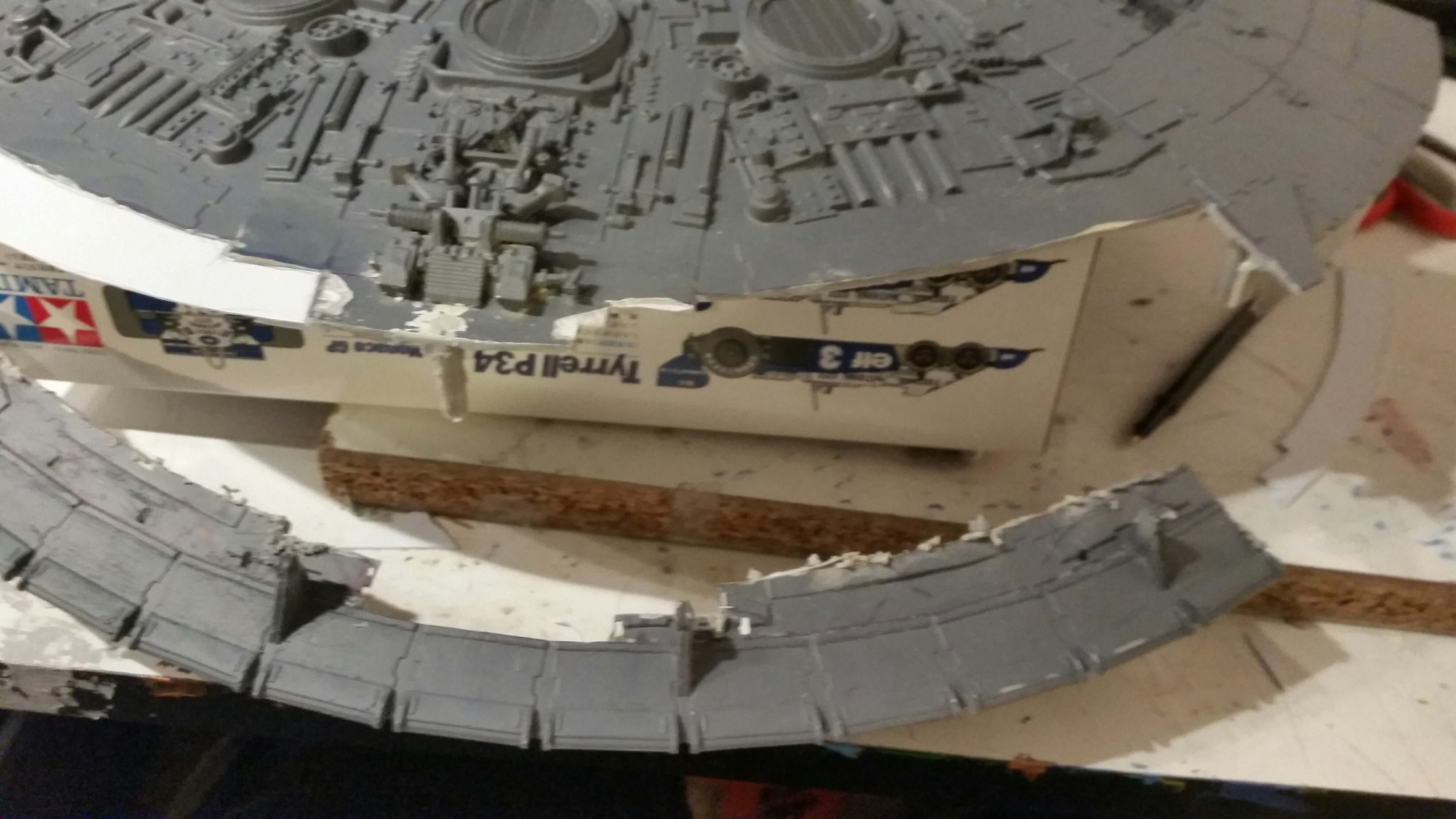

im a newbie here but my ANH version is here
http://www.therpf.com/showthread.php?t=231344
i may cast later but cannot guarantee when I would be ready

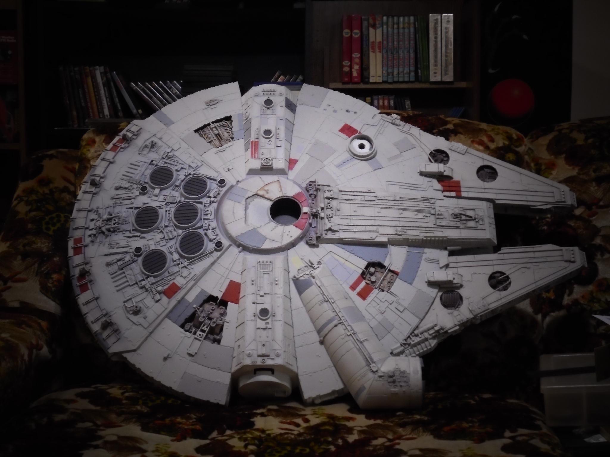

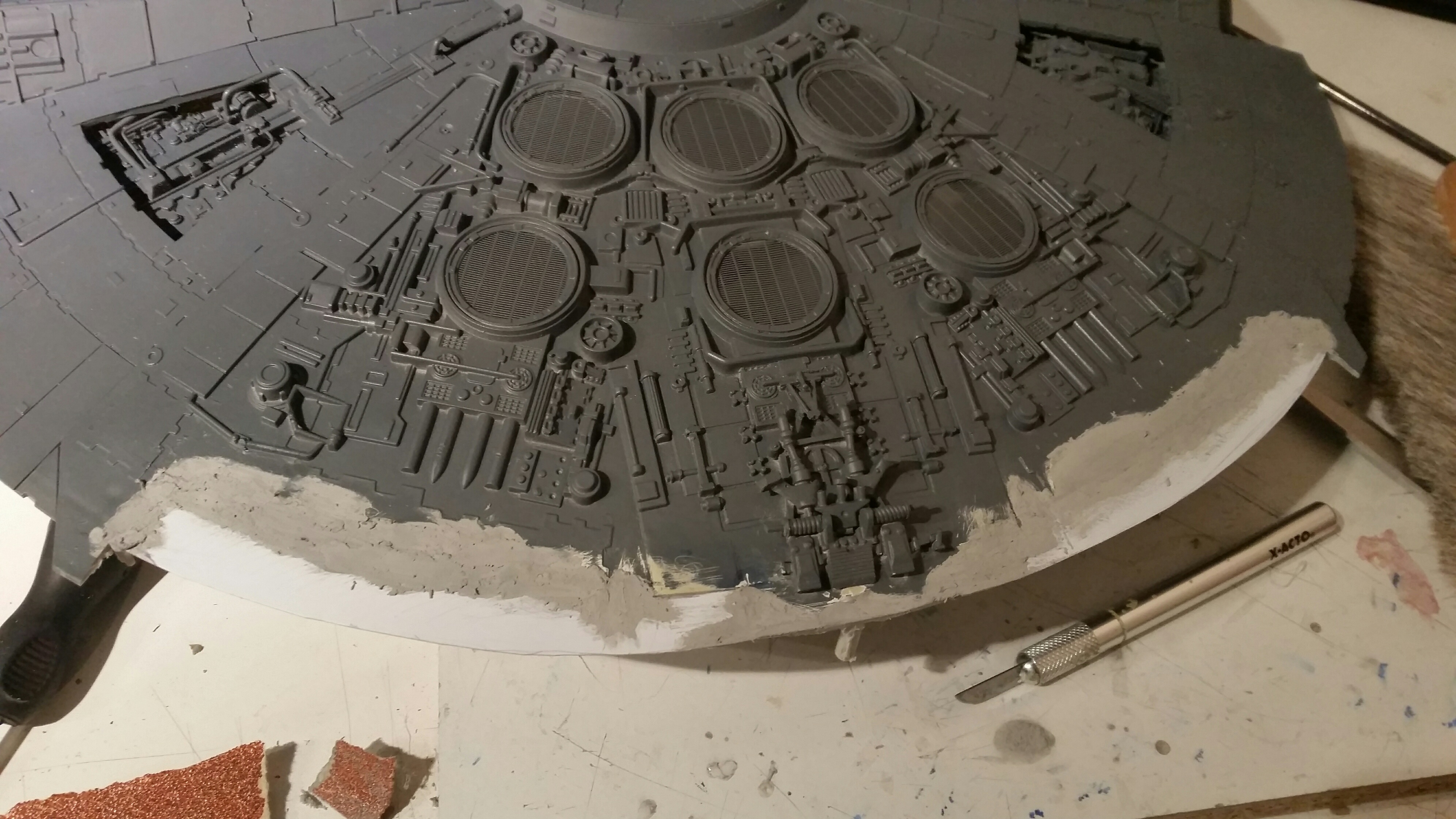

Were I am at on my work. DSC00094.JPG:cool

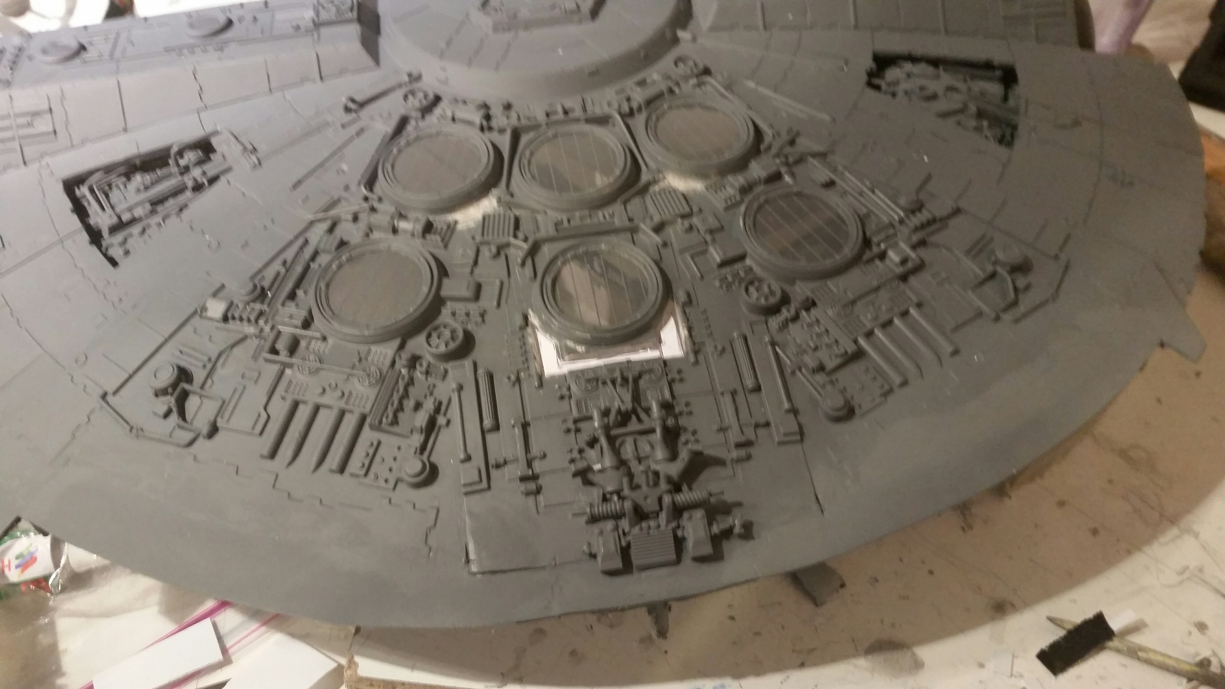

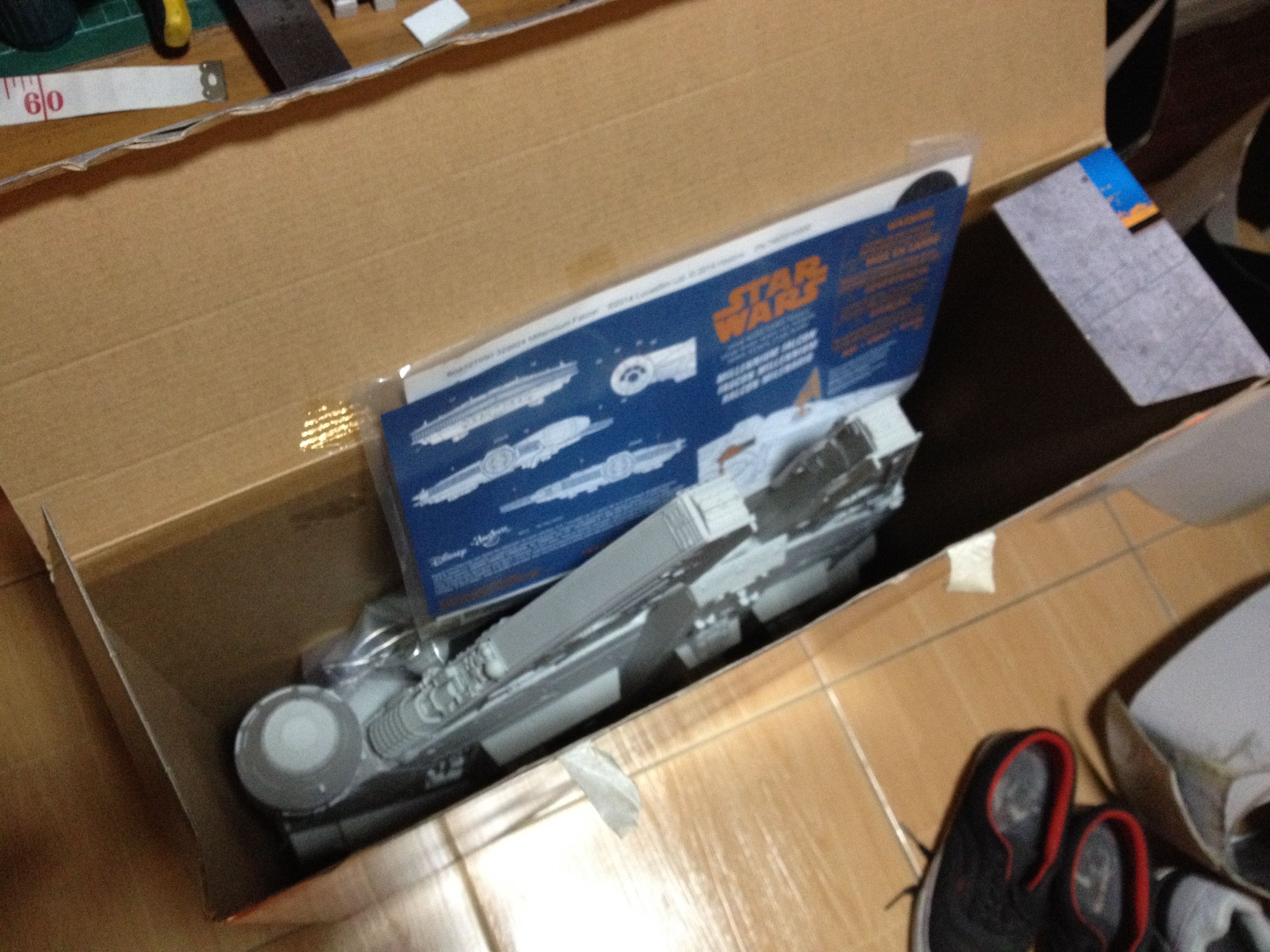

Finally, thanks to our local 501st Garrison CO who trooped last week in our annual ToyCon and alerted me on a vendor selling these. Its the last one and not quite cheap ($150), but I guess its better than going thru the hassle of ebay, wait time and probable high shipping cost for something this huge going half-way around the globe.
I also got to finish scanning over the 113 pages of this thread where I left off and also happy to know that there are now resin kits available.
With all the new info swirling inside my head, Im thinking of where to start. Maybe cutting off the cockpit windows and landing gear stomps? I read of heating up the plastic and using an xacto knife, but could a dremel with a cutting disc work as well?

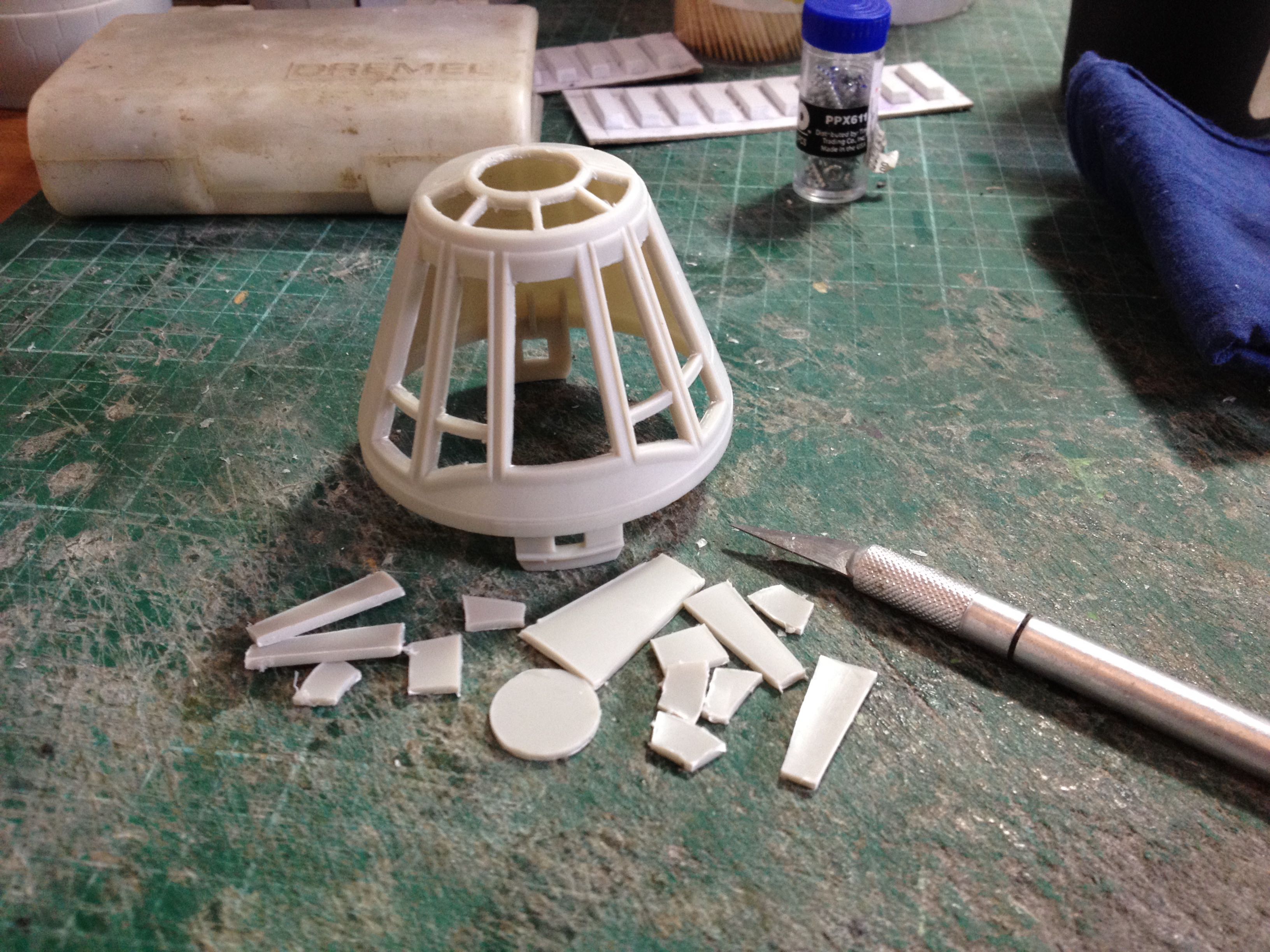

Dremel works but but this plastic melts literally spraying it , heating it and using a knife is very effective, also this plastic doesn't file/ sand I use small chisels to remove surface details , slowly slowly catchy monkey
Xactos worked great on mine. Cut out the engine vents, gunner windows, and landing gear no problem.
Careful when heating the plastic, i use a heat gun and it literally needs about 5 seconds on low! The plastic turns to goo real fast and crisp details will soften out! i have found that if you can smell the plastic you have gone too long. Just heat, cut and re-heat when u start to get resistance, and as stated above, don't cut toward your hand or body and "go really slow!!!" I have already sliced every finger on my left hand!
Dremel cut off blades work well with cutting off the engine flaps, it shreds the plastic, but you can for the most part slice or pick off the mess. Humbrol Model filler is the best thing I have ever used as well!
Anyway, good luck with the build!!

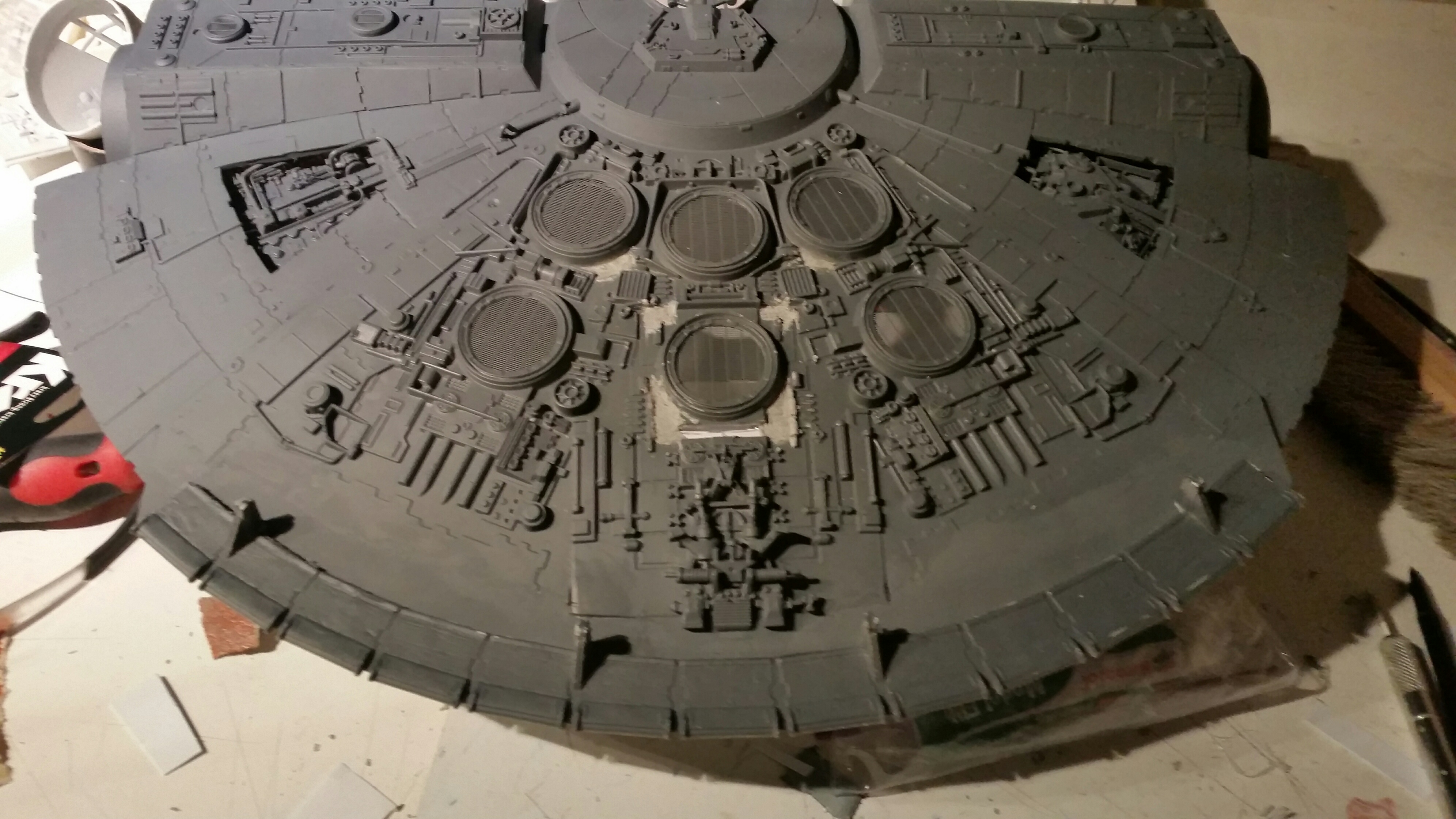

20150621_001700_resized.jpg20150621_011645_resized.jpg20150622_175300_resized.jpg20150623_062027_resized.jpg
Hairdryer and sharp exacto - worked fine except for the time I stabbed the whole freaking #11 blade up to the hilt into the muscle of my thigh. Star with the landing gear stumps, says I - lots of plastic to be removed, which will let you get a feel for how it cuts without risking damaging the ship.
Okay, after reading all comments I have to say cutting up the cockpit windows seems like a daunting task so I took the MF out of the box and kinda played with the xacto knife and scribed one side of the middle window. Lo & behold, just after a few passes the blade went thru - so took the task and removed all screws and took both halves apart. It took me awhile to figure out how to remove the 2 docking bays and the cockpit and glad my patience held to figure it out instead of grabbing my dremel.
Once the cockpit was off, I continued with cutting the center window I started earlier. Without the aide of a heat gun or hair dryer, I finally finished all in about 45min. Too long, I know.
I guess living in a tropical country kinda helped :p
Question: How did you guys remove the 5 landing gear stomps? Did you remove just the vertical structure from the exterior or did you remove the whole rectangular assembly thru the interior using the rectangular pattern as a cutting guide?

I started from the sides of the stumps. Just me, and I'm sure I did it a harder way than probably neccessary, but the problem with using the rectangular area I felt, and to be honest, it's not a HUGE problem, is that the stumps actually extend very slightly past the recessed rectangular textured area. Ultimately, you're going to end up having to cut slightly larger than the textured area to completely get rid of the stumps. I took them down as far as I could from the outside, sides with the blade, then dremmeled as flat as possible to get a really good look at just where the perimeter will need to be cut.
Hi Timmy,
I got what you meant, the center and the 2 rear landing gears had this recessed sections. I did cut all 5 gear stump outs from the interior using the rectangular shapes as a cutting guide while the recessed portions had to be cut from the exterior to get a flat result. Right before the 5th gear got removed my xacto blade broke but still usable, unfortunately my fingers were a bit sore so I called it a day.
I feel the gunner's window may require a more delicate cutting approach due to the narrow frames so I will probably try the hair dryer approach. How did you guys tackle the other window on the opposite side? With the gun molded into the window, I fear a re-build is necessary.
