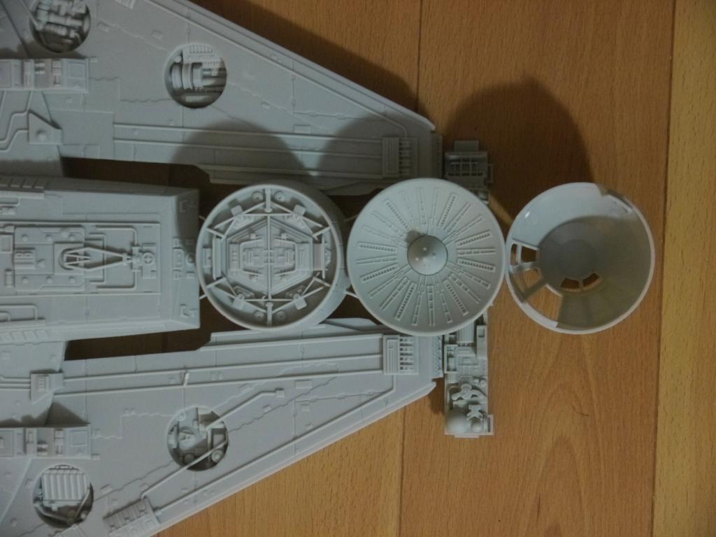

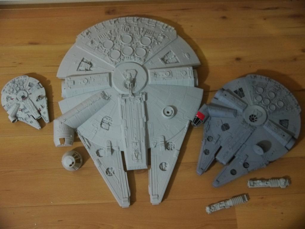

Heres some comparisons with the FineMolds kits:
Honestly cant get over the size & the possibility of this thing
The usual measurement that should be the same is the outermost diameter of the docking rings, the front of the jaw, the diameter of the cockpit tube & the dish.....
.....the dish is slightly larger than the others.....slightly,....I dont think I will reduce the size of the dish:

Grabbing a seat, too! :) Thanks for the comparison shots, John. Finally we have something that looks like a Falcon without our having to strain. By the way, the curvature -- is it really more 32" than 5-foot? If it looks closer to the MR, I guess going for a 32" won't be a bad idea as there would be less parts to scratchbuild. I'd hate to see all that nice 32" detailing -- the Porsche transmission and engine deck -- go to waste.

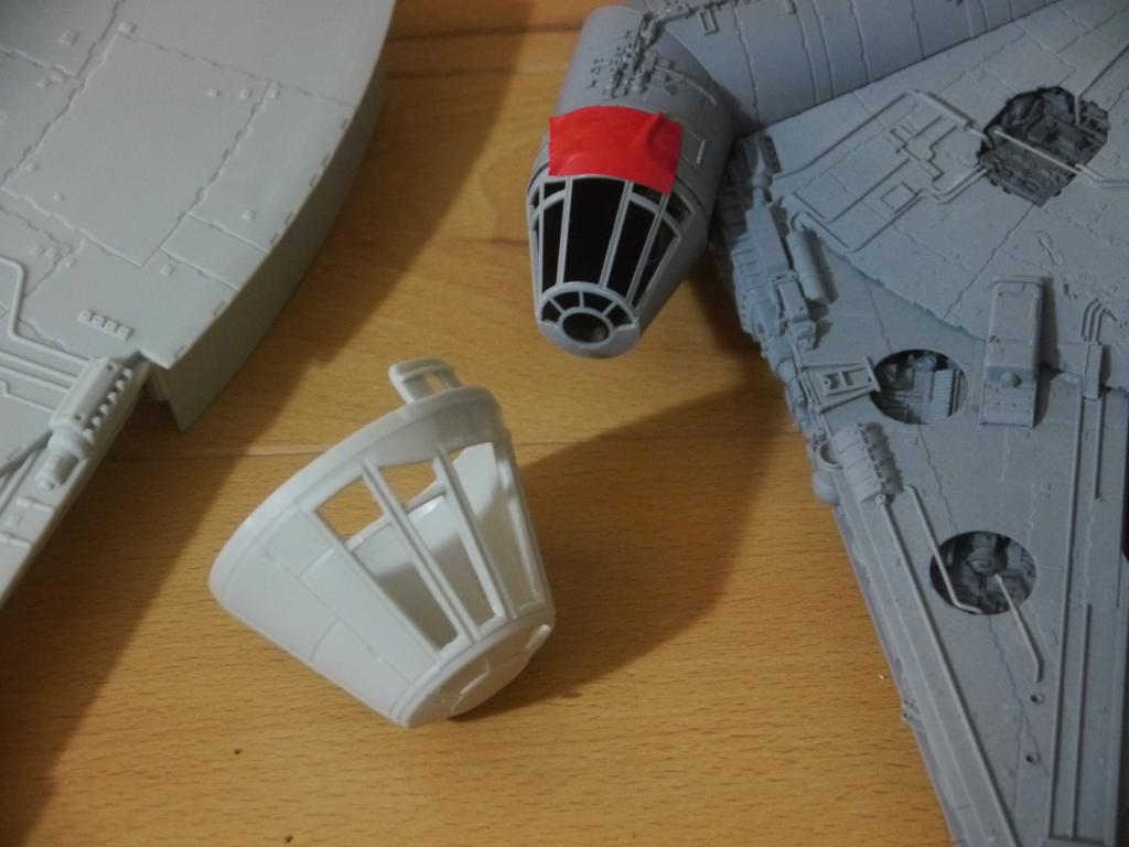

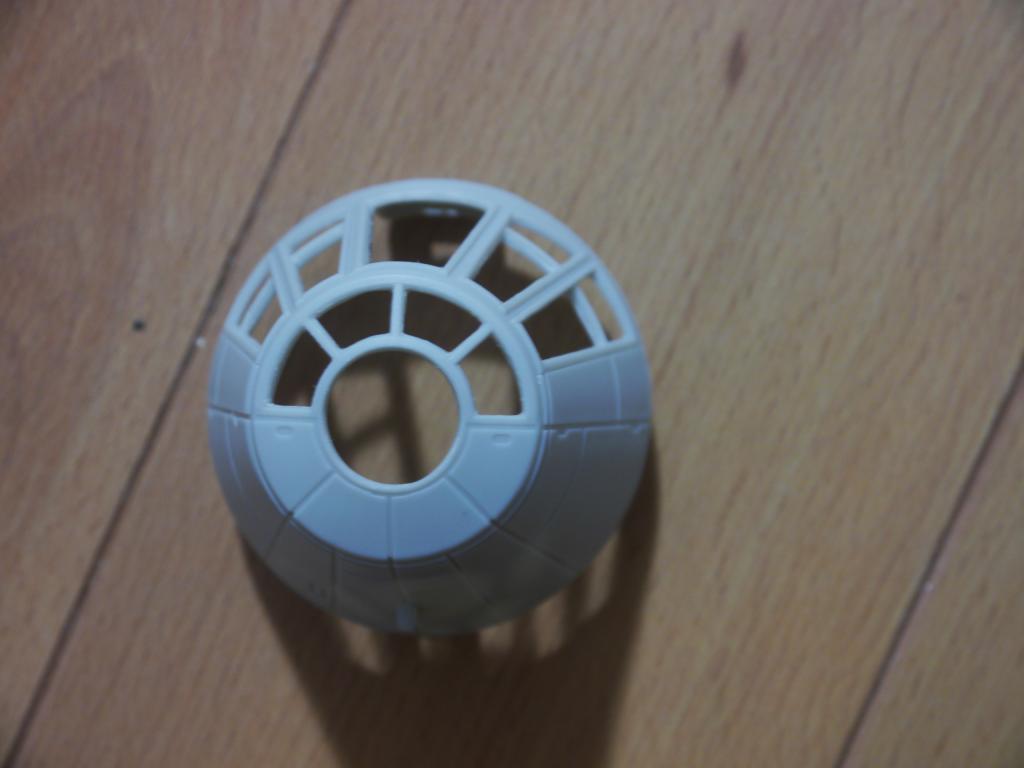

Looking great so far! How did you cut the cockpit? Any plans for the undercarriage? Lighting :) ?
Thanks for the great comments guys,....ThrakenSai, I'll be using others great ideas as well:D
crackerjazz, I like the eway Hasbro have used different elements from both studio models....If I'm gonna change anything or create parts I'll likely lean towards the 32" ship....but no matter what happens the cockpit cone is pretty much the 5 footer
newmagrathea, yeah (cough, cough,....the MPC,.....I havent forgotten about that one)
khitomer, I cut the cockpit with a sharp scalpel,.....dunno about the undercarriage,...but....I took your tip today and went to Argos ,....bought a couple of dolls for my daughter for Xmas & another Hero Falcon.....gonna use the other top turret, window & quad gun for the underside
...gave the cockpit cone a blast of primer,....just for a laugh.....tested the dried area with masking tape which easily removed the paint......I know I know.....you guys have the experience with this type of plastic & I will take your advice,.....but I just wanted to see how easily the paint would come off with the regular stuff:rolleyes

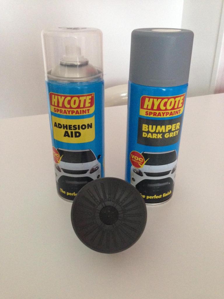

I went to my local car accessory shop & bought some Adhesion Aid and Bumper spray
attachment.php
The Adhesion Aid took a bit longer to dry than the usual car spray,.....you can tell as it looks like youve sprayed the part with water,.....eventually patches appear of matte drying out across the part.....
After it was completely dry I sprayed it with the Bumper paint, which dries just like regular car paint......I made myself a cup of tea and tested the part with masking tape.....nope....the paint stayed undamaged,....I tried stronger tape electrical tape,....still no damage:D

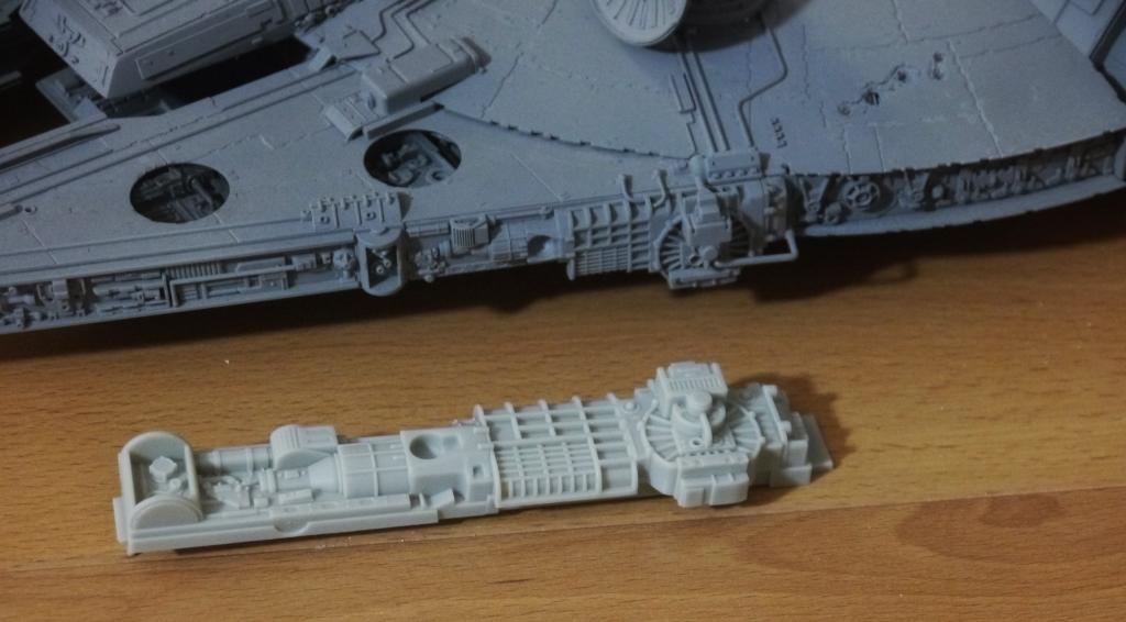

How did you cut out the detail under what you seem to be calling the notches, knife? will you be doing the front circle bits? (I don't know what any of the parts are called) as it seems to me that on the 5" one there is a lot of undercut, whereas the 32' seems to be more like this model, straight down from the circles edge? :)
Out of curiosity, (since I haven't spent too much time looking at pics of this) are the panels all from the ESB falcon? Or is it a mixture of the the ESB and anh? For some reason, I would rather deal with greeblies than me panels
Nice work already,
Is that the 4 circular openings on the mandibles?
Na, I'll not be cutting notches in those, just all the ones around the circumference of the main hull to do

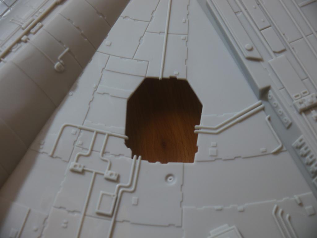

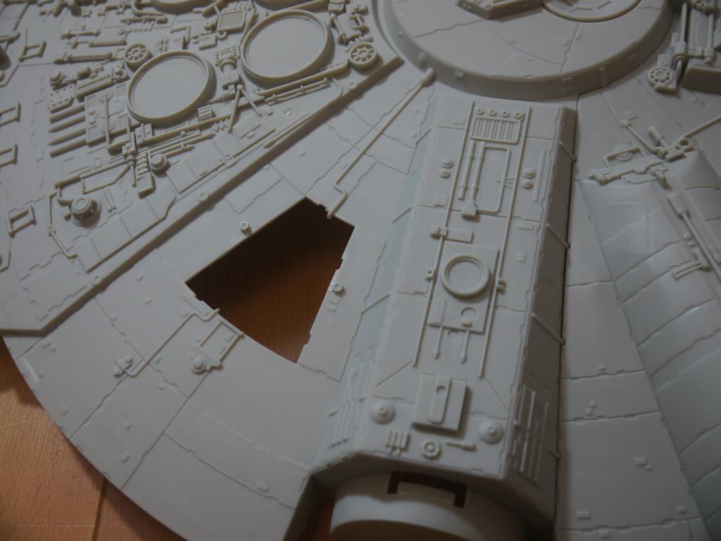

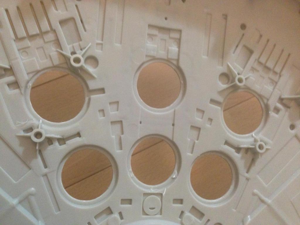

This plastic is strange stuff, its hard to ge it to a good finish.....although I'm using a scalpel, there are still frayed edges where I'm cutting.....
Hopefully paint will cover obvious cut work
Trying to replace some of the most obvious pipework.....nasty:
I had to remove one of the supports on the inside:
Thanks for looking
John
Looking great John, much more ambitious than anything I'll be trying soon! Where did you get the Hycote paint from? My local Halfords was out of stock of their stuff which is £7.99 a can, so I've tried their plastic primer instead. I'll test fro adhesion when it's cured for a few days.
Thanks Khitomer, I get the Hycote from my local independant car accessory shop,...I've found that Hycote has been the best, smoothest, splatter-free rattle-can car paint that I've found.
I've bought other brands and regretted it, no naturally enough I was impressed that the also produce an Adhesion Aid spray
