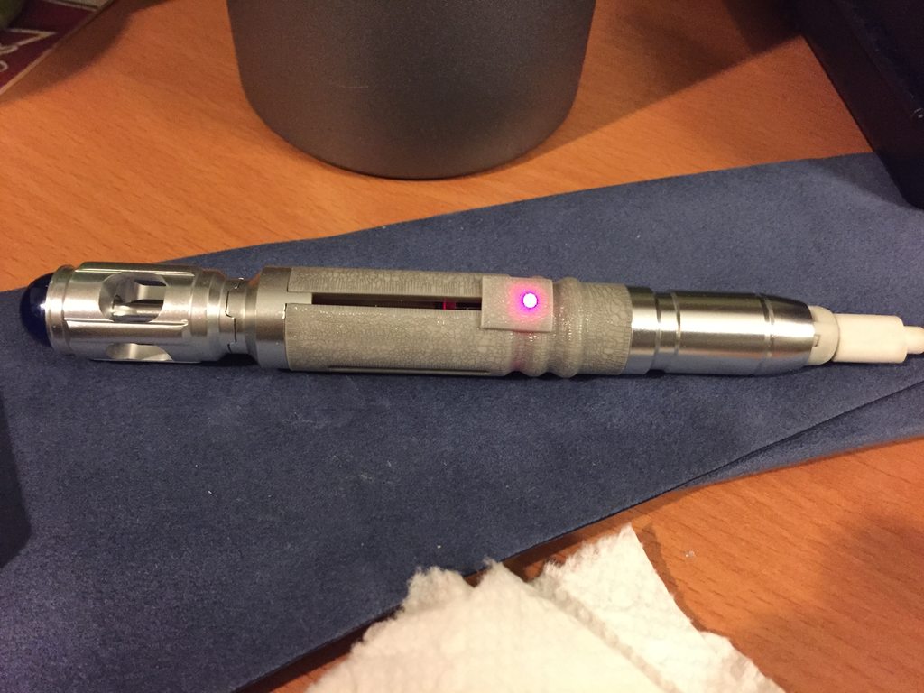

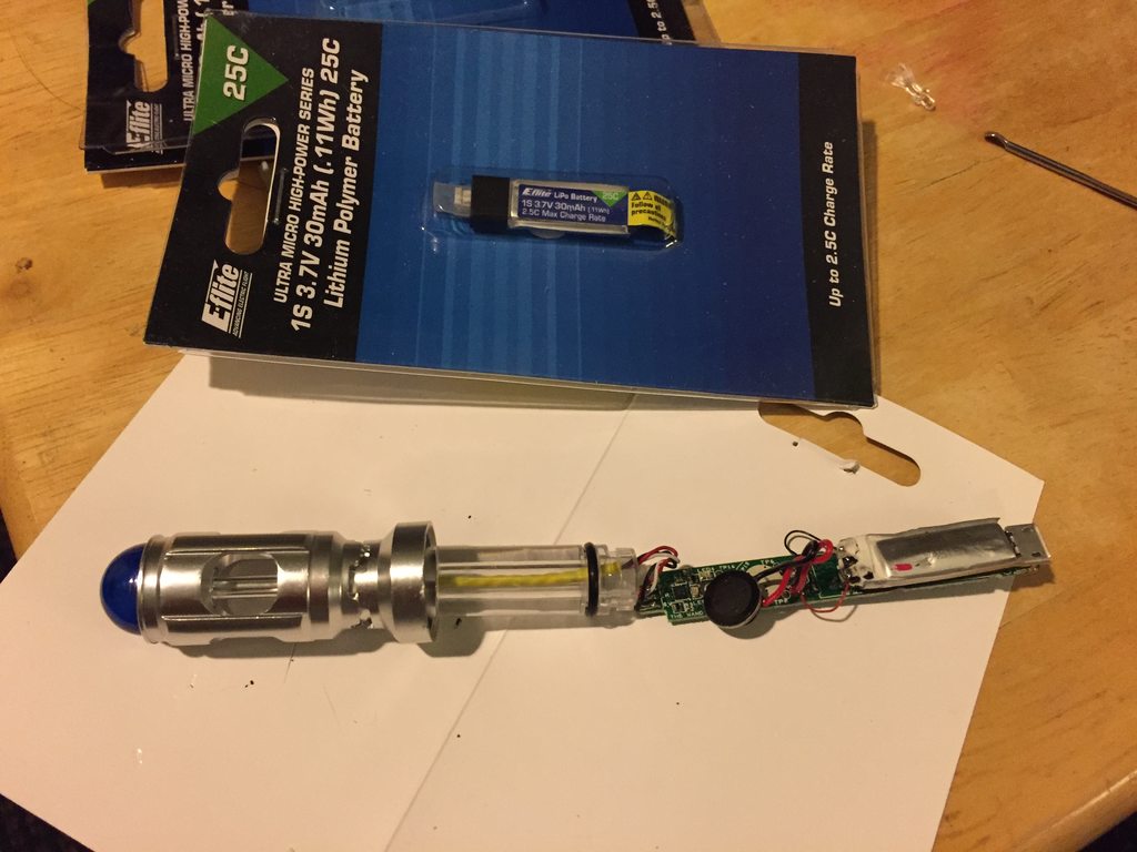

replaced the battery with the suggested batter from voo45doo. I got a little marring on the backside of my collar as i tried to pry it off :( brok a plastic tab underneath the collar too, but hey you win some you lose some.
Solder'ed new battery in, and closed up, but it wasnt closing as tight as before so sliding up and down was a little tight. ended up sanding the inner casing down a little and its a bit better. all in all, functional now! not too happy with me marring the collar tho :(
thanks voo45doo for the type of battery to use!

So how are you guys removing the little black tab on your replacement batteries? I managed to get the same as voo45doo and crick0234, now I want to install it in my sonic since it came with a dead battery. I just don't want the thing to blow up while I work on it. :D
