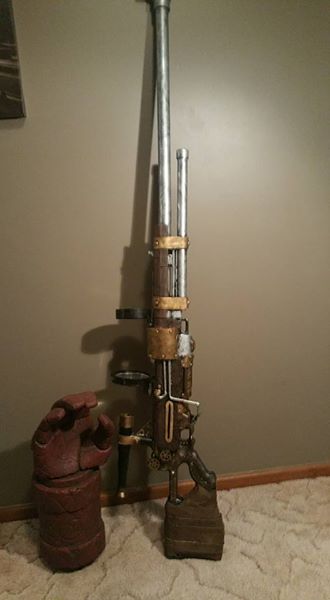

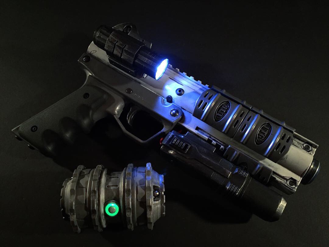

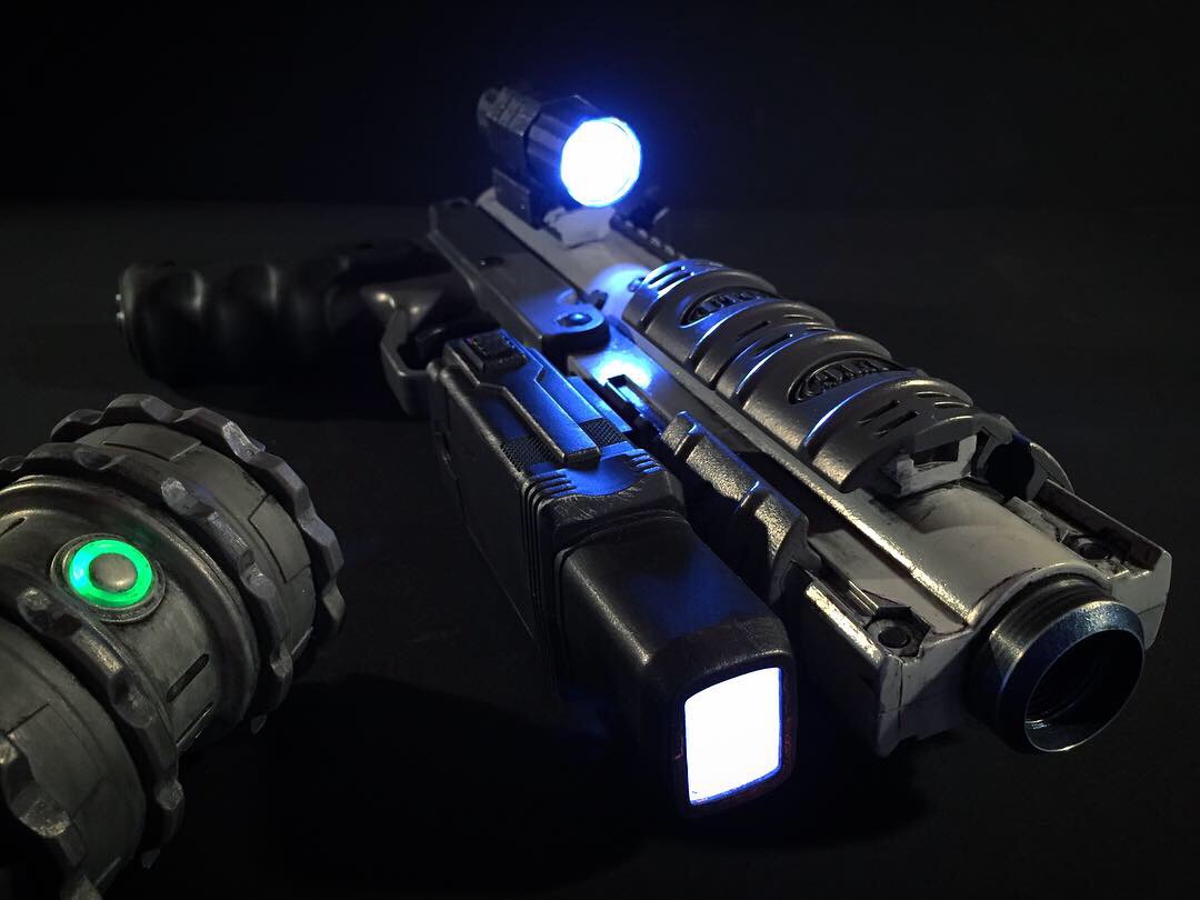

Technically not NERF. Moderately Massive MIB gun:
I'm still working on details, but you get the idea.

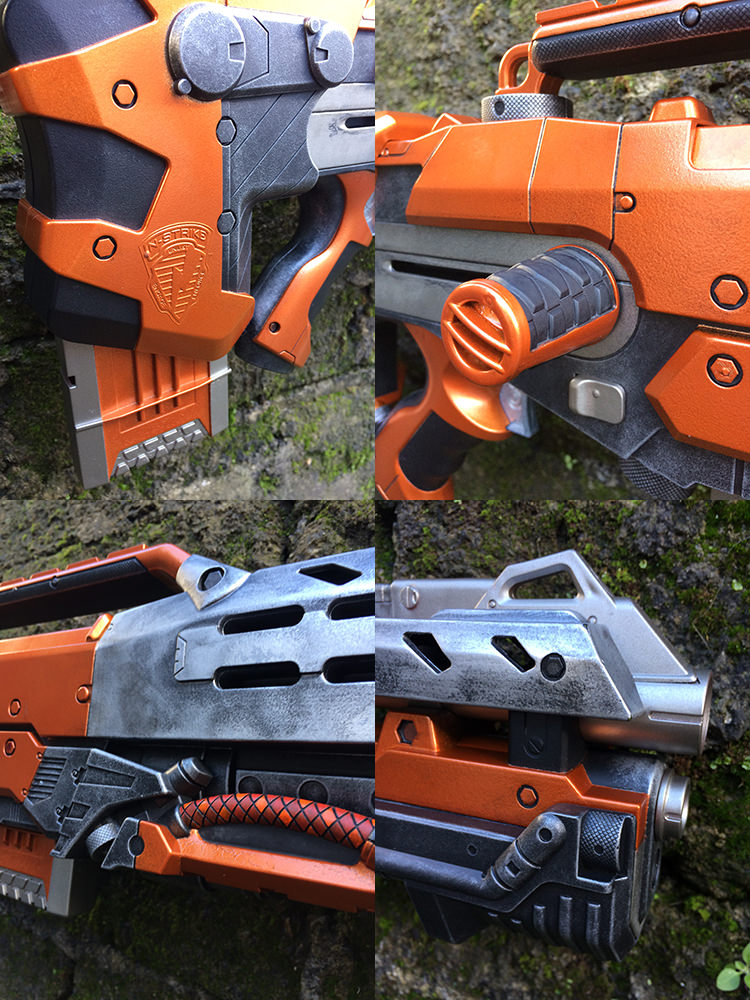

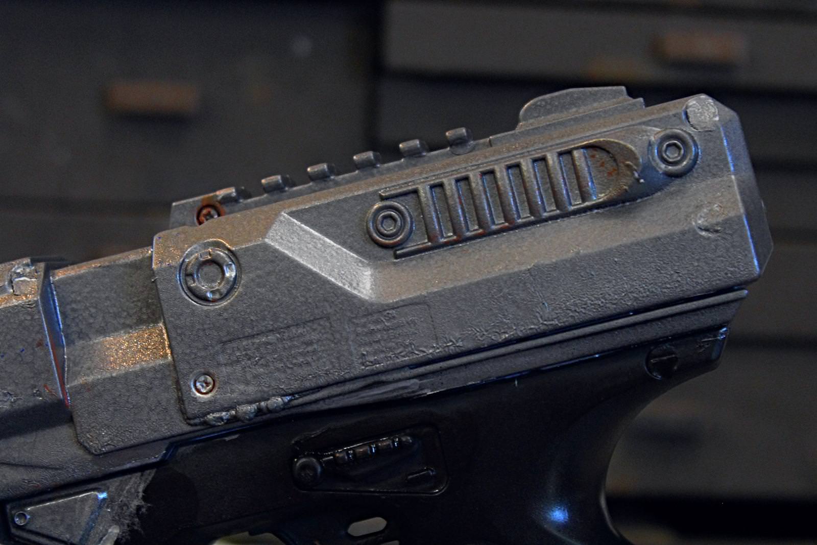

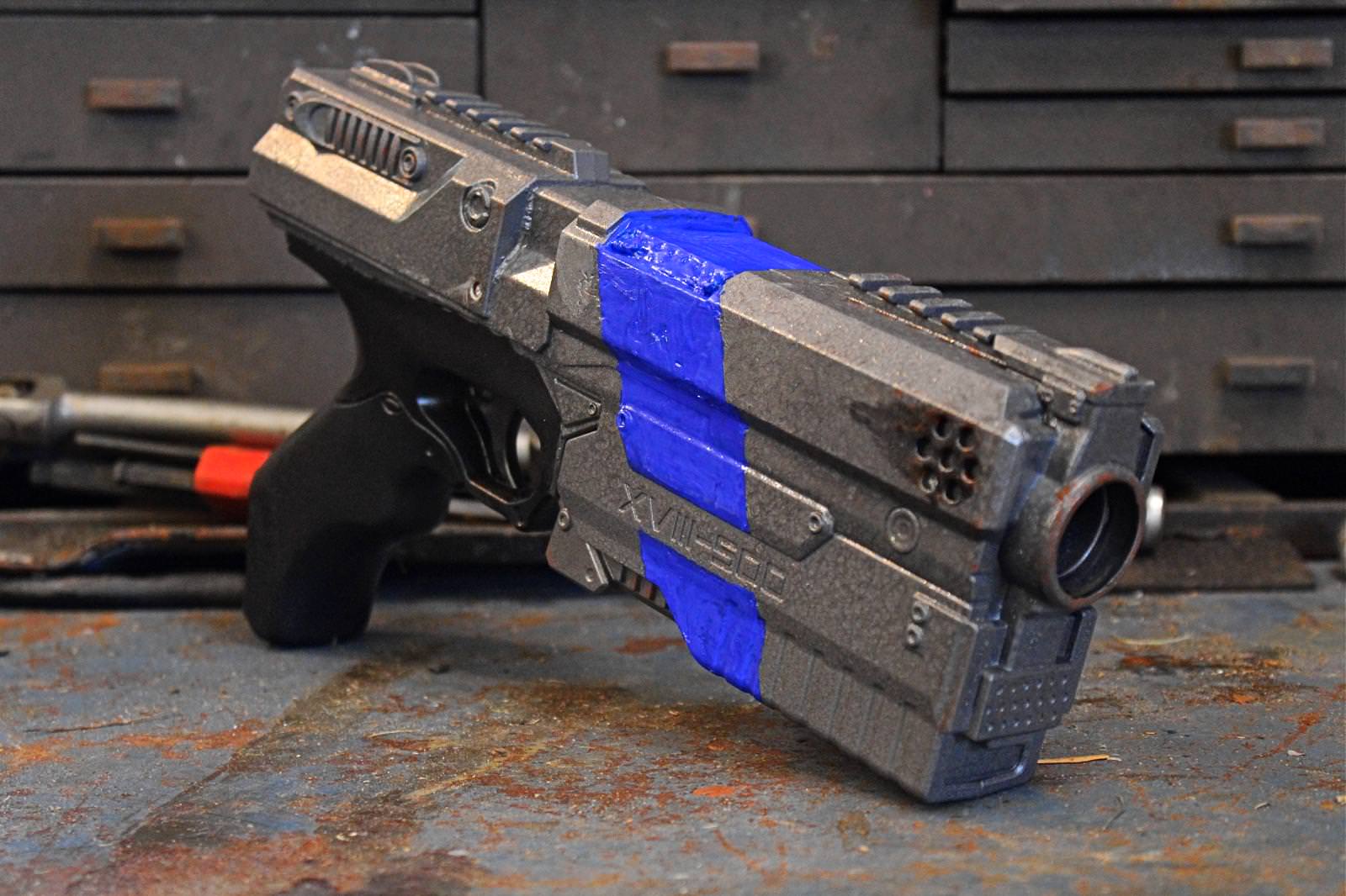

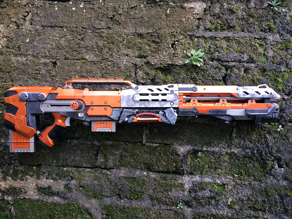

Hi there fellow nerfers,
Our antipodean weather warmed up enough for me to get some paint down on this beast at long last... and it's finished. Well, as much as I feel like finishing it anyway...
Being that it's an upgrade blaster, I kinda wanted something I can run around with without freaking people out too much, but I'm not sure if I didn't overdo it again :/

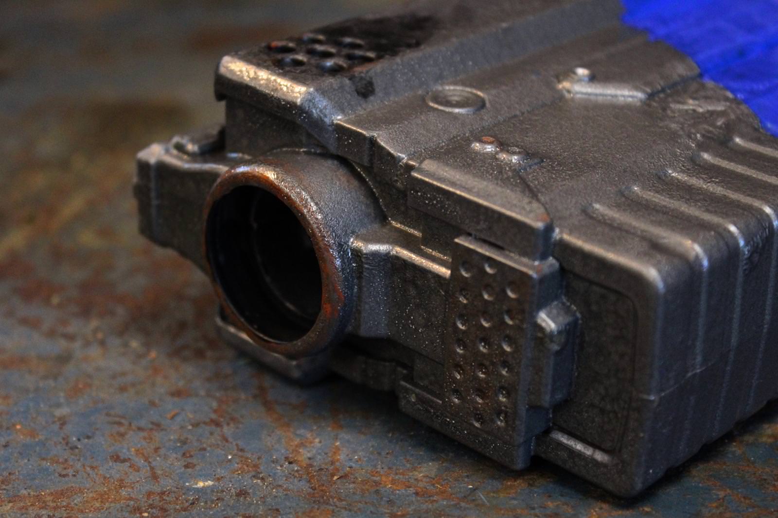

To be honest - this has been my least favourite blaster to paint so far. Too fiddly, too many parts, too many difficult nooks and crannies to mask - it was a nightmare. And once again, I'm having real problems with the Rustoleum 2X Matt Aluminium - I swear, nothing wants to stick to this stuff, so as a result I didn't go too fancy with the paintwork. Had to be done though, as the metallic orange needed a shiny silver undercoat to really pop, so that worked at least. I just didn't want to risk masking over the orange and having it come off on the tape like the Hammershot debacle from last year...
The most fun I had was installing the OMW Solid Stage 1&2 upgrades. It was an old blaster to begin with, and as such its performance had deteriorated badly, so the new spring, plunger and boltsled have it firing twice as far as it was, and without the front gun it's firing 3-400% better, depending on the darts I use. It's a lot of fun to shoot now!
Aaaaanyhoo - thanks for looking, and as usual, any feedback and/or questions are gratefully received and happily answered.
Nerf on!

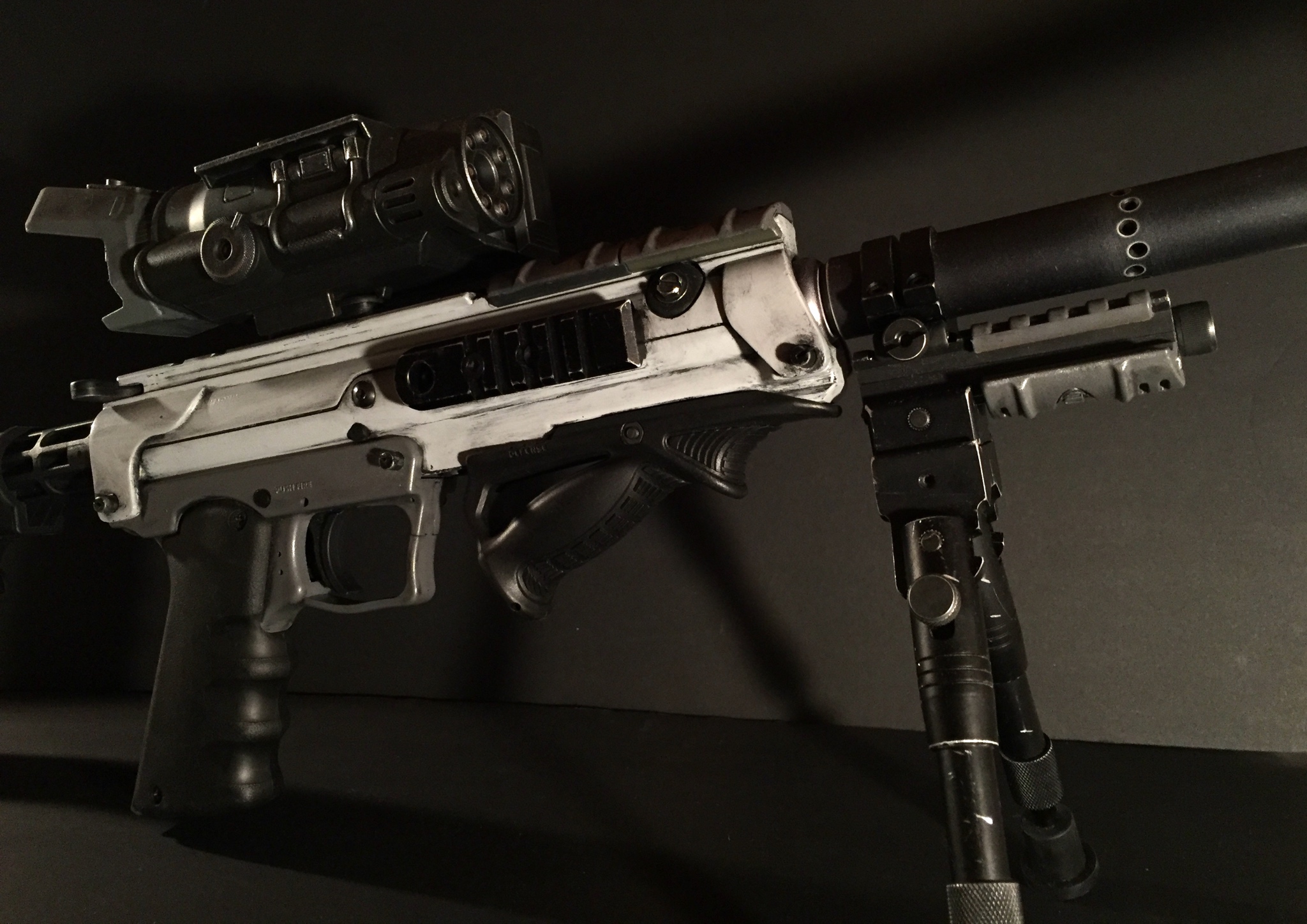

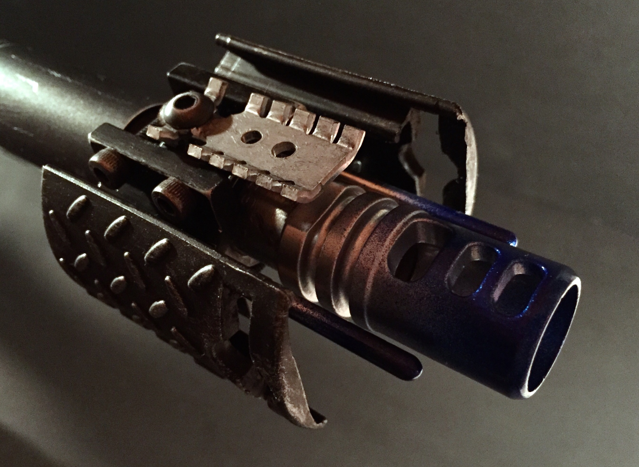

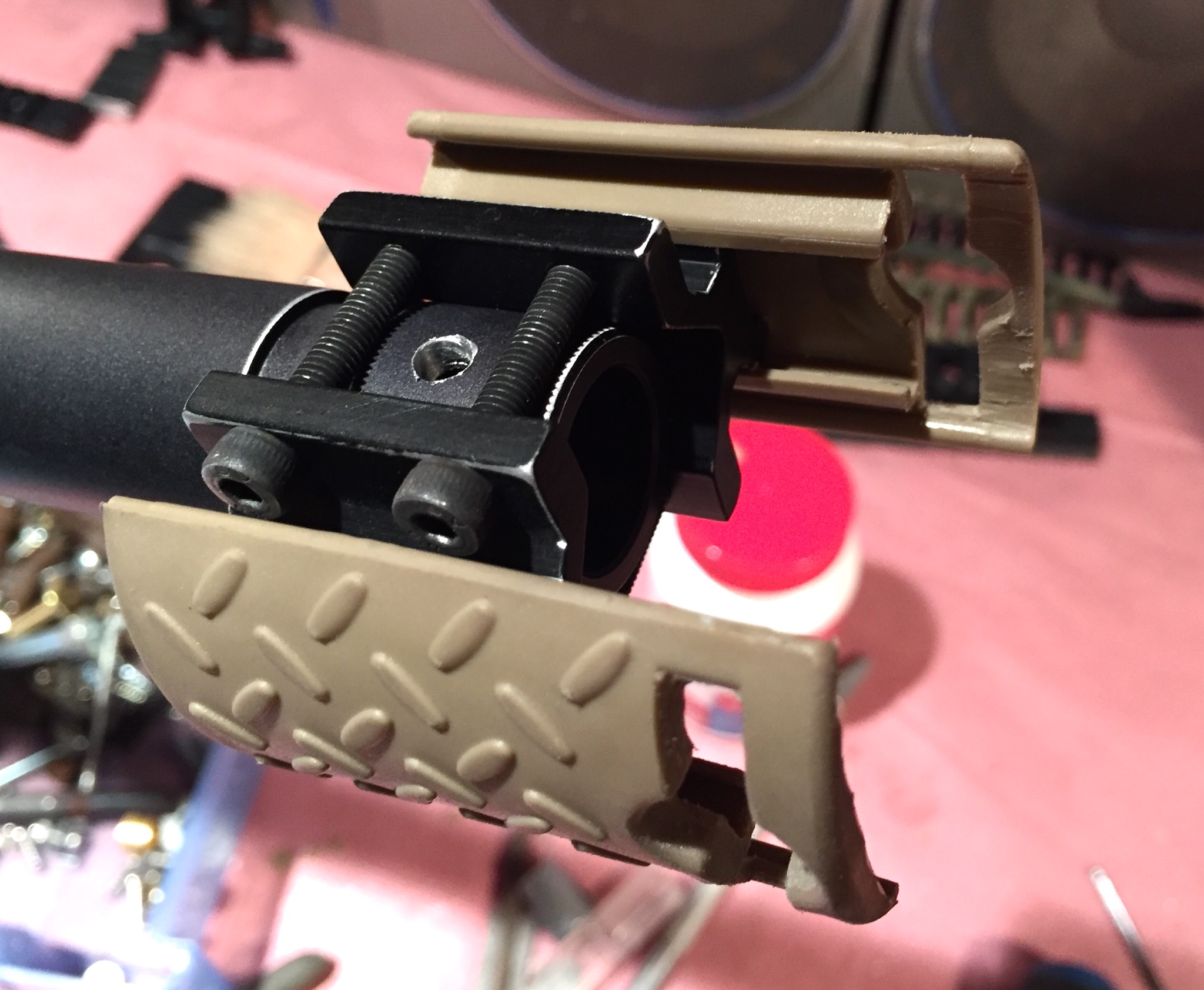

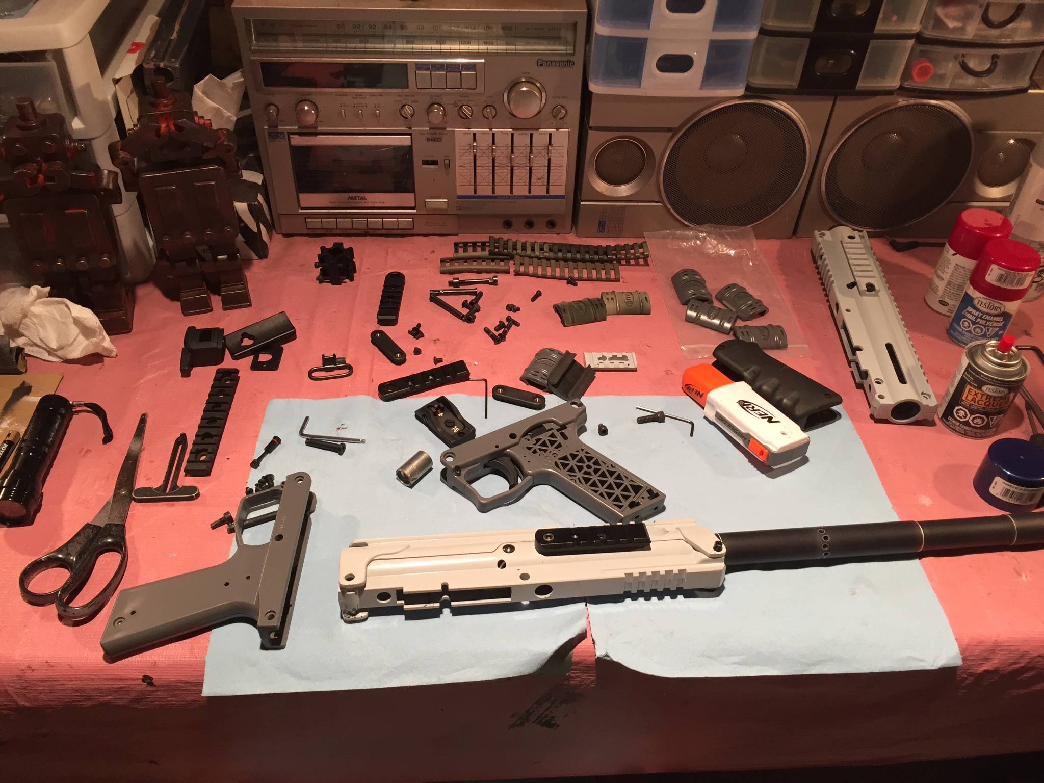

These are paintball guns, but both have Nerf accessories...
Still working on the rifle, waiting for some parts from Evike...
The rifle scope is the Nerf night-vision scope, which I highly recommend. It's such a fun scope and actually works! Plus I picked mine up for $15. Bargain!
Man, those are great looking builds. I love tearing apart paintball guns!
Did you glue or bolt the nerf scope down? I've had terrible luck with nerf scopes breaking off with very little use. I started using milliput, and steel stick to fix them in place!

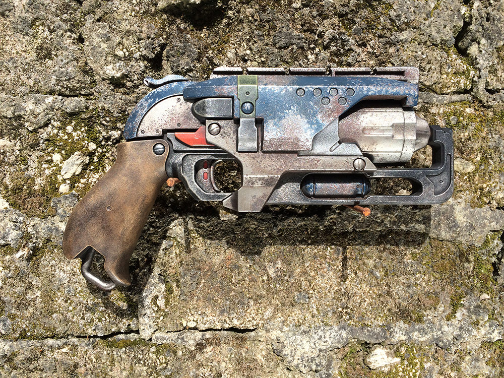

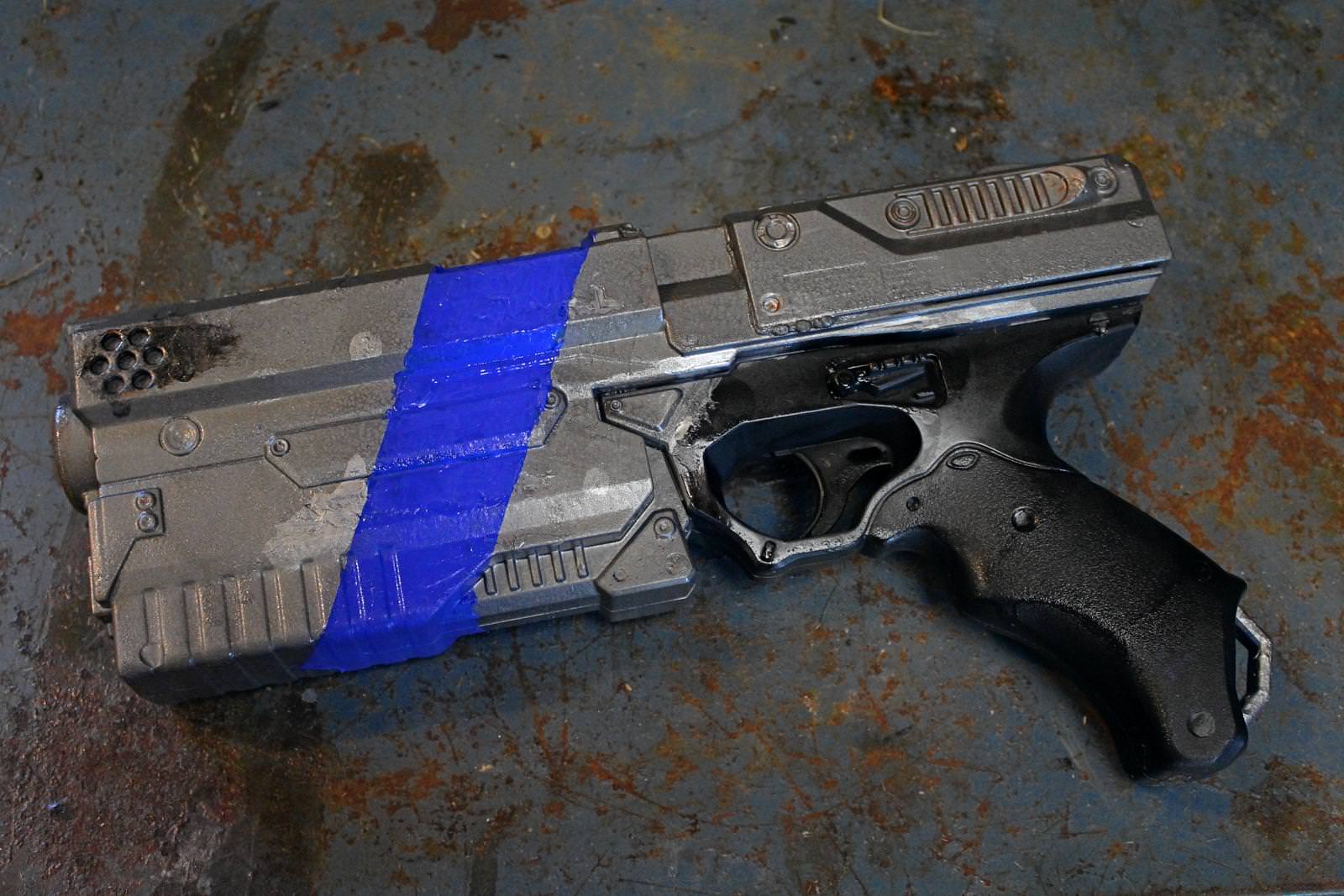

Spring has well and truly sprung here in NZ, the temperature is climbing steadily back into the double-digits, and once again the paint is flying. Can I get a Huzzah!?

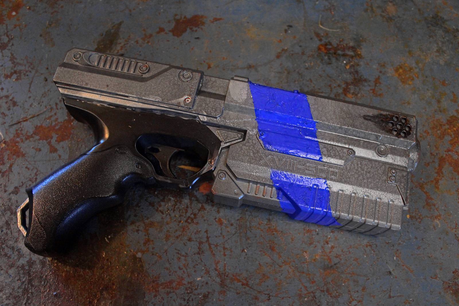

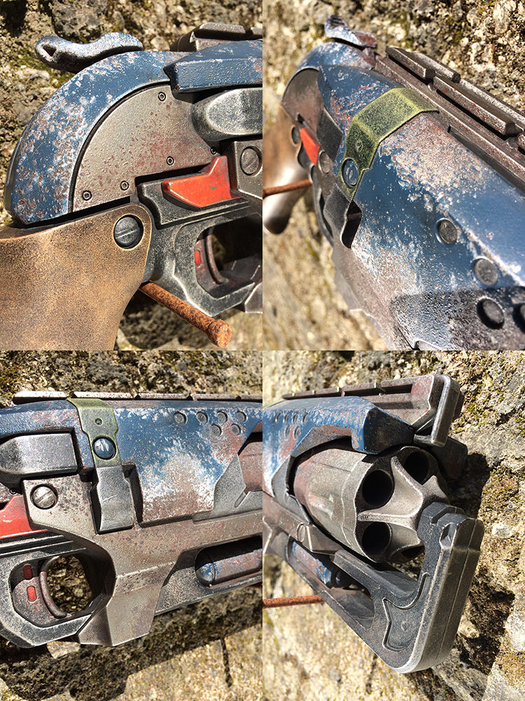

May I introduce to you, the Corsair; a WWII-era navy pilot sidearm, named after the Vought F4U Corsair aeroplane.
This blaster employs an experimental technique for the oxidizing of the paint as well as my usual corrosion techniques. It's achieved by leaving all of the salt used for the rust in place, applying more salt over the metal coat, and then spraying a light coat of white before the top primary is applied. The top coat is applied by spraying predominantly from a single direction (similar to the water droplet effect technique), in this case, from the top down. This allows the salt to act as a rough mask, allowing the white to show through the blue around the salted areas.
I had no idea if this would work or not, but I think I can mark the experiment a success!
Thanks for looking, and I hope you found something in this you can take away and apply to your own work.
Peace :)

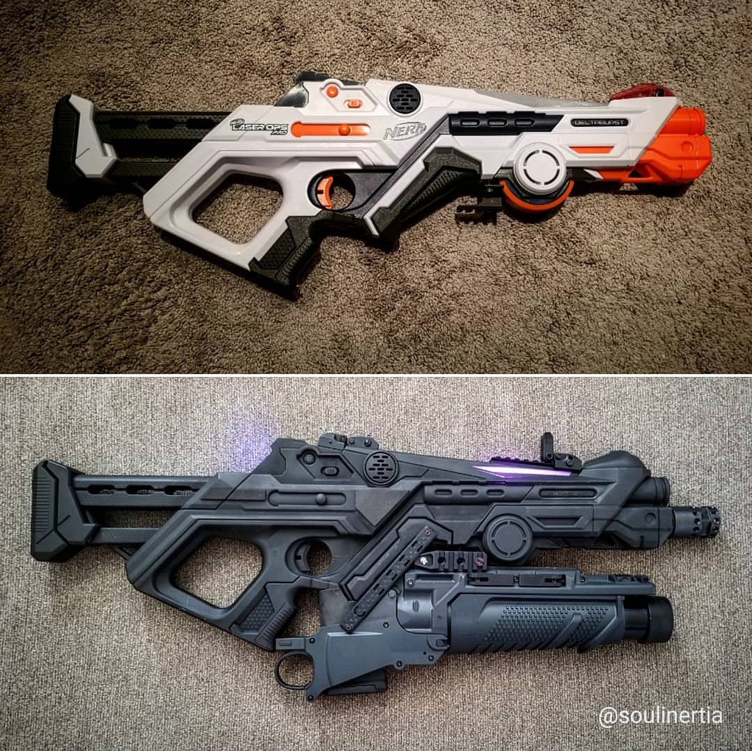

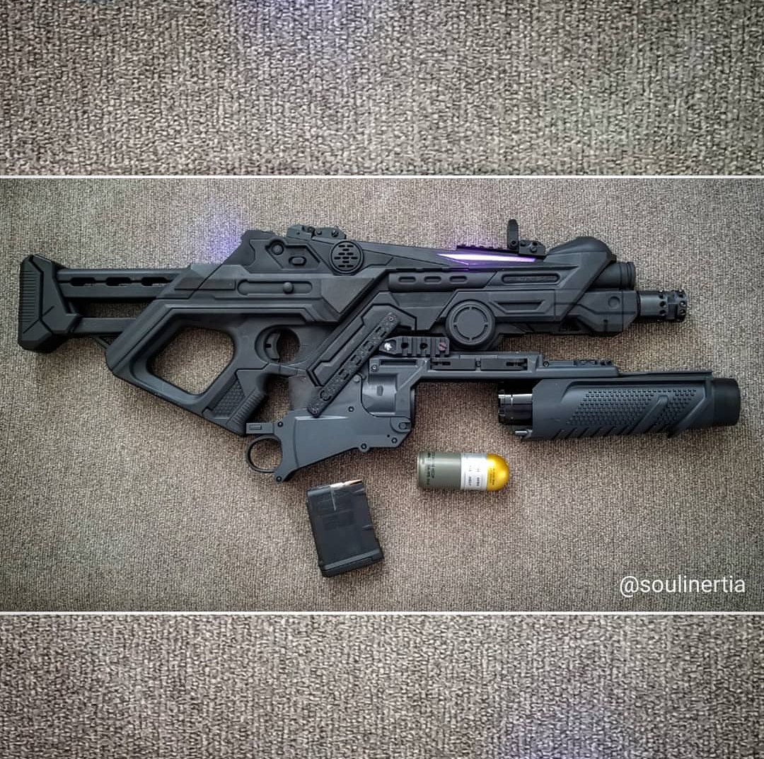

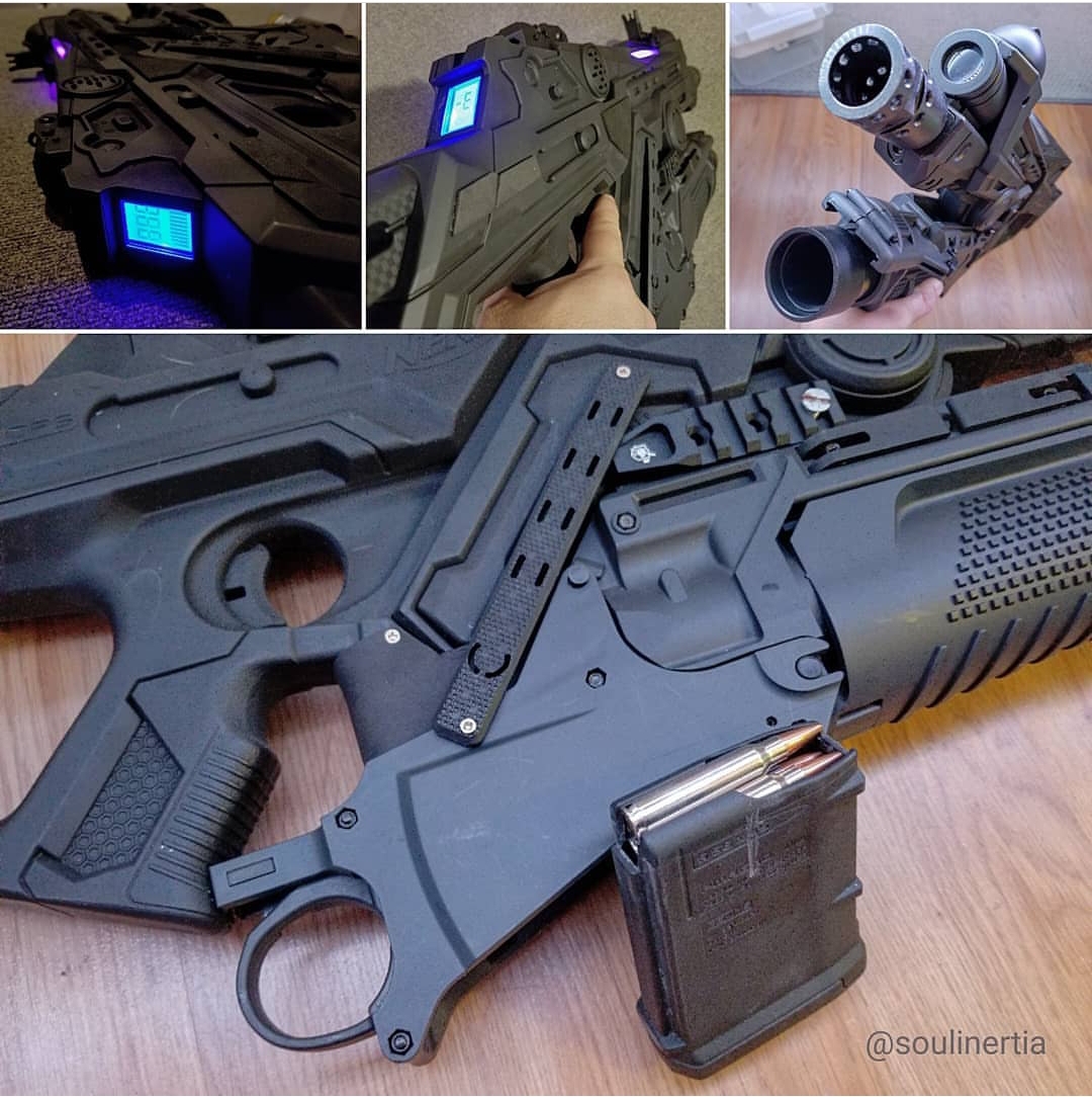

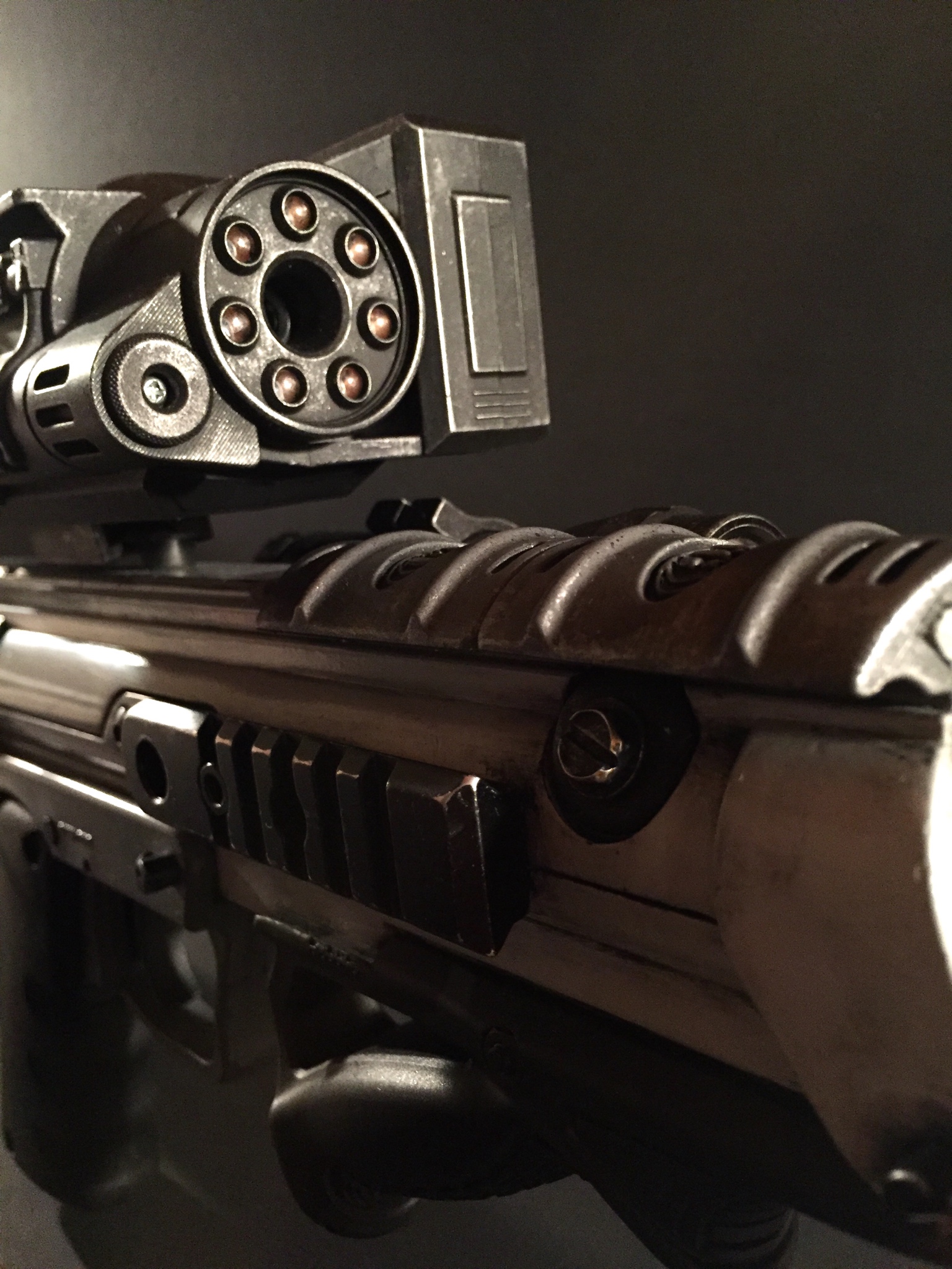

This is one-day-build I made out of a Nerf LaserOps Deltaburst which I married up to an EGLM 40mm grenade launcher. I added a few additional parts including a MagPul 10rnd mag and a bit of foamsmithing . . .
I still plan on adding some decals and weathering. Follow me on instagram for more!
I like this Rifle! How's the grip feel? Looks like the launcher is a bit In the way

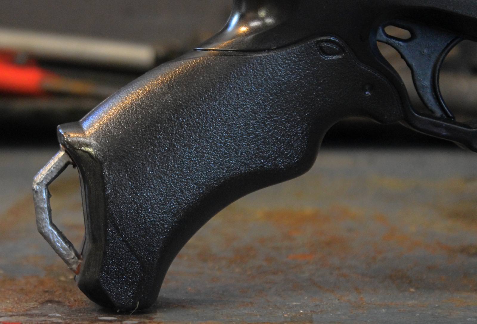

The leather effect you did on that plastic grip is amazing, how'd you do that?
