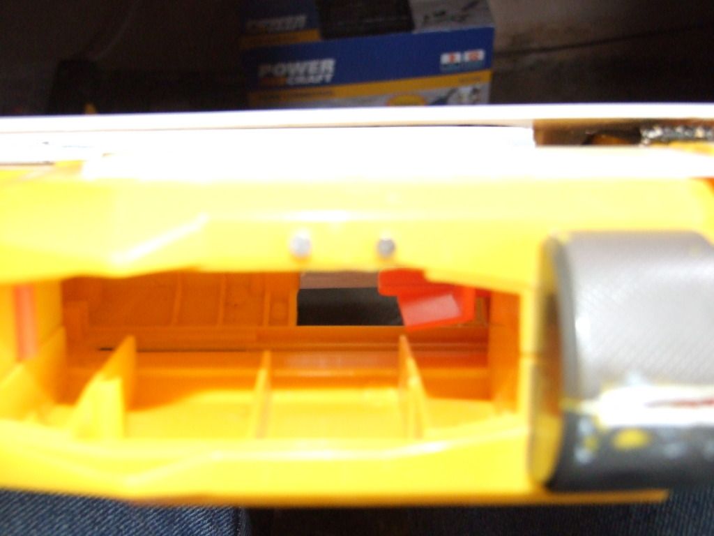

1.) Grind off with a hand file and cover with a small piece of PVC pipe.
2.) Same.
3.) Glue small bits of plastic on the inside, drill a hole for the 'bolt' then a shallow but wider hole for the head and sand the rounded contour.

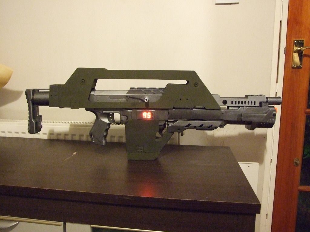

Made it so when i insert mag the counter lights up to 95.
Only lights 95 doesn't count down :cry
still working on it so once its finished will post up pics.
Nice looking set up.
So everything is contained in your shroud and you just have contacts on your magazine?
Mine is nearly done just bit of filling and sanding and then paint of course to complete..

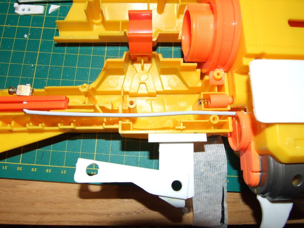

front "grenade" launcher trigger is made up of coat hanger wire.
i also filled in the grips as can be seen from pic and the barrel shroud was tweaked and has magnets in place to keep it help on.

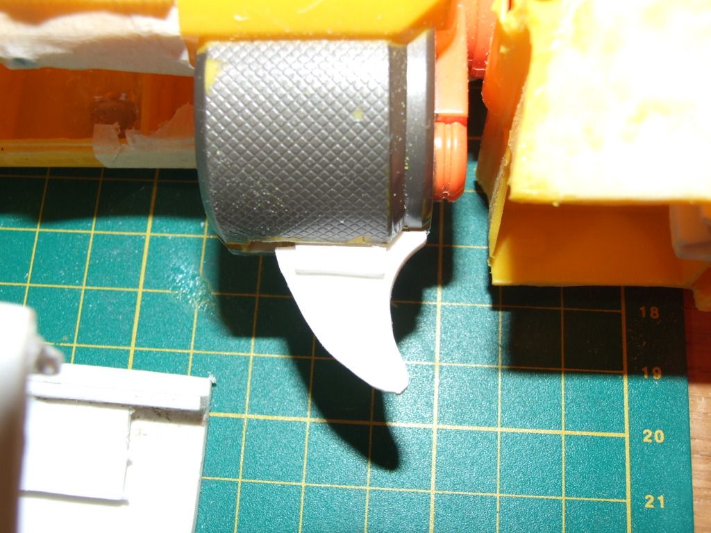

front grenade launcher trigger

looks awesome! funnily enough I was browsing this thread earlier today in prep for my own attempt and was wondering if there'd be any news...BAM! thanks and congrats on an awesome looking build.
One question?...what did you use for the cocking lever/bolt? looks cool.

Superb conversion - I'm still very tempted to do one of these myself - my all-time fave movie gun.
My ears still echo the distinctive sound these things made when fired!
I think the Nerf gun conversion looks better than the real deal!
