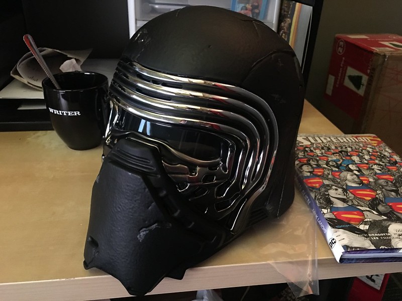

And then this arrived today!
This is a little intimidating cuz I've never really modded anything... so taking this apart and mixing it with the Disney Store helmet, rebuilding and repainting will be interesting.
Always worried I've paid a bunch of money to DESTROY something... But this wasn't bad. 80 bucks.
I'll post pics of my destruction as it goes.
https://c8.staticflickr.com/6/5336/30457615895_92efbc12bf_c.jpg

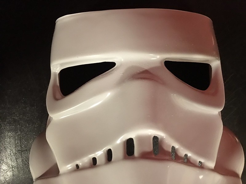

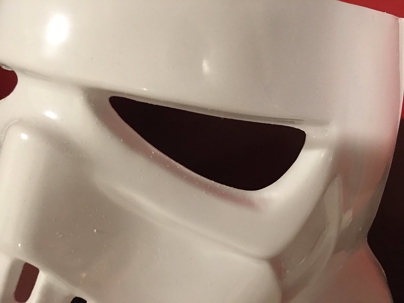

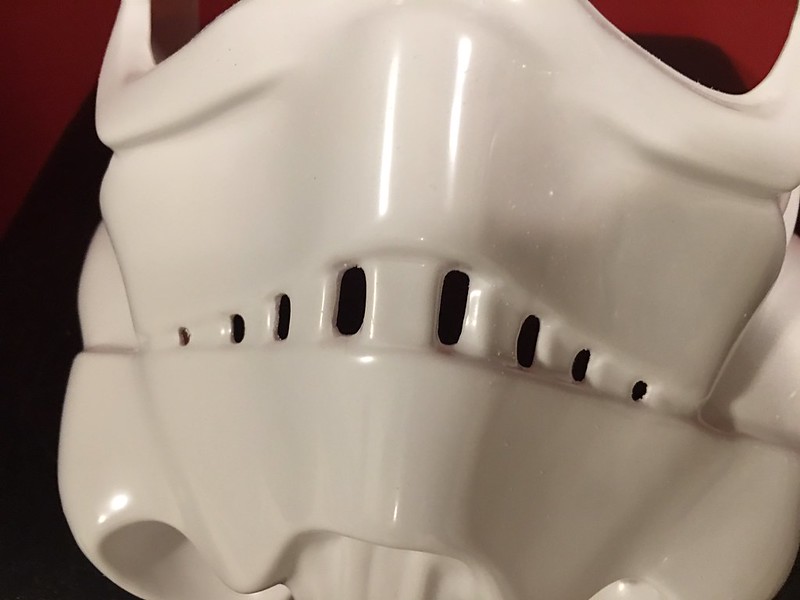

Okay you bucket builders out there! Couple questions about my rough cut-out!
So here you can see I've left a bit of a lip on my rough cut... before I sand down and finish, anyone know if there should be a lip at all?
I've researched and it's all over the place... but with some it could just be laziness or not knowing. I'm sure someone knows.
I MAY Want to put in bubble lenses down the line.
And with the teeth... I went for a rounded corners look... and now that I see big pictures, I'm thinking they may all need to go a *bit* further down...
What say you all?
Didn't realize how choppy it all looked til I saw these pics blown up....
Anyway I want to clean up and finish tonight... though I'd see if there are experts out there...
Yeah I could go to White Armor, but MY HOME THIS IS! I will just ask here! ;)
Also, knowing how many helmets they made, and the rush, I figure these are all hacked together quickly, and I'm wasting my time being anal...
But so it goes!

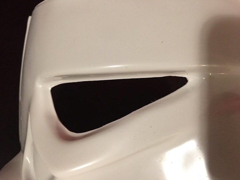

Re: NeoRutty's Prop Projects -CALLING STORMIE HELMET EXPERTS! question on last post!
Should the top lip on the eyes be flush with the "brow"??
That is a preference. Most have been a slight gap between eyes and trim. I haven't seen any builds that are directly over without a gap. I have seen some with a larger gap but not many. Between 1/4 and 1/2 has been the norm.
As far as your eyes go, it's hard to tell. Some shots look like you still have some flashing and other shots look good.
What I did was take my lenses and hold them in place to see if there are bumps or gaps. If they line up for you then I believe you are all set.
Another trick is to take some plain paper and trace your eyes and compare both sides. There really hasn't been a right or wrong way as far as I have read when it comes to eyes and teeth.

Idk neo, the eye cut outs look great to me. I would be scared when cutting those out, not much room for forgiveness.

the trick is to use a drum on your dremel and cut them down from the inside, then use your xacto knife and or mini files:)
