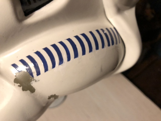

That sounds EXACTLY what I was looking for... a wash feels like it would just seep in the cracks... I wanted to dull it a bit like it's been handled with dirty fingers for 40 years...
As far as wiping if needed... Did you use a clear coat first? I have a good gloss clear coat, but glossiness was what was making it look too new...
But then if I use a matte clear coat... it may be too matte...
if I get semi-gloss, I have to BUY... and I already have 50 cans of spray paint... don't need more in my tiny place...
I just don't want to clear coat this far in and it looks like crap.
But either way, that Newspaper trick should work well.... thanks!
As for painting (heh) I didn't use decals and just tried to do it all by hand or with stencils... there HAS to be things I'm doing wrong... cuz I always get leaking, and then my version of cleaning it up is NOT great...
in fact newspaper dirt would def hide some of my "fixes"

I don’t remember where I saw this tube stripe tip, but it totally works. Use a coat of flat white paint in the stencils first, then when it dries apply the blue paint. The white paint will seal it and prevent the blue paint from seeping under the stencils. (If the flat white bleeds through you can’t see it.)
DUDE.
That's brilliant. Of course that would work.
Why wasn't that in the dozens of paint tips I watched... the damn tubes...
I had to scrape and carve it, then touch up, then use a fine liner...
I was a final line animator for 8 years! THIS SHOULD HAVE BEEN CAKEWALK.
IT was not.
this was the part I feared most and wanted to try before doing a hero... it went so bad I was considering decals for the next...
but that paint tip sounds dope
