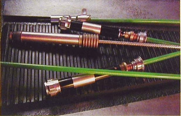

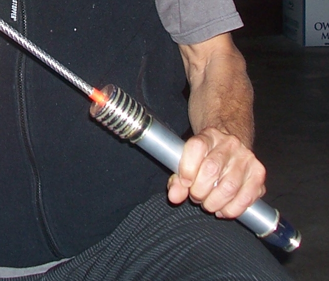

One of my current obsession's is the Cin Drallig stunt hilt. Ever since I've started the clan hilts project I've scoured the web for more and more references and while working on the Shaak ti hilt I was looking for more hilts that used the same construction (like Barriss offee) and one was the Cin Drallig hilt. However thar particular hilt does not really exist, its more of a post movies hilt that was detailed after the fact. In the prequels this hilt was often used by Nick Gillard (master stunt coordinator) which was then made the Character Cin Dralling.
This is the "canon" hilt
And this is the real one used

Trying to replicate this stunt saber it seems like a similar pommel and emitter to the fisto, with a polished tube in the middle. I have been trying to figure out how to tackle this one and I used references like the other stunt hilts to determine the diameter of the mid tube and the overall size of the hilt.

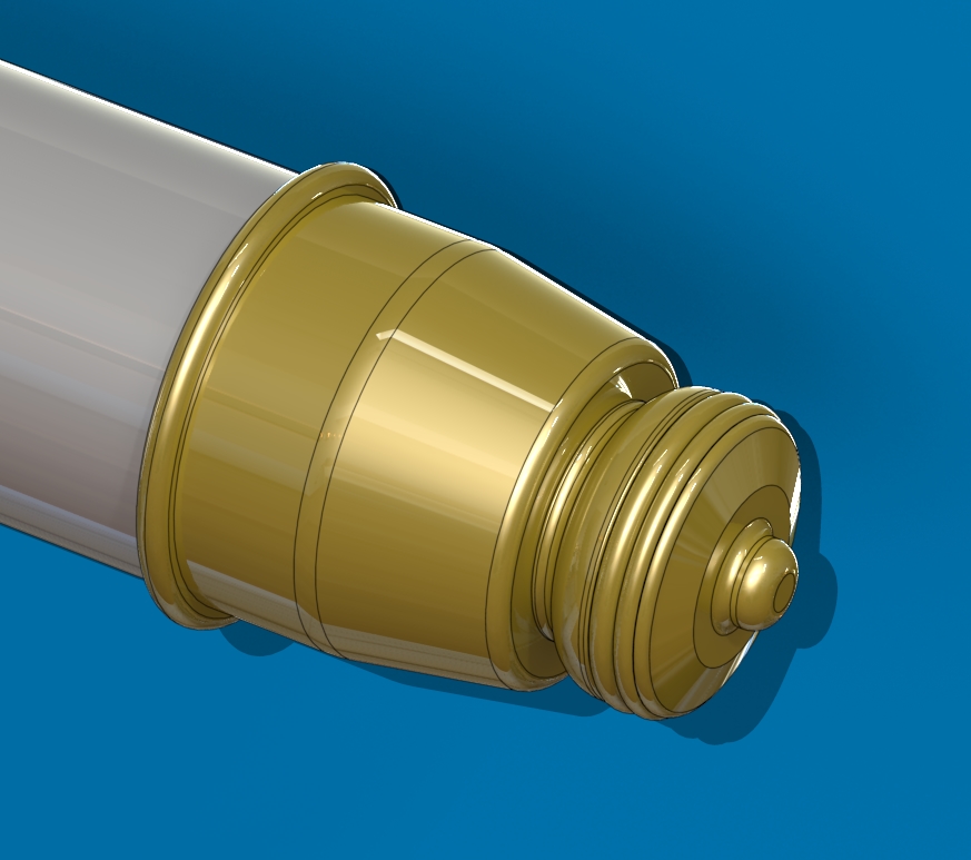

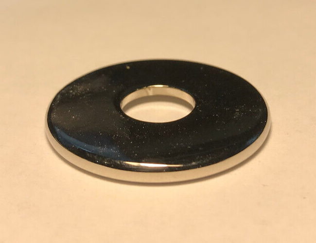

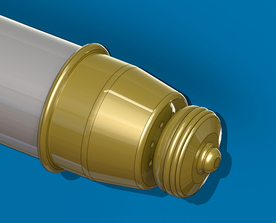

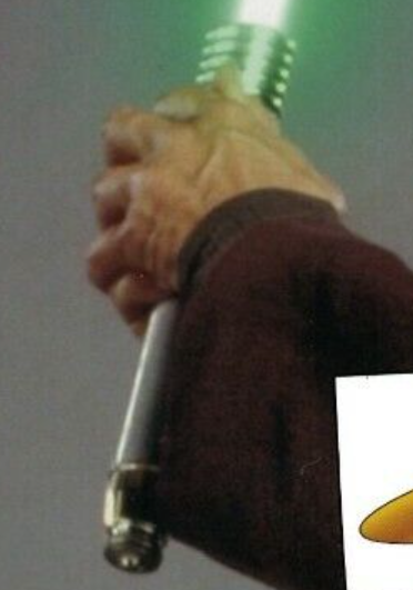

So here is my current model and as you can tell the construction shows rounded edge rings (brass colored) and this is where I have some doubts because I have no clear image of the emitter to determine if this is accurate. That last picture is the one that gives me the idea that those are like brass seating rings like this one:

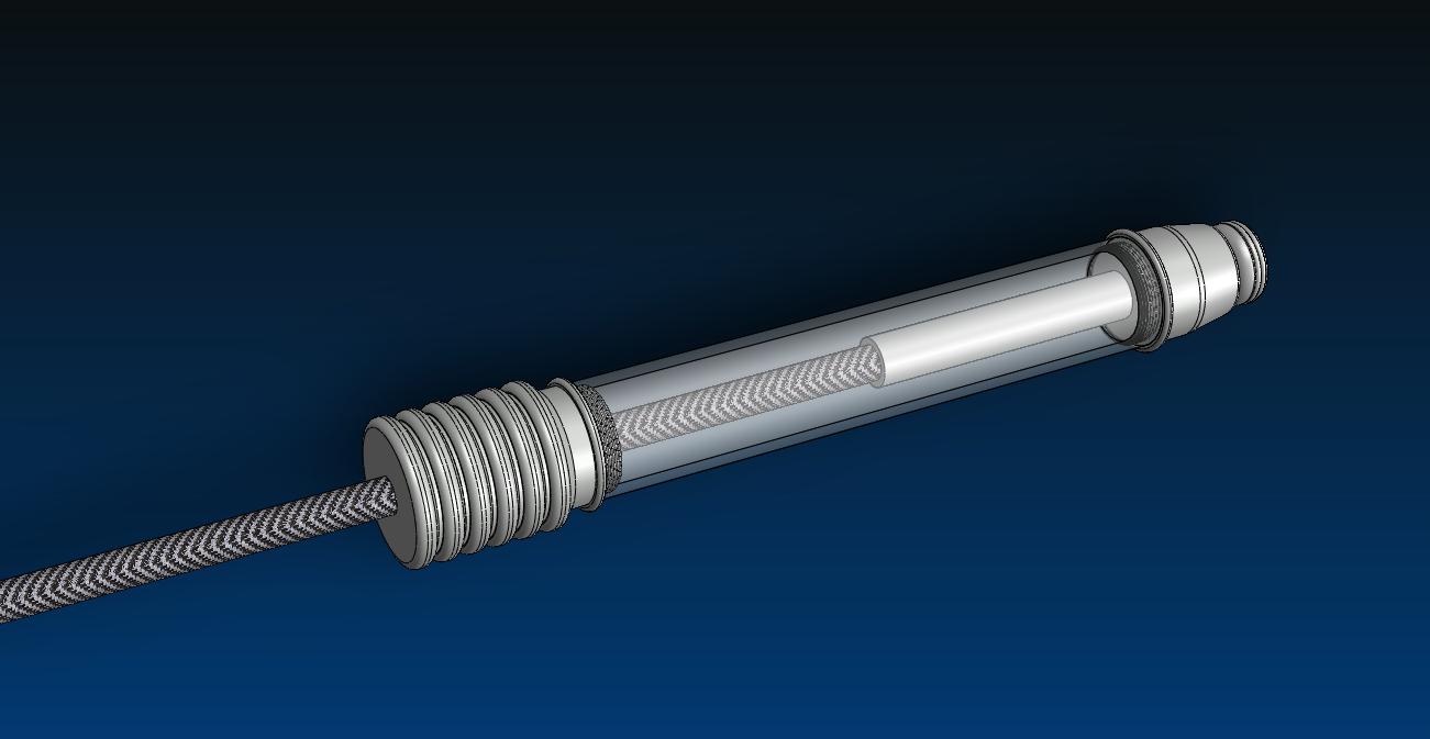

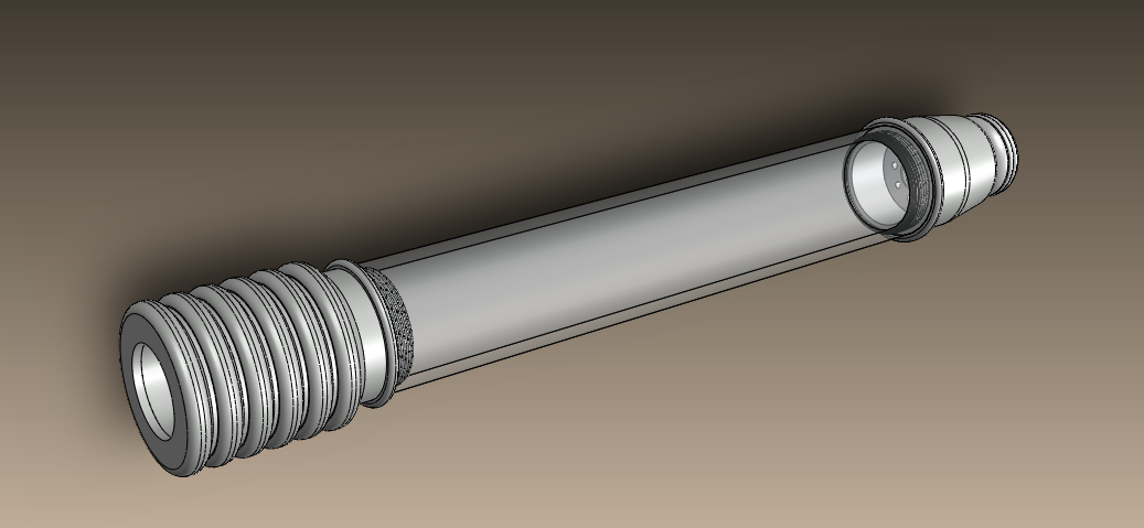

Model

Any thoughts on the seating rings construction?
Thanks.
Model looks great as always. But, on the original prop, I don't see brass. I see chrome plating
could it be nickel plating? cause there is a little bit of a gold tint.
I agree that it doesnt look like brass at all. The only reason i went that rout was because of those setting rings i found, but those also can come plated as well.
Thanks to Teecrooz I updated the model. I believe the emitter and the pommel are nickel plated brass, cause you can see the brass being exposed in the edges due to the hits it received or normal wear and tear.
The renders show the nickel plating being more saturated than it should be. Here is an example of nickel vs chrome plating

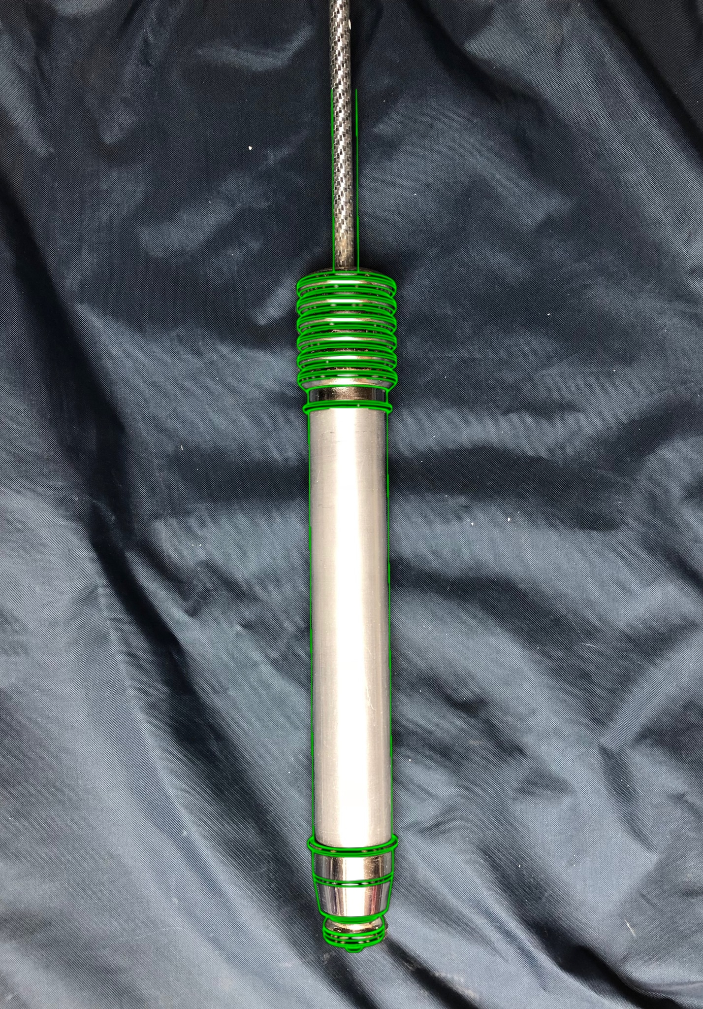

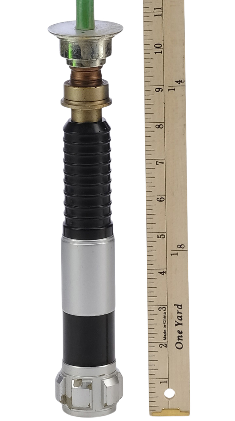

I think the model is done now. Size-wise, I believe its little over 10.5" long, using this picture I can tell it's close in size to the Obi Stunt.
And the Obi E3 Stunt is around 10.5", I know this is not the same model but should be very comparable in size
Using that length as a base, the middle pipe should be 1.25". Scaling everything from that pipe size my model ends up at roughly 10.6" or 269mm
Here are just a fee comparison shots with the model overlaid
