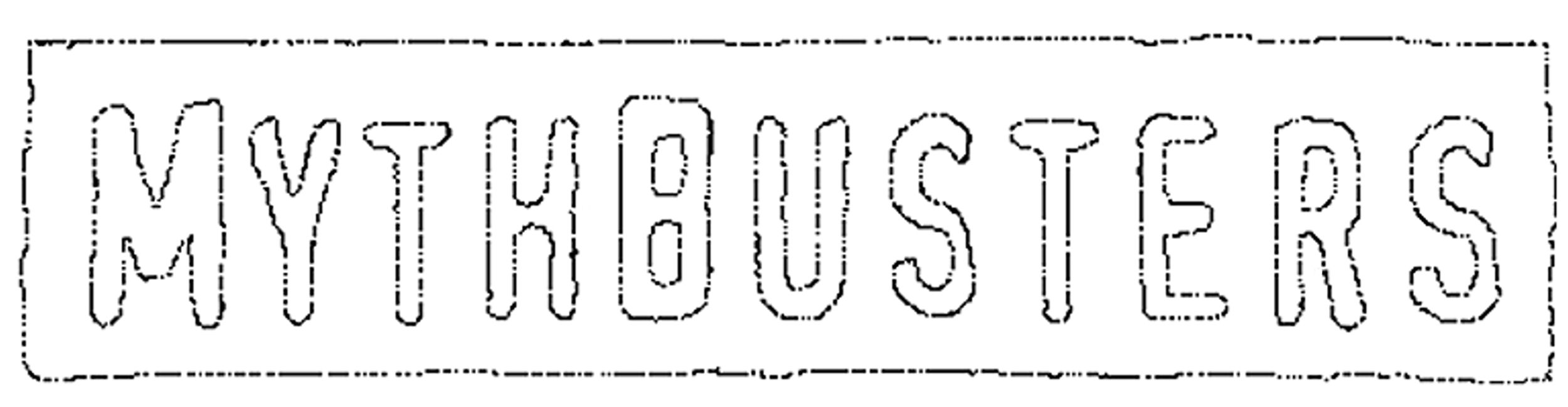

Thanks for the compliments! This really was an easy project. Sorry I didn't document my progress with WIP photos. Here's what I did:
I started by grabbing a few pictures I found with Google Images. Just search for “Mythbusters sign.” I selected a few of the larger file size images so I had some resolution to work with. Note: I believe that there were 3 signs originally made, and appear to be in a variety of sizes. You can see them in just about any of the Mythbusters episodes. Many of the images I found on line appear to be digital art created for marketing and advertising the show. I don’t know for sure, but there are several signs and they all look a little different. Mine is not an exact copy of any specific sign.
Using photo editing software (in my case it was Paint Shop Pro) I made a simple outline of the sign and letters by tracing my “borrowed” image. I made the outline on its own layer and, when finished, discarded the original image leaving me with the tracing. Of course, this could also be done freehand, or on tracing paper over a print, or however. I then played around with the size of the image until I could print it at my desired length (24 inches). You could also size up a small image with a series of enlargements on a copy machine. The letters are a bit rough so this is not a real critical operation (see, easy and forgiving starter project…).
My sign is made from two layers of ¼ inch white sheet styrene that was left over from another project. The first layer is the sign backing itself, as said, it is about 6 inches x 24 inches. The second layer is the 11 letters. I believe that Adam Savage had recently posted that he made the original signs from 1/8 inch steel. If I were to do this again, I would certainly use the thinner material. It would make cutting the letters easier! I traced the letters from my 1:1 print onto the styrene. I simply placed the paper print on top of the plastic and traced the letters with a nice new wet Sharpie. The ink soaked thru the paper and transferred the letter outline onto the styrene. You could also cut out the paper letters and trace around them or use carbon paper (that stuff still available??).
