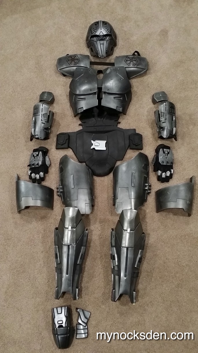

Alright, here it is: the first sneak peak of all the Sith Acolyte armor parts made to date gathered together for some group shots!
Hard parts are about 90% complete! Just need to finish molding and casting the right thigh, COD plate, and we're there (I missed the left boot plates in the photos)! Armour has been nearly 2 years in development now, and is extremely screen accurate. It is cast in resin (with the exception of boot plates and knuckles, which are vacuum formed). Since every piece has been molded, armour is 100% repeatable. Will be sporting this at C7 early next year!
Almost there! :)
