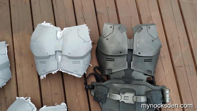

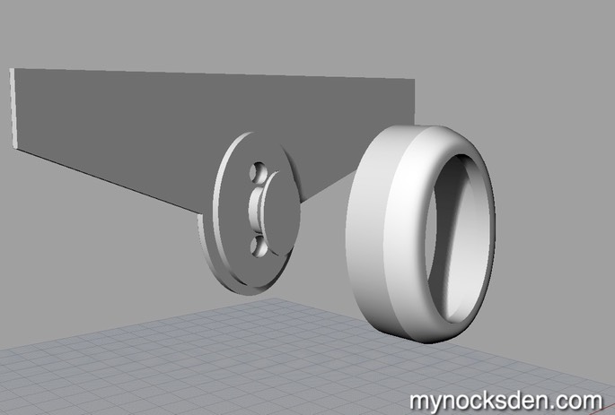

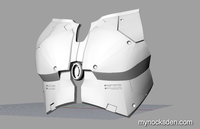

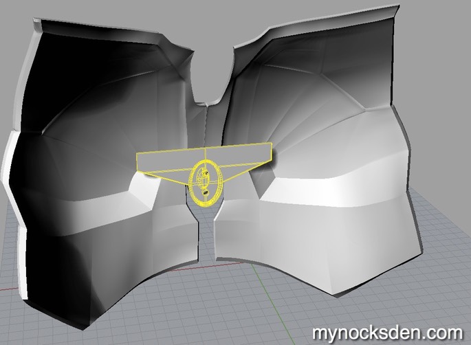

Enter Sith Acolyte/TOR Jedi chest plate V2! Unlike the original version which was done 100% by hand, this is completely CAD based, and will be 3D printed. As before, the final piece will be cold cast in 65D resin, with the outer layer cold-cast in aluminum. The Jedi version will come with a 3D printed centre oval housing, which will be comprised of two pieces that will snap together. The assembly will be hollow to allow for installation of LED lights. I will be 3D printing this in the next few days once I finish up the model, so stay tuned for more updates!

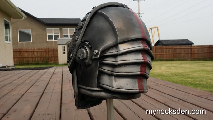

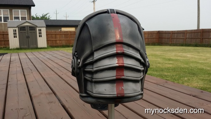

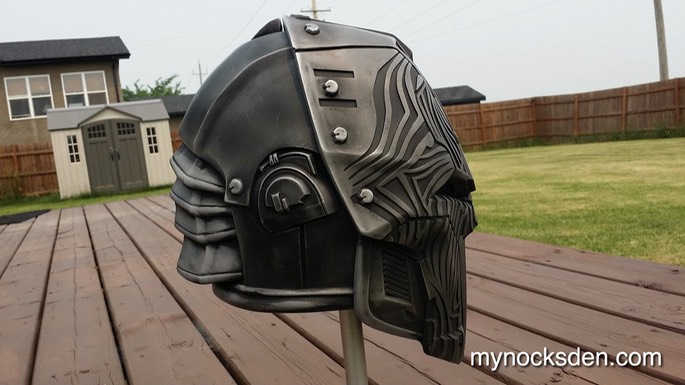

Alas, no build is every truly finished! Thus, behold, the Sith Acolyte Helmet!
I've worked on this build for 3 years, and in that time have come by a lot of invaluable information and insight into this character; I've known for a while that the mask is really a two-part helmet, though until now I didn't see the need do the back piece, as it was never seen in the old trailers. The unhooded Acolytes in the new SWTOR trailer "Sacrifice" changed my mind! :D
Basically it is my version 5 Sith Acolyte mask supplemented with a detachable backplate. In the reference material the Sith Acolyte character's helmet is quite small in proportion to the rest of the body. When I initially modelled the front mask, I scaled it up so that it would cover the face of an average person. I then made the back piece to maintain proportion with the front, which made it very accurate albeit small.
My goal in this was not to make a wearable component, but to turn the wearable mask into a screen accurate display piece - a full helmet. Don't get me wrong, the two-part helmet CAN be worn, though because of how snug it is, it may not fit all heads or be very comfortable to wear for more than a few minutes at a time. The two halves are separated for the helmet to be put on; they secure back in place over the head using Velcro straps. Some people have suggested neodymium magnets to hold the two halves together, and so I placed an order for some to experiment with. I'll be posting results soon.

In other news: the redesigned and much more accurate V2 chest plate is finally ready! The new plate is reinforced with a metal rod across the central bridge (the weakest structural point), and is lighter than the old version. I have some amber LED lights on order as well; once those get here, I'll put together a lit Jedi version to give you an idea of what that will look like.
Taras, each post you make on this guy absolutely blows all previous updates out of the water!
Quite frankly one of the best, well put together SW costumes around.
Thank you, sir! It has been a long but fun-filled journey :) More cool stuff to come in the coming days!
