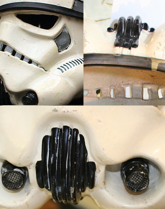

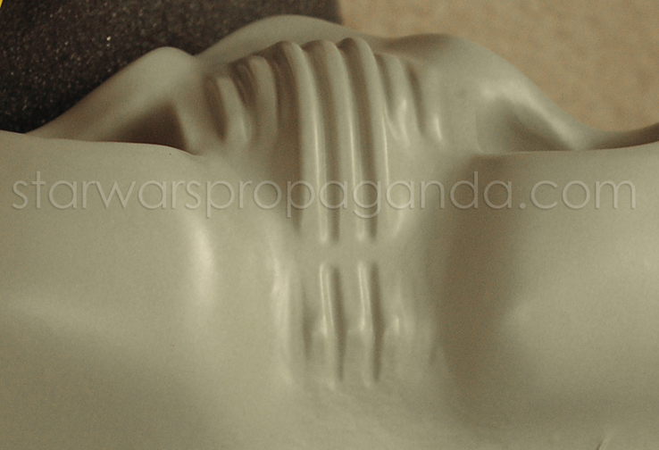

Something that I've incorporated into this V3 HDPE is the enhanced vocoder area.
Every vocoder I've ever seen (with the exception of the Brian R helmet that is the origin of my faceplate) is extremely sharp. The ribs are individual with deep grooves in-between. Of course, the sharpness of this area varies from faceplate to faceplate on the screen used helmets.
I could see on my mold were all these individual ribs/grooves were, so I very, very cautiously enhanced their depth to be more in-line with the other screen used helmets.
Here's a comp of screen used HDPE helmets that show the sharpness of the vocoder as well as the tube crease-bump.

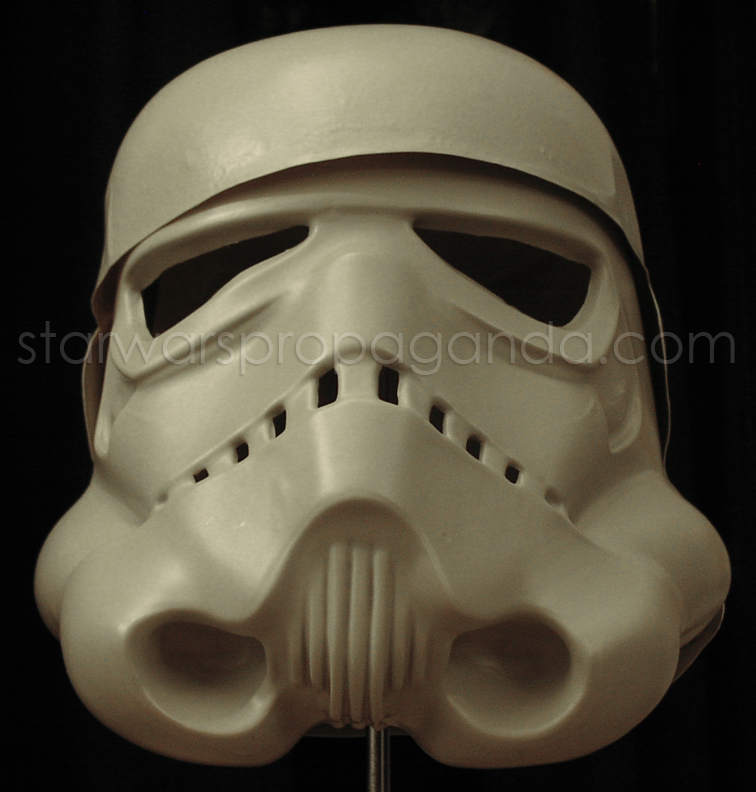

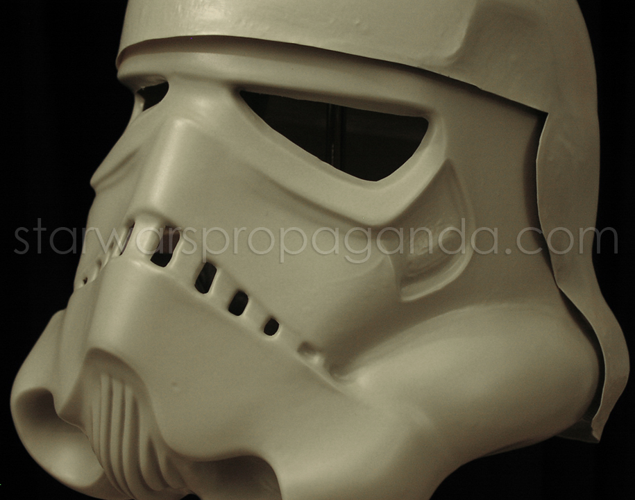

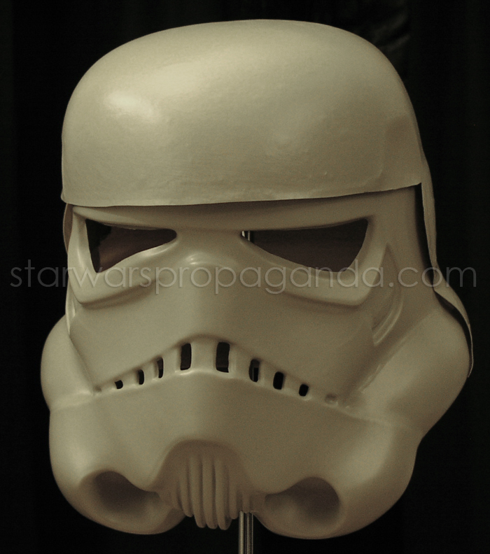

Ok enough rambling, here are some pics.
The helmet is not assembled, it's just being held together by tape which is why the back/cap is sitting crooked on the face. I just wanted to give an idea of what it would look like.
Let me know what you think.
Re: My V3 HDPE TROOPER HELMET
Beutiful Gino!!Really exciting stuff.And yes that HDPE does do weird stuff.Nice work on the vacoder area too.
Ben
Beautifully formed!:love and lovely surface details on the faceplate too.now is time for the other tricky part *gulp*

Getting there Gino, but I see a lot of air "channels" or "tunneling" going on in many places. Sounds like this stuff (HDPE) is a major challenge! What variables have you tried so far (heating or vac strength etc.)? Looking forward to seeing these when they get dialed in.
Doug
Actually this is as there as it's going to get. :)
What you are seeing are not air channel issues.
The material sucks into those areas just fine, but then the material takes over.
The same phenomena occurs on the screen helmets.
